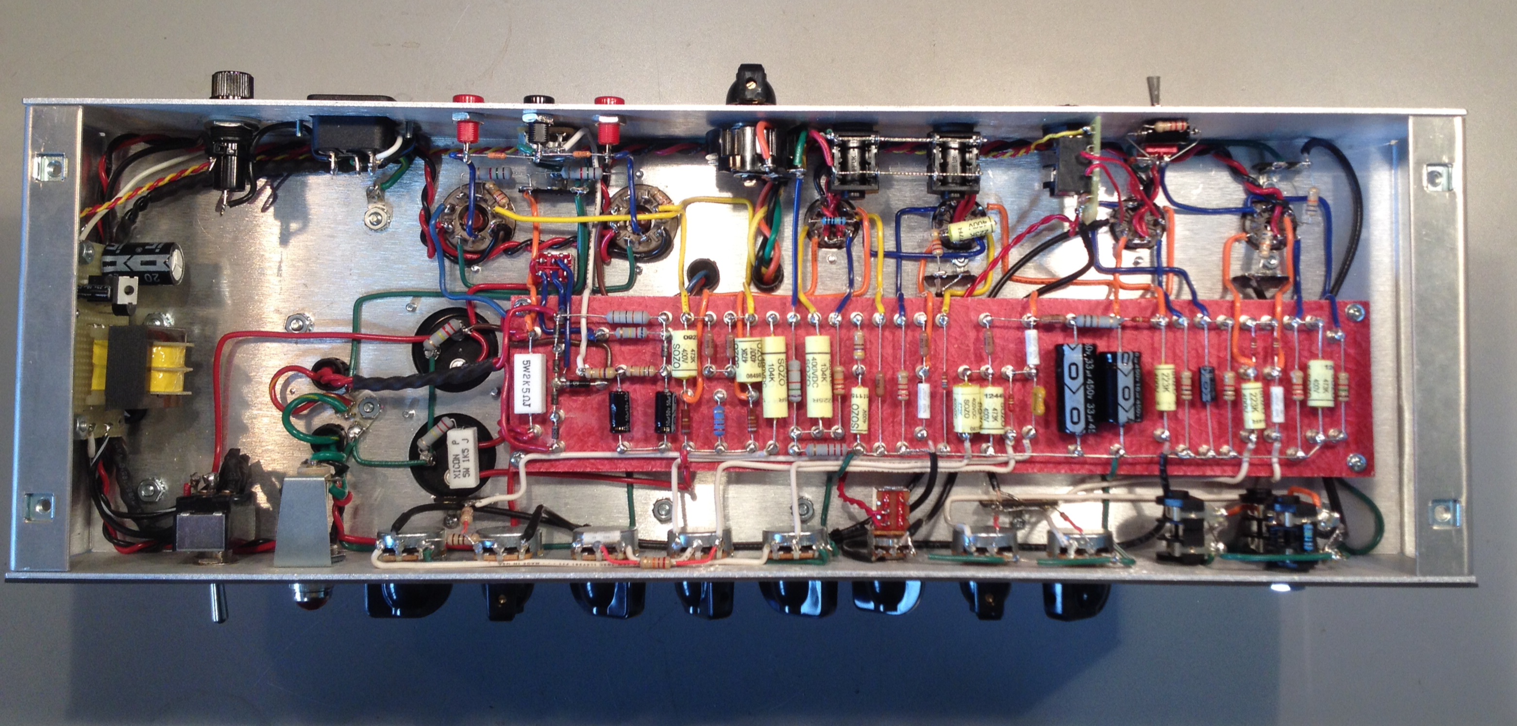

PostPosted: Tue Jul 28, 2020 11:07 am
At this point, my suggestion is to review your lead dress. Shortening, Separating wires and crossing wires at 90 degrees. I've not had this issue in my builds.
Check out the picture for clues.
and here's a large hi res picture
http://www.trinityamps.com/ForumGallery/trinity/triwatt/circuit_board.jpg

Hi Stephen and PharmRock, thanks for the replies, and sorry I'm a couple months late--in fact, I somehow missed Stephen's reply to review lead dress until I came back to follow up. I'm about to embark on an 18-Watt build and wanted to resolve any lingering issues with my Triwatt to start from a clean slate. That, and the laziness of not wanting to unpack the chassis and poke around was holding me up!
Stephen--I came to the same conclusion without seeing your post after gaining much more amp-building and troubleshooting experience during the lockdown (7 more amps, to be exact!): LEAD DRESS. I found I was able to eliminate the pop by snuffing the V1A plate resistor with a .1uf capacitor, so I started chopsticking leads around V1, V2, and V3. I was able to get a little joy with the chopstick on the V3A plate/grid wires, so I went through all 3 tubes' plate and grid wires, shortening most of them, getting more space between them, and crossing as cleanly as possible as Stephen suggests. Et voila, no more pop!
Revisiting the layout, I have to say Stephen has done a very good job of showing you where the wires should be--the closer you follow that, the better your chances are of avoiding any oscillation issues. As someone who marveled at the precision of other users' Triwatt builds here and attempted a similar look, my build style has progressed to the point that I really don't care if all the wires are making their way around the chassis at 90-degree angles--the ability to see/access everything, and a cleaner lead dress has become the focus, which doesn't necessarily translate to visual precision all the time (not to knock those out there who've achieved both a quiet amp AND such a stunning look :).
