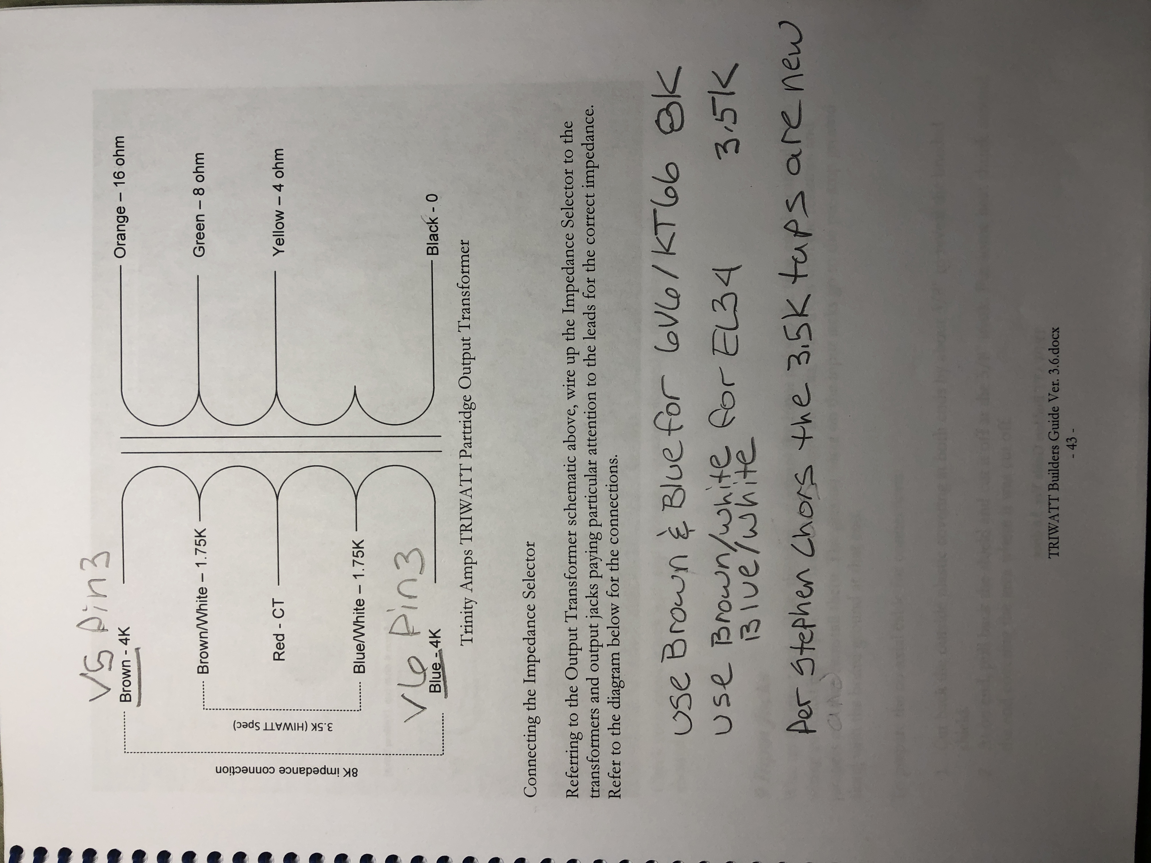

Thanks for the reply. That makes sense. I'd like to try EL34's at some point. Is there a big difference in tonality between them and the KT66's ?
I'll have to see if my amp has that tap available as I bought it already built. Are there any procedures printed up for the EL34 option anywhere, does anyone know ?
PostPosted: Mon Jun 08, 2020 3:46 pm
Posts: 40
You can read this thread and it should help you. But if your OT is older and it doesn’t have the 3.5 k taps than you cannot use EL34 tubes. If the wires are there they will be blue with a white stripe and brown with a white stripe stowed

The el 34s in my opinion are the best in it, you can easily get a nice lead tone without a boost or anything which is something the kt66 and 6V6 did well with but the 34s were stronger. Definitely felt more 70’s rock ish with the 34s, similar in gain to 70s marshalls but a different feel and more note definition.
Here are some pages out of the build manual. The extra taps are the later OT. Not sure when Stephen changed it.
Mark
