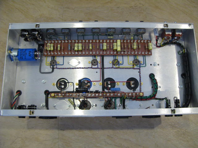

Here's a picture of the chassis for my 504.

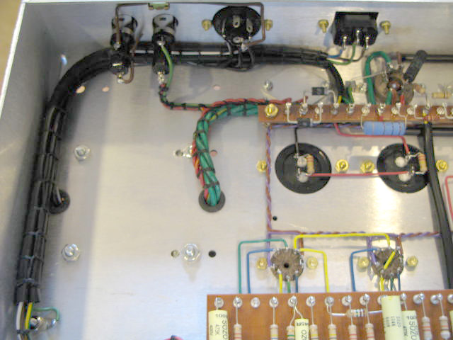

Thanks for the compliment about my DR504. It was actually my second tube amp project. The first one was a Trinity TC-15 I built about a year earlier, but I had been building electronic projects for over 30 years by that time. The assembly work for the original Hiwatt amps was contracted out to an outfit in England that also did work for the British Navy. The wiring was very neat and close to military specifications. I tried to emulate that as closely as possible when I built mine. Also I started with a fairly big chassis, like the originals had, so it was easier to keep the wiring from looking cluttered.
Here's a picture of the outside of the chassis.
PostPosted: Sat Dec 07, 2019 12:13 am
Mitch, did you loom the wiring on the mains and power transformer wiring or are those cable ties? Curious minds (mine) would like to know :hmmm: . In any case, sure is "priddy" (Okie for pretty).
PostPosted: Sat Dec 07, 2019 1:30 am

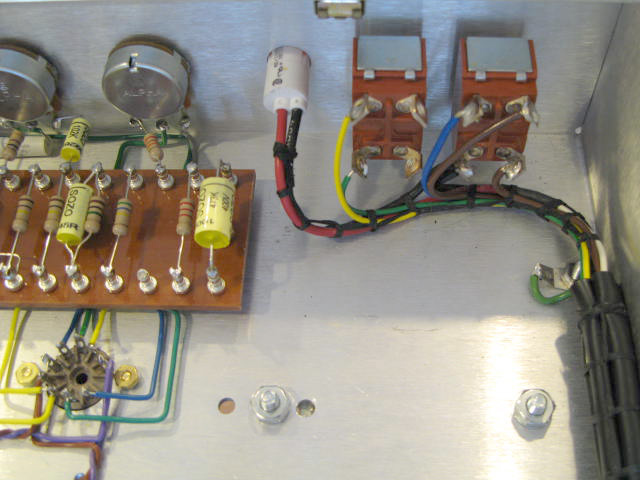

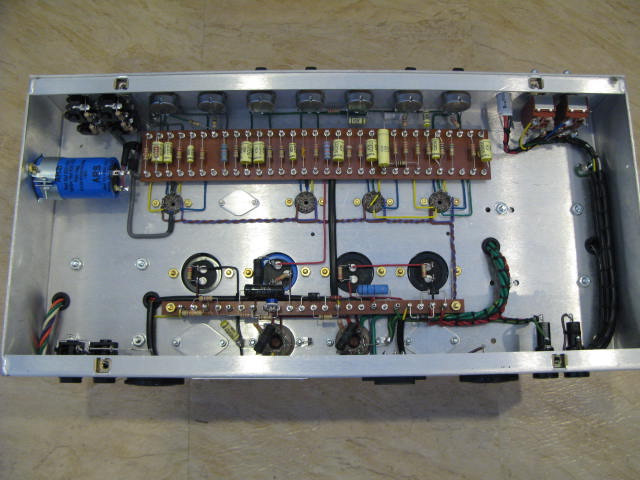

Thanks, Hank. The original Hiwatts used cable lacing and plastic tubing to bundle the power and transformer wires, so I did that too. Also like the originals, I attached all the fly-off wires to the underside of the circuit board. It sort of looks like the board isn't wired to anything yet in the photo of the chassis interior I posted earlier, but that's the completed amp.

I'm happy to answer your questions, but this is sort of hijacking Matt's post about his successful Triwatt build. I have lots more pictures of my DR504 project and I can post some of them in the Dressing Room section if anyone is interested in seeing what a Triwatt's big brother looks like.

The metal piece between the output tubes and the filter capacitors on my 504 is a heat shield like the original Hiwatts had. A couple of EL34 tubes get fairly hot so it helps to keep the capacitors from getting too warm. Some Hiwatts have four EL34s so they would get even hotter.
