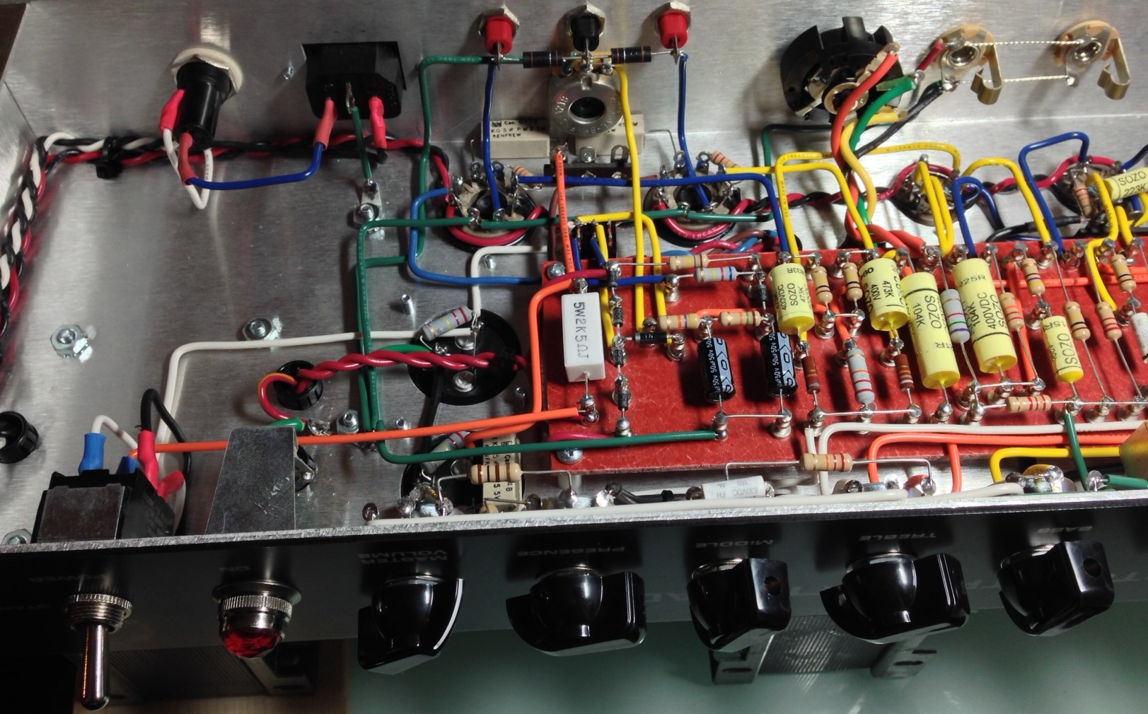

After unexpectedly moving I have finally found some time to start on the build. This is my first amp build so if you see anything goofy please let me know. I have built a couple pedals and am a profession luthier who has been looking to build an amp for the past 5 years. I'm pretty good with a soldiering iron and can get pretty anal on details.
Here is my current progress. I have all the tube sockets wired up and all the caps and resistors in. I'm pretty happy with how it's coming. Thanks a lot to zaphod for his build picks they have been very helpful.
I'll have some more time on Thursday to work on it. I can't wait.

I can't comment on how it goes together but I can say that is a very nice and professional looking build.
I'm about to embark on my 18 watt build and I sure hope it turns out as neat as yours is.
How many hours do you have in the build so far?

Looks excellent. Keep it up and I'm sure you will have a winner there!

Work looks awesome. Love the crisp corners on the wires.
