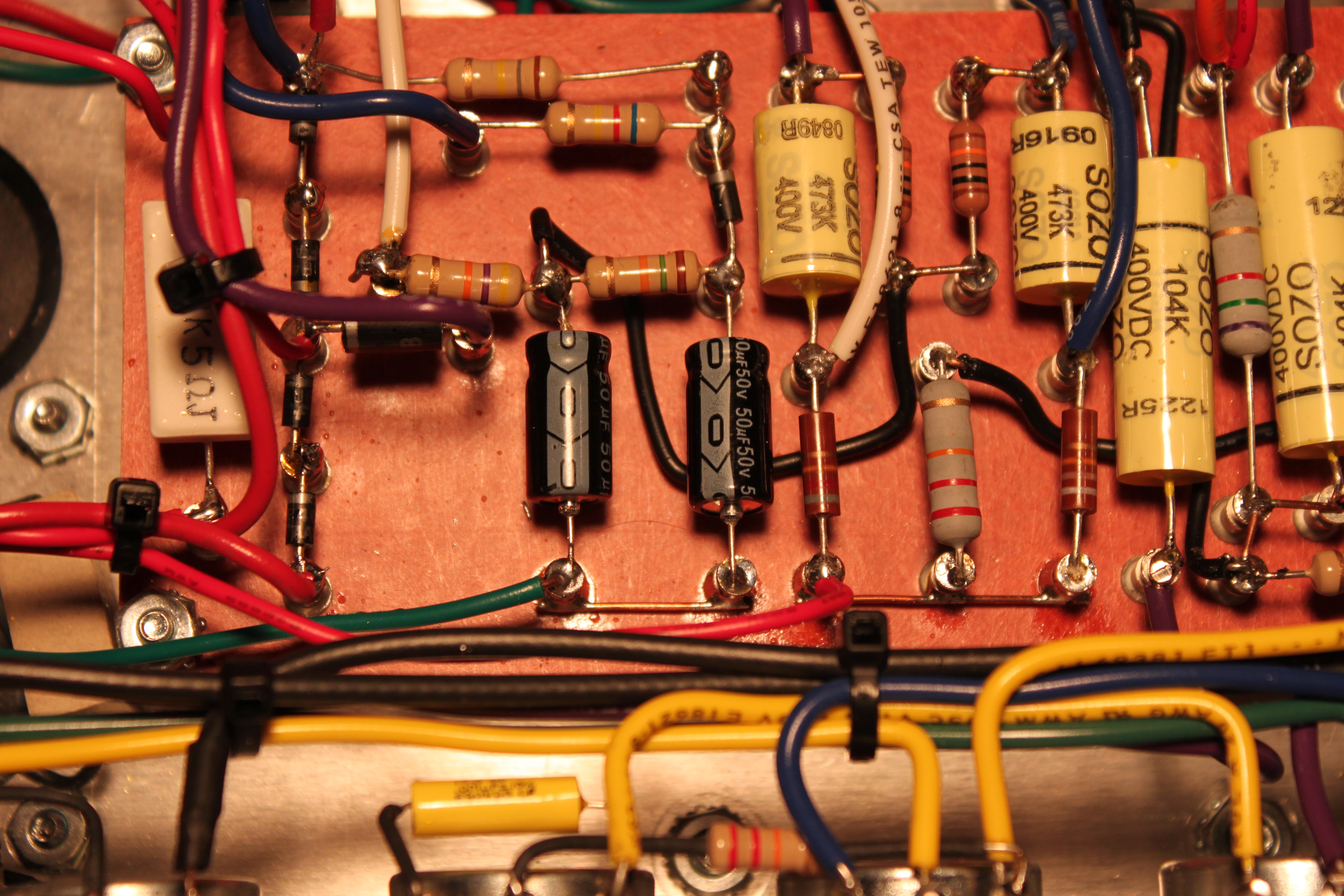

I think that I have found my problem...
I think that I have two caps in backwards...
Thanks,
Andrew
PostPosted: Sun May 26, 2013 7:02 pm
Posts: 49
Okay I am going to try to add as an attachment...
File comment: Caps In Backwards?
PostPosted: Sun May 26, 2013 11:34 pm
Yes they are in backwards which means you have no bias control.

Okay after swapping the two caps, and setting the bias to 22.5, which was the maximum I could get, these are the voltages that I measured....
