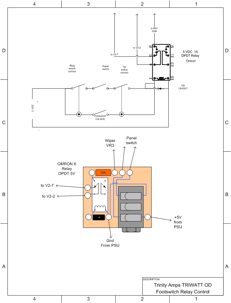

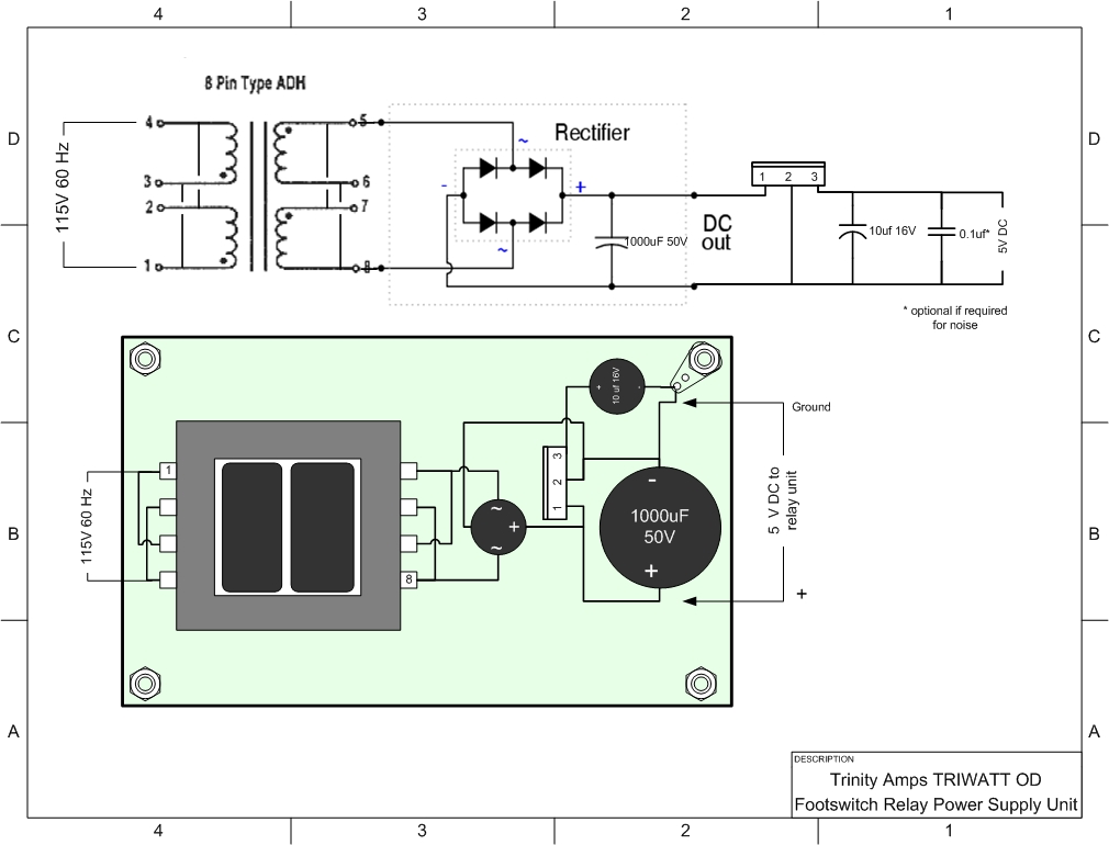

I am new to this forum and to amp building, so bear with me if these are beginner questions. I have a Trinity Triwatt that I have nearly completed, except for the footswitch. Here are my questions:
1. I am unsure of how to wire the power supply unit up to the 120V power switch. Which components should the white and black wires from the PSU connect to?
2. Should the +5 V and ground wires that go from the PSU to the relay board be twisted to reduce any noise?
3. I see in the manual where it says not to connect the 100k resistor to the back of the overdrive switch if using the footswitch. Is this resistor not used?
4. On the layout diagram of the relay where two wires go off the board and say "to Panel OD Switch", which lugs do the wires attach to exactly and does it matter if they are reversed?
5. Is the straight wire that goes from the OD switch to the nearby lug not necessary with the footswitch option?
A - One to the Power switch the other to line Neutral OR to just connect them to the Power transformer primary.
A- Not necessary as DC has no noise, but not a bad idea to keep them neat by twisting.
A- They can be reversed. It goes to any two terminals that are closed when the OD panel switch is pulled. Test with a meter to find two terminals that behave like that. It will be a middle terminal and one other.
A-It is still required.
