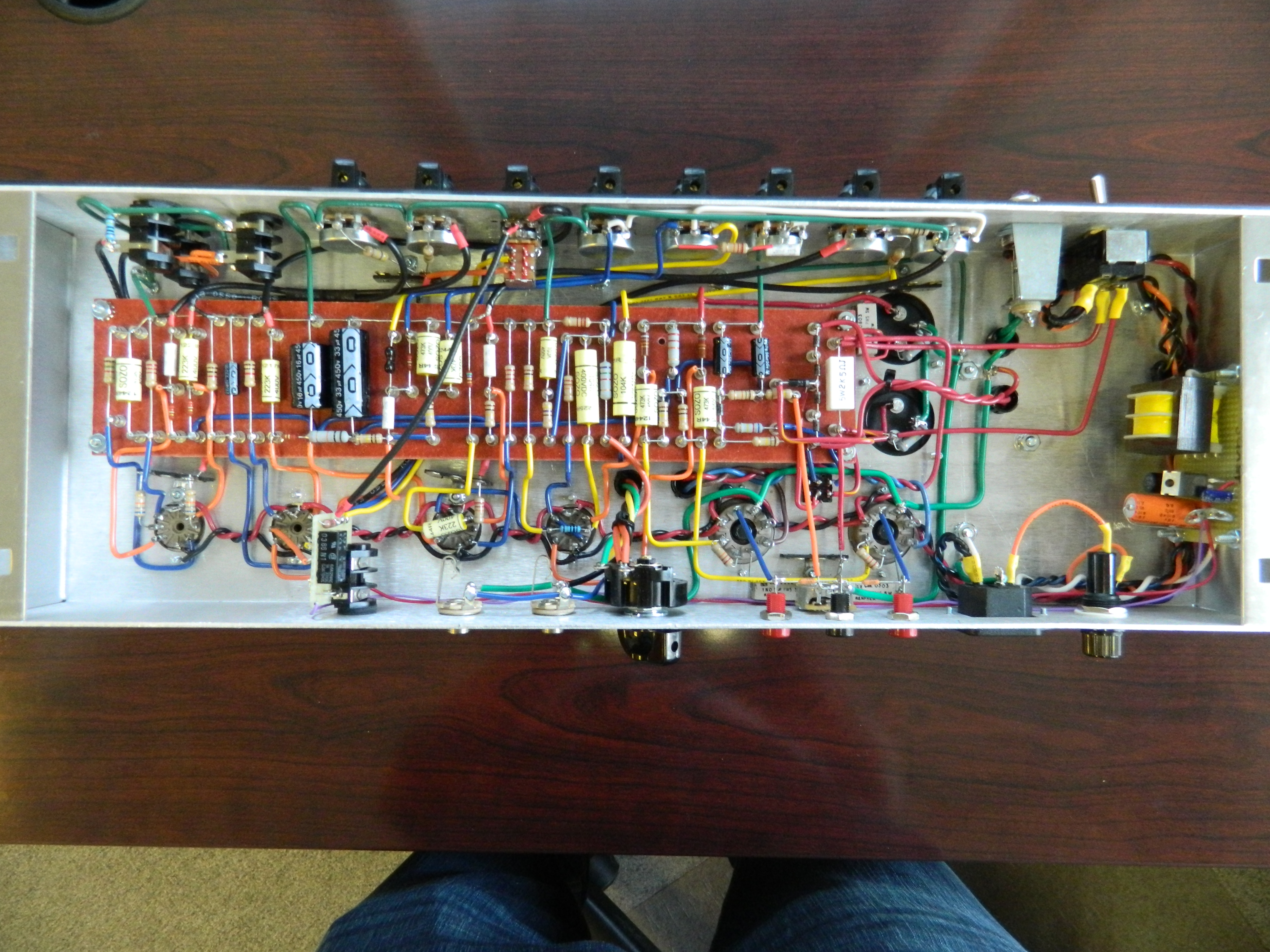

Next, after turning the volume up a bit there is a loud hum. I am wondering if this is related to the bias thing, but I don't know. I swapped out another set of preamp and power tubes and I get the same hum. Also, I am having the squealing issue with the OD up past 3 o'clock like some other builders have mentioned. I have attached a pic of my build and any help would be greatly appreciated. Thanks!

I should also mention that when the pic was taken the high voltage PT secondaries and the red wire to the left side of the zener diode were not wired in yet. They are now... obviously.

What's the voltage at the junction of D6, C22 and R45? The solder joint at this turret looks a bit suspect in your photo.
PostPosted: Wed Nov 13, 2013 12:41 am
In the photo, there seem to be turrets that weren't soldered, I'm assuming you have soldered everything.

Coco: yes, everything is soldered in now. I took that picture before I soldered the high voltage secondaries and the red wire to the zener diode.
Mitch M: Thanks for taking a look. I'll check that when I get home tonight.

I checked the voltage at the junction of D6, C22, and R45, and it was -56.3 VDC. I checked it at all three leads coming into the joint and they were all the same, so I assume the solder joint is ok.

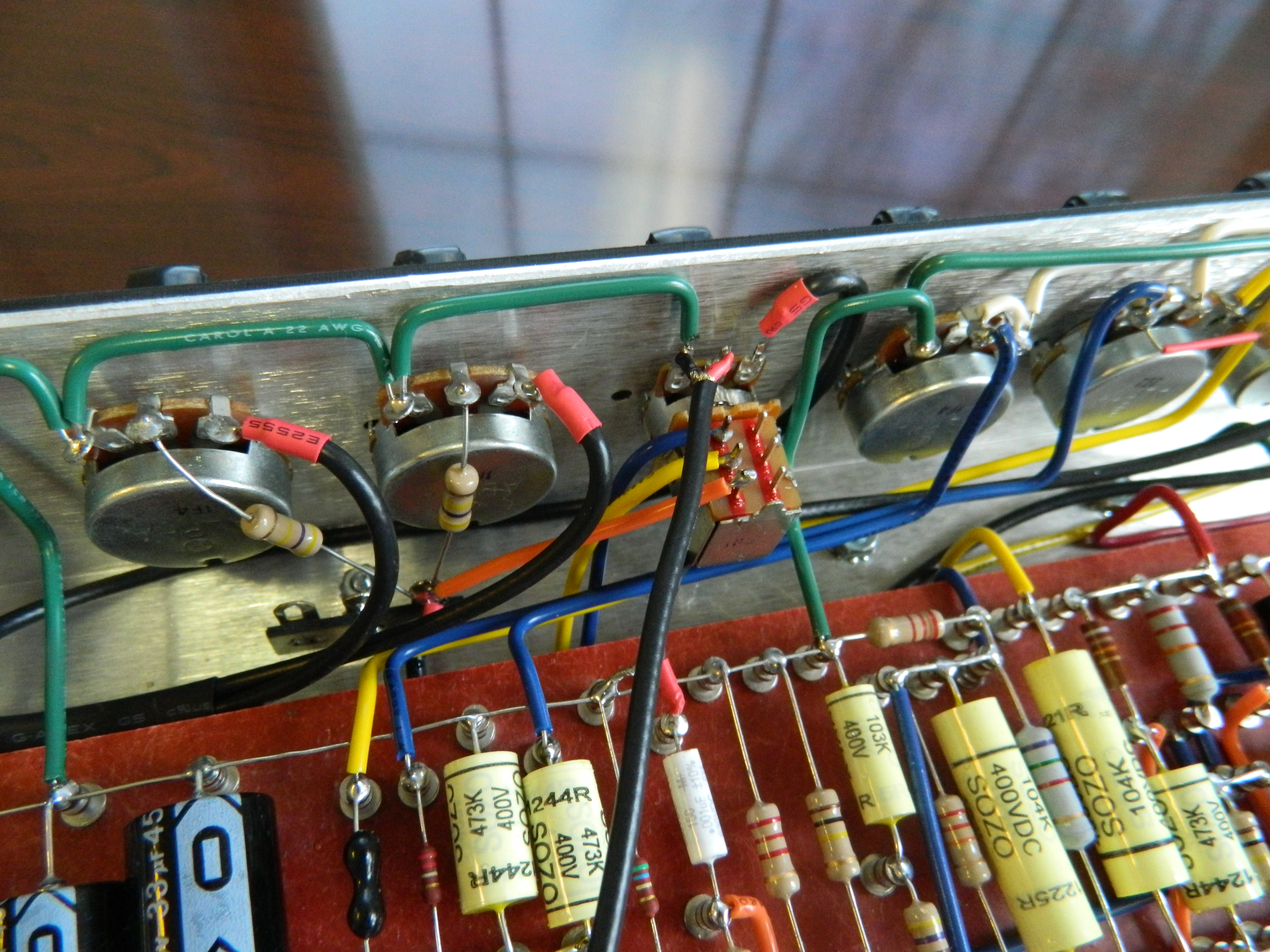

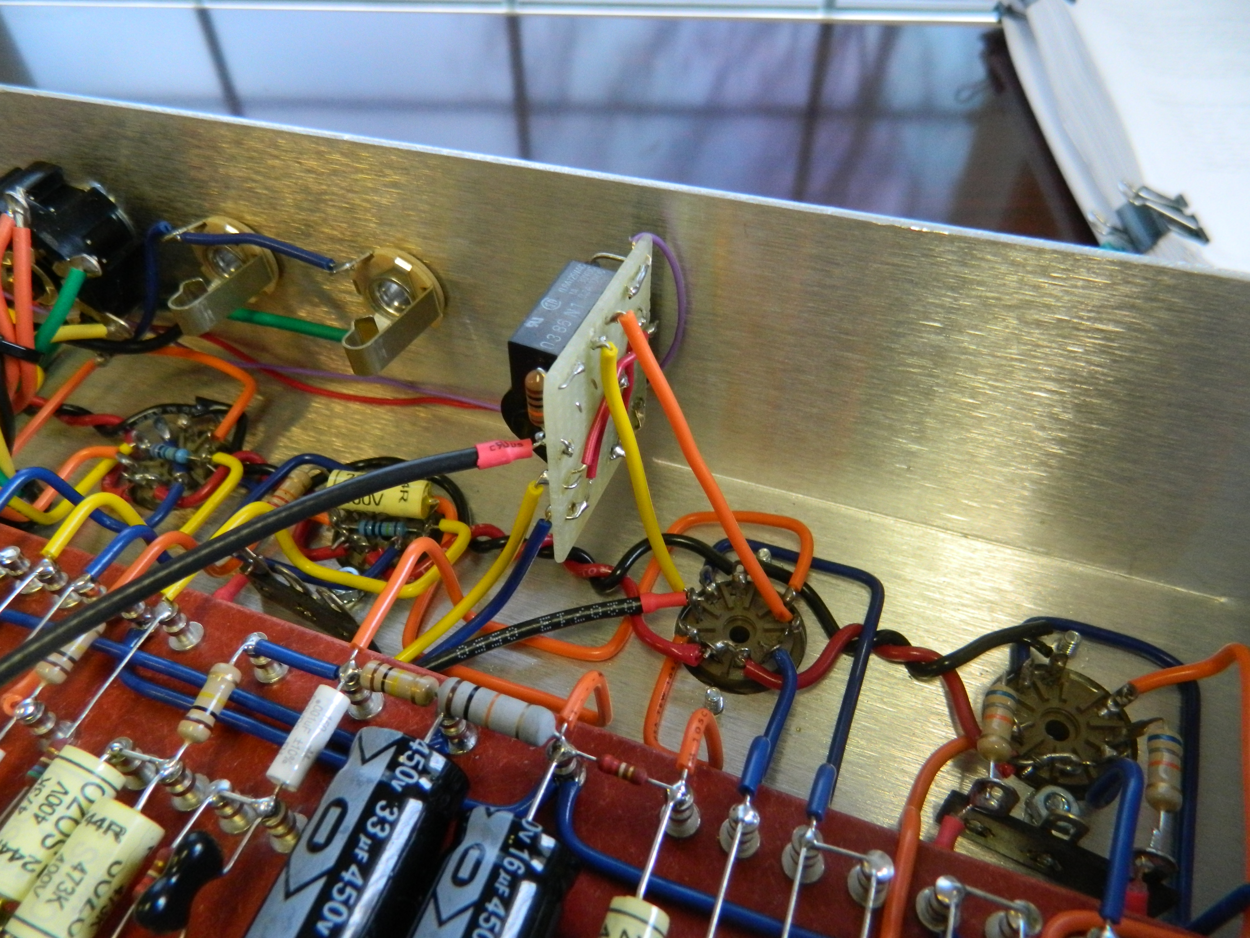

I got a little more time to play the amp and troubleshoot the other issues I originally mentioned (hum and squealing) and I have a little more info on that. I figured out that the hum goes away when I plug the OD footswitch in and use it to turn the OD on and off. I have attached a couple pictures of the the wiring as it stands now. Did I wire something wrong with the switch possibly? Grounding issue maybe?

Try moving around the yellow,orange and purple wires on the OD switch. All three of those wires are very sensitive, especially the orange one I find.
Try moving the wires around with a non-conductive device while the amp is running. This way you can hear the effects while the amp is on.

I have experimented with that a little bit. It did affect the squealing issue with the OD pot past 3 o'clock, but I could never get the squeal to completely stop. What I am more concerned with is the loud hum issue even when the volume pots are low. Moving these wires did not affect the hum issue.

I don't have the OD switch in my amp, but if the hum goes away when the footswitch is plugged in, then you could try grounding the jack. chances are you might have a ground loop happening and the jack is eliminating it. If you can get a grounding jack that would also do the trick (grounds out when nothing is plugged in it) usually more common on older amp, but that probably won't fit nice into the pcb..
For the squeal, I had it pretty bad and slowly corrected things until it went away almost completely unless the OD, the preamps, and the MV are all pretty cranked to top.
I shortened all leads coming or going in the OD circuit - moved leads around with a chopstick and any signal leads that affected the sound of the squeal I replaced with shielded wire. I then ran everything under the board. Each change gave incremental improvements.
