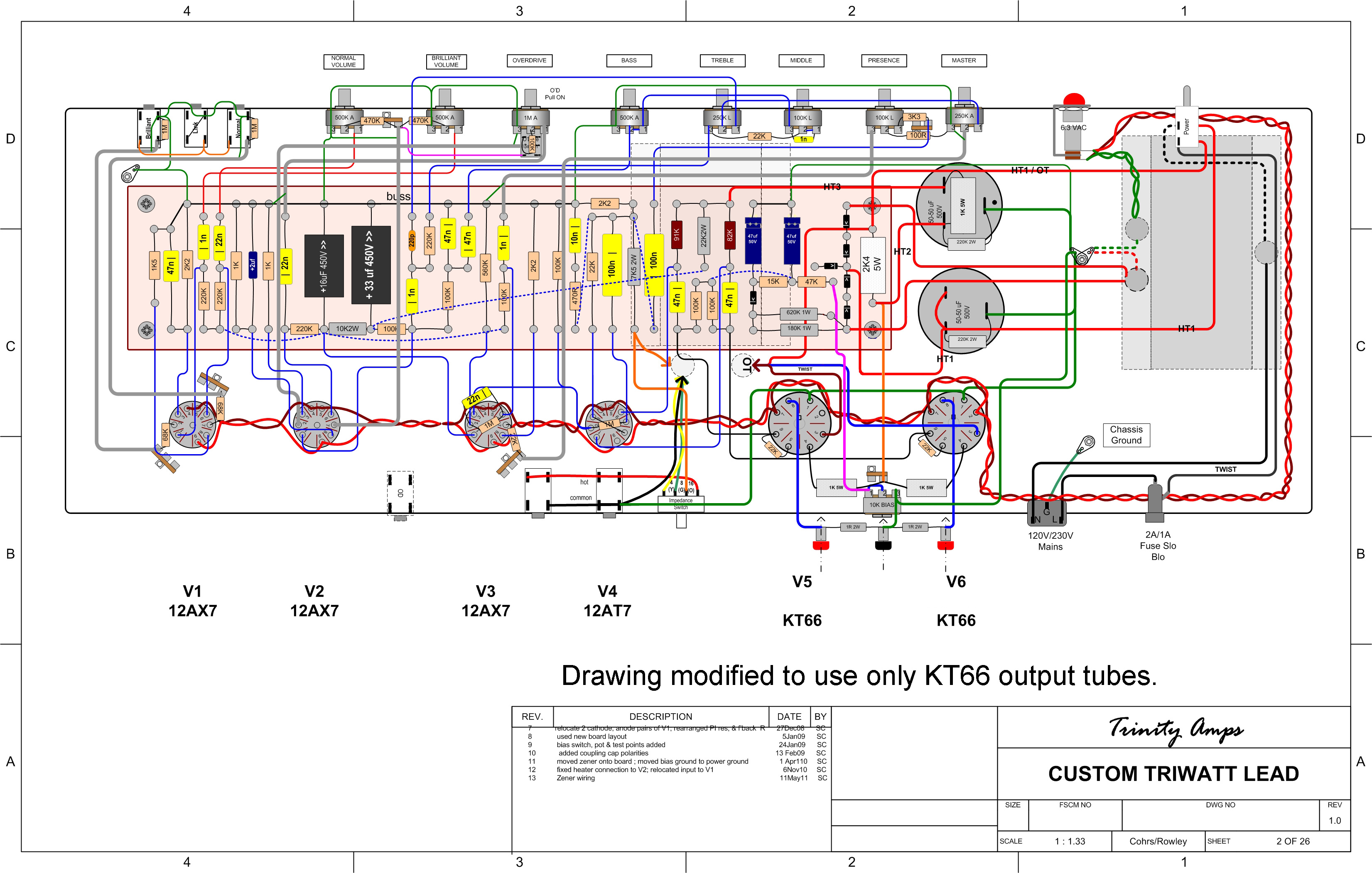

There are slight discrepancies between the layout and the documentation, regarding the bias circuit wiring. How shall I decide which is accurate?
Favour:
I'd like to bypass the bias switch and hardwire for KT66. Can anyone provide a simple description and/or bias circuit layout, describing or showing the correct wiring?

In the KT66 position, the bias switch lowers the value of the resistance feeding the bias circuit by connecting R43 and R44 in parallel. It also bypasses D5 to supply more B+ voltage.
To eliminate the switch and wire the amp only for KT66's:
Remove the switch and all of its wiring.
Place a short jumper between the right ends of R43 and R44, the same way there is a jumper on their left ends.
Wire the C20/R39/Standby Switch junction directly to the D1/D4/D5 junction.
You can also remove D5 if you want as it will not be used.
I modified the layout drawing to show all of this and it's attached to this message.
For the bias circuit the layout drawing and the schematic are correct. If you are having problems, recheck all your wiring very carefully.
Best of luck getting the amp going.

Thanks so much. The description was great, but the layout change was beyond the call. Can't thank you enough. I'll post a pic later, with results.
