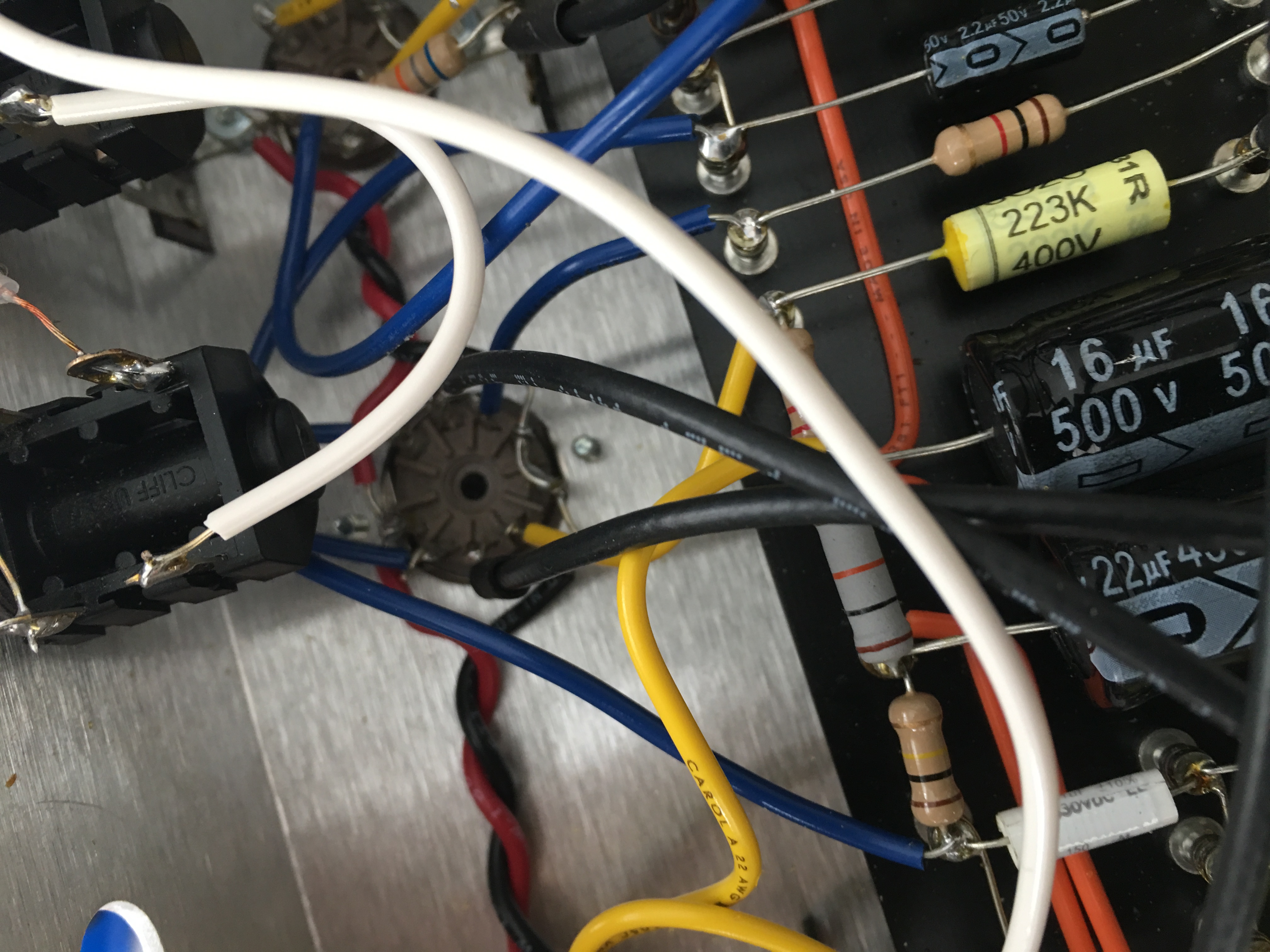

Well, there is an issue with the connectipn or a part around of v4 that you need to find for it to work correctly. A good picture of that area would help.
PostPosted: Sun Jan 08, 2017 2:09 pm
Joined: Sun Oct 09, 2016 12:23 pm
Posts: 23

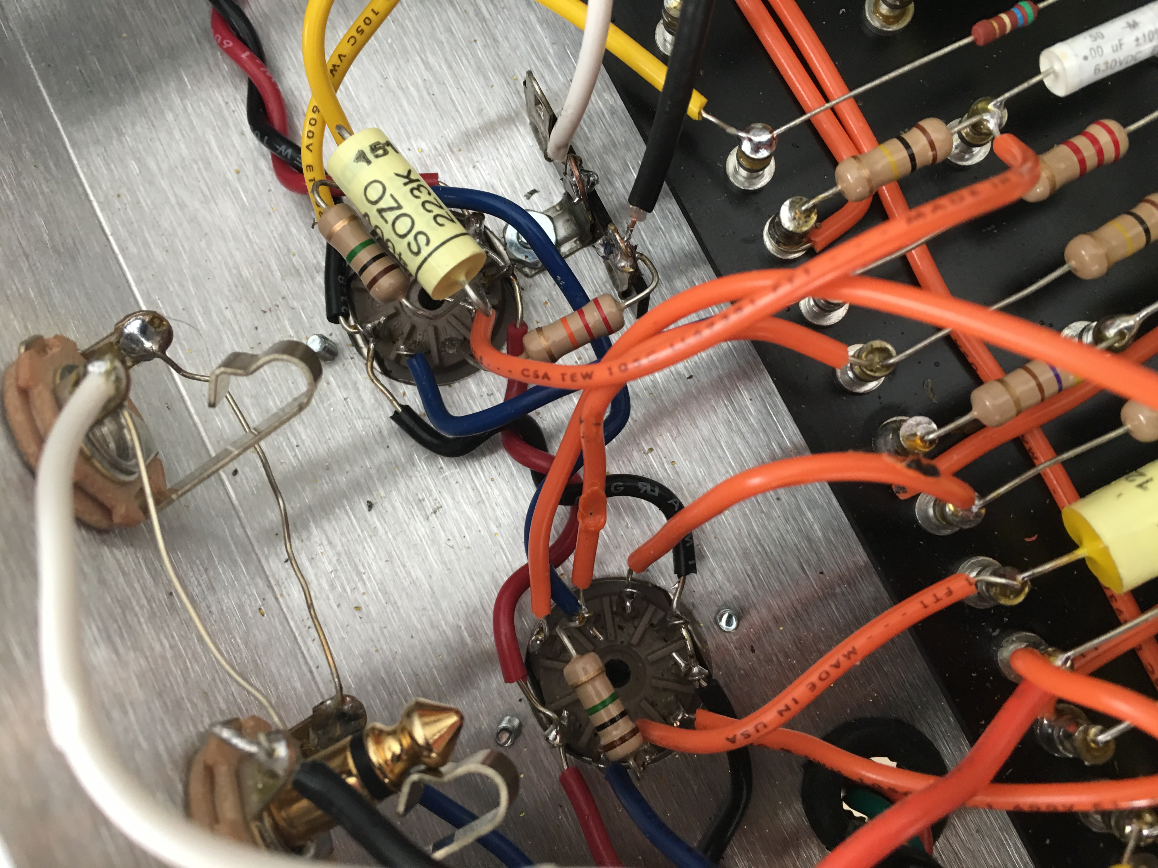

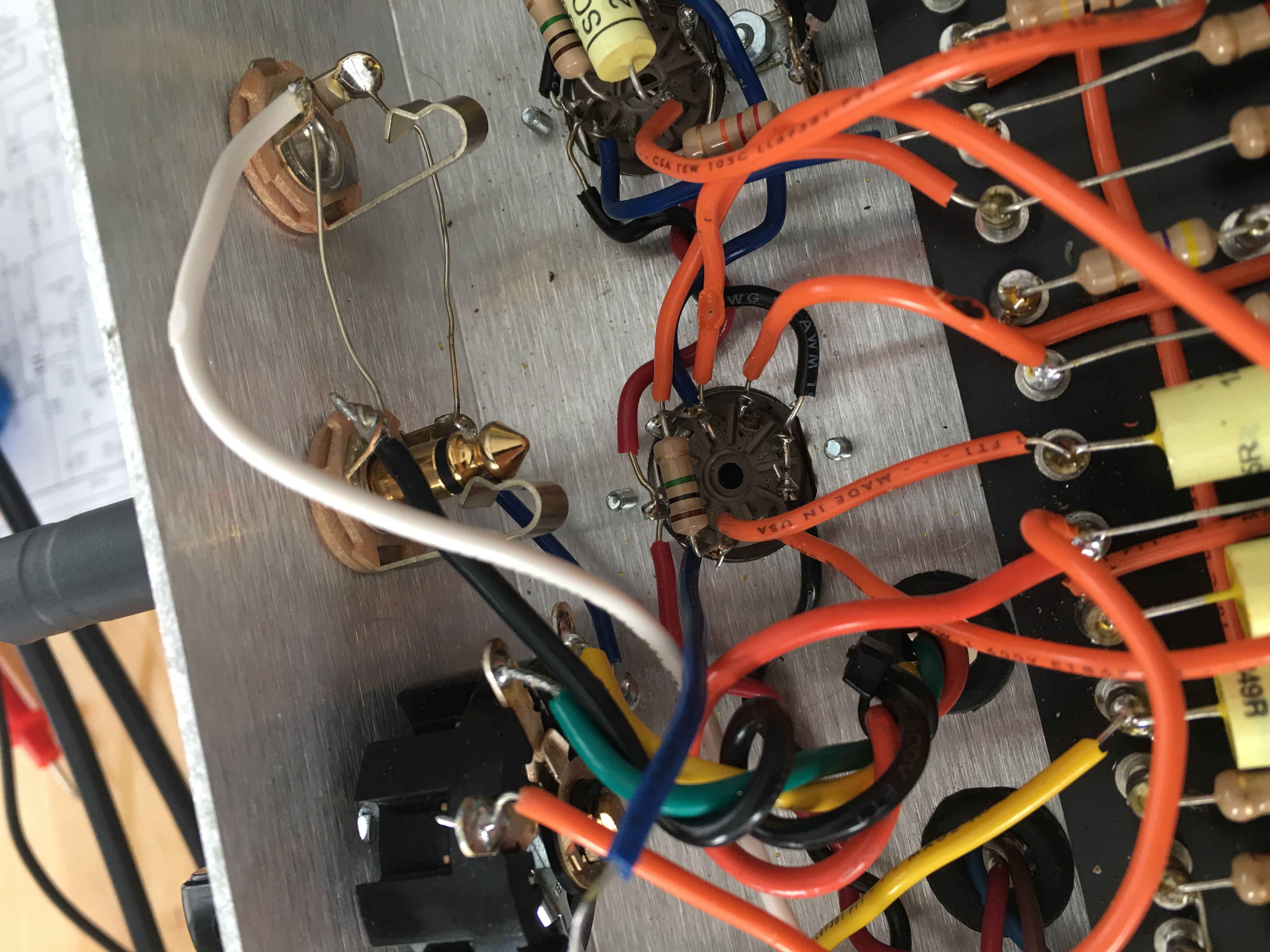

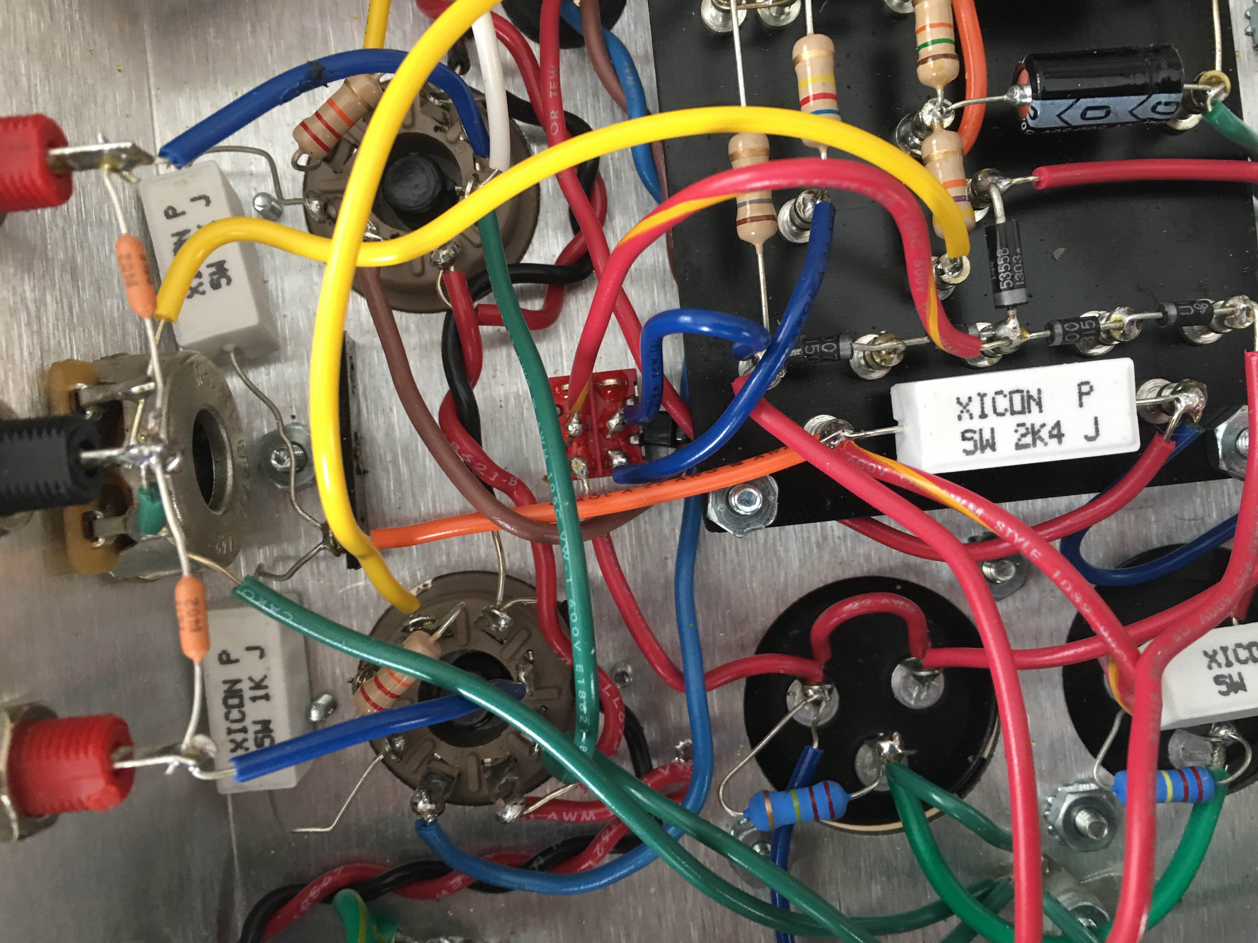

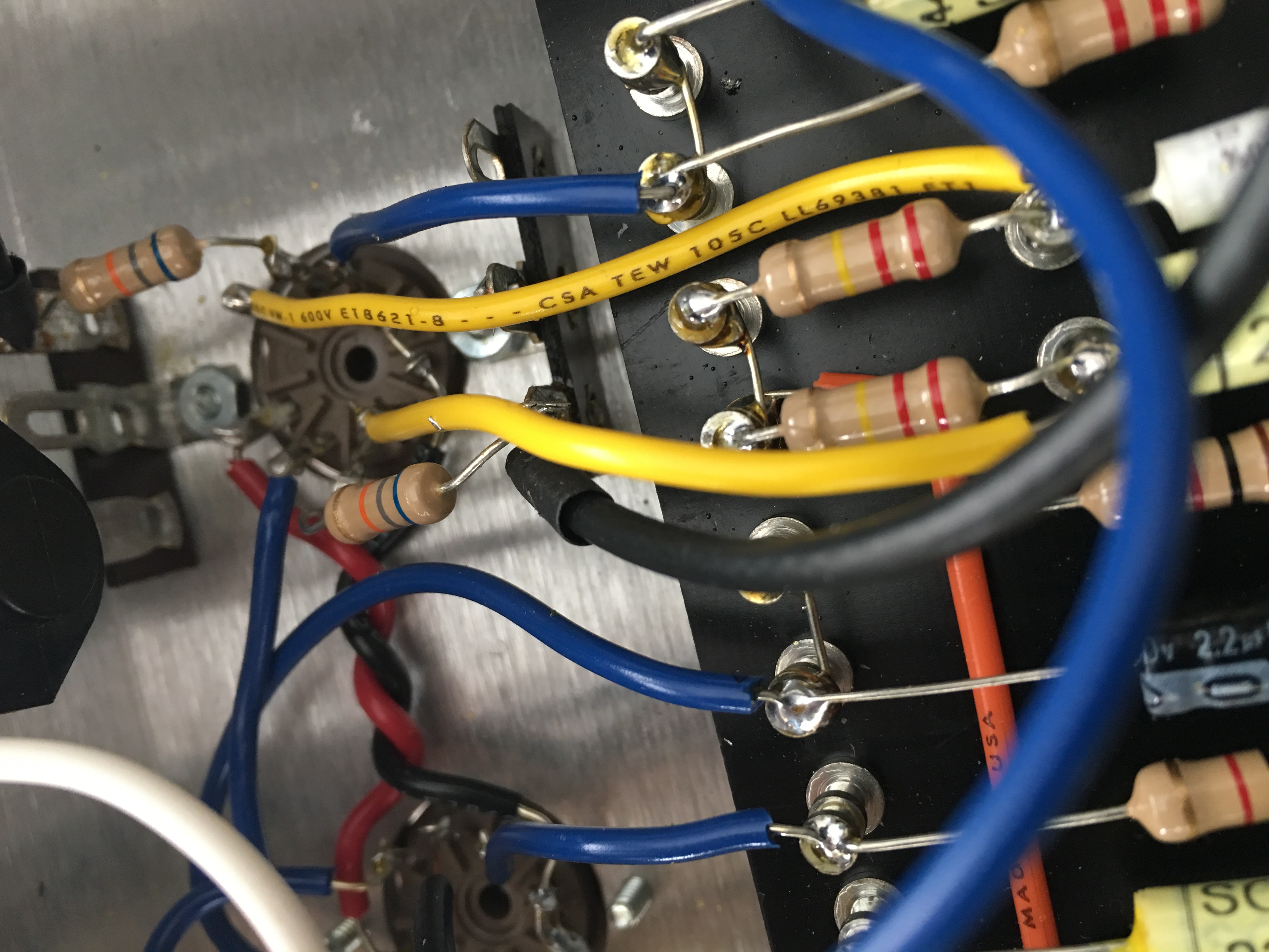

Good day here's some picture... sorry for the delay... I had someone triple check all the amps vs layout and schematic.
(Got the over drive problem solved... I had conected the wire from (V2 Pin2) to the OD jack on the same leg as the resistor...)
BUT having this made, I've try to connect the bridge (I had to use the blue wire over all the other connection...) but same result.
So it's now off again... and I can get pretty good sound out of my amp...(actually I love it... but I'm concern with not having the Bridge between pin 3 & 8 in V4)

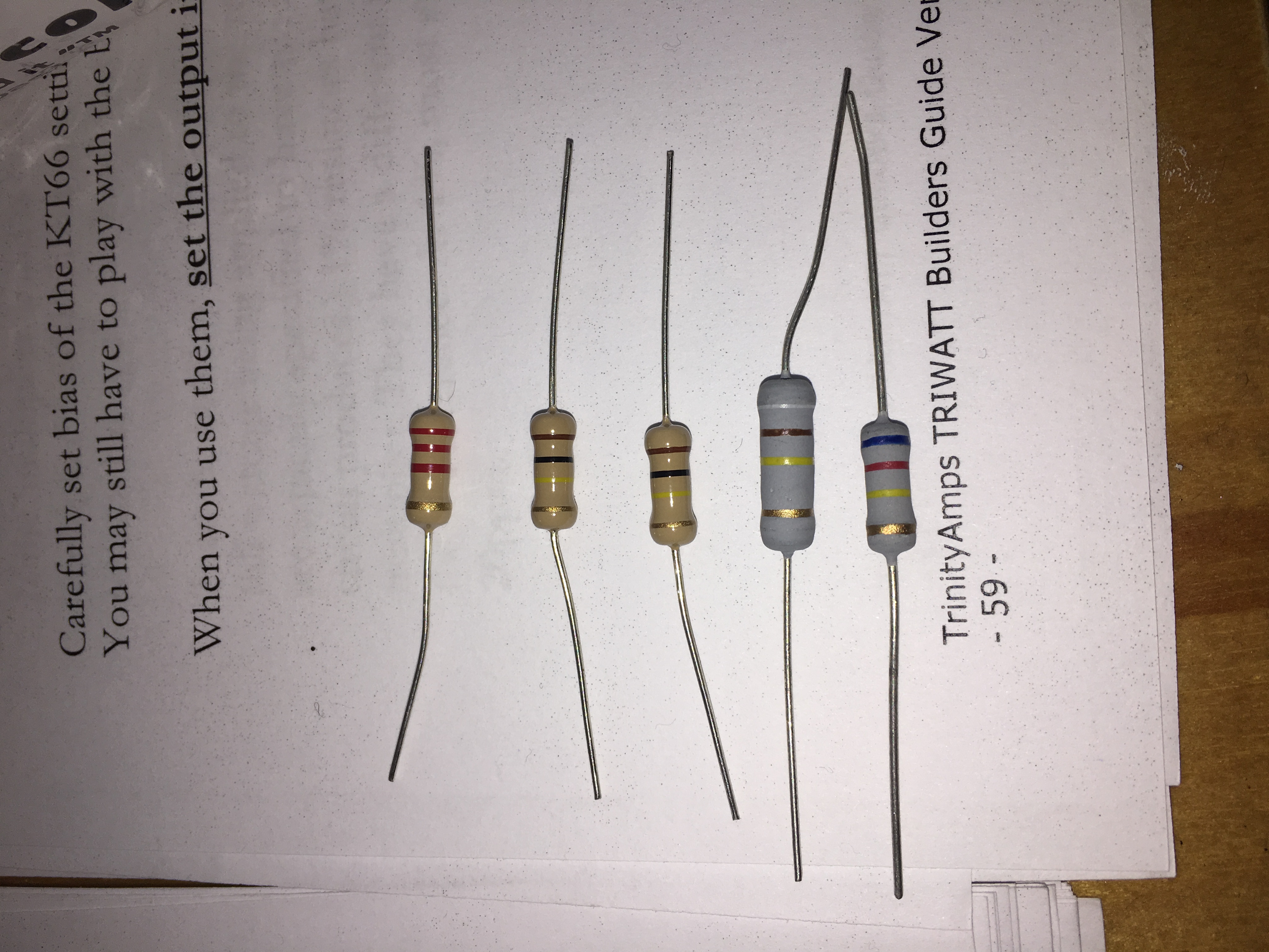

File comment: extra parts... can't find where they go...

V4 is the phase inverter that feeds signals to the power tubes. The connection between pins 3 and 8 is necessary for proper operation of the phase inverter. Put it back in place. The amp can't work at full power unless the phase inverter is working properly so both output tubes can drive the transformer.
Now that the problems around V3 and V4 are fixed, try swapping the pin 3 connections at V5 and V6 back the way they were originally.
