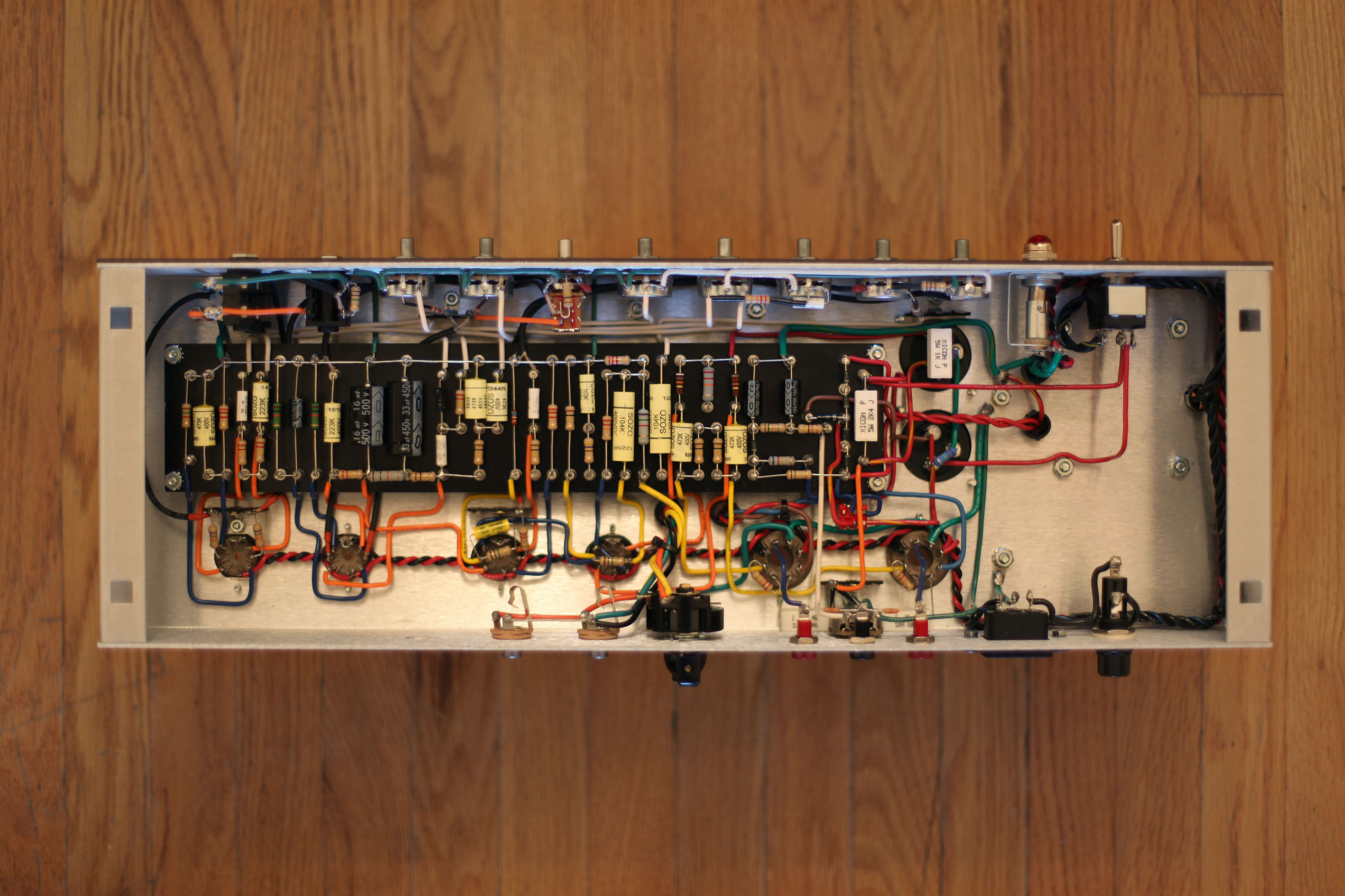

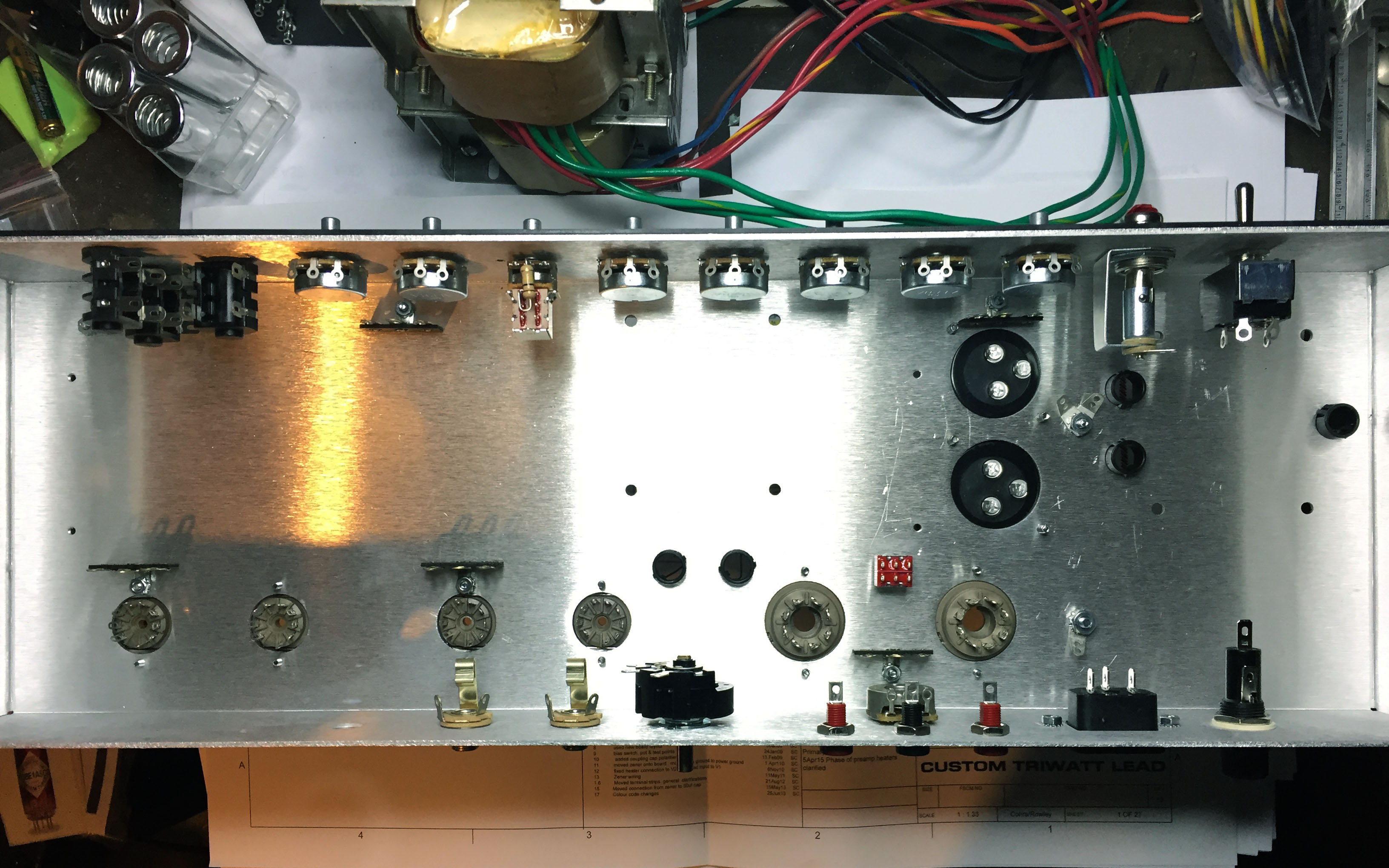

Just starting to dig into a TRIWATT build. Populated the chassis, the manual says 6 terminal strips, I can only see 5 on the wiring diagram. Seems perhaps one was removed from the other side of V1 in this design, revision 19? Any thoughts on input jack orientation? I've set Normal and Bright inputs horizontal and the Link input vertical because that seemed like it would be easier to wire Normal and Bright that way. Looking forward to the rest of the build.

PostPosted: Thu Feb 23, 2017 5:05 pm
Posts: 72

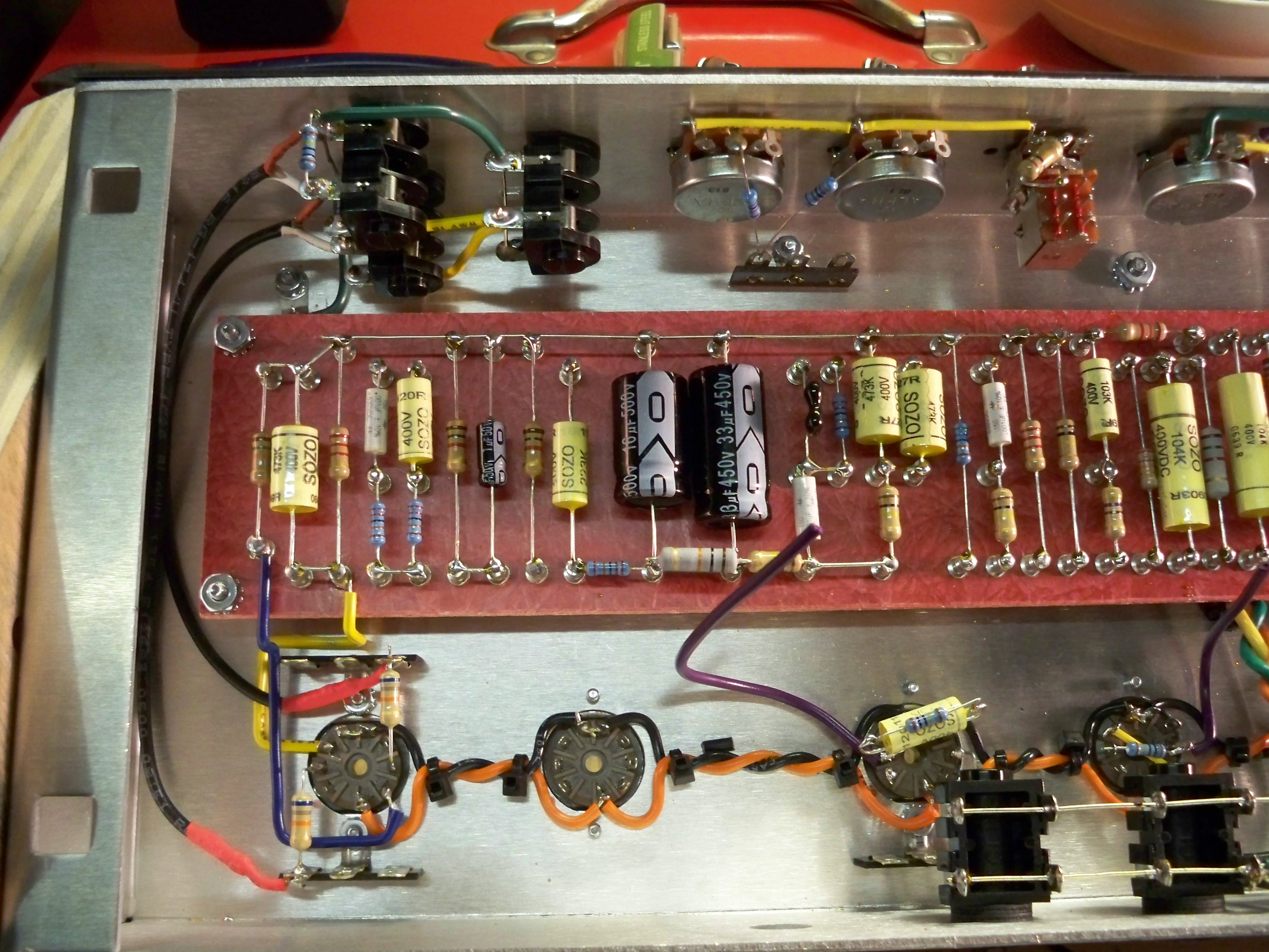

I had two terminal strips attached to the last tube socket. Now it was 6 years ago that I did my build so things might have changed. Hope the photo helps.

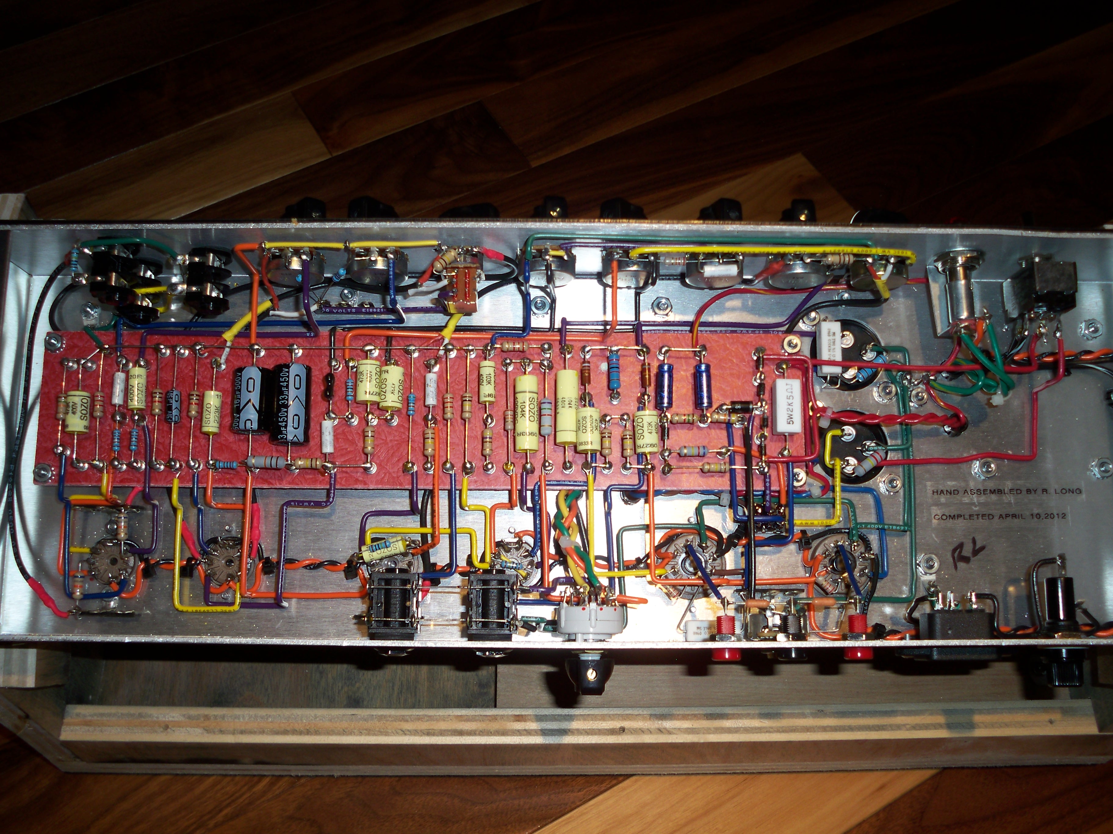

No. I pretty much stuck to exactly what was shown on the layout. My limited knowledge of electronics made me want to stay with the plan. There was some photos from Zaphod that helped a lot. Here's a shot of my result.

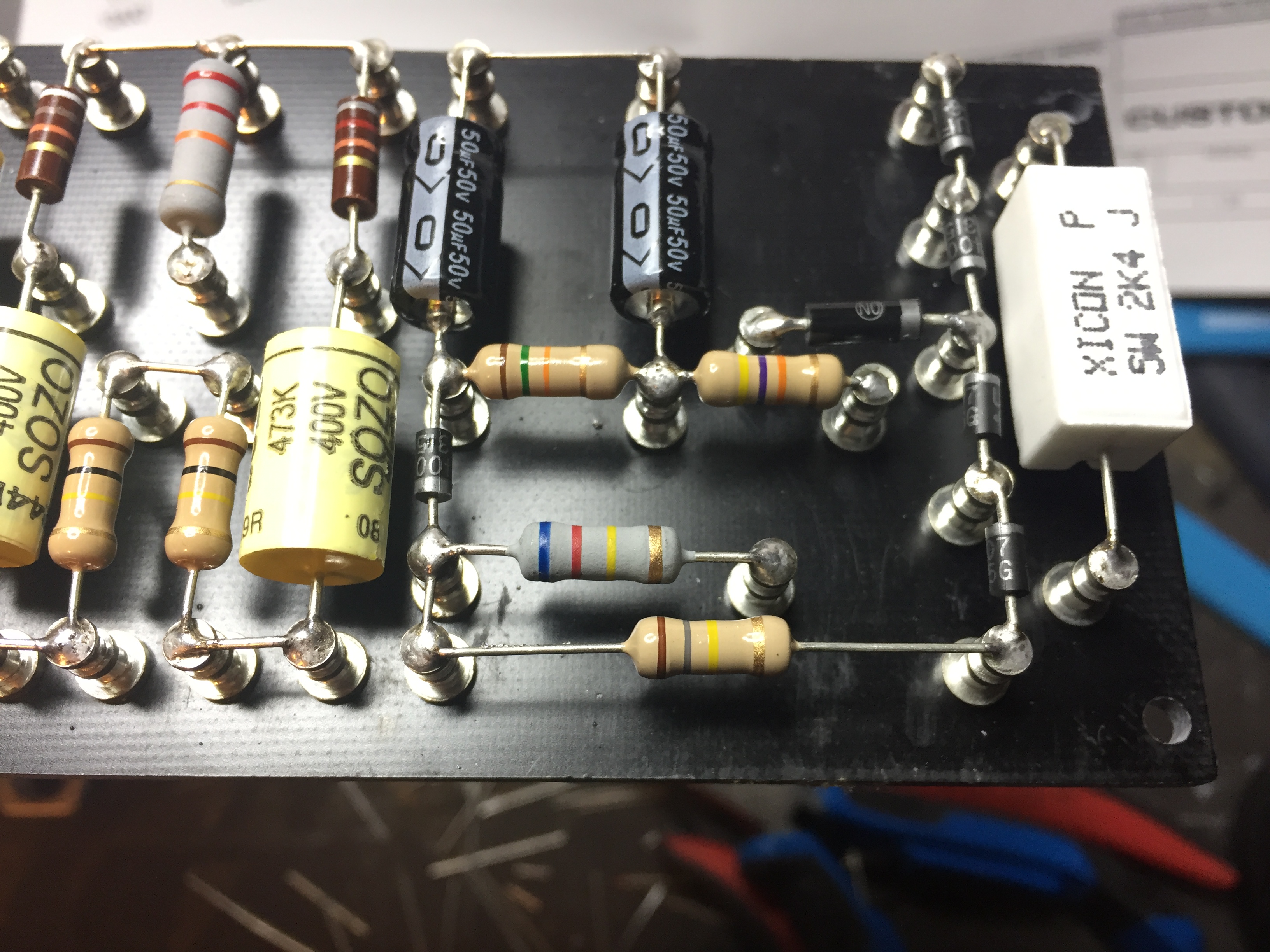

Moving along here, populated the turret board, noticed I don't have a 2W for one of the resistors that calls for 2W, R43 (180K), though the circuit diagram has it at 1W. I assume since the circuit diagram says 1W this is going to be okay?

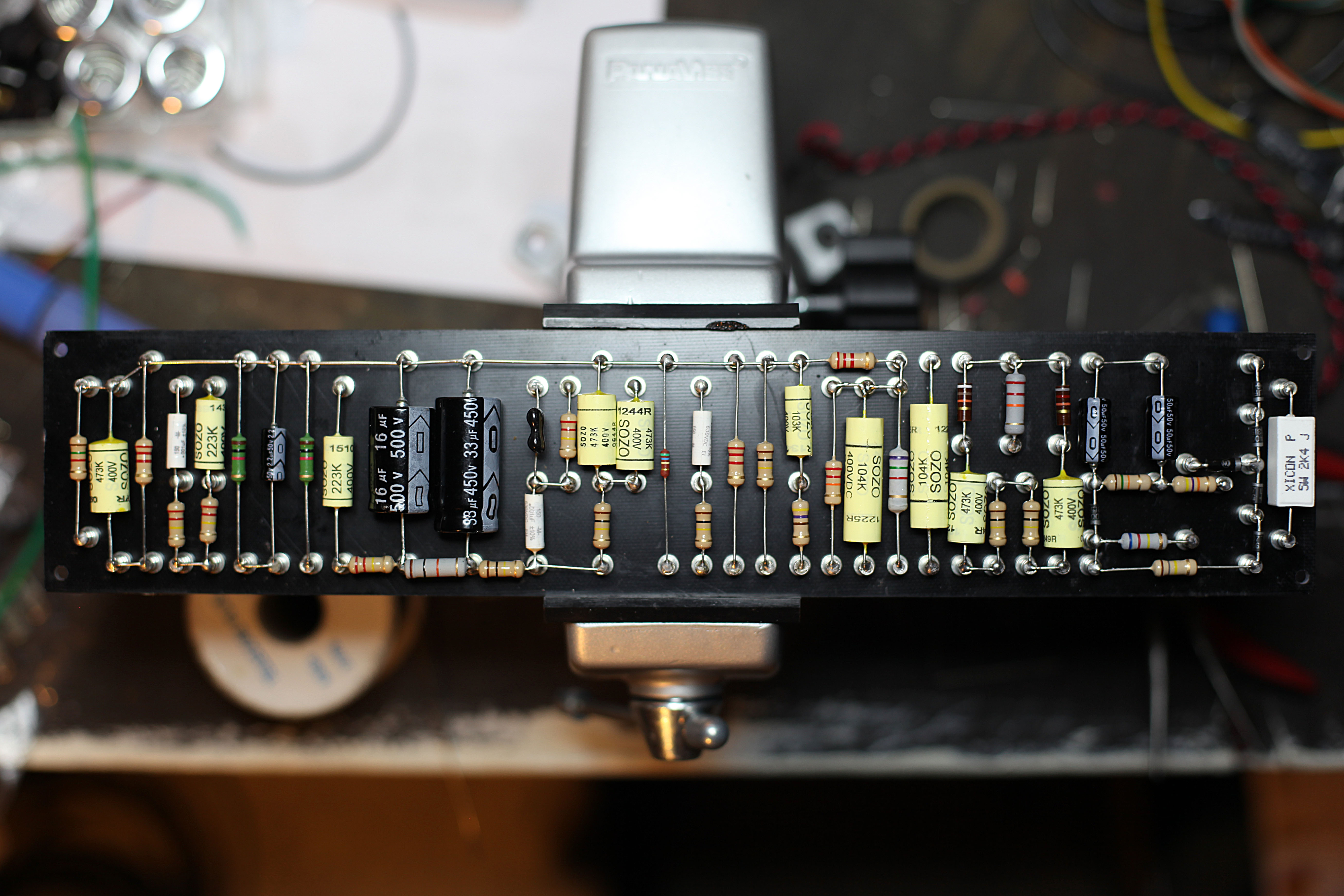

Posts: 58
Here's the board populated.

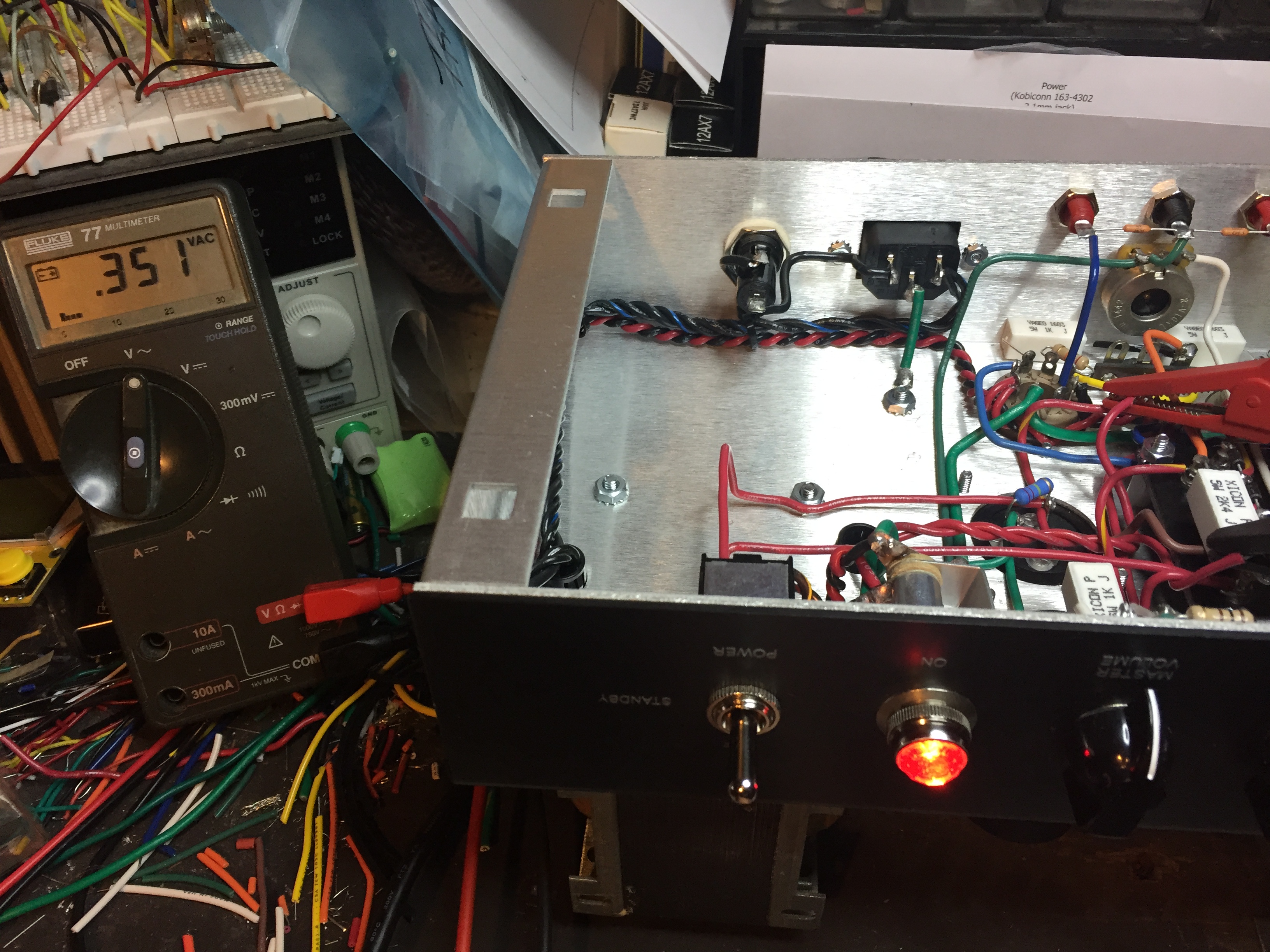

Thanks. Running into some confusion testing the transformers. I hadn't tested them before since it seemed like you needed the board populated to fully test them, so I moved on to that, when I had the board done and in, I forgot to go back before wiring the PT.
Anyhow, trying to test now as the manual instructs. I desoldered the PT hi voltage secondaries from the board (the diodes), both red wires (everything else is still soldered). The pilot lamp came on nice and bright, so I moved on to testing the secondary output, when I test the high voltage secondaries by attaching my meter between them I only get .3 VAC, where should I go from here? The OT is fully wired.
Only reading about 2.5 VAC at the pilot lamp.
I tested the resistance on the PT leads to the pilot lamp before and they were low to ground, but not 0.0, now they're both around .5 ohm to ground (which is probably my probe's resistance).

PostPosted: Tue Apr 18, 2017 10:57 pm
confirm that you have 120 V at the primary leads
PostPosted: Tue Apr 18, 2017 11:01 pm
Posts: 58
With the amp off, the pilot unplugged, when I plug in the power I get about 100 VAC then it falls slowly to about 90 VAC, over the course of 30 seconds or so. I'm getting that across the primary leads past the fuse with the amp on stand-by. I've got primary blue/black striped and black going to one side of the IEC and primary red/black striped and yellow/black striped going to the power switch.
http://amparchives.com
PostPosted: Wed Apr 19, 2017 8:18 am
mains voltage dropping is very strange. i assume your house voltage is stable so might be a bad wire or fuse? still, can you measure the secondary AC and relate it to the mains voltage. You should still be getting high voltages off the secondary reds and closer to 6.3V on the heater/ pilot light
PostPosted: Wed Apr 19, 2017 8:44 am
Posts: 58
Solved. Fluke meter battery was low causing bad VAC readings. I suspected when I realized the only way the mains would drop as soon as I attached the meter is if the meter was causing it, or reading wrong. Phew. Swapped in another 9V and I'm reading 6.4 VAC on the pilot lamp and ~750 VAC or so on the secondary reds -- that's more like it!
