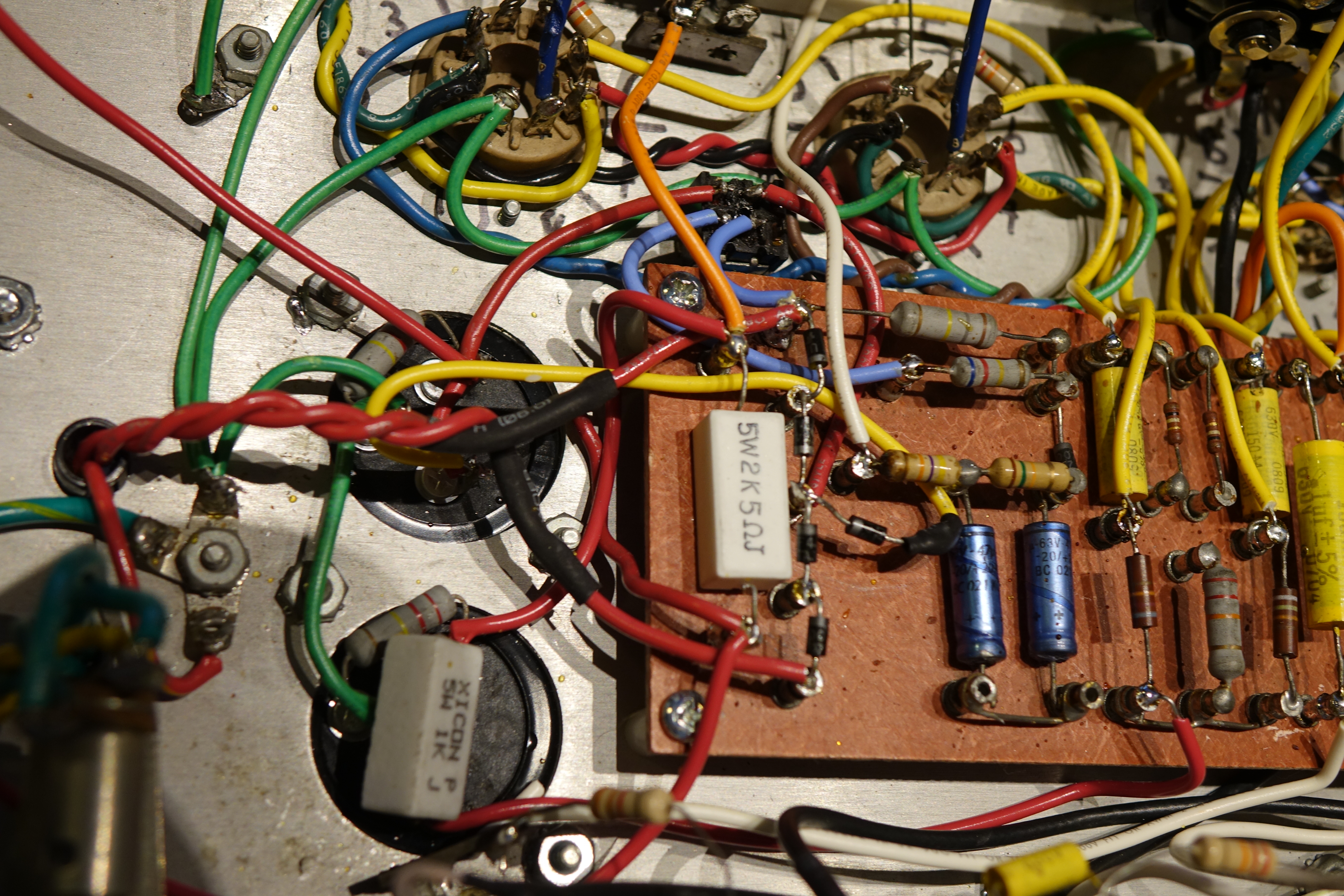

Another funny thing I just discovered, my turret board is different.
There is no eyelet for the 5th zener diode.
Any suggestions as to how to get about that.

 Post subject: Re: Triwatt Revisited.
PostPosted: Tue Apr 03, 2018 5:04 pm
Zener can "fly" between parts or even go on the bias switch (original design intent). Check on the layout where this could be possible. It is for the 6V6 setting only.

A couple of pics from yesterdays efforts.
I know it looks a bit shabby, but its been dormant for 8 years.
However, all solderings are solid, and all the caps still measures.
So it should work. Well see.
Should be able to finish it today.

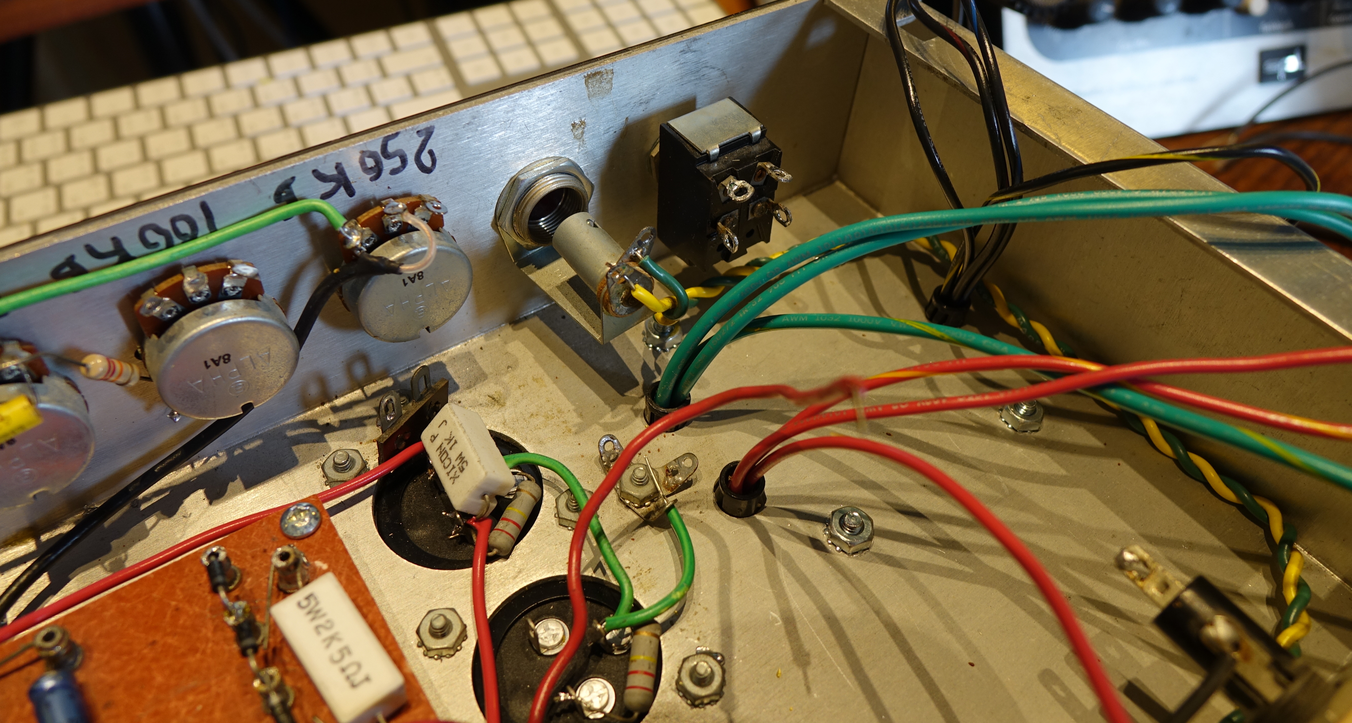

Stephen, do you have a layout for the 240v PT. I am not sure how to solder it.
www.paradisepi.com

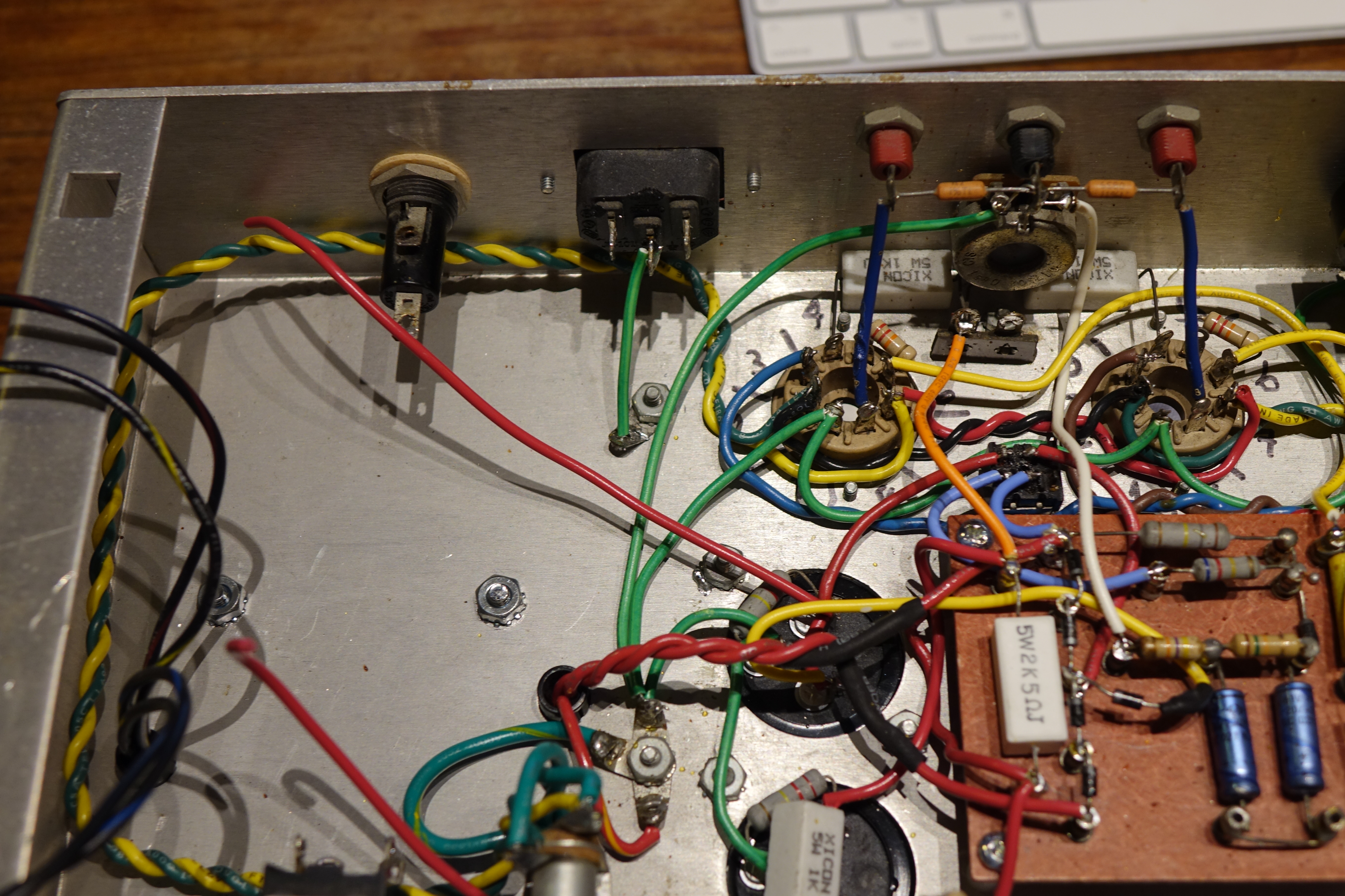

Almost done, just need to wire the PT.
Not the cleanest build, but everything checks out.
All the resistors, resists....
Some pics. Let me know if you spot something odd.
PostPosted: Thu Apr 05, 2018 4:14 am
Posts: 112
Location: Bangkok
Has anybody here wired 240V PT.
Then I would really like to know you wired it.
Cause I am not sure.
www.paradisepi.com
PostPosted: Thu Apr 05, 2018 5:30 am
Posts: 112
Location: Bangkok
Also, i should mention, i used layout rev 20, which is a bit different.
The OT wiring is different, so i hope i did it right.
www.paradisepi.com
PostPosted: Thu Apr 05, 2018 8:42 pm
Looks like you got the OT wiring right. But in an amp that uses negative feedback, there's always a chance the phase might be wrong and it will oscillate like crazy. If that's the case just reverse the blue and brown wires that connect to the anodes of the output tubes.
I have never built a Triwatt, let alone one wired for 240 volts, but looking at the schematic I'd say the 240-volt wiring for the PT primary would be:
Live (from power switch) to Black-Red, Neutral (from IEC connector) to Black, and connect Black-Blue and Black-Yellow together.
PostPosted: Thu Apr 05, 2018 10:05 pm
The P T wiring is correct. Check on the power switch how the contact work. one side is power swithc, the other is standby. Do you jave the latest manual. I noticed it was not posted. I will fix that.

Ok, so heres the PT wiring.
Black-Blue and Black-Yellow, are tied together and soldered.
Black-red goes to the Power switch, upper left.
And Black goes to IEC Negative.
Stephen, please conform that this is right for 240V
PostPosted: Fri Apr 06, 2018 10:59 am
nickkbh wrote:
Ok, so I fired it up with my bulb device.
Nothing blew up, but before I could start measuring, I broke the second probe cable in a week, and I dont have a spare, haha.
Wont get a new one until tomorrow, so I will wait until then to test further.
But something is still wrong, as I couldn't get an even bias on the KT66 I have. The only thing I managed to probe before the cable broke.
Without tubes in, you should get a negative voltage on the bias feed to the power tubes. Remove the tubes and confirm you are getting that, and that it changes when you move the bias pot. Confirm the bias goes to the correct location on the board as well.
