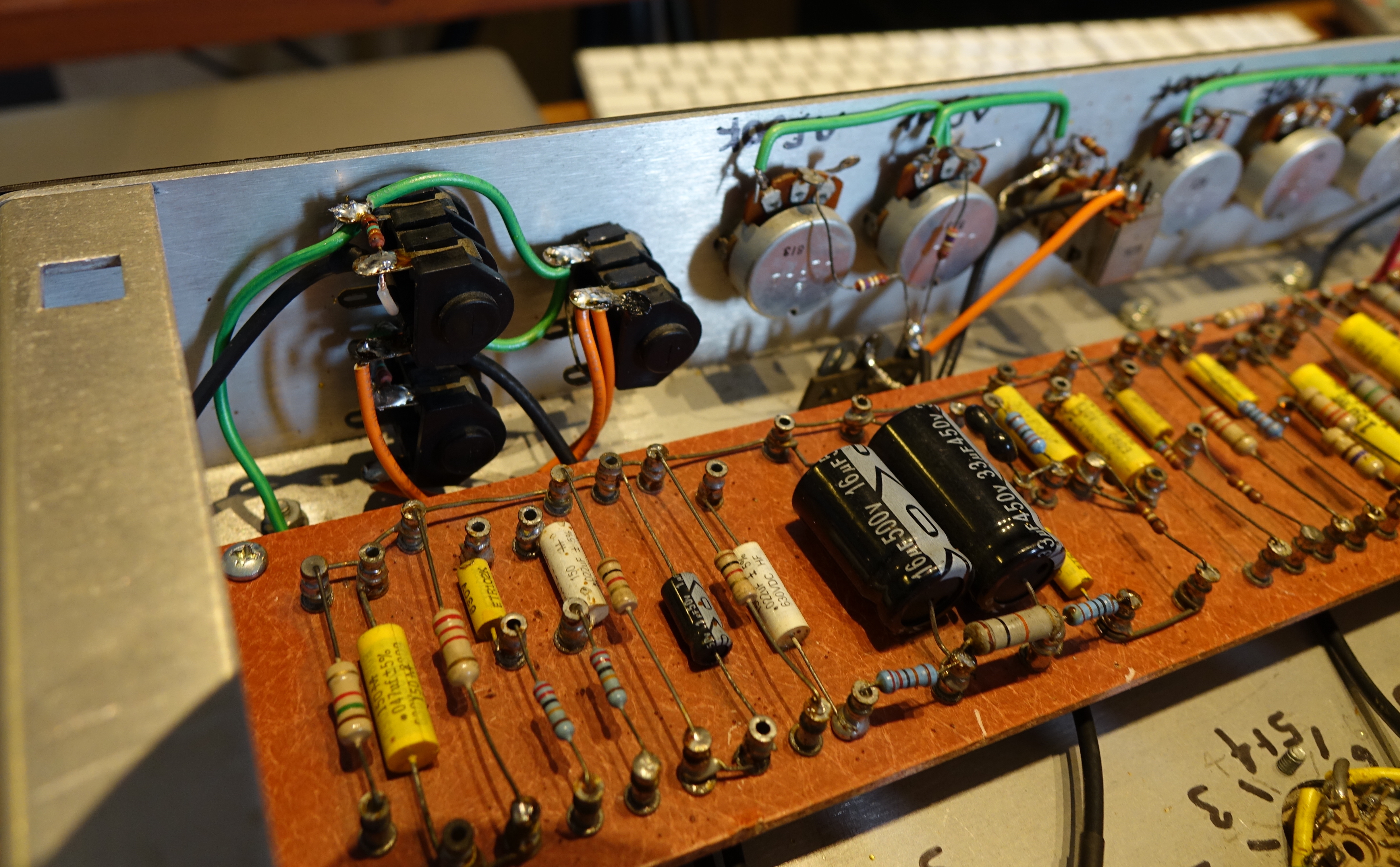

Another question.
I am checking everything from scratch, desoldering most.
But I am having some doubt on which way to solder the caps.
My caps are not same as you have posted here
viewtopic.php?f=14&t=3734
which are all sozo caps, so I am not sure.
I do assume though, that the right side, according to the text on the caps are +
Please see attached picture.
www.paradisepi.com

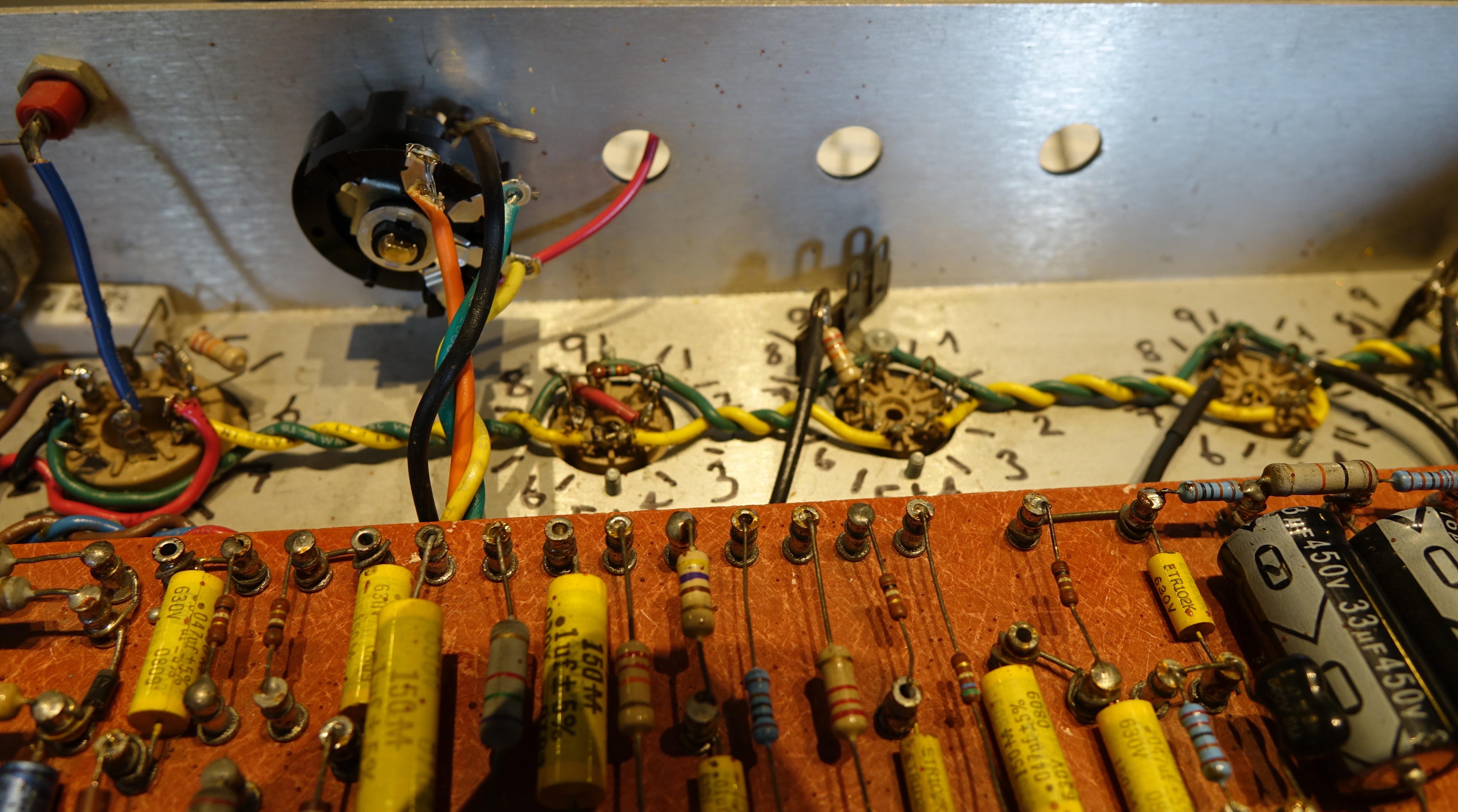

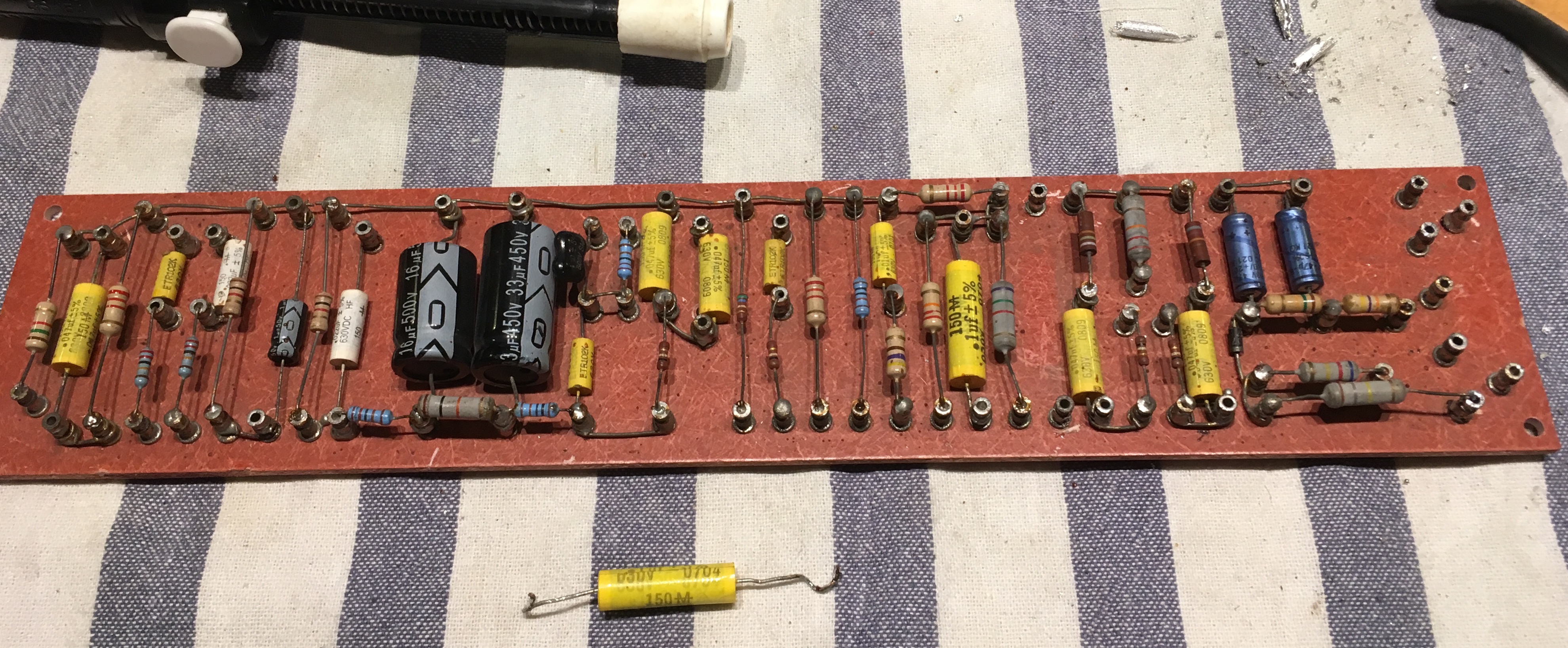

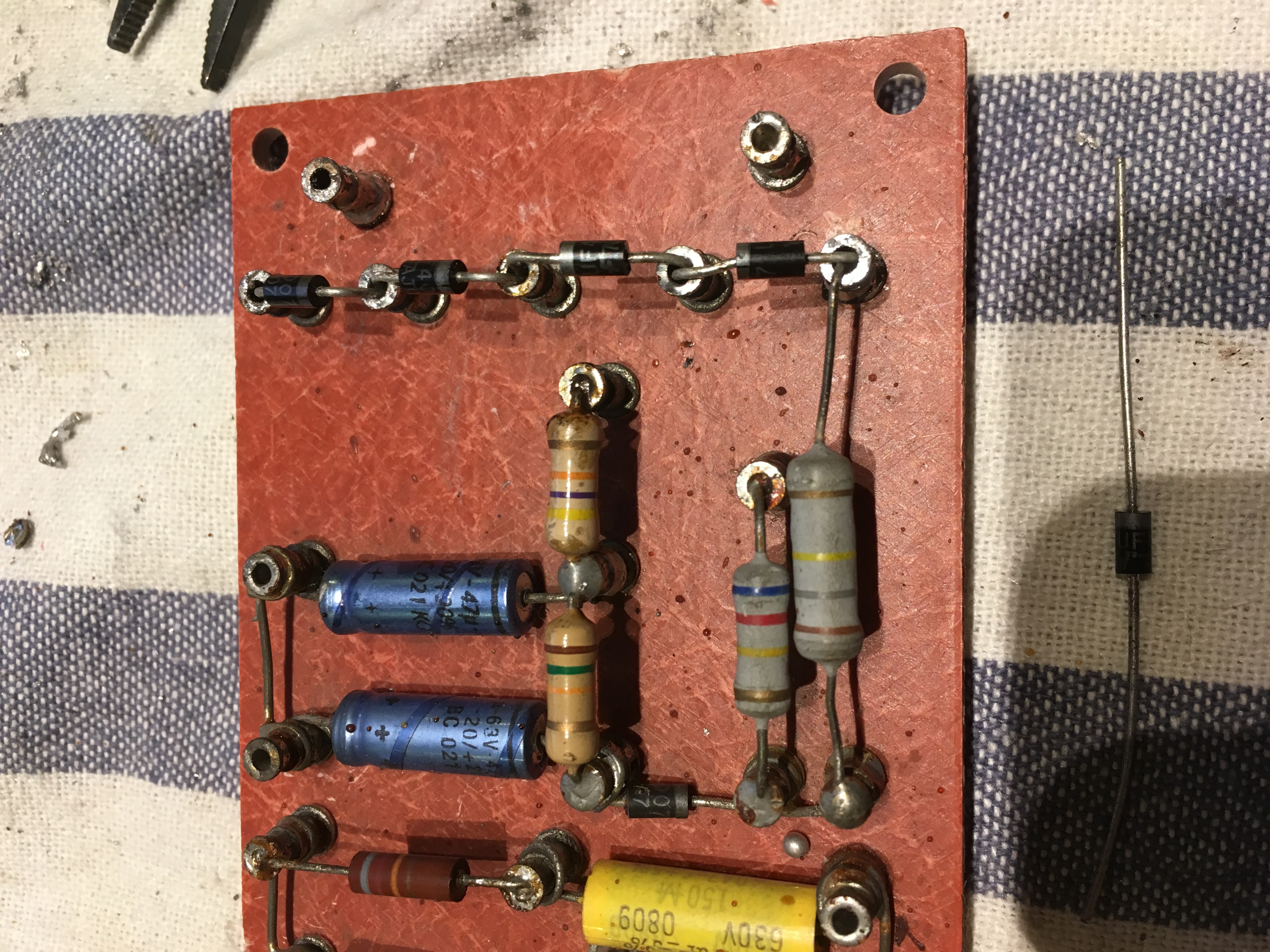

Another funny thing I just discovered, my turret board is different.
There is no eyelet for the 5th zener diode.
Any suggestions as to how to get about that.
www.paradisepi.com
 Post subject: Re: Triwatt Revisited.
PostPosted: Tue Apr 03, 2018 5:04 pm
Zener can "fly" between parts or even go on the bias switch (original design intent). Check on the layout where this could be possible. It is for the 6V6 setting only.
My caps are not same as you have posted here which are all sozo caps, so I am not sure.
Only electrolytic caps are polarized with a + marking. Typically over 1uF values.
The coupling caps (.022, .047 etc. ) are Mallory, not Sozo, in your case and it doesn't matter which way they go in.
Ok, But how should I do it. Should I drill a hole, or what. I have a set of Genalex Gold Lion KT66 waiting.

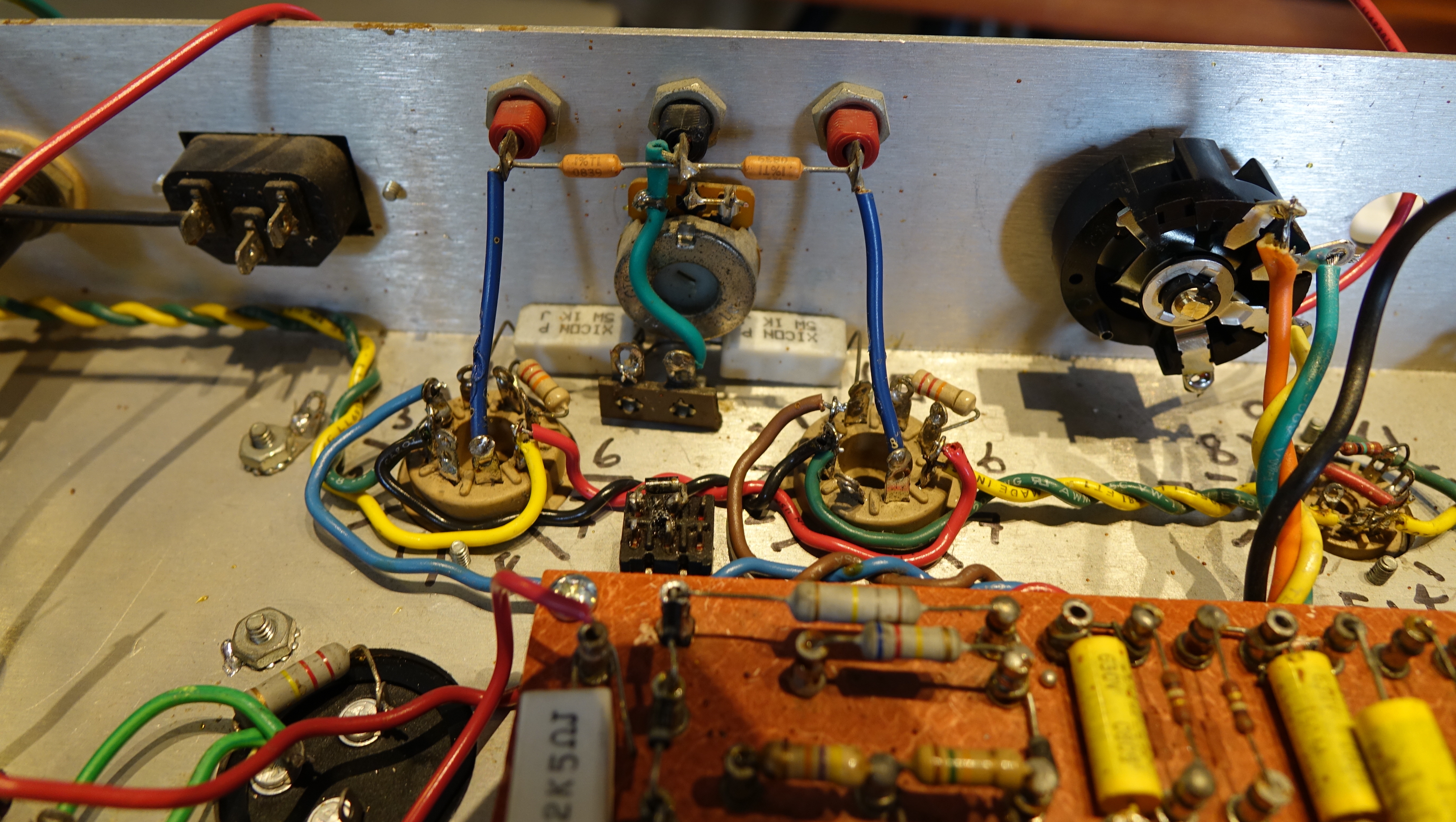

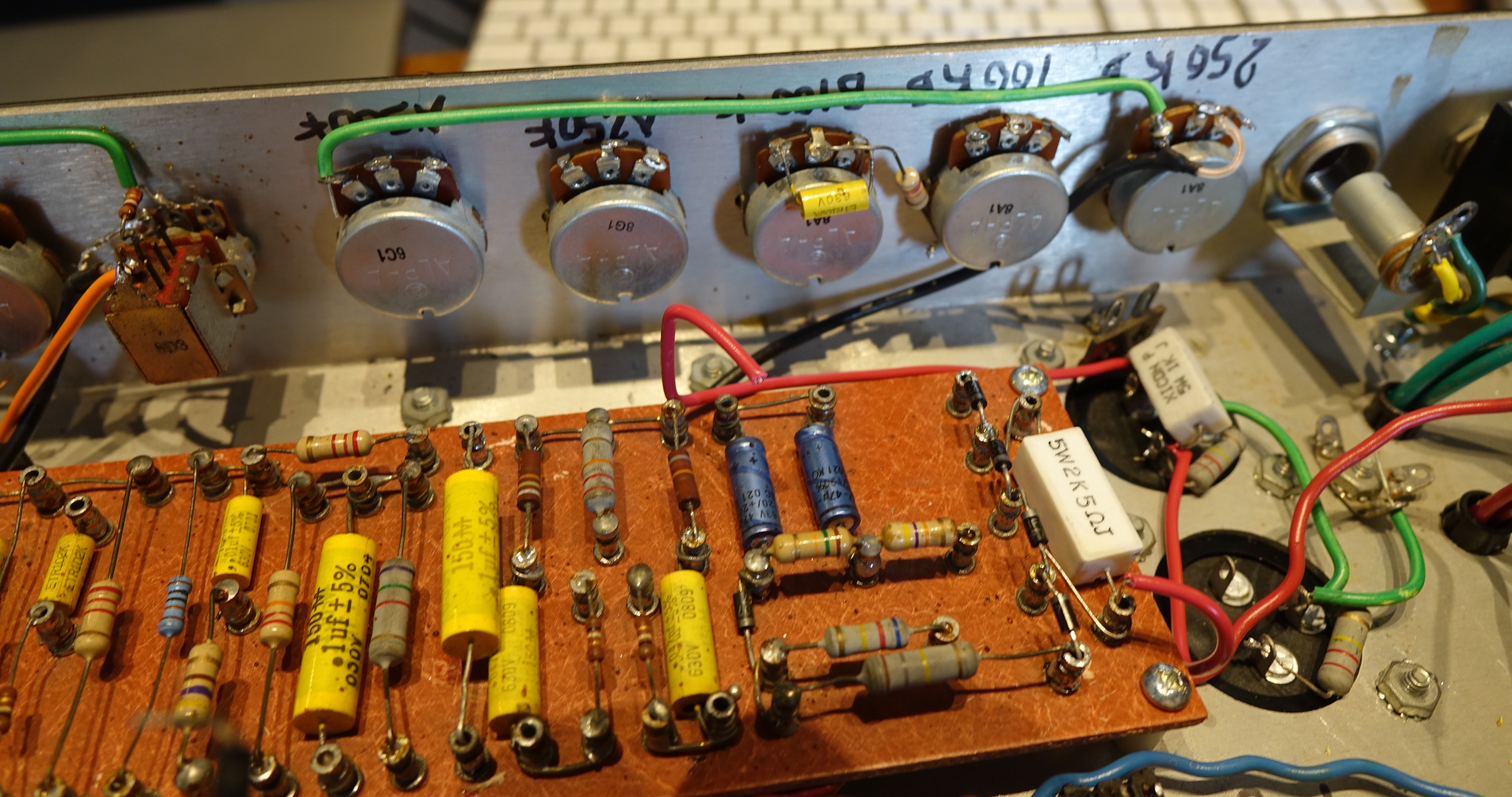

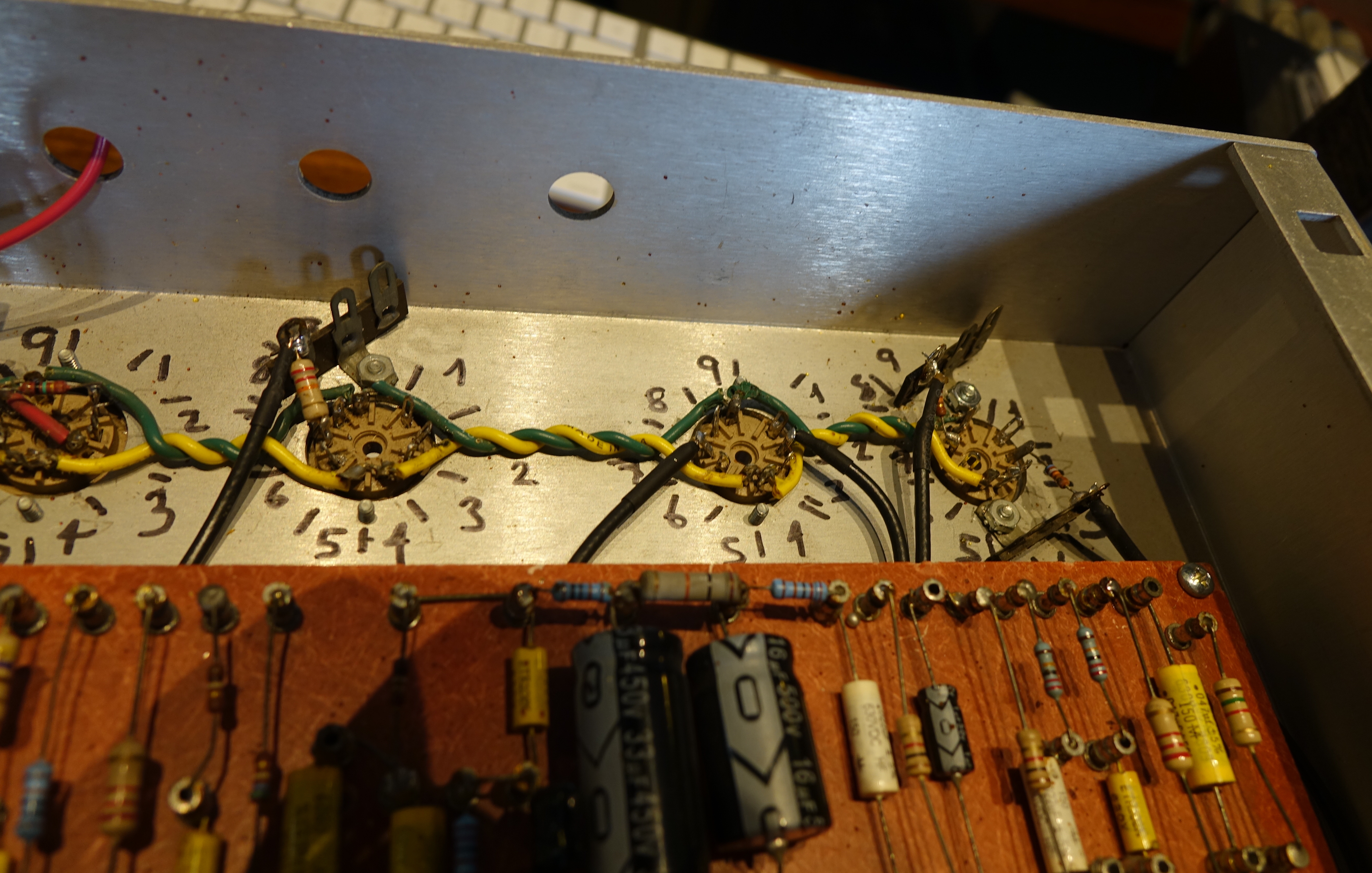

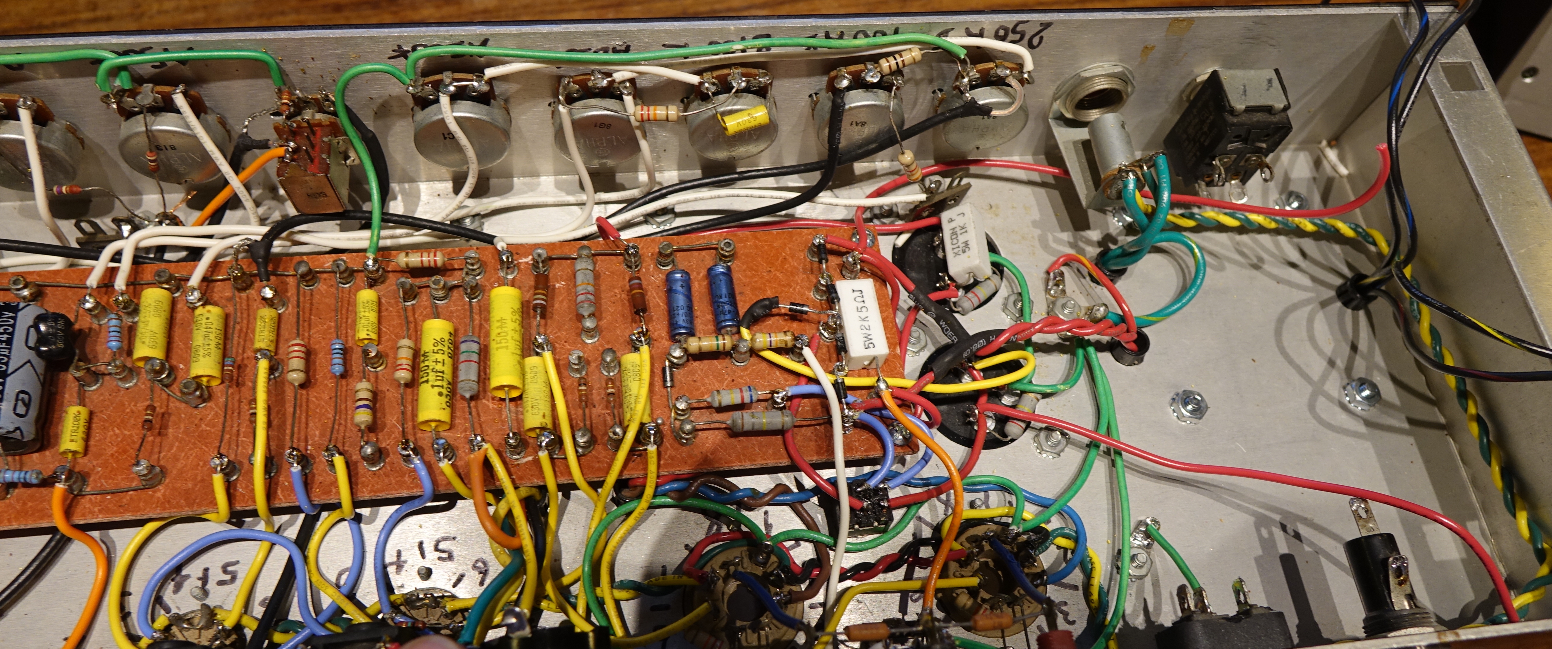

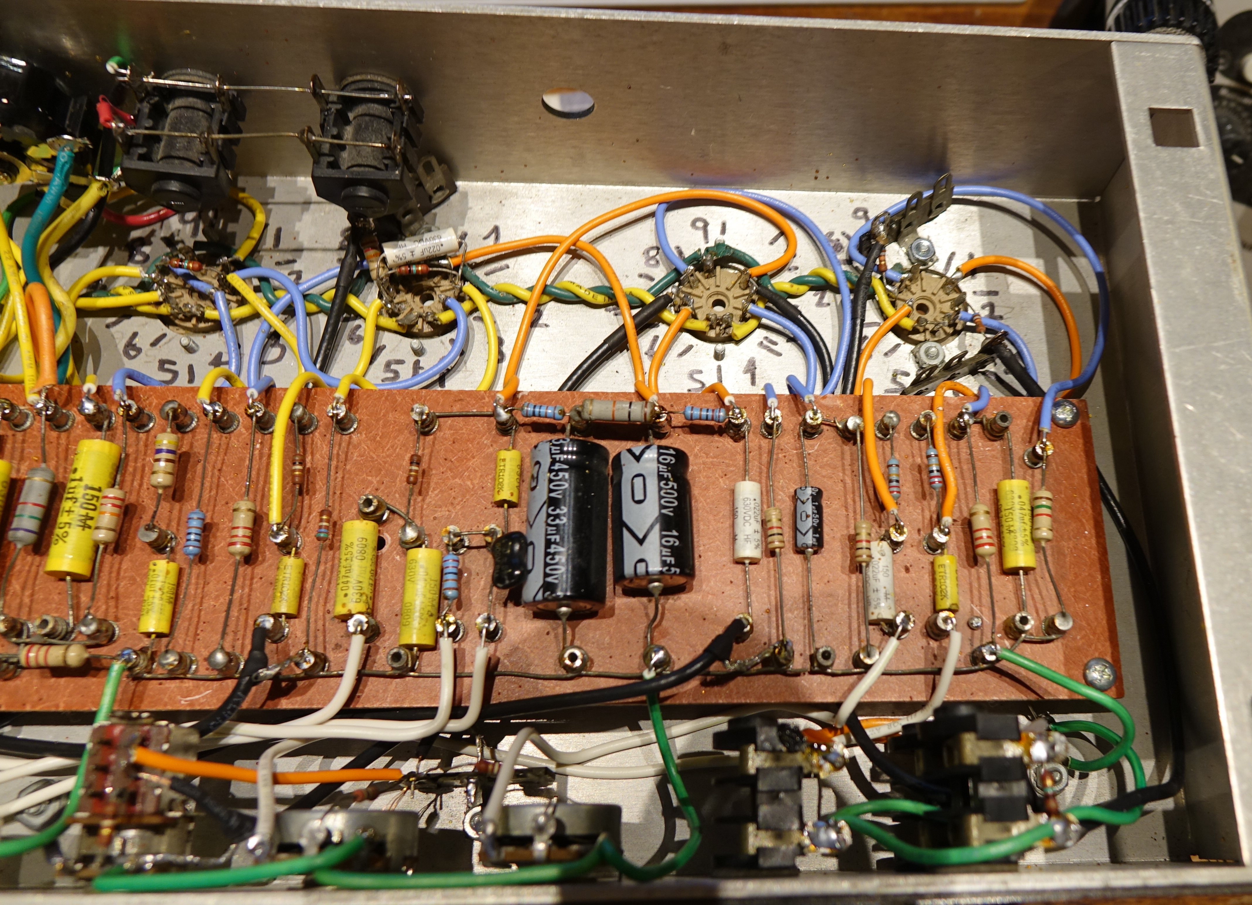

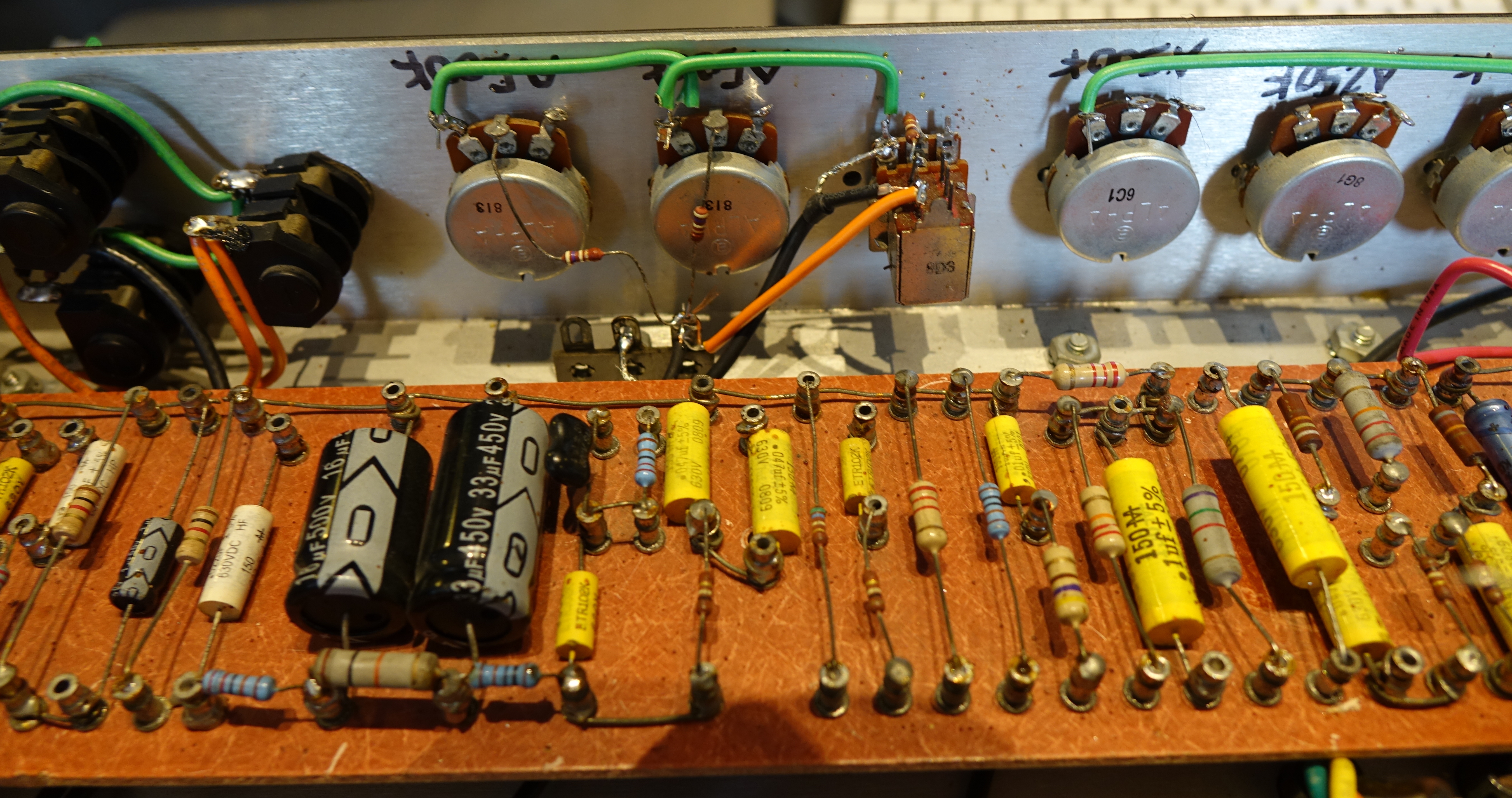

A couple of pics from yesterdays efforts.
I know it looks a bit shabby, but its been dormant for 8 years.
However, all solderings are solid, and all the caps still measures.
So it should work. Well see.
Should be able to finish it today.

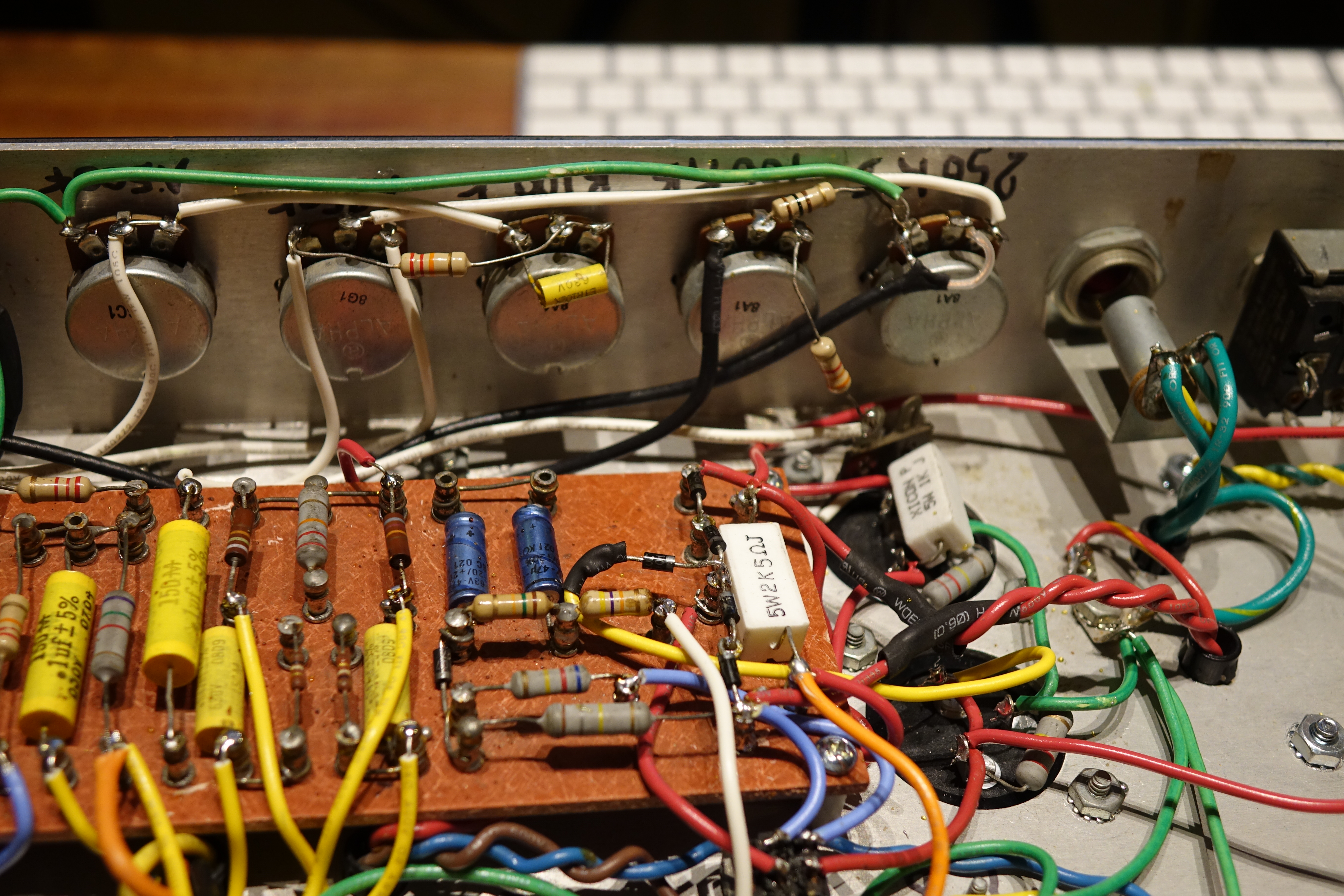

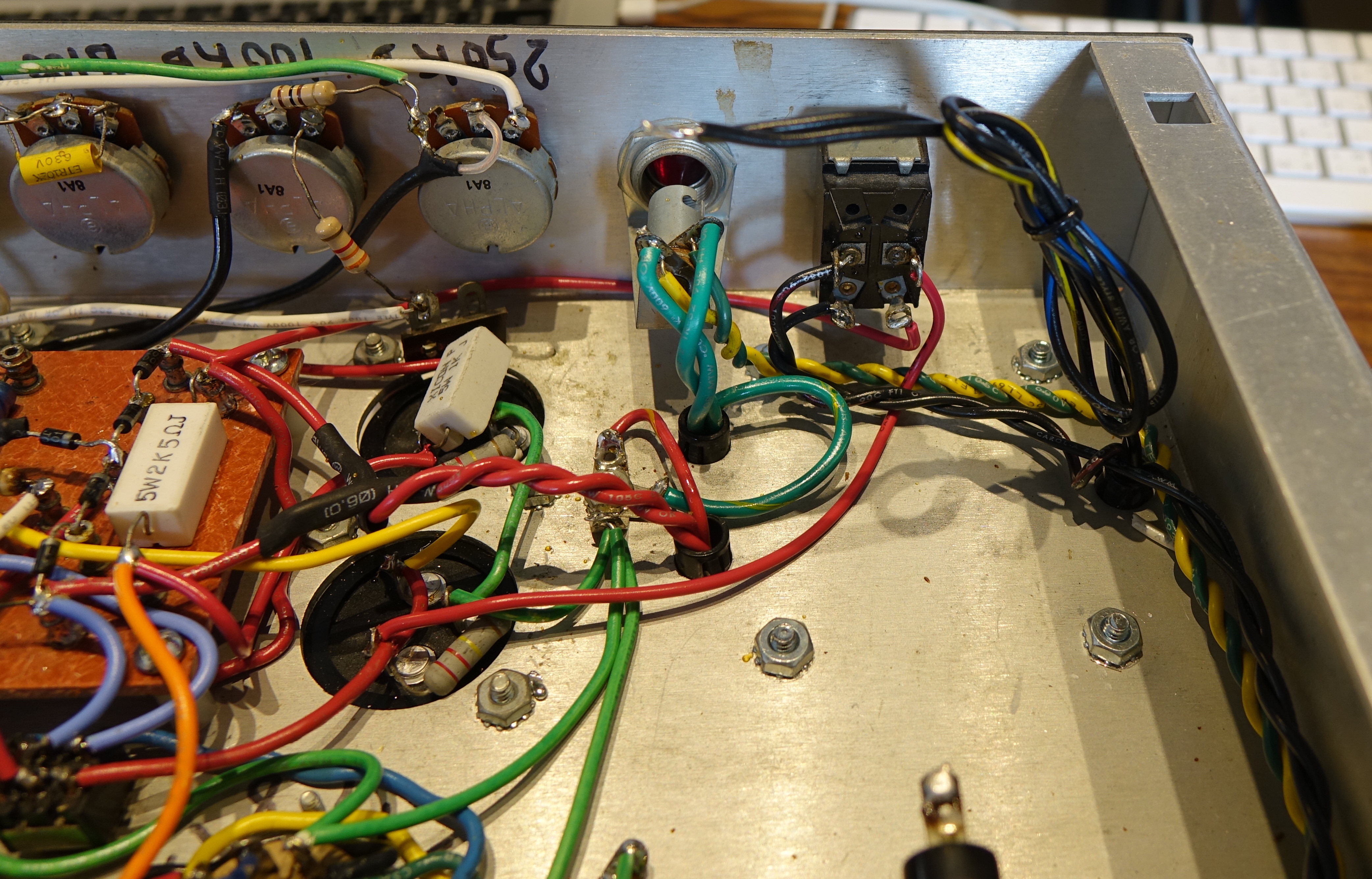

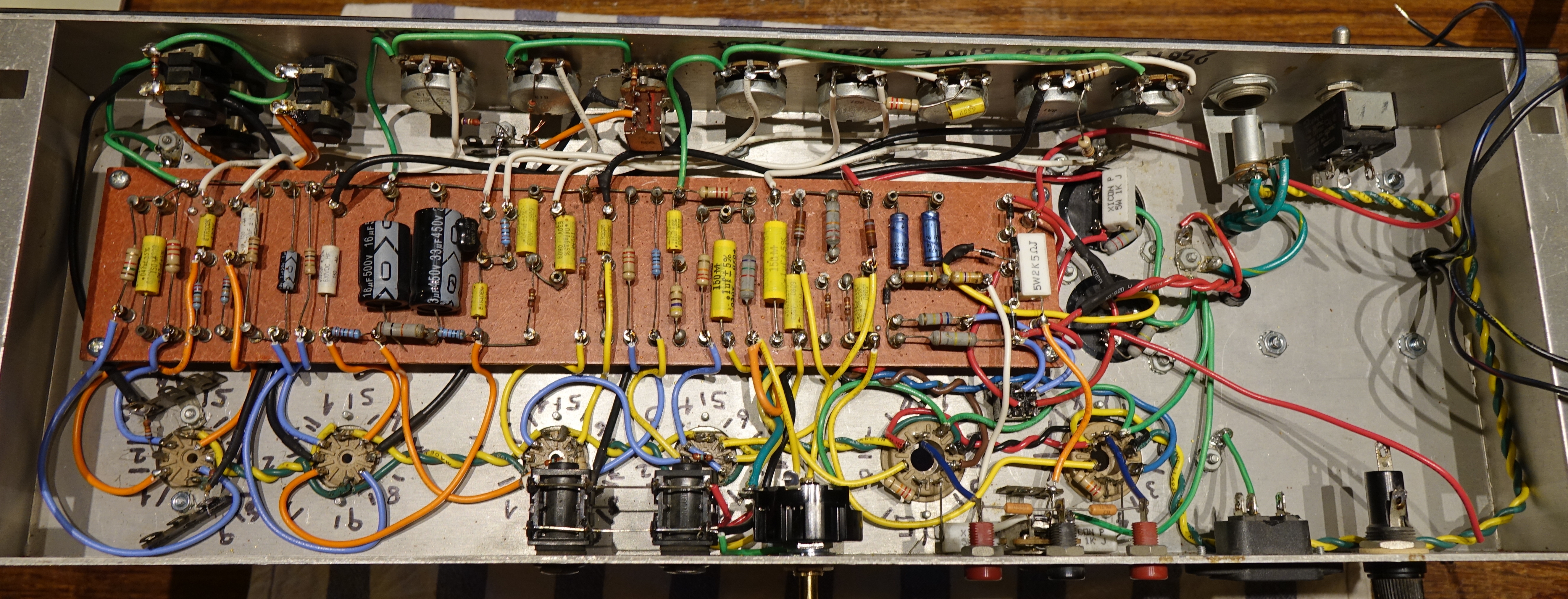

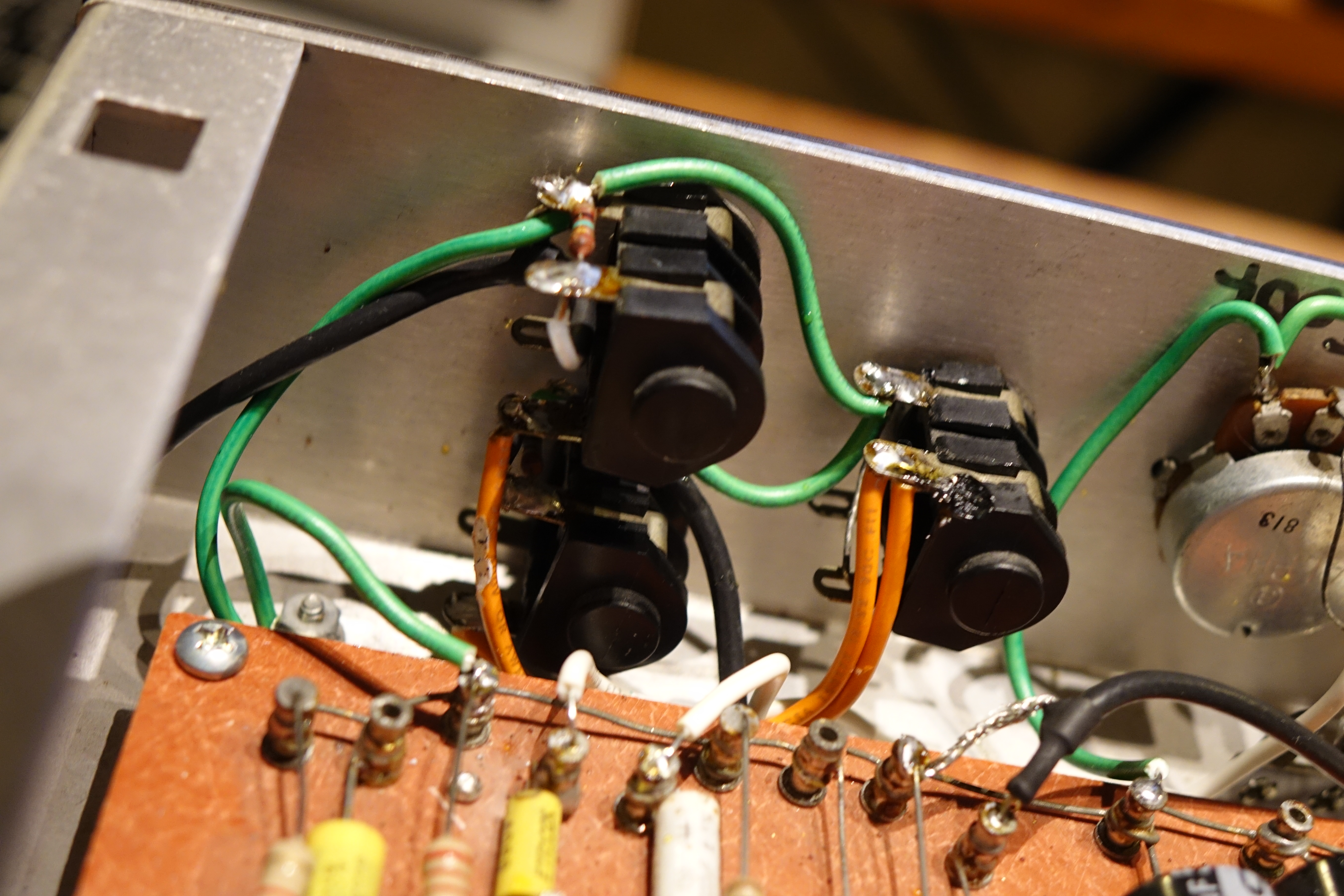

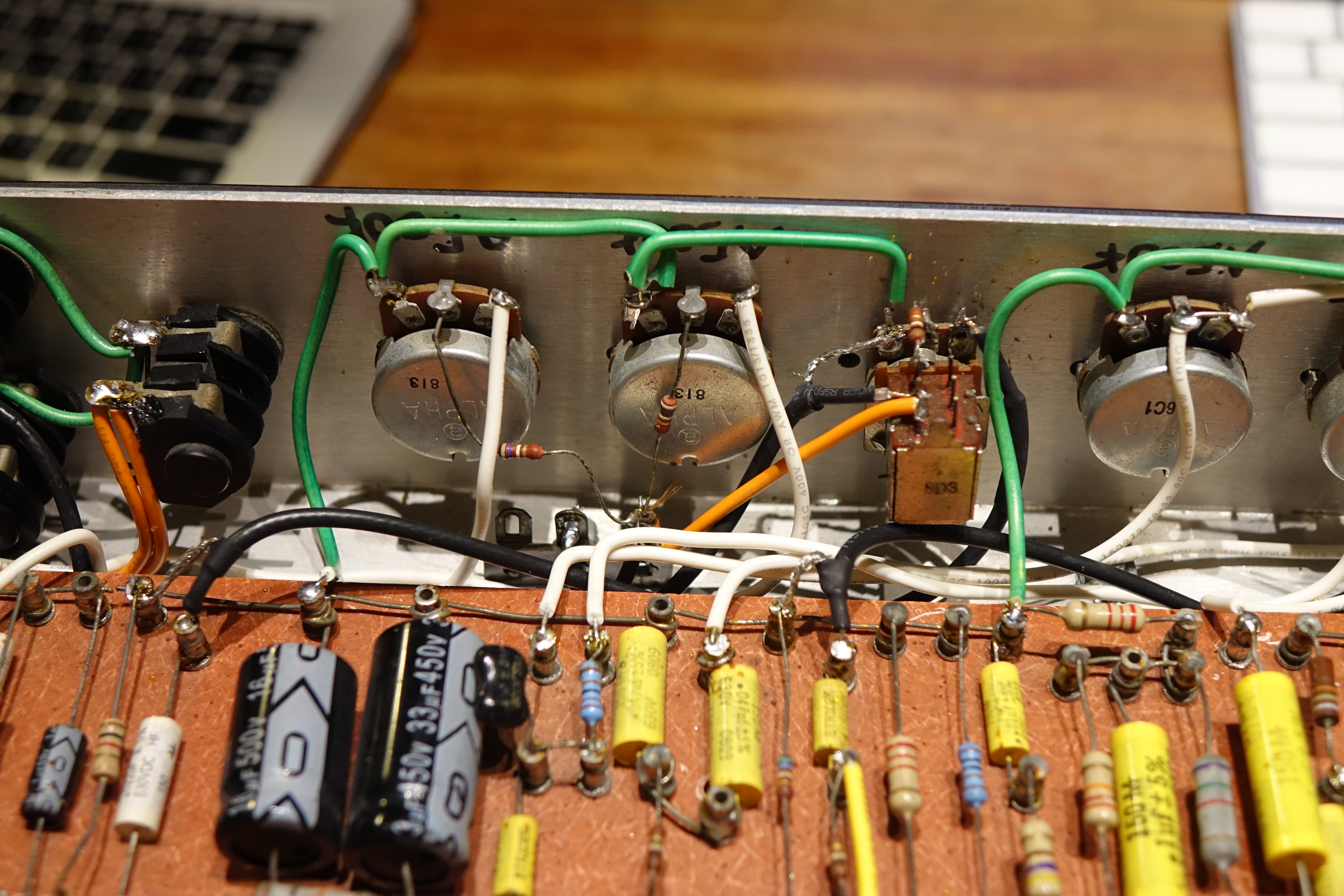

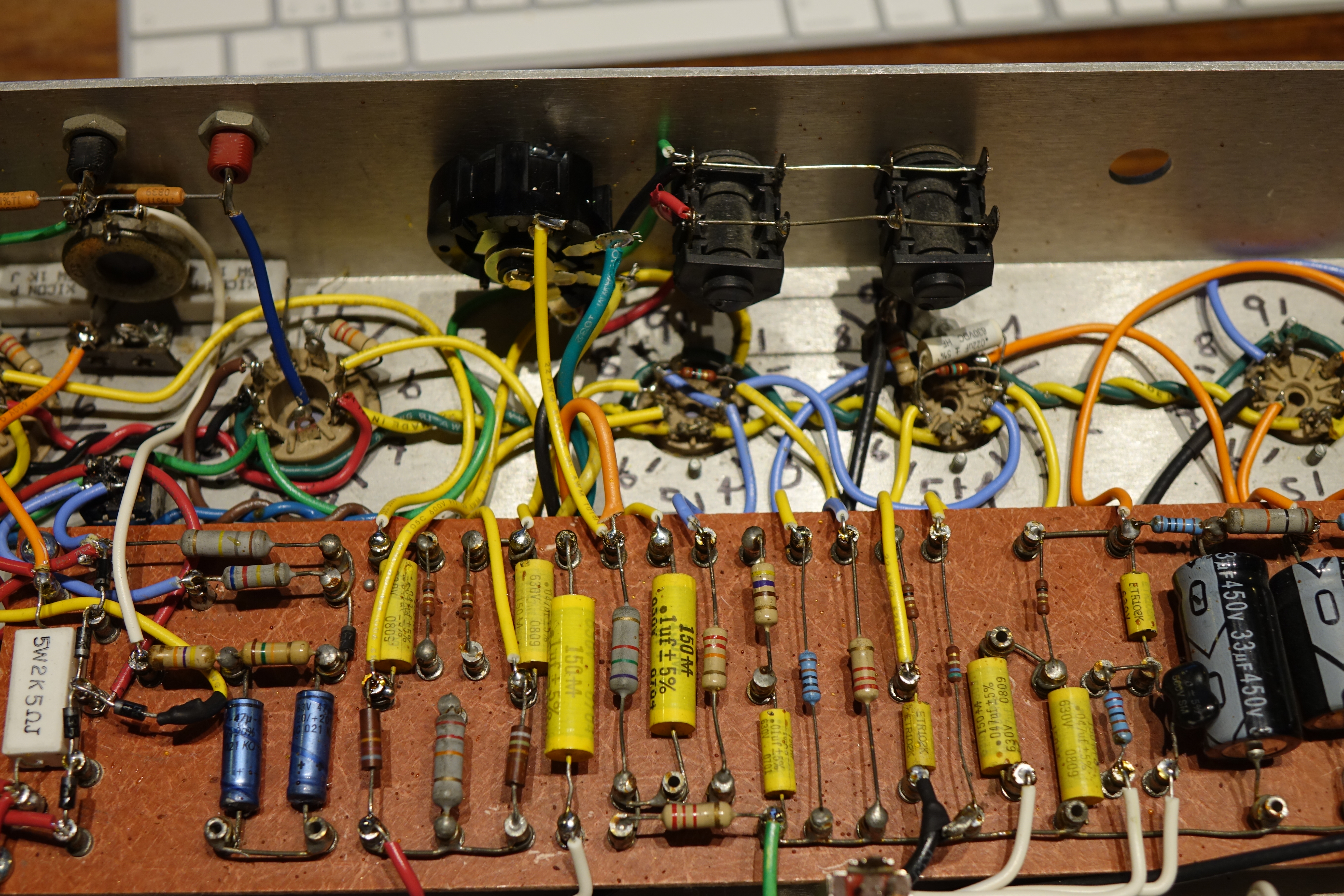

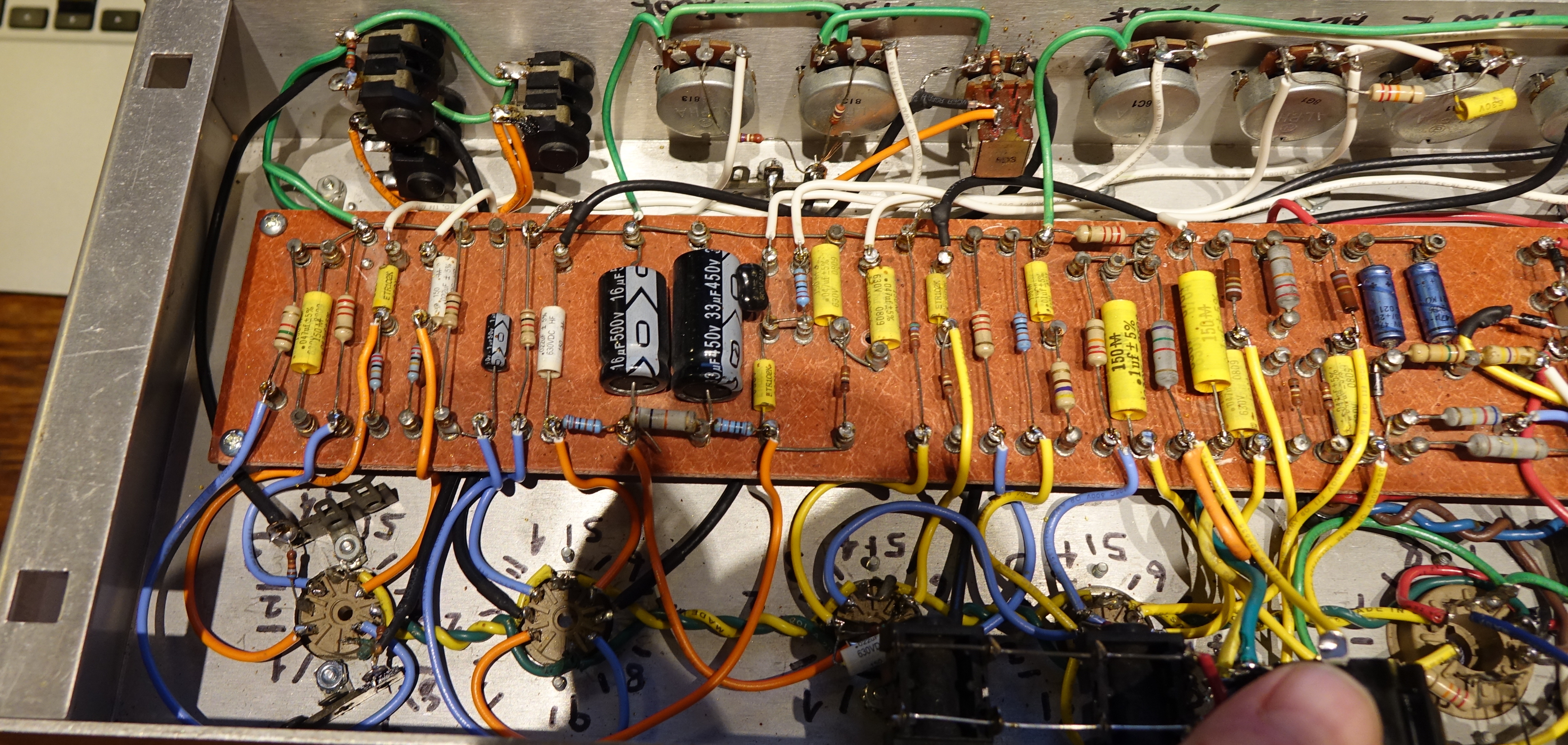

Almost done, just need to wire the PT.
Not the cleanest build, but everything checks out.
All the resistors, resists....
Some pics. Let me know if you spot something odd.
PostPosted: Thu Apr 05, 2018 8:42 pm
Looks like you got the OT wiring right. But in an amp that uses negative feedback, there's always a chance the phase might be wrong and it will oscillate like crazy. If that's the case just reverse the blue and brown wires that connect to the anodes of the output tubes.
I have never built a Triwatt, let alone one wired for 240 volts, but looking at the schematic I'd say the 240-volt wiring for the PT primary would be:
Live (from power switch) to Black-Red, Neutral (from IEC connector) to Black, and connect Black-Blue and Black-Yellow together.

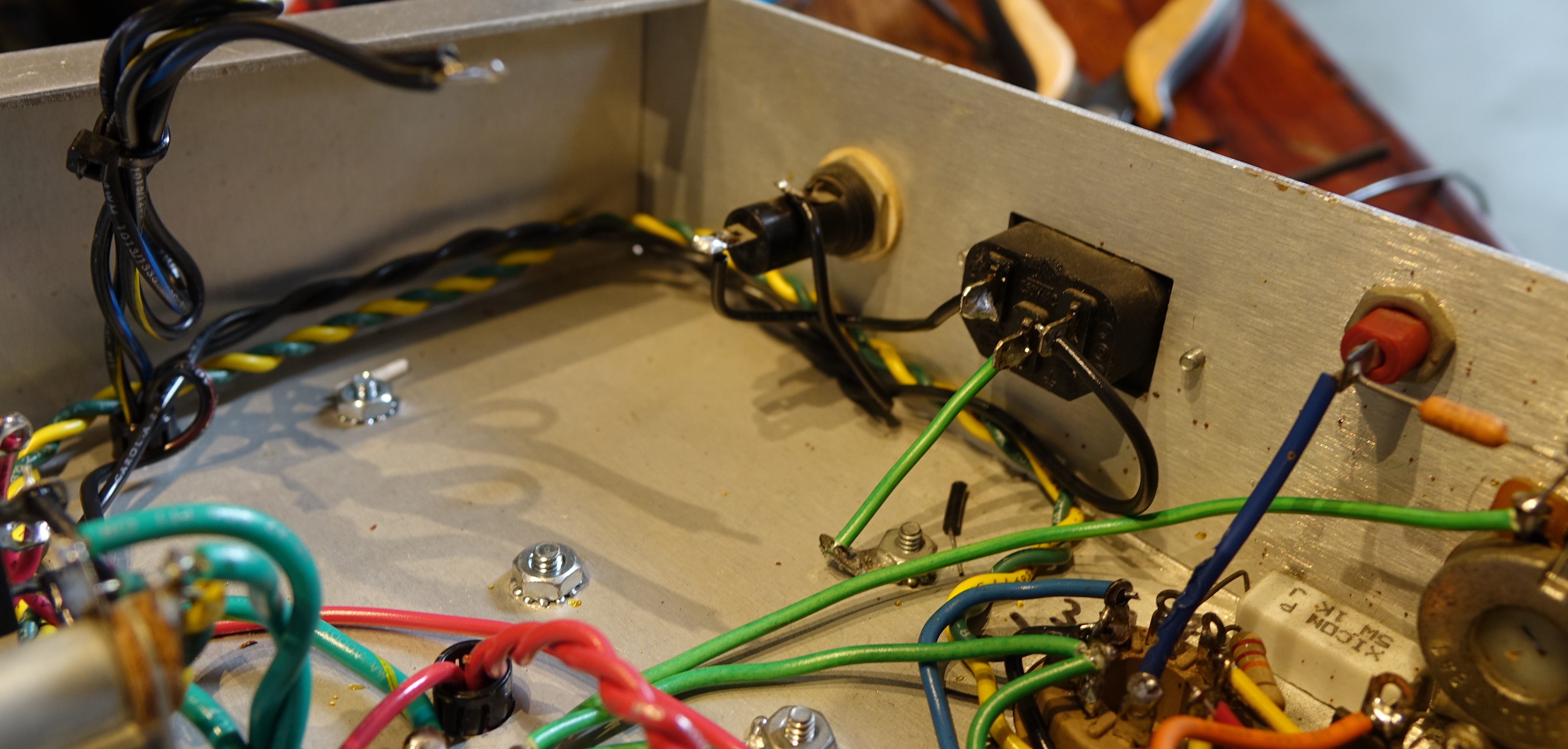

PostPosted: Thu Apr 05, 2018 10:05 pm
The P T wiring is correct. Check on the power switch how the contact work. one side is power swithc, the other is standby. Do you jave the latest manual. I noticed it was not posted. I will fix that.

Ok, so heres the PT wiring.
Black-Blue and Black-Yellow, are tied together and soldered.
Black-red goes to the Power switch, upper left.
And Black goes to IEC Negative.
Stephen, please conform that this is right for 240V
