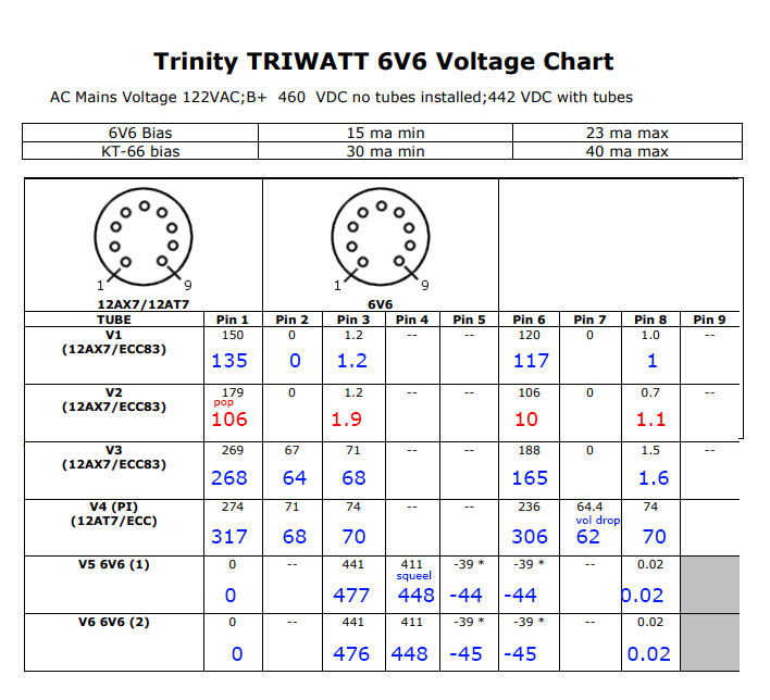

Finally got around to pulling this amp and checking voltages, something definitely up with V2.

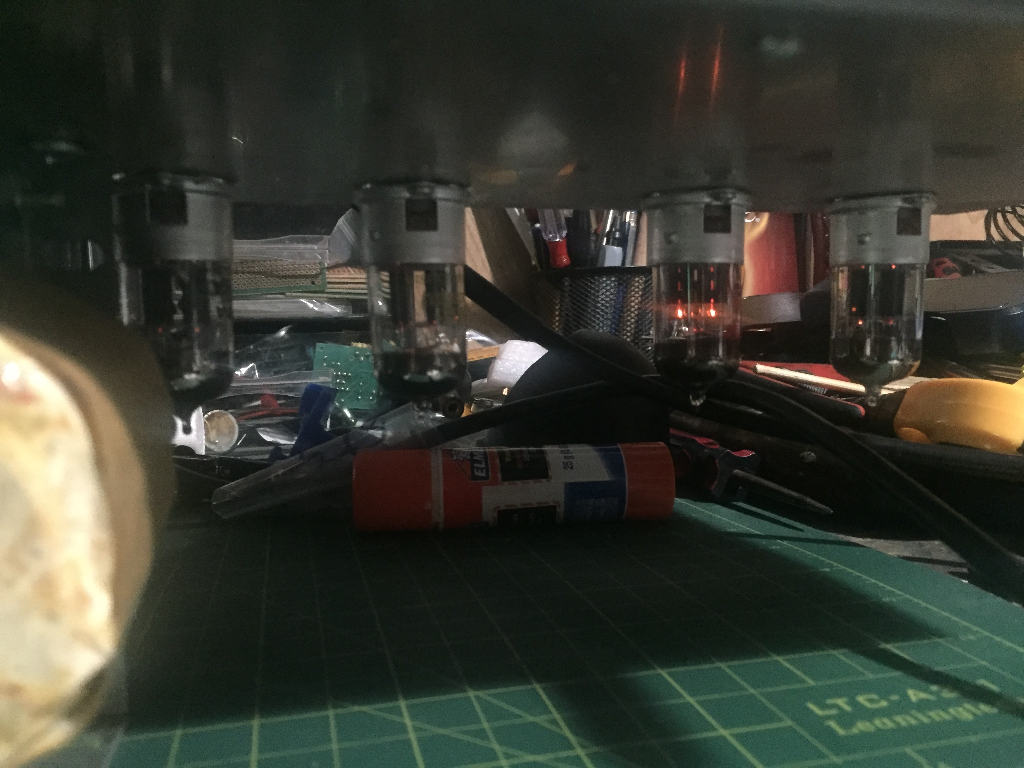

Hrm, replaced V2 and I got my volume back but V2 is glowing maybe a little too much? Here are V2 voltages after the tube swap,

Anything to be worried about with these readings, or the glow? V4 seems quite a bit off (by 70 VDC on Pin 6).

PostPosted: Sun Aug 18, 2019 12:23 pm
You might want to check the value of the 1K cathode resistor. 1.6V is quite high compared to the sheet.
Touch up the solder joints there. Rest looks OK.
PostPosted: Sun Aug 18, 2019 2:56 pm
Posts: 58
Cathode resistors test fine. Preamp tubes are a mismatch of brands and ages now. Does it make any sense that the 12AT7 on V4 would go, I swapped that out for a 12AX7 and then V2 seemed to have gone, now I've swapped V2 for a 12AX7 and I've got volume back but I'm concerned I'm just going to burn through tubes. I'll give it a run through on the bench here at operating temp and see what happens.
