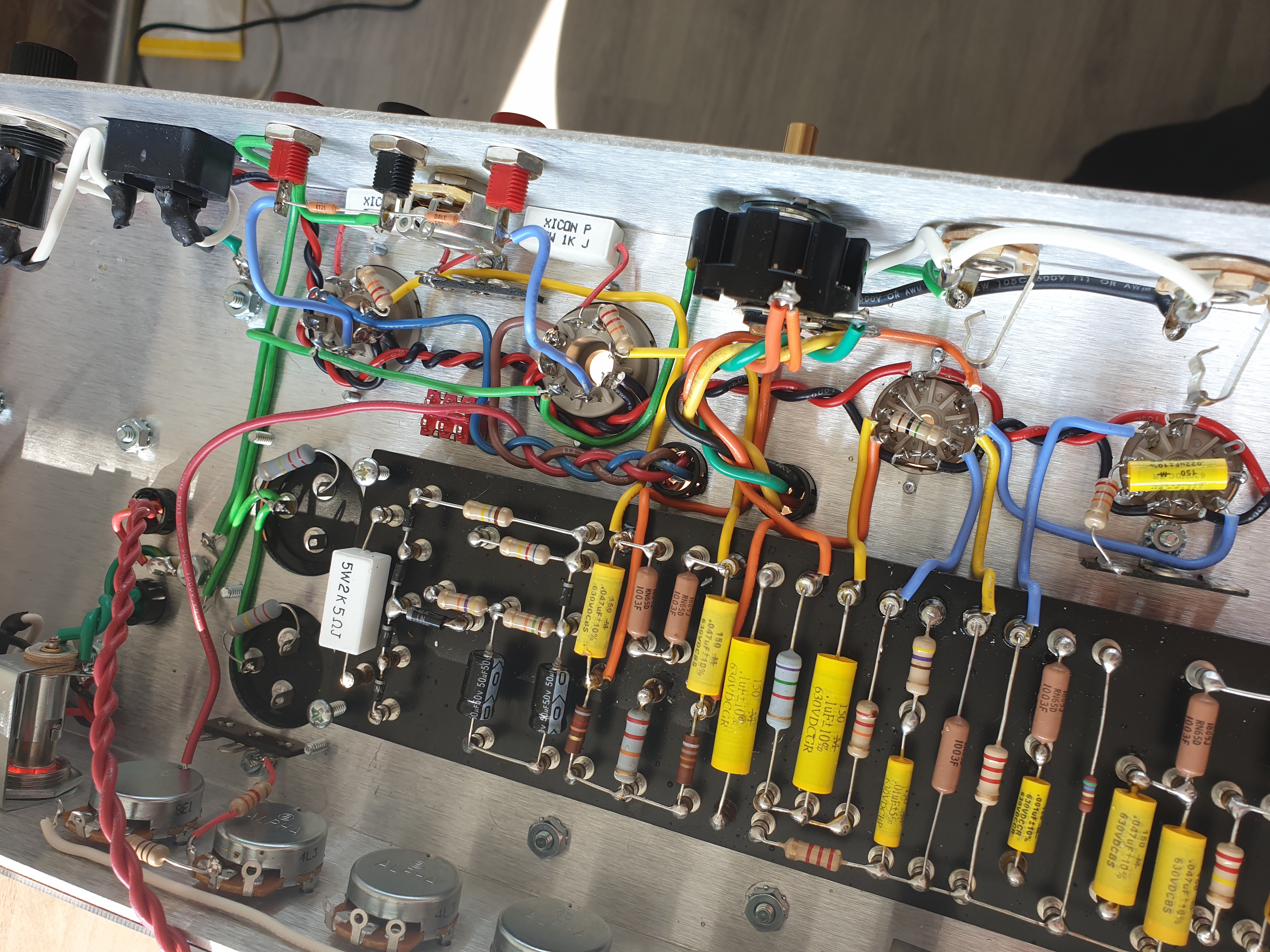

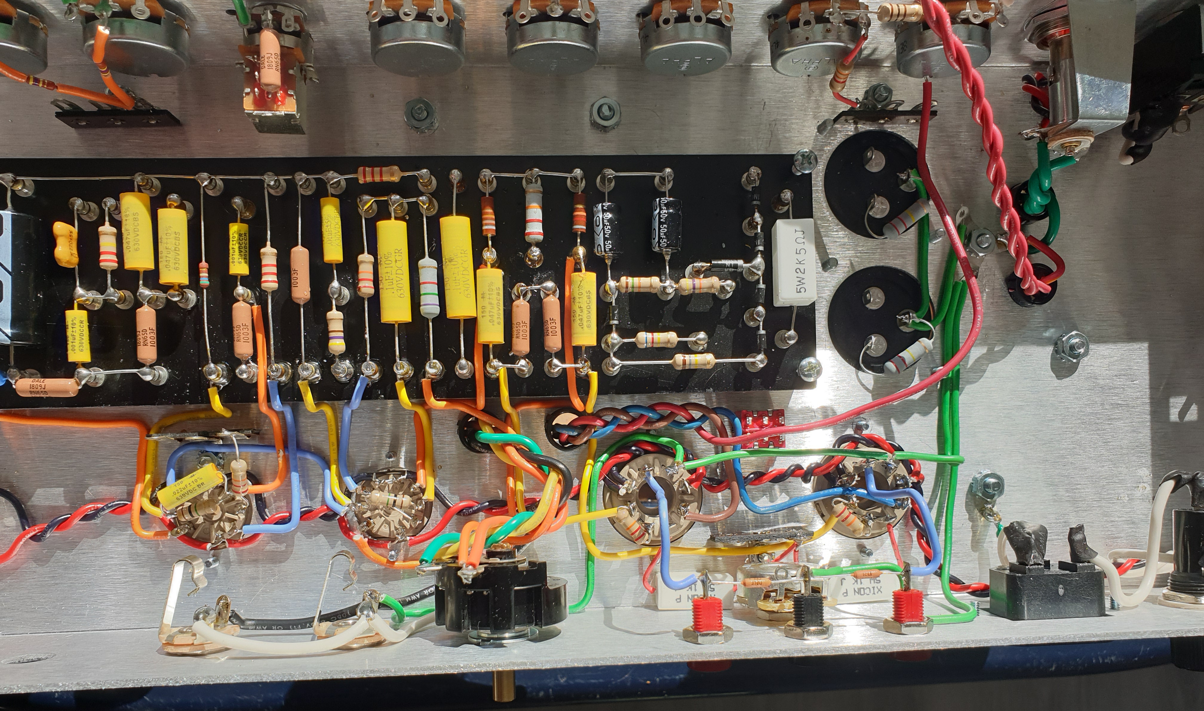

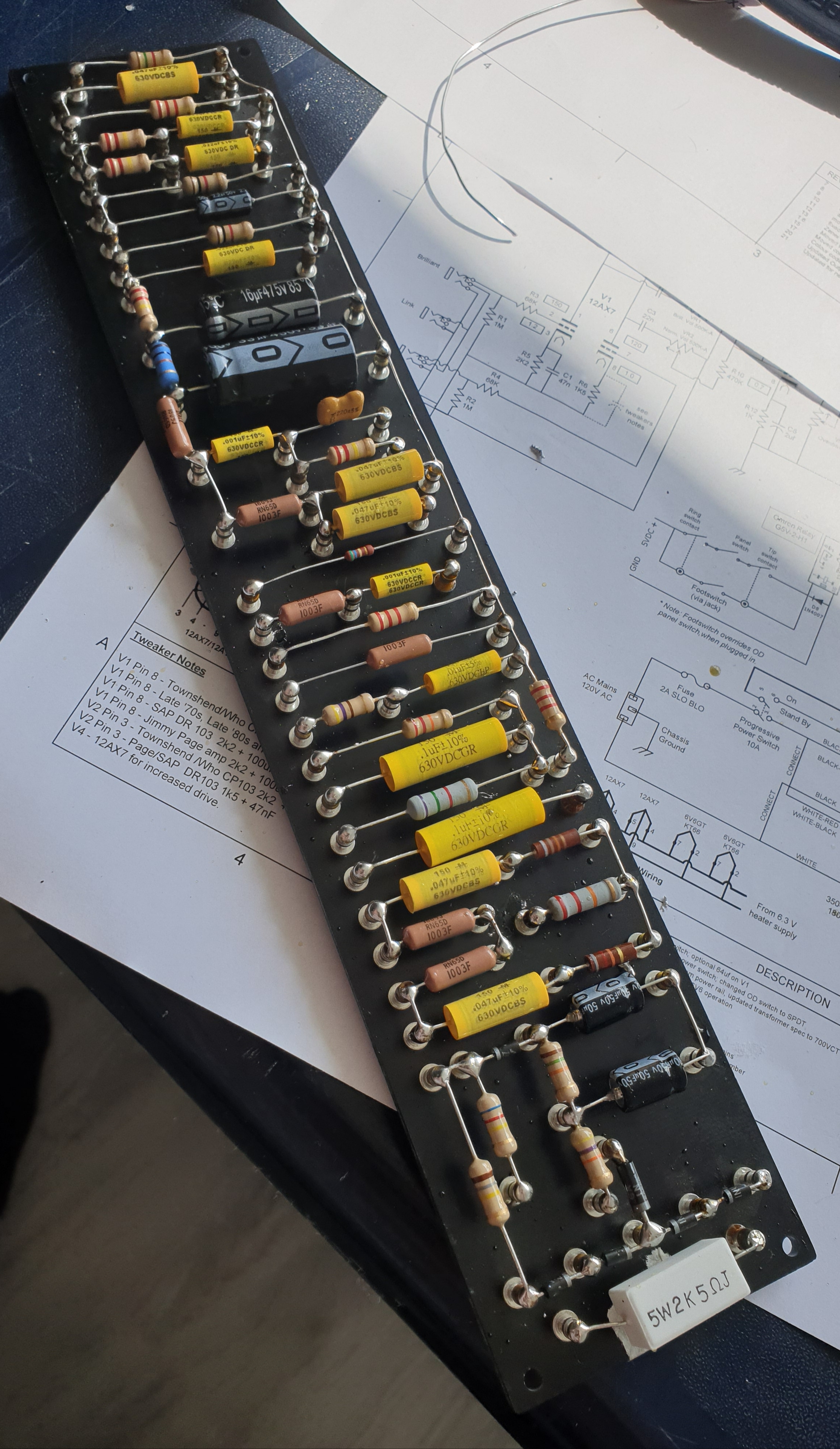

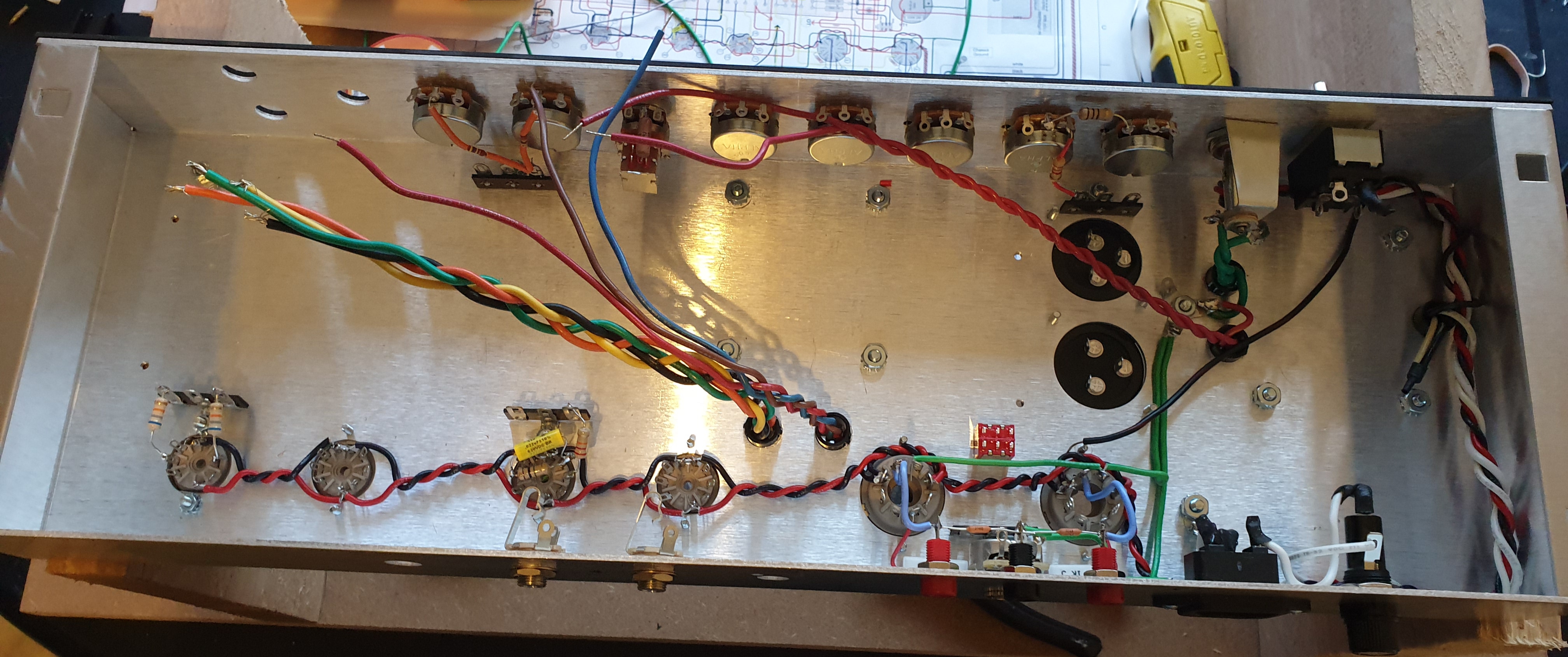

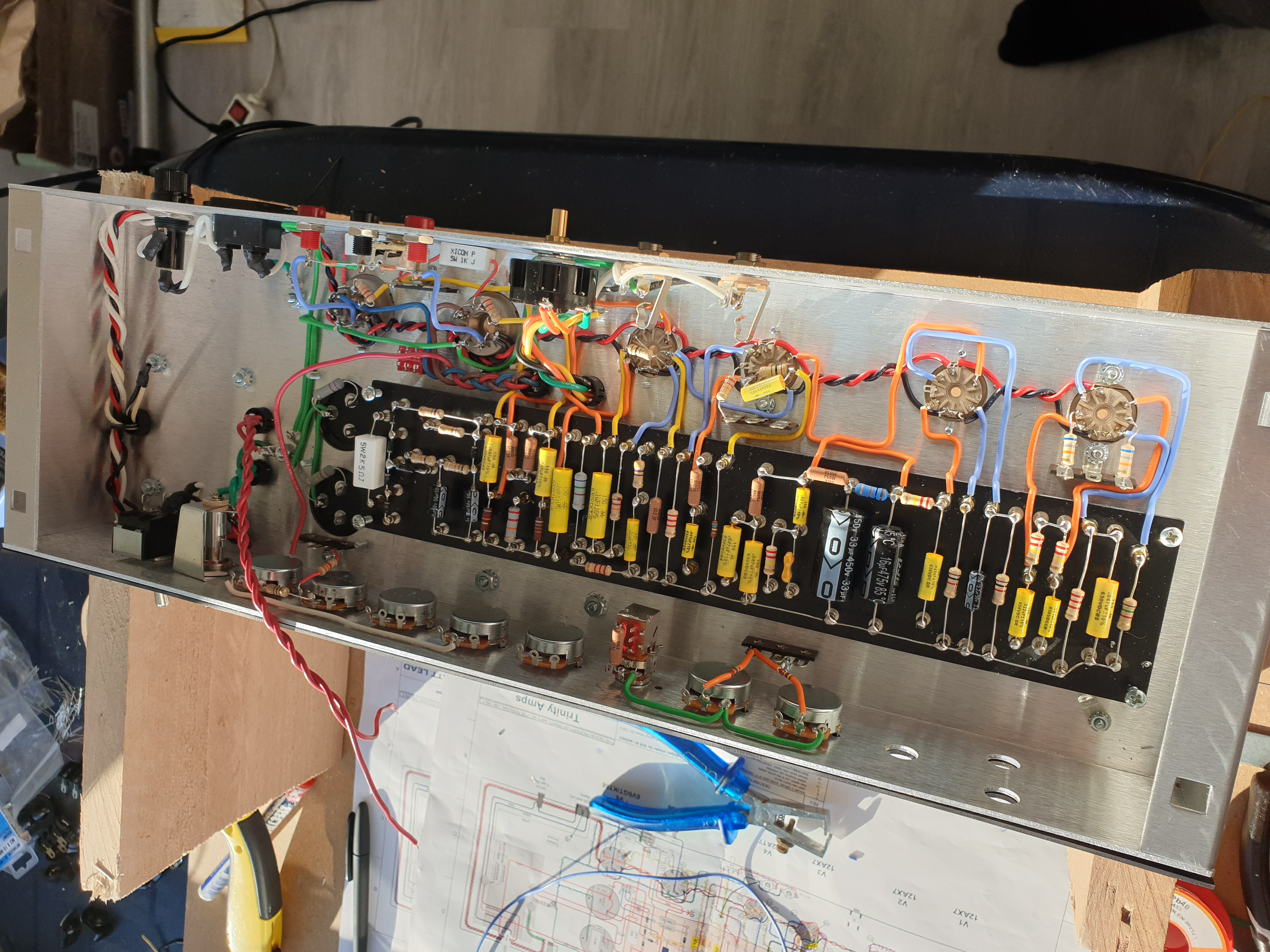

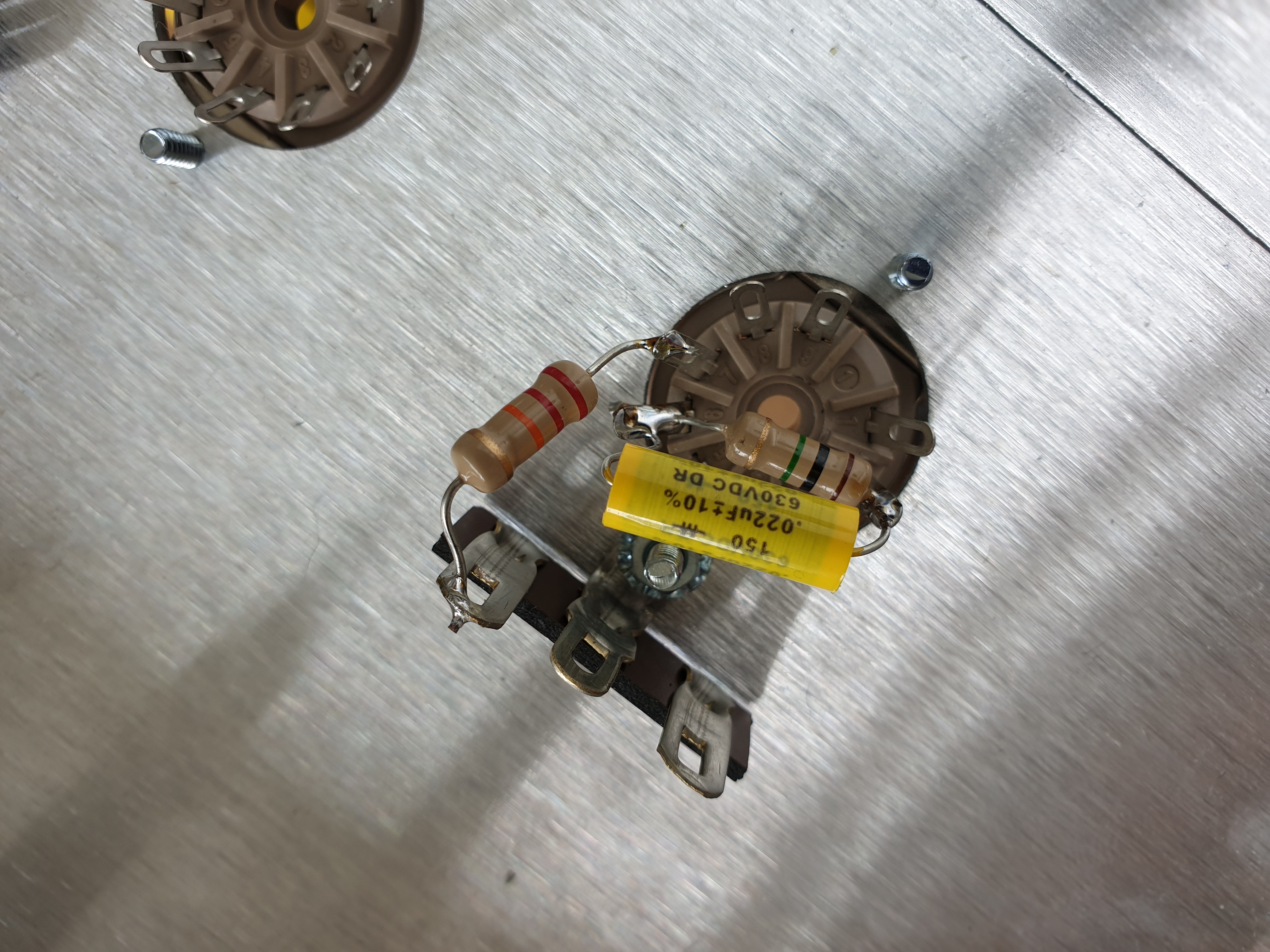

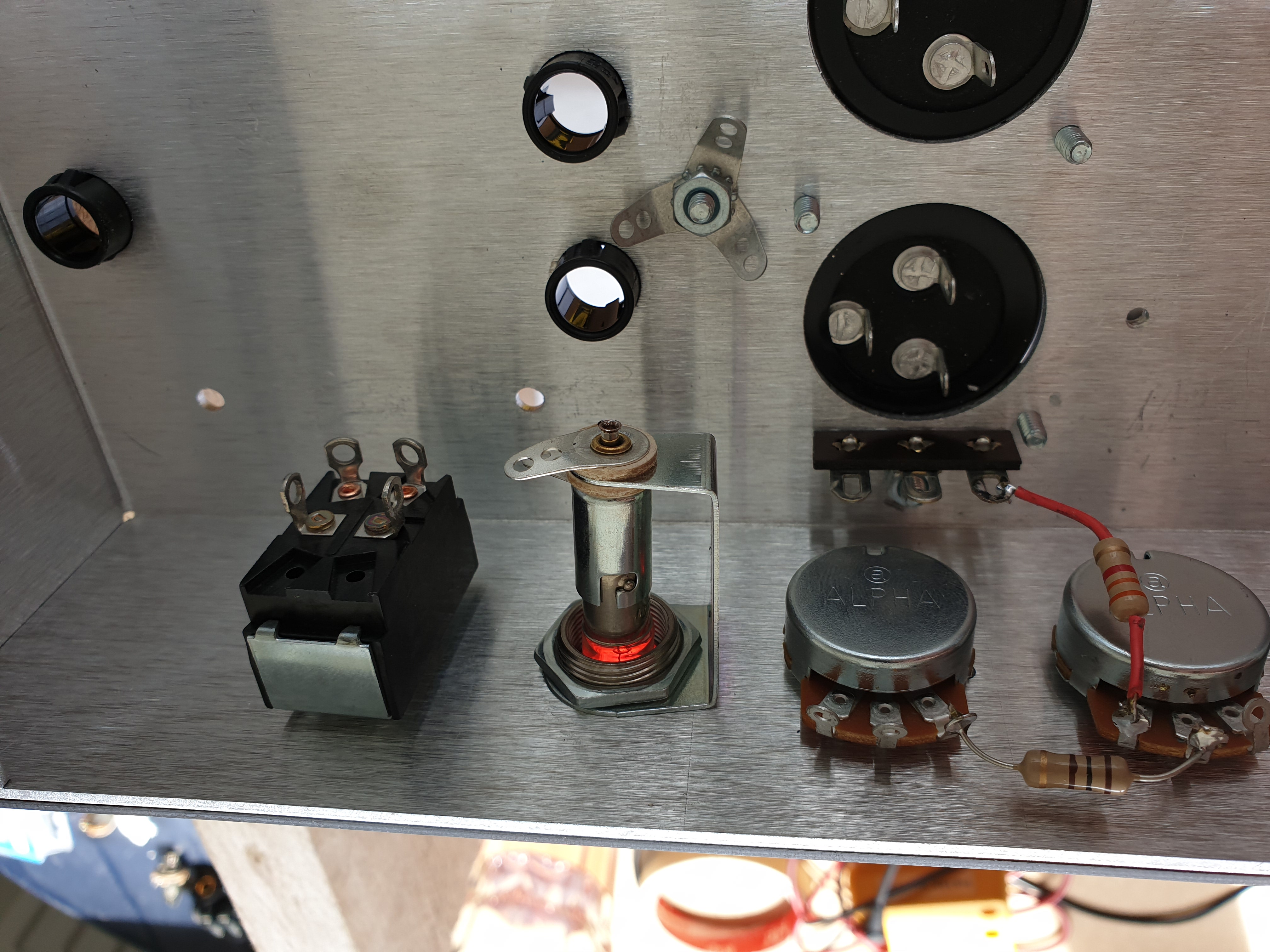

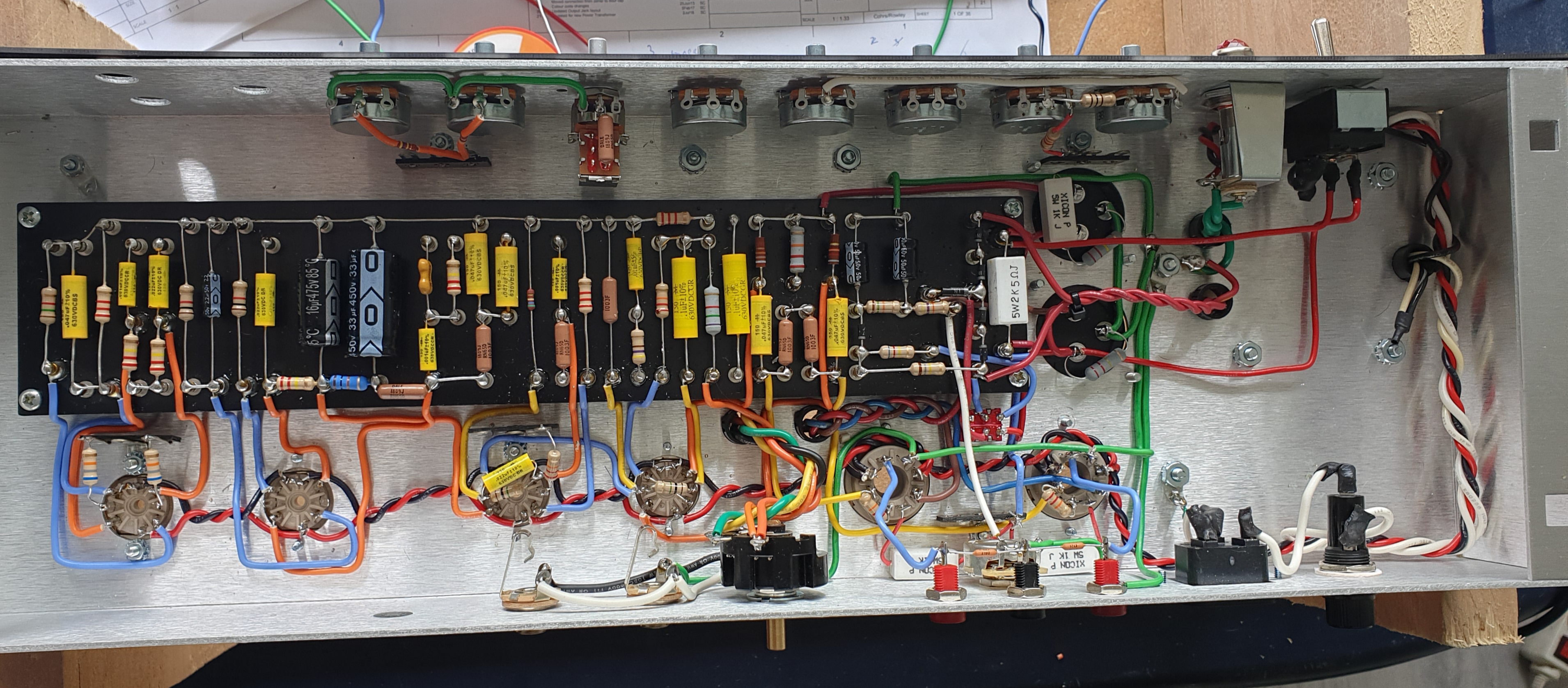

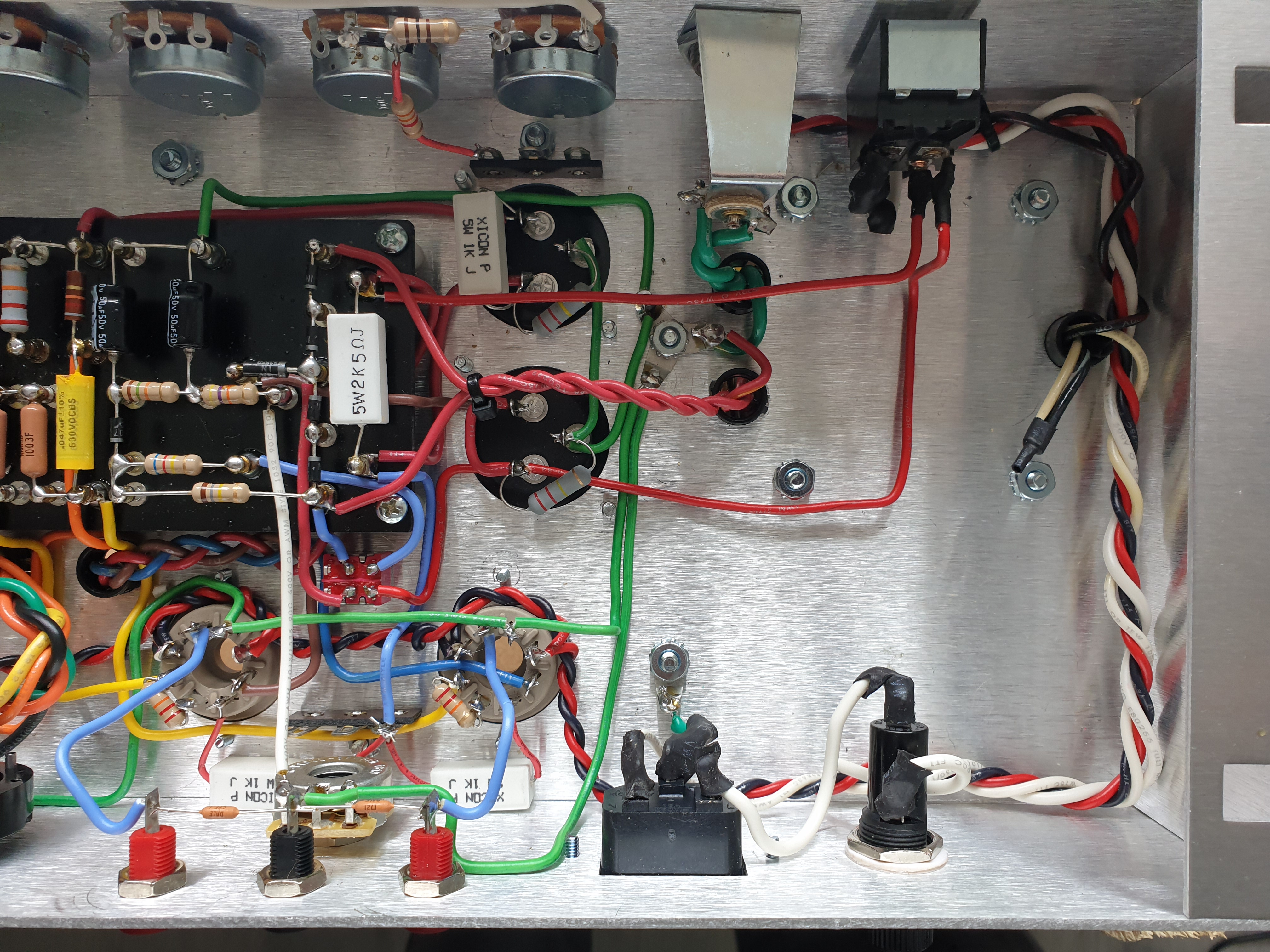

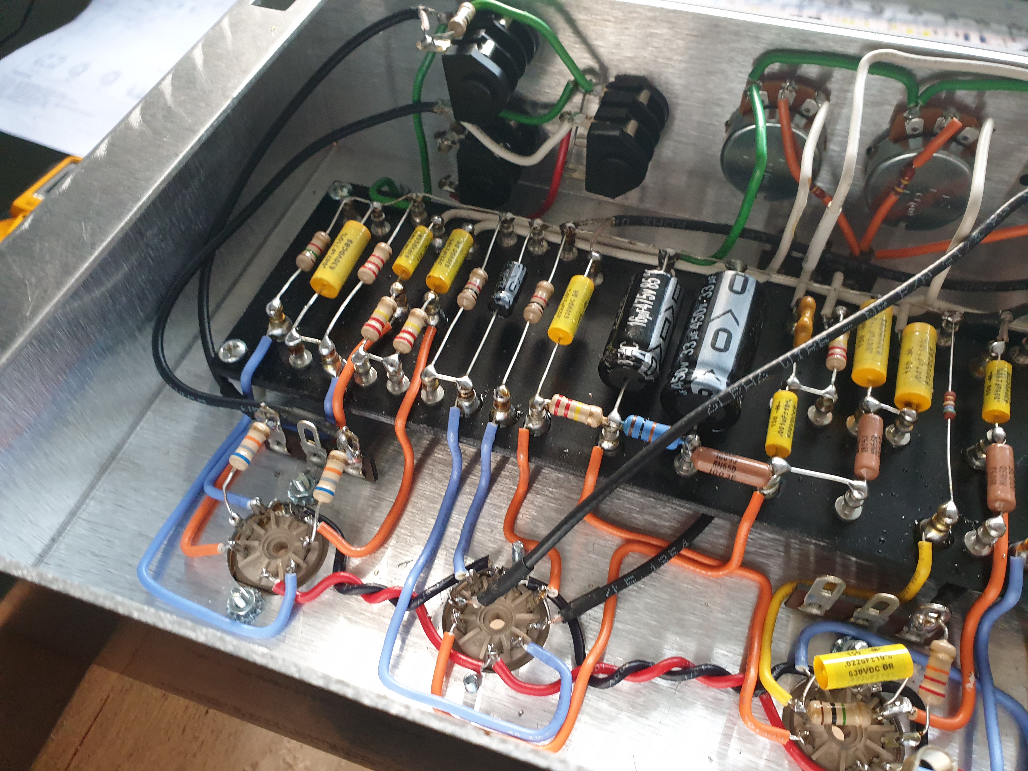

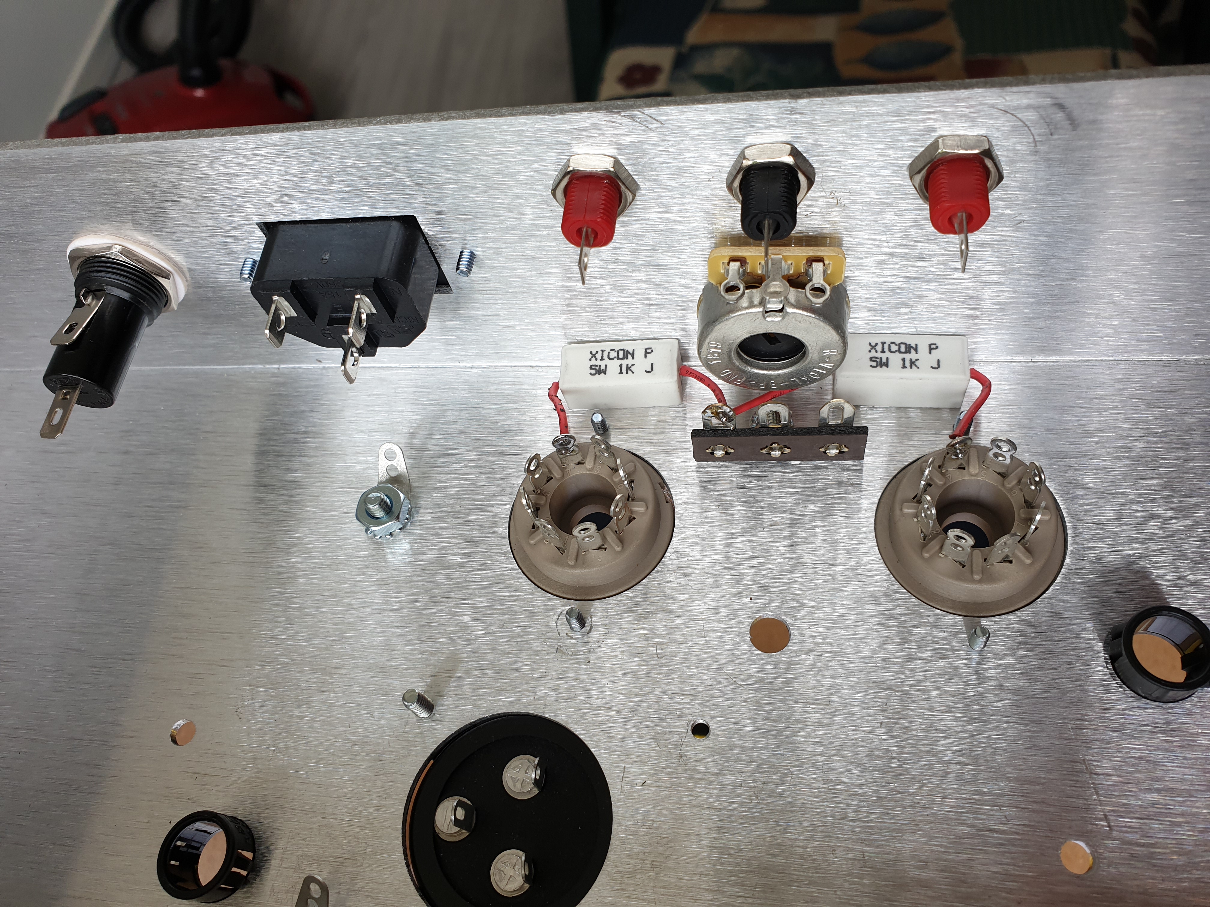

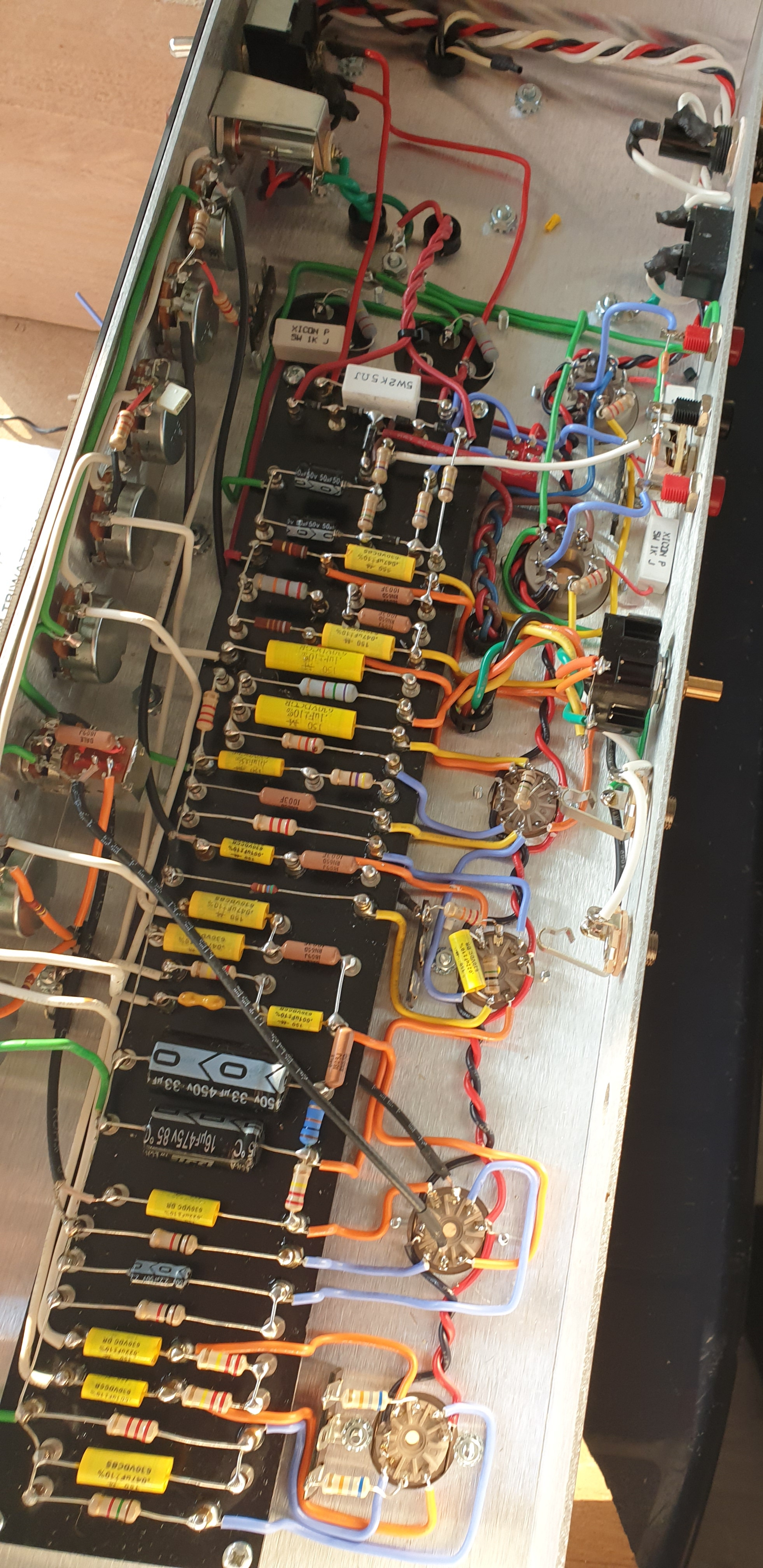

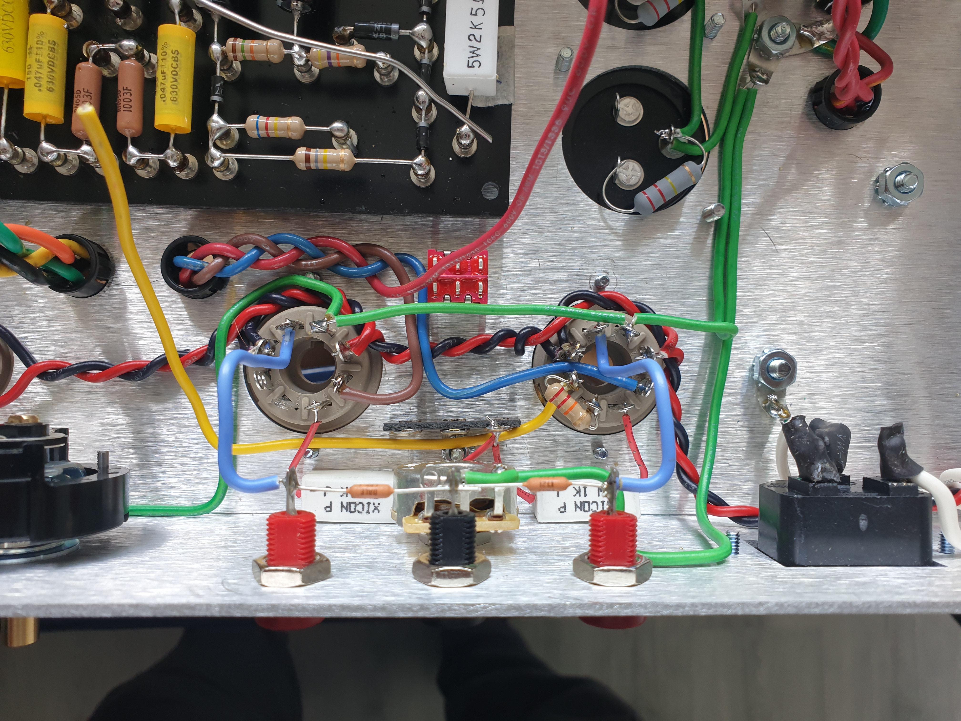

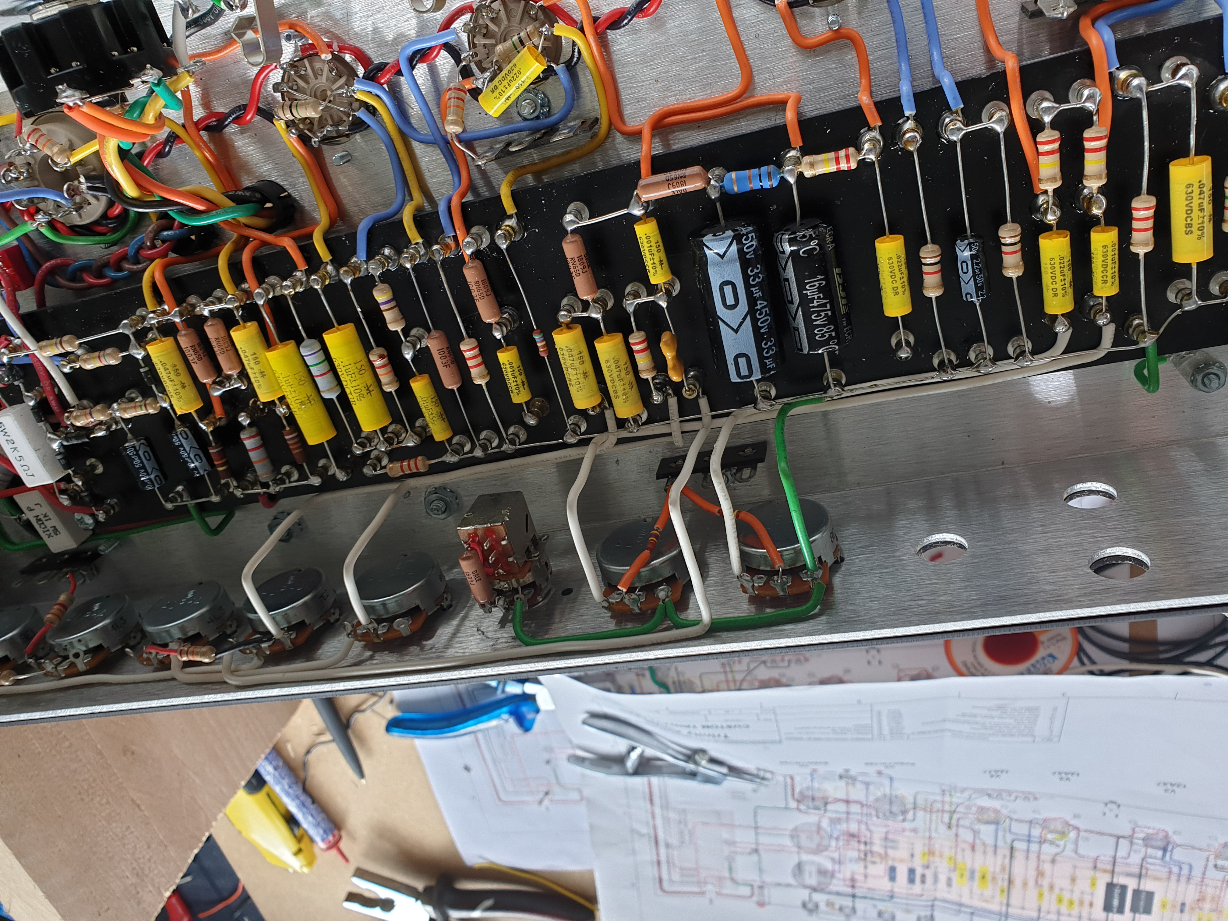

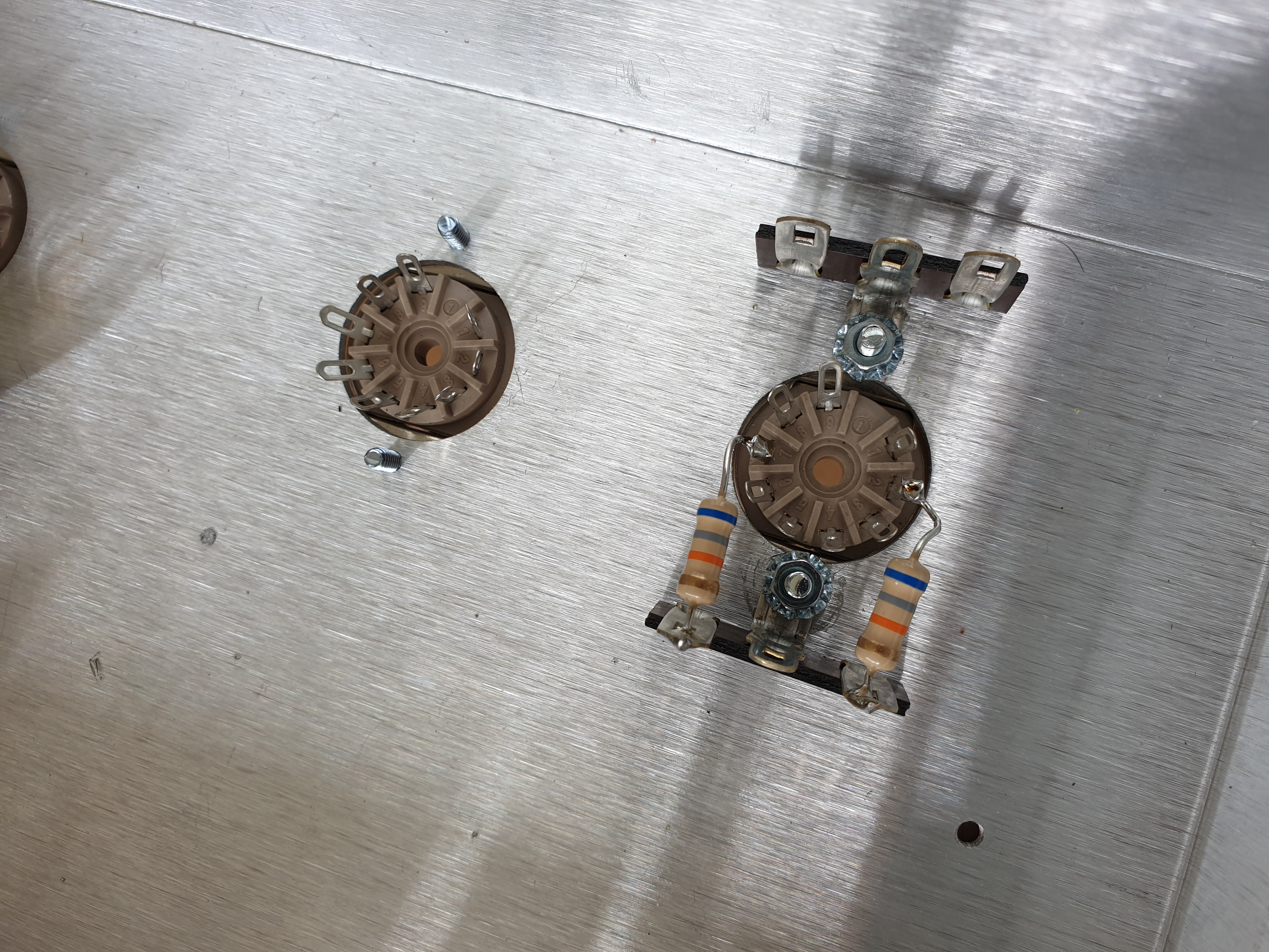

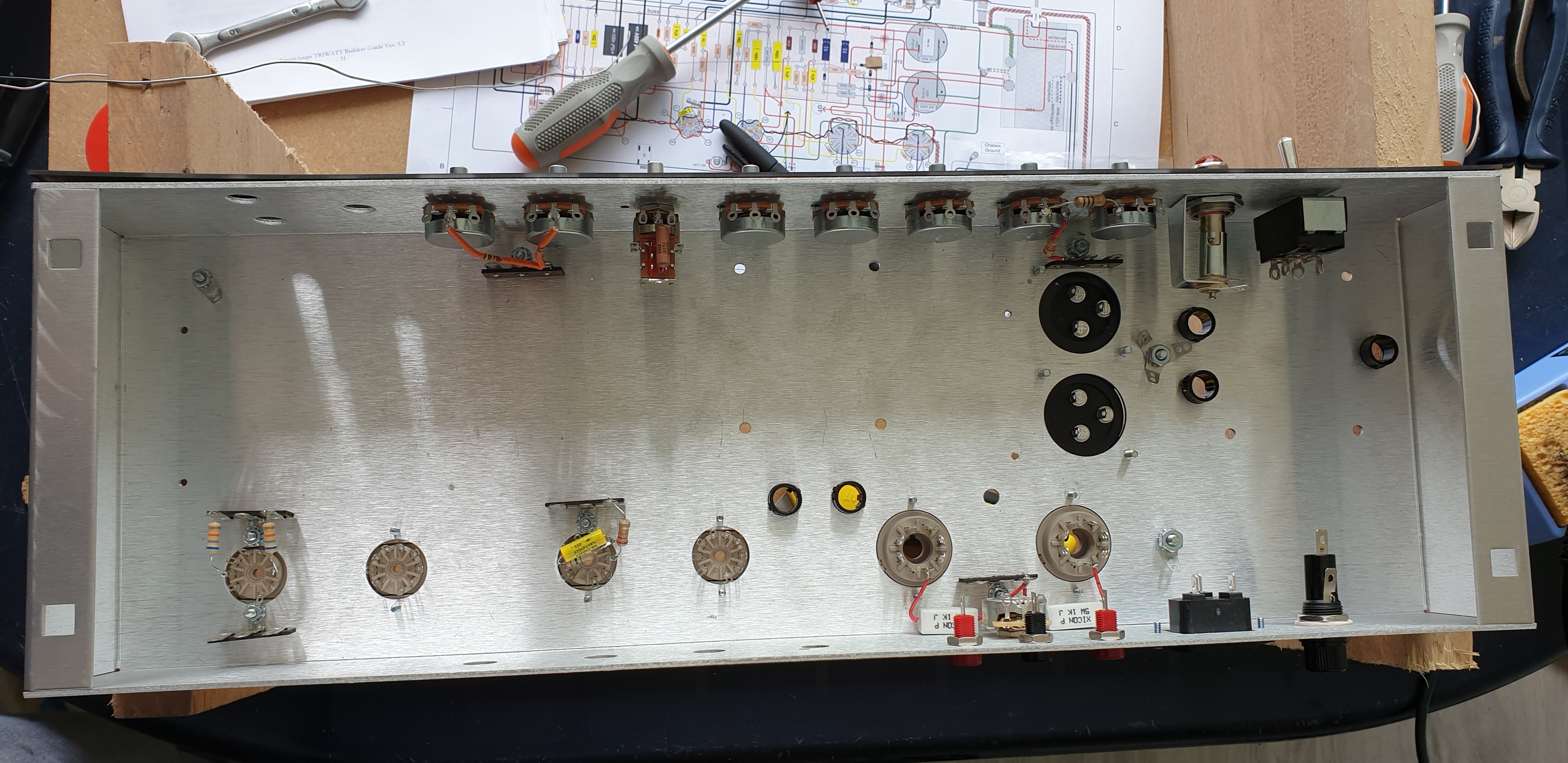

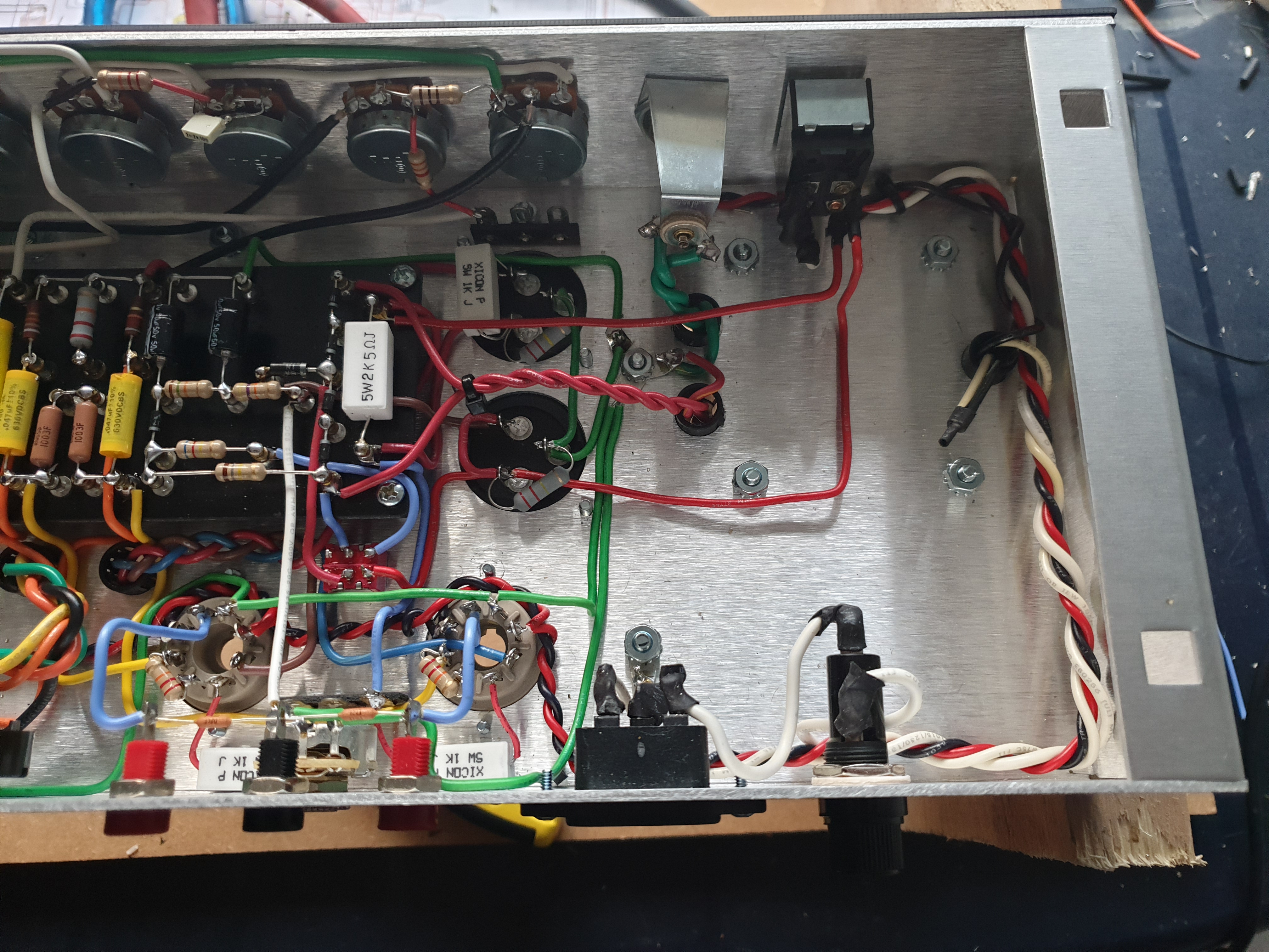

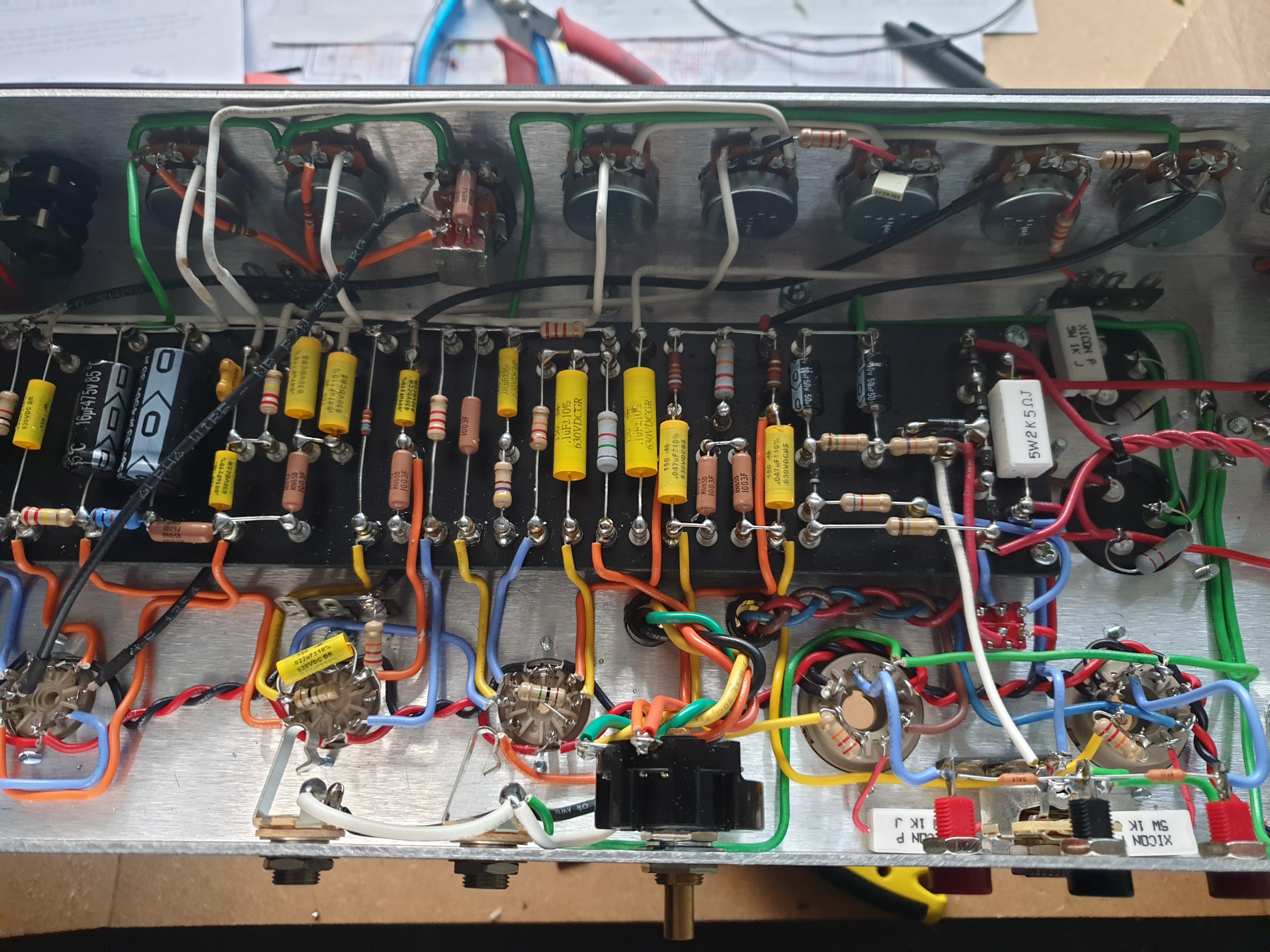

Thought this could help everyone out who is intended to build a Triwatt since the build pics in older topics might have a little different appearance. I really enjoyed this build so much!
Hope this could be of some help!
Feel free to comment on the build. It's my first, so comments are more then welcome!
Cheers!
Gertjan (The Netherlands)
File comment: Turretboard - Bottom jumpers
File comment: Turretboard - top

File comment: Hardware installed
File comment: Power section Close up
File comment: Bias hardware Close up

File comment: Heater and bias wiring
File comment: Heater and bias wiring 2

File comment: Turretboard wiring (first part) + OT secondaries wiring with impendance switch + output jacks
File comment: Turretboard wiring (first part) + OT secondaries wiring with impendance switch + output jacks - top view

File comment: Turret board wiring (part 2)
File comment: Turretboard wiring (part 2) top view

File comment: Complete build - top view

PostPosted: Tue Jun 04, 2019 9:17 pm
Hi Gertjan. Welcome to the forum!
Good job on the build. Really neat and tidy. Thanks for the detailed pictures.
I'm sure you will have as much fun playing it as you did building it.

Thanks for the kind responses! And yes I enjoy playing it as much as building it. I used a lot of images from others during the build so I figured I might as well take some decent pictures after each step to help others out!
