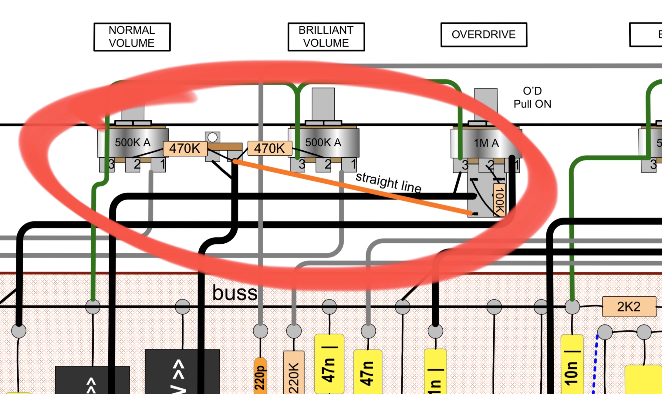

The. Triwatt is pretty sensitive to wiring and the OD can be one area to review. Also check the wire from the two pots that goes to the OD.

Corrected the wiring on the overdrive per the diagram. Needless to say it most definitely wasn't in a straight line !! I also replaced the master volume pot with the ALPS...very nice upgrade ! although it's a stereo pot and you only get to use one channel but even so, very open and clear sounding.
