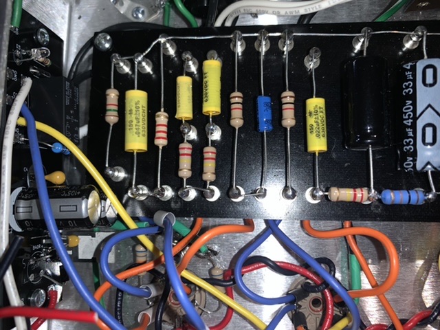

I just finished my build and I’m not getting the bias readings I should. I measure 4mv regardless of how I set the bias adjustment. I am also not getting any sound, hiss, or any kind of noise out.
I’ve checked connections, looked for shorts, tested continuity, I’m getting 350v from each side of the transformer, but after the first diode on each side the voltage is 146.
Any help or ideas would be greatly appreciated,
Thanks,
Kevin

K, Are your voltages (VDC) on all the test points for tubes close to correct or all showing voltage w/o the tubes in? Are you measuring voltage after the diodes using VDC range on multimeter? Can you post gut shot pictures using the upload attachment feature? I will look on the schematic again (haven't find the B+ test point, yet). According to docs, B+ should be around 442VDC (higher w/o tubes), so should be around 221VDC on each side after the diodes if those are correct spots for B+ voltages (it's my understanding that Hiwatt circuits are considered to be somewhat different than "normal" guitar amp circuits). If Mitch or Coco chime in, they would probably be able to help more. Hank S.

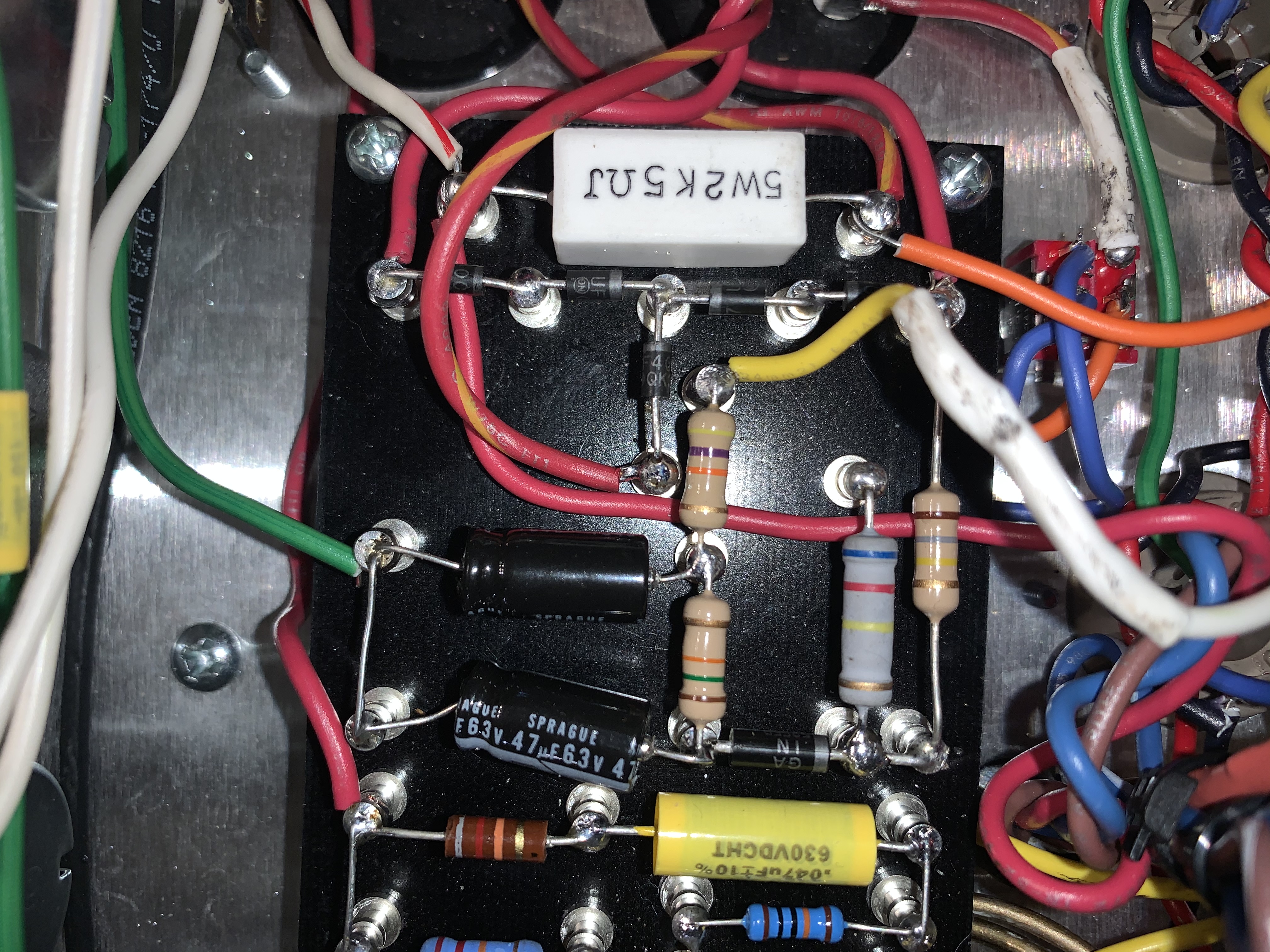

PostPosted: Mon Oct 26, 2020 12:29 pm
Continued looking at your board photo and am wondering if you may have switched D5 (1N5355B) for D6 (1N4007)? The four diodes (D1-4; 1N4007's) should be feeding into D5 (1N5355B) in that 5 diode network near the right end of the board (looking at the layout). The lonely diode (D6) near the electrolytics a little farther up should be a 1N4007 diode. I really couldn't see the markings, but D6 looked fatter than the other 5.

Thanks for your help, yes I did swap the diodes. I would not have caught that. I can wire up a guitar and do residential wiring, but this is my first time building an amp.

PostPosted: Tue Oct 27, 2020 1:47 am
It helps to get the right parts in the right places! Lots of diodes look similar.
Is the amp working properly now?
On a Triwatt, you can measure the main B+ where the three diode cathodes join together near the 2K5 5-watt resistor at the edge of the board.
This is also called HT1 and you can measure it at the positive terminals of the 50/50uF filter capacitor that's closest to the output tubes. The reading there depends on the setting of the KT66/6V6 switch, though. It will be lower than the main B+ if the switch is in the 6V6 position.
HT1 follows a somewhat convoluted path through the Standby switch and the KT66/6V6 switch. It eventually ends up at the 2K5 5-watt resistor at the edge of the board, then it heads to the center tap of the output transformer.
You can measure HT2 and HT3 at the positive terminals of the other 50/50 uF filter capacitor. HT2 is on the terminal that also has a 220K resistor. HT3 is on the terminal closest to the front of the amp.
This is all shown on the layout drawing.
