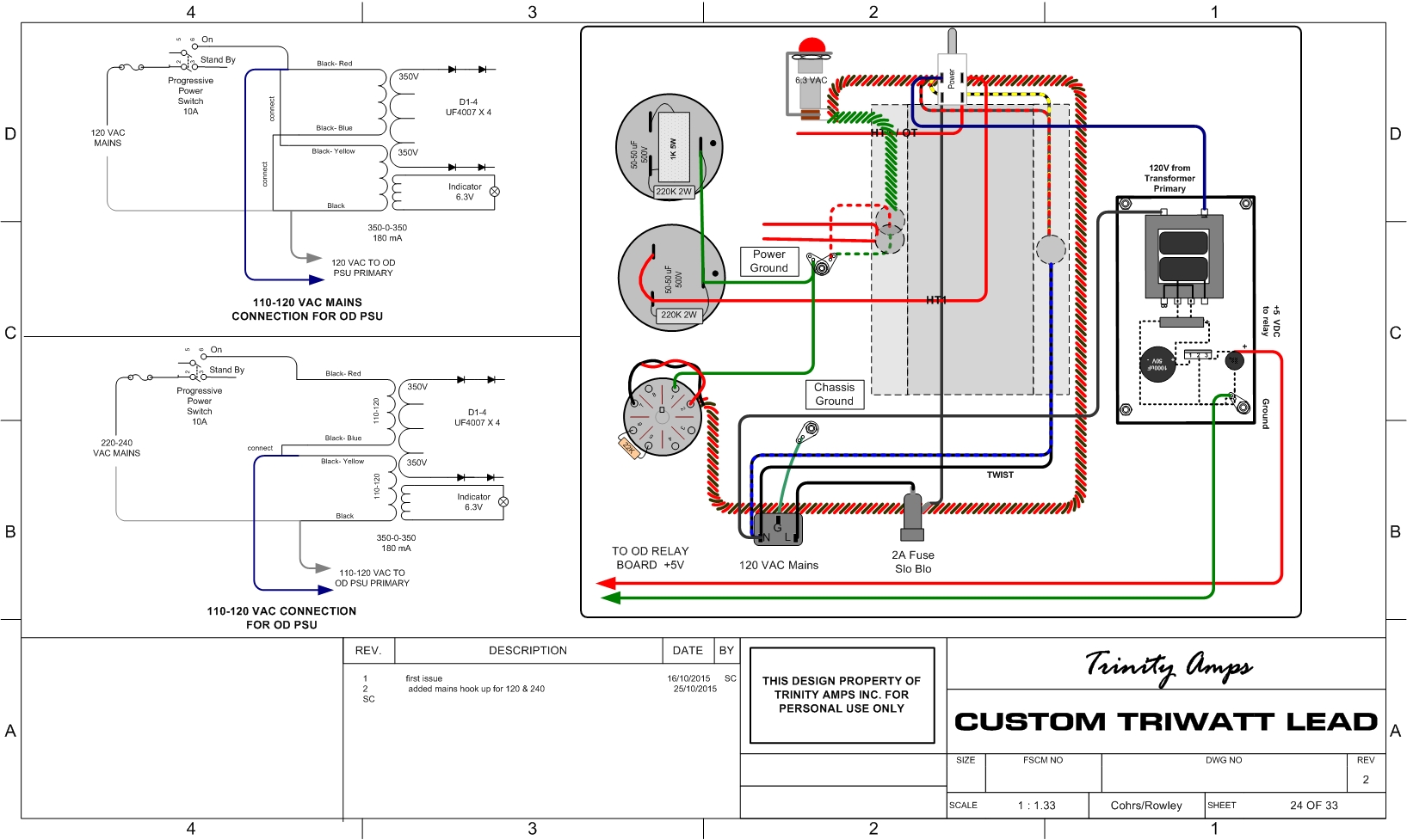

1. As I was unpacking the Power Supply the two wires broke off the Perf Board. Doh! I didn't get a chance to see where they originally were. My guess is that Ground is on Terminal 1 of the transformer? It looks like it and it is marked with a little black marker. Hot I assume is Terminal 4?
2. Sorry if this question is answered elsewhere, in fact I know it was, but I just wanted to verify I completely understand it. The question was about how to wire the Power Supply up and the answer was
One to the Power switch the other to line Neutral OR to just connect them to the Power transformer primary.
I have attached an image to verify if I understand what this means. The magenta is hot and green is ground. I actually can't figure out what the Power Transformer Primary is. I know newbie. I'd appreciate any help. Gonna take this nice and slow and will probably be asking a lot of question here.

The power supply to the relay power board does come from the HOT and NEUTRAL and should be AFTER the switch i.e. turns on when the amp is on only. These are the two wires closest to the Transformer

So if I understand this right it should look like this? This would make it work in standby I assume.
The two wires closest to the Transformer on the switch PSU are what broke off, I also wanted to verify which one goes where. Red to Transformer lug 4 and black to transformer lug 1?

No, one wire to the power switch (Line) , the other to the neutral at the IEC chassis connector you identified previously.
It doesn't matter which goes to the OD PT terminals, so put the Line to pin 1

Ok great thank you. I don't mean to be so dense, new territory for me. :oops: Good to know it doesn't matter which wire goes to which on the Foot Switch transformer.
Just for extra verification, again apologies for being so dense. I do appreciate the help, not sure why this is so confusing for me. I can hook the wire to either one of the power switch terminals that is closest to the the food switch transformer.

Wire it like this..

Oh man, my first one was correct. Talk about way overthinking it. Thanks Stephen for clearing all that up!
