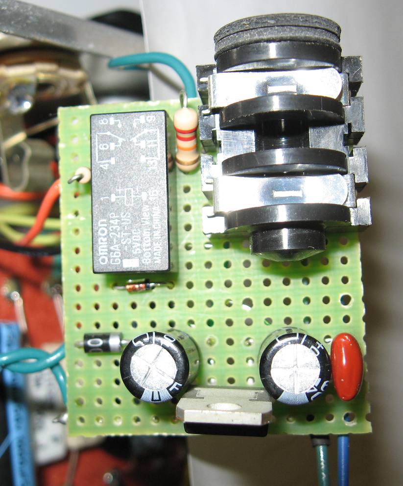

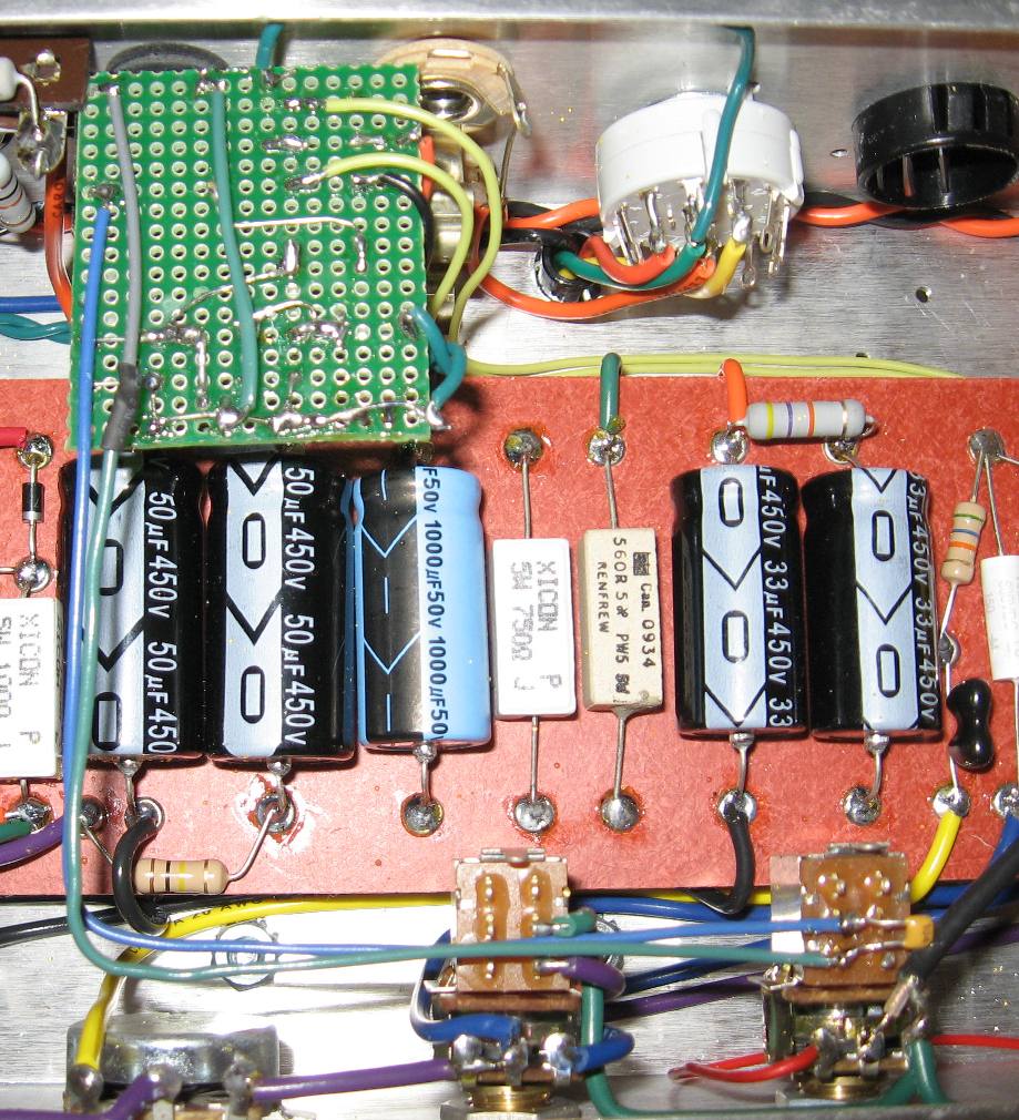

PostPosted: Sat Aug 07, 2010 1:56 pm
View of Relay board installation

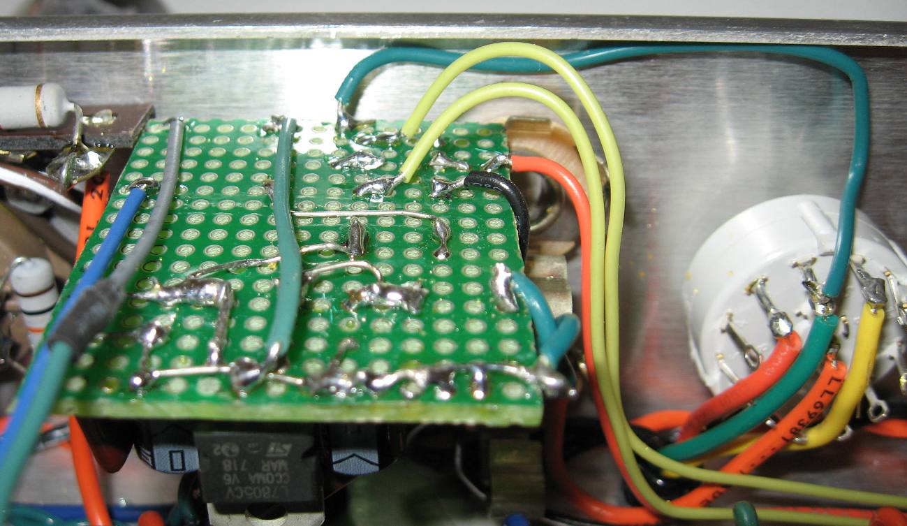

View of wiring from Output
Close up of Relay Board

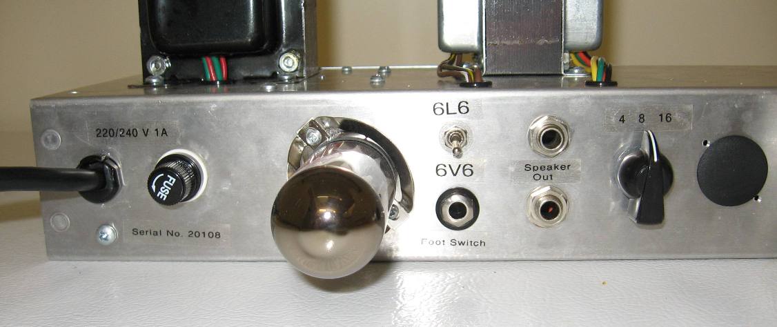

View of Modifications to accommodate Foot Switch jack and Power Tube Bias switch.
