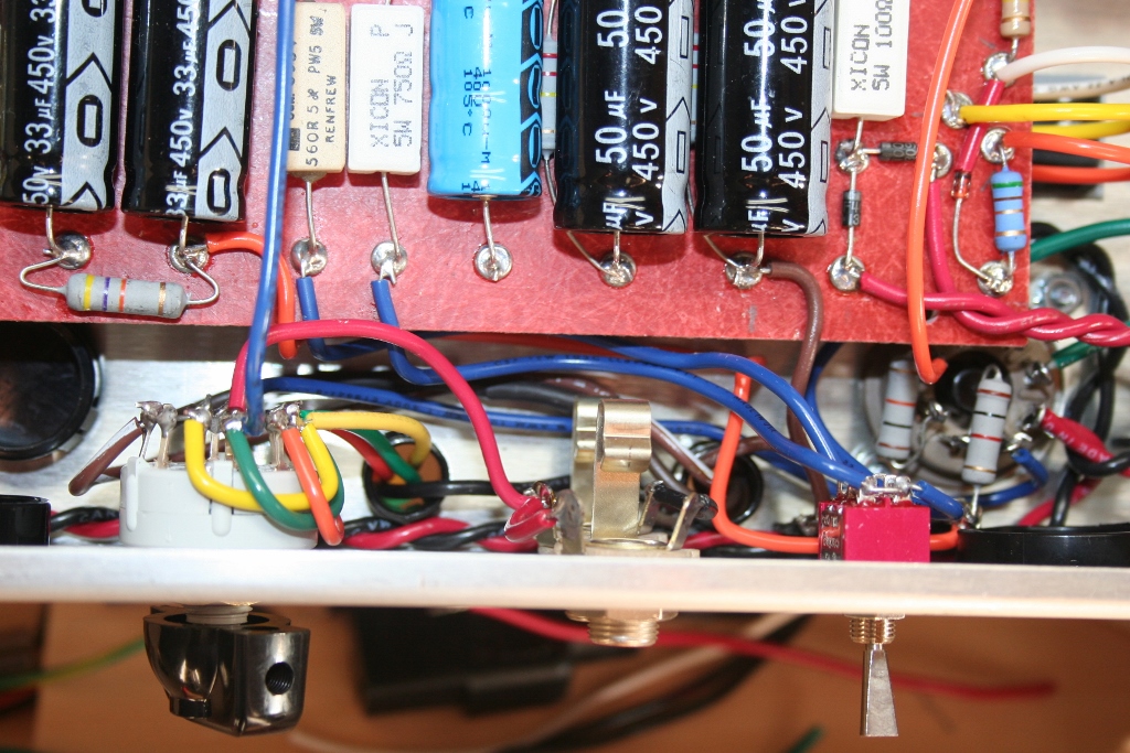

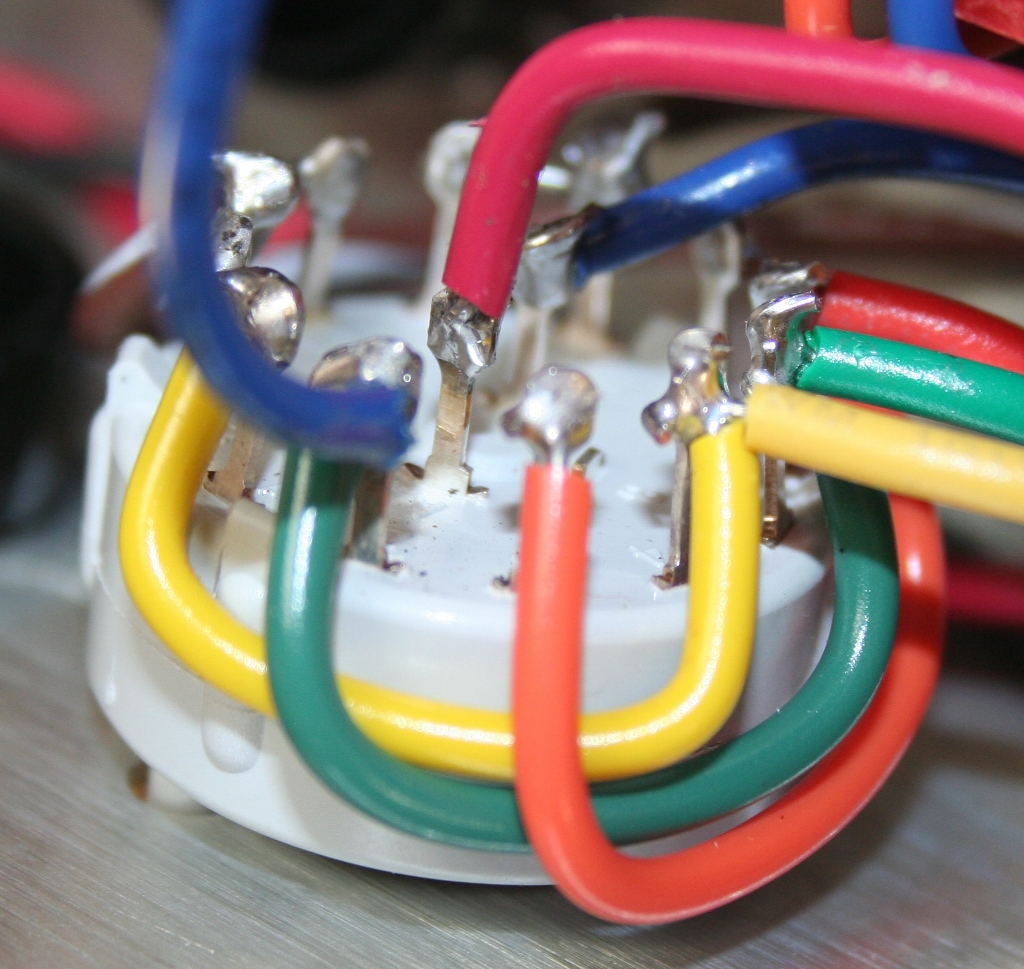

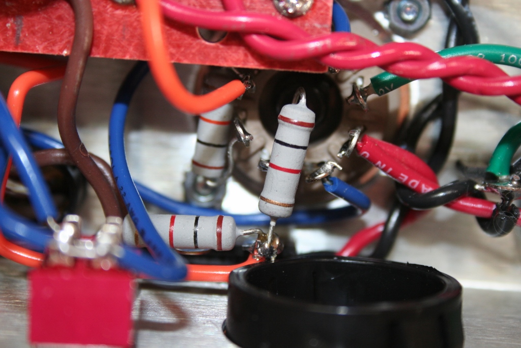

Thanks for the help Snowy! Maybe you or someone else can help. I have barely had time to play the amp due to other life issues but I decided to mod the impedance switch for El34 use following your thread. Before the mod it sounded good and loud! Now after the mod I have very little volume and it's very fizzy! :( So I swapped out the new EL34 for the original 6V6 hoping it was a bad tube. Same result. Oh, the amp is quiet and only fizzy when the guitar is strummed. Other than undoing the mod and running the 2.5k tap to the plate I don't see what I did wrong. Any ideas? I will attach pics and wait for rescue!

I know the mod works iF wired correctly bout it Is a biT of a tough mod. I can't tell from the pics if it is wired Ok. I assume you have a schematic for it.

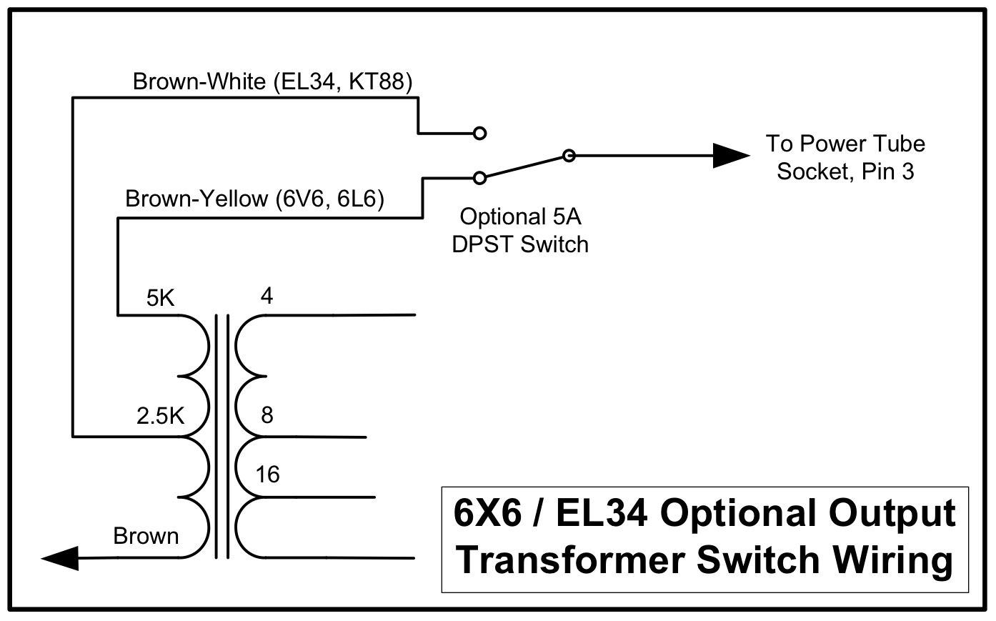

While it is an elegant solution, We don't actually do it that way anymore. We do it with a Toggle switch.

Thanks for the reply Stephen. Good news! I found the problem. It was a bad patch cord from amp to cab. :oops: I mowed the grass after posting the plea for help. Always seems to help to walk away and clear your mind while mulling over a problem. I realized that I used a cord I just recently found in a closet. Decided to retry with a known good cord. She works and sounds great again! :happydance: I think if I had it to do over again I'd go the separate switch too. Next build! This thing is actually quite loud with a 12" speaker when cranked!
