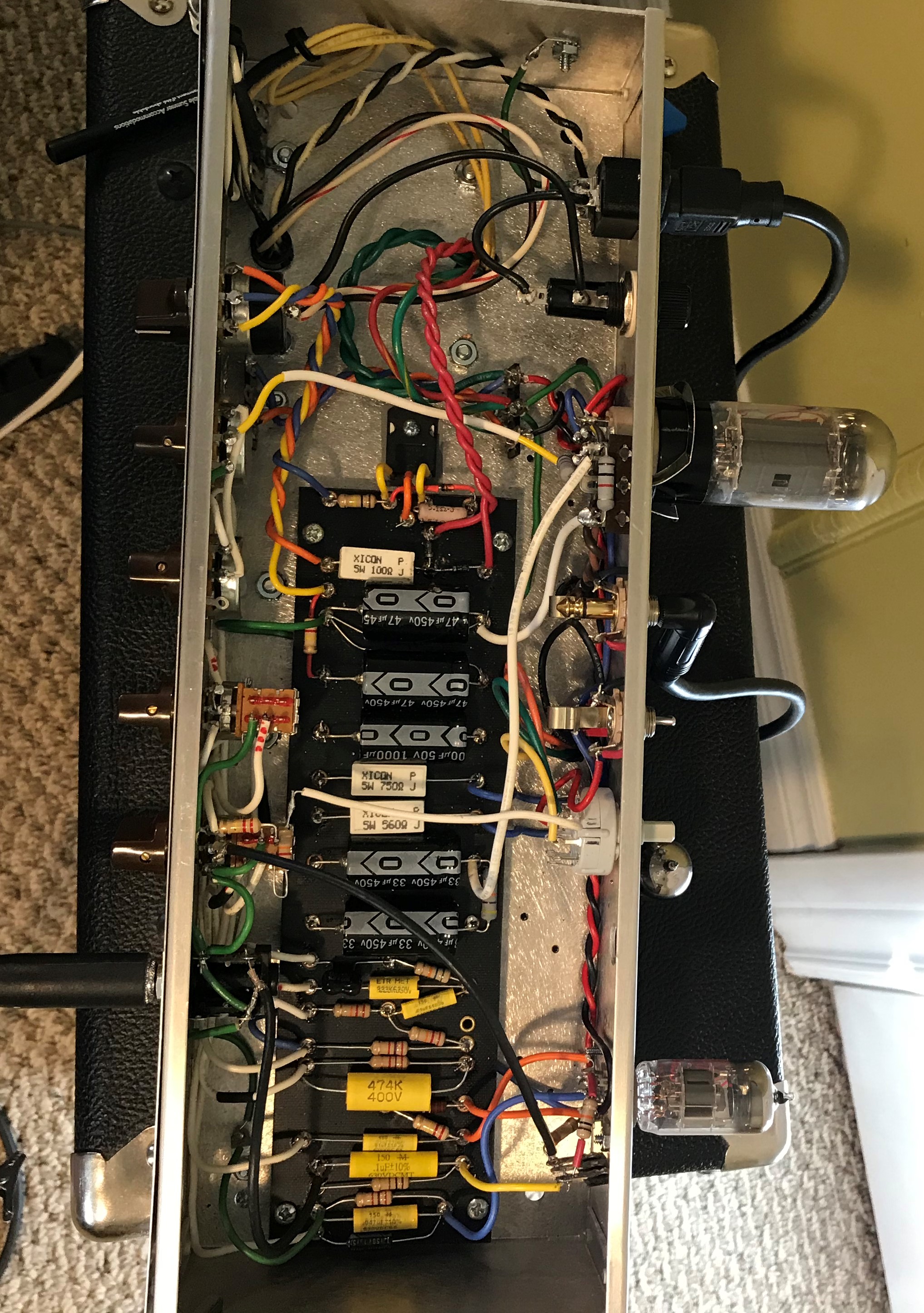

Took me a while to transfer iphone pictures to PC and convert etc... here are the pics requested. Thanks in advance for taking the time to look.
Roj
File comment: Whole amp

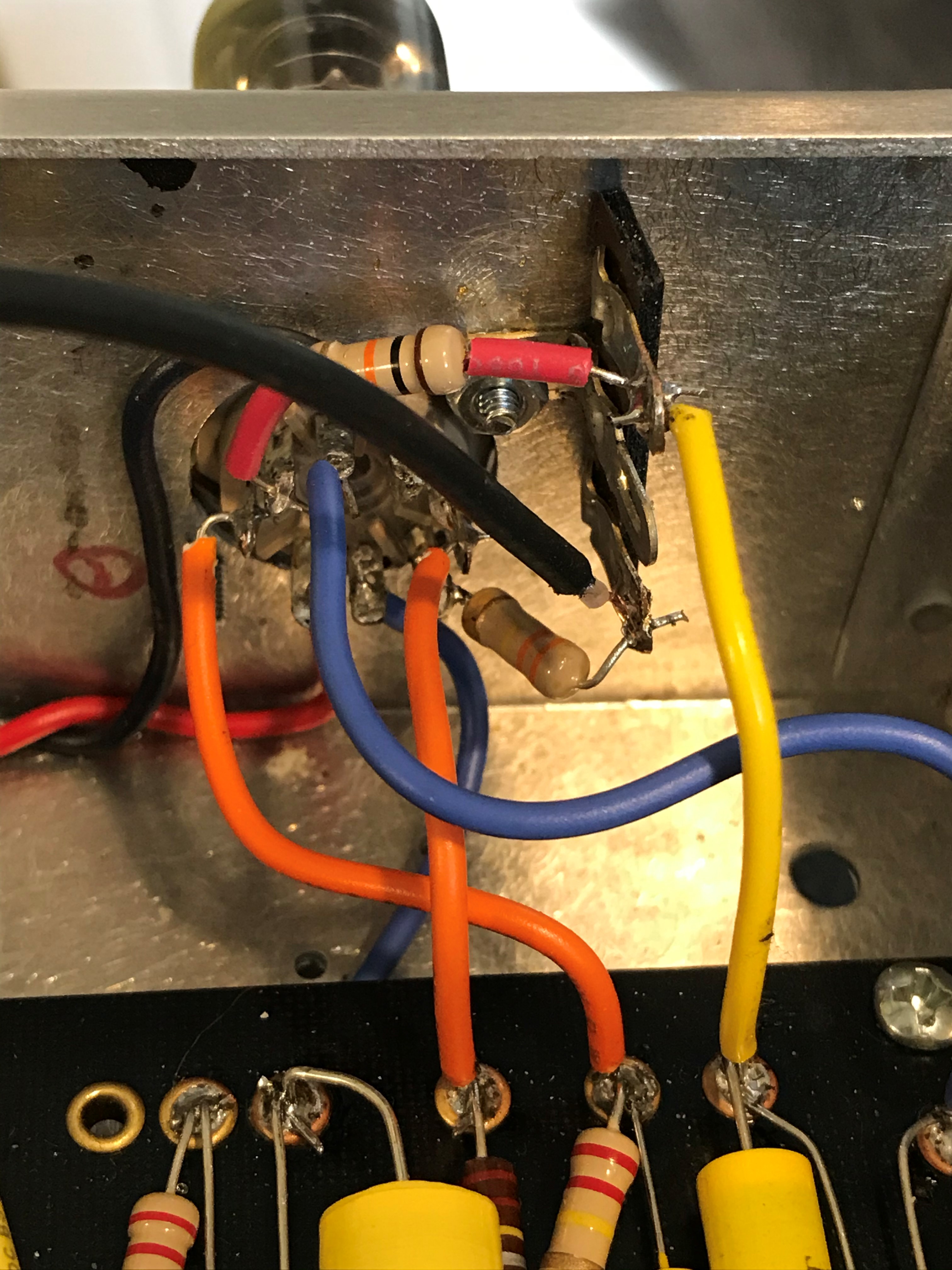

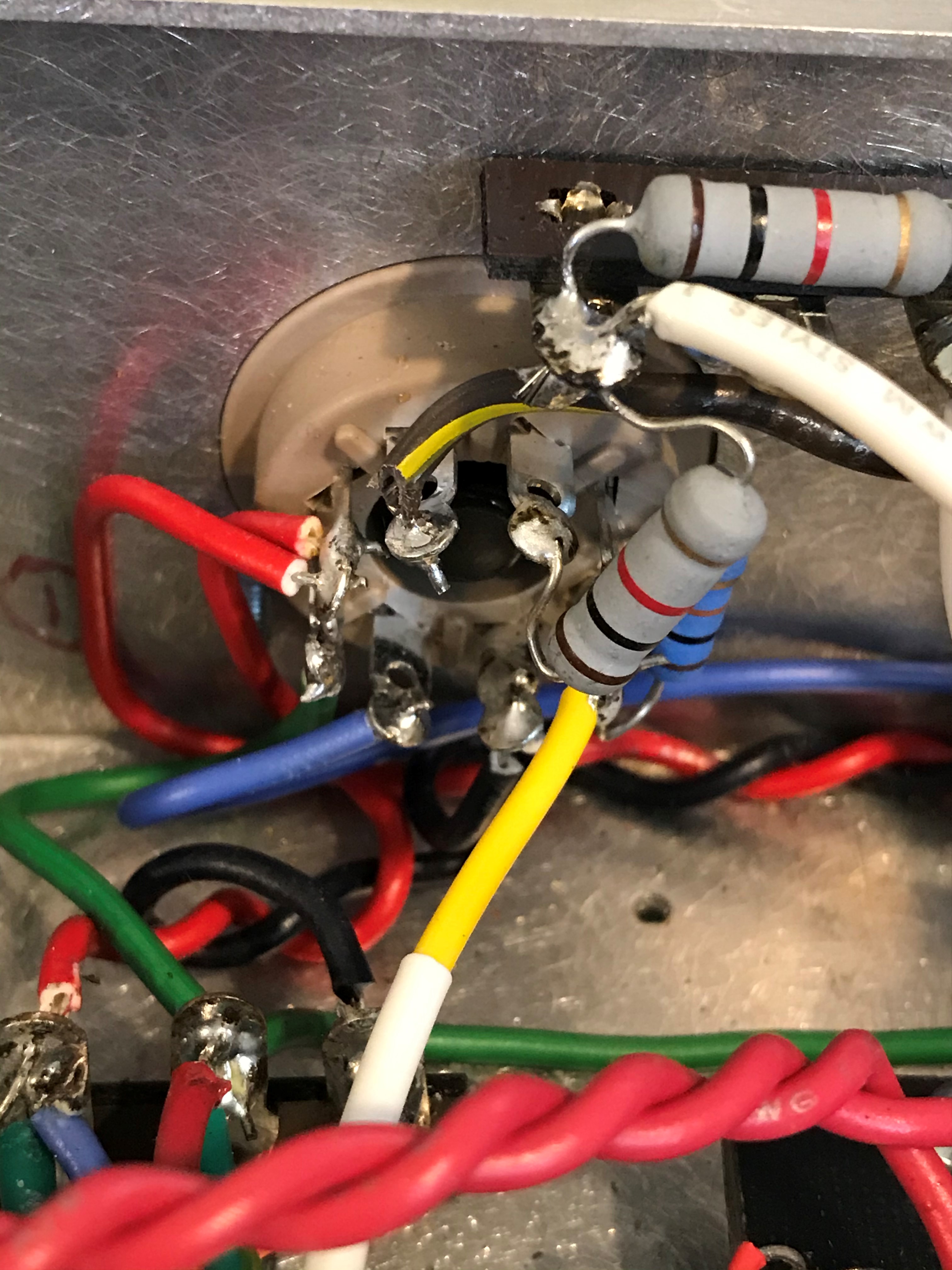

File comment: 6V6 socket

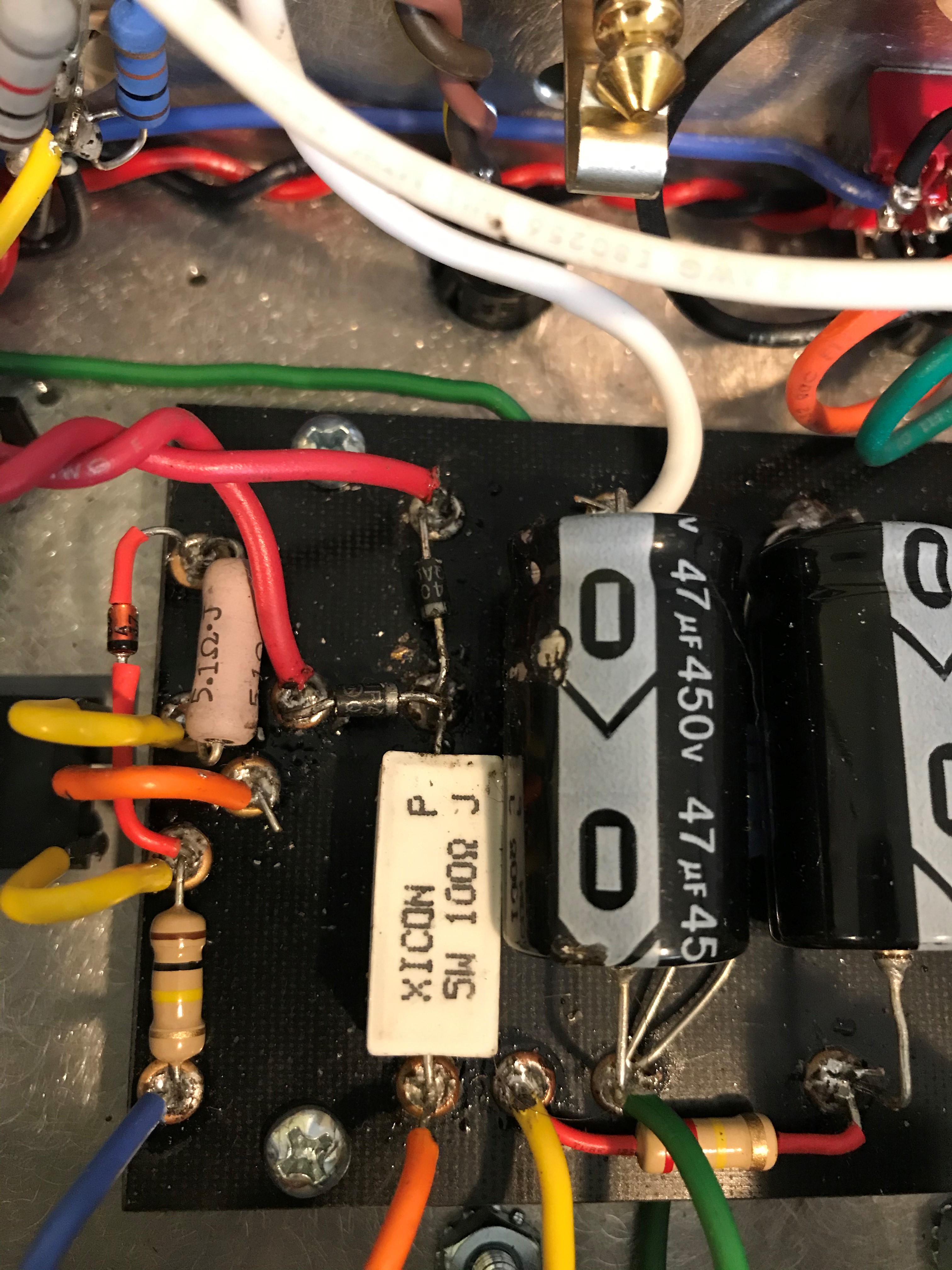

File comment: Rect bridge and cap damage

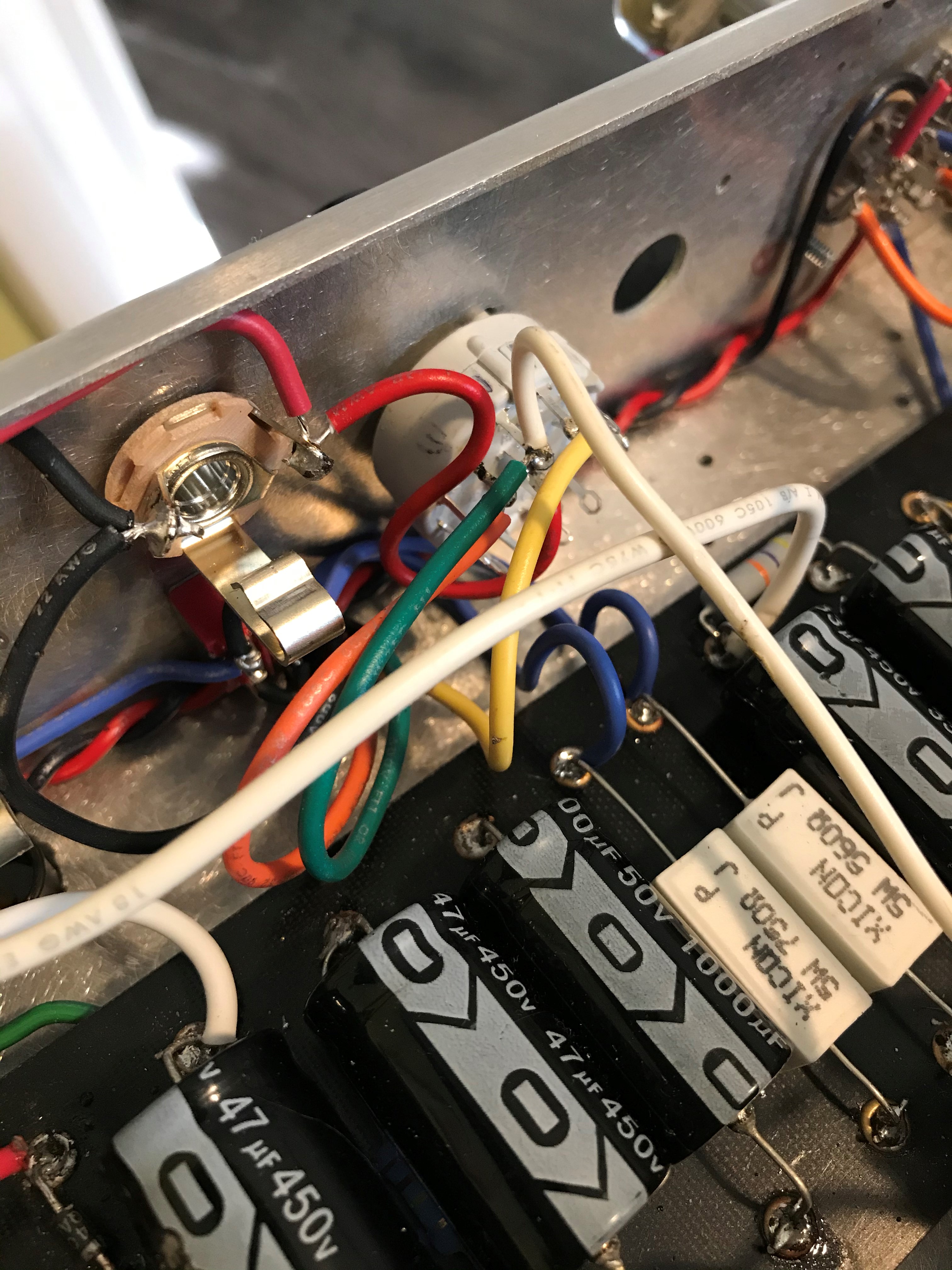

File comment: Impedance switch

Looking at some of the solder joints in power section, I'll suggest what everybody else does :D Check for cold and/or bad solder joints in that area. Should be shiny and smooth around component and jumper wires at the eyelets. And check out Joey Velours post in resources "Of Solder and Solderability". Keep your tip clean and tinned; :bugeye: Crusty and black is BAD on a soldering tip. Sorry that's what I got for now.
