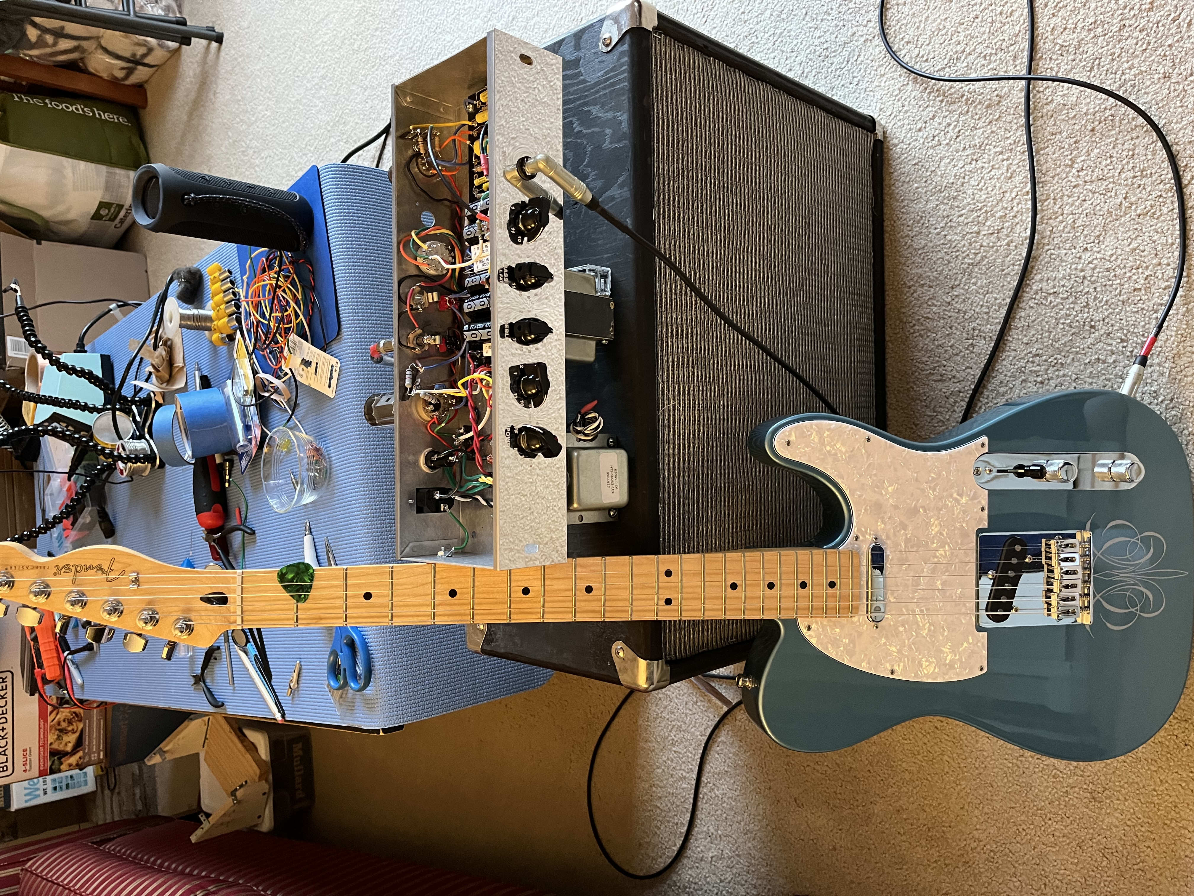

Anyone understand exactly how the VRM impacts the circuit enabling such variations in breakup. I’m loving the variability, but am trying to understand the engineering behind it. How does the change in circuit voltage impact tube performance and distortion?
-Brian
Note: MIM Telecaster upgraded with Fender Pure Vintage 64 pickups is great match with Tweed mode. Only thing holding me back now is talent and experience!
