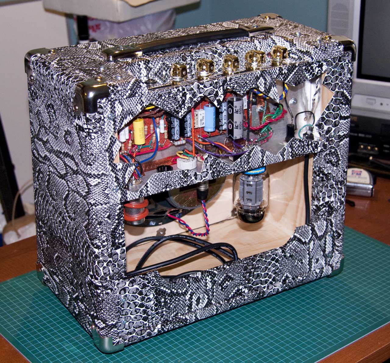

Here is what the amp looks like for the moment. (Thank's Stephen for the hint. Attachment works and it is much cleaner that way.)

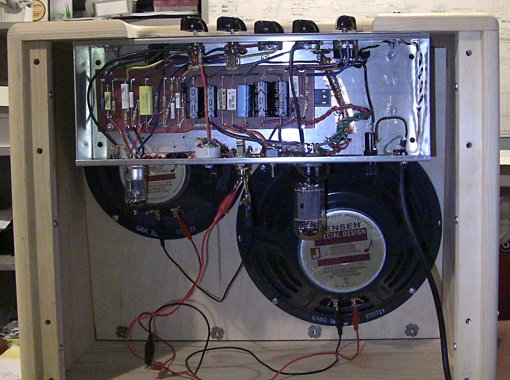

Here is a picture of the back with the temporary flying wire connected to the speakers. There is a 2 inches 'distance' between the magnet and the 6V6. I Was forced to install the 10" on that side because the 8" on the other side didn't like the big PT installed. In fact there is only 1 inch between the PT and the speaker baffle board.
I Like it, I like it !

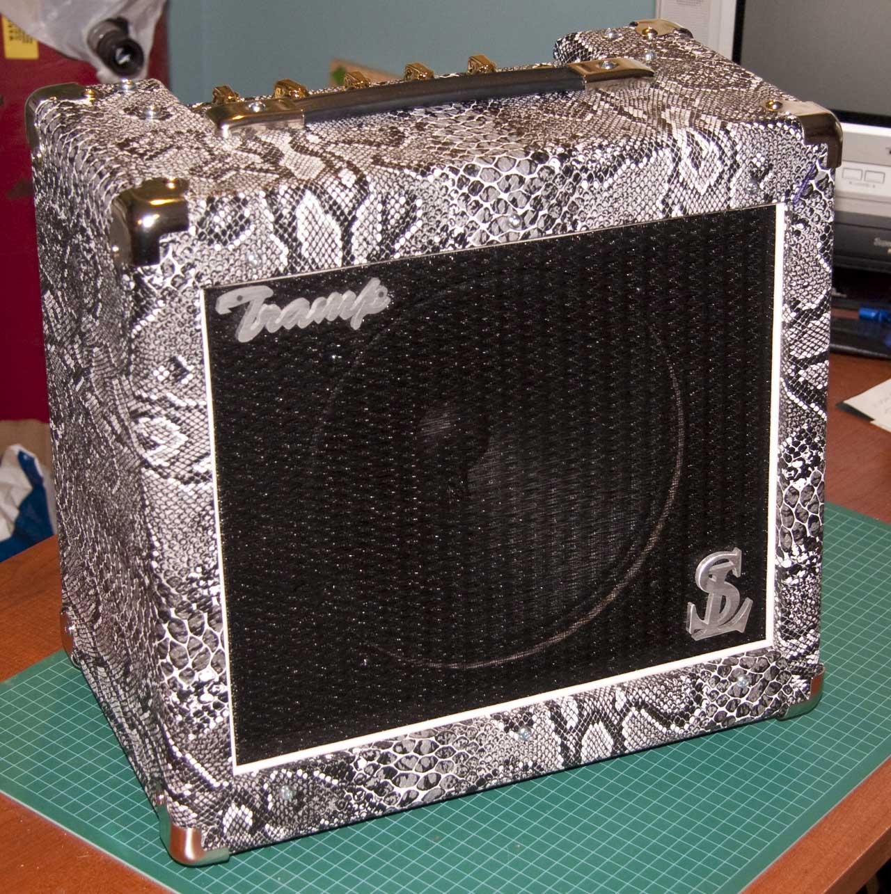

I finally received my Tolex and finished my minimalist Tramp. See the picture posted. I put a plexi on the back so I can see the innards of the beast.
A little help is needed for the biasing of the KT66.
I measured 37.2 volt across the 735 ohms cathode resistor at full VRM. Am I correct assuming that (I = E /R) there is .0506A going through the cathode. If I read the JJ spec for the KT66, .085A seem to be the maximum plate current value. So the rule of 70% of the maximum plate current give .0595A for the cathode current. In comparison my .0506A give me 59.5%. This seem a little cold.
Is there a way to find the correct cathode resistor based solely on the above numbers. Thank you for correcting me and your help.
