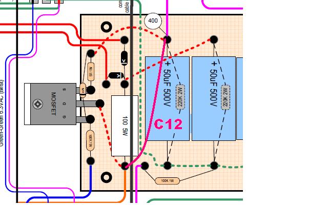

Guys, start by shorting out the VRM. We need to eliminate that from the equation and first get the main part of the amp working. Solder a shorting wire from the VRM end of 100 ohm resistor R23 to the + end of the second filter cap C12.
With the VRM out of the way, you should have a nice loud amp. We can deal with the VRM later.

I'm not that good at reading the schematic and co-relating it to the layout. Is it possible to show me how to short the VRM on the layout?
PostPosted: Wed Mar 16, 2011 3:36 pm
The instructions I gave were based on the layout diagram. I don't know how to spell it out any simpler than I did.
PostPosted: Wed Mar 16, 2011 4:41 pm
This is what Zaphod is suggesting but I have not done this.
Assuming it works, it should put 400+ volts onto the plate of the 6V6. Make sure the bias switch is in the correct position for 6V6.

Posts: 24
Assuming is works, it should put 400+ volts onto the plate of the 6V6. Make sure the bias switch is in the correct position for 6V6.
Thanks for the image. I actually was pretty sure I figured out where to short it but I used the Capacitor next to the one you indicate and it didn't work. I'll try this later today.

Hmm...I was also confused by that. I shorted to what I thought was the "2nd Cap", meaning from left to right of the pair. Perhaps you could put that image into the docs for troubleshooting?

The image makes sense to me.
If you shorted to the top of that cap beside C12, you'd just be bypassing the 100 ohm resistor - because the top leg connects to the top of that other cap with the jumper wire under the board.
How about CAREFULLY putting in a nice beefy jumper wire instead of soldering?
PostPosted: Thu Mar 17, 2011 4:43 pm
Solder a beefy jumper wire if you want. :) But the connection has to be nice and solid, so it has to be soldered in until the rest of the amp has been debugged.
