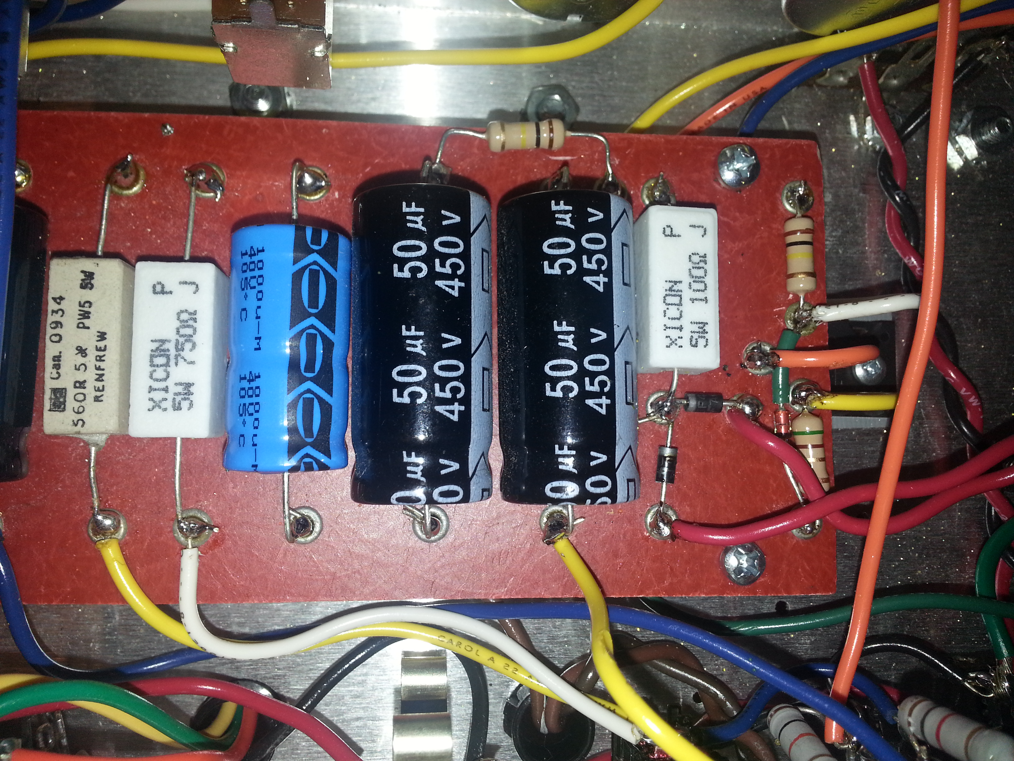

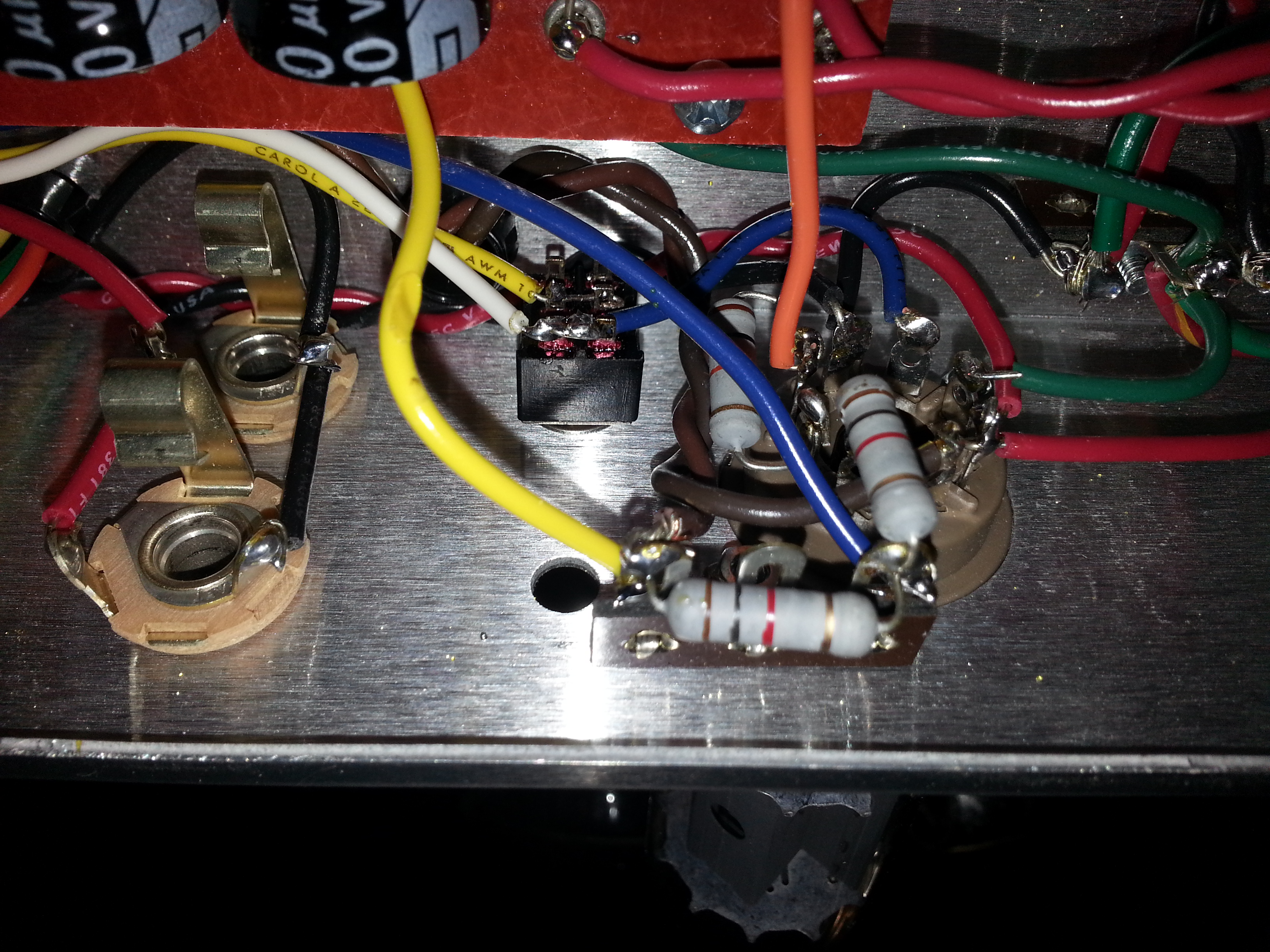

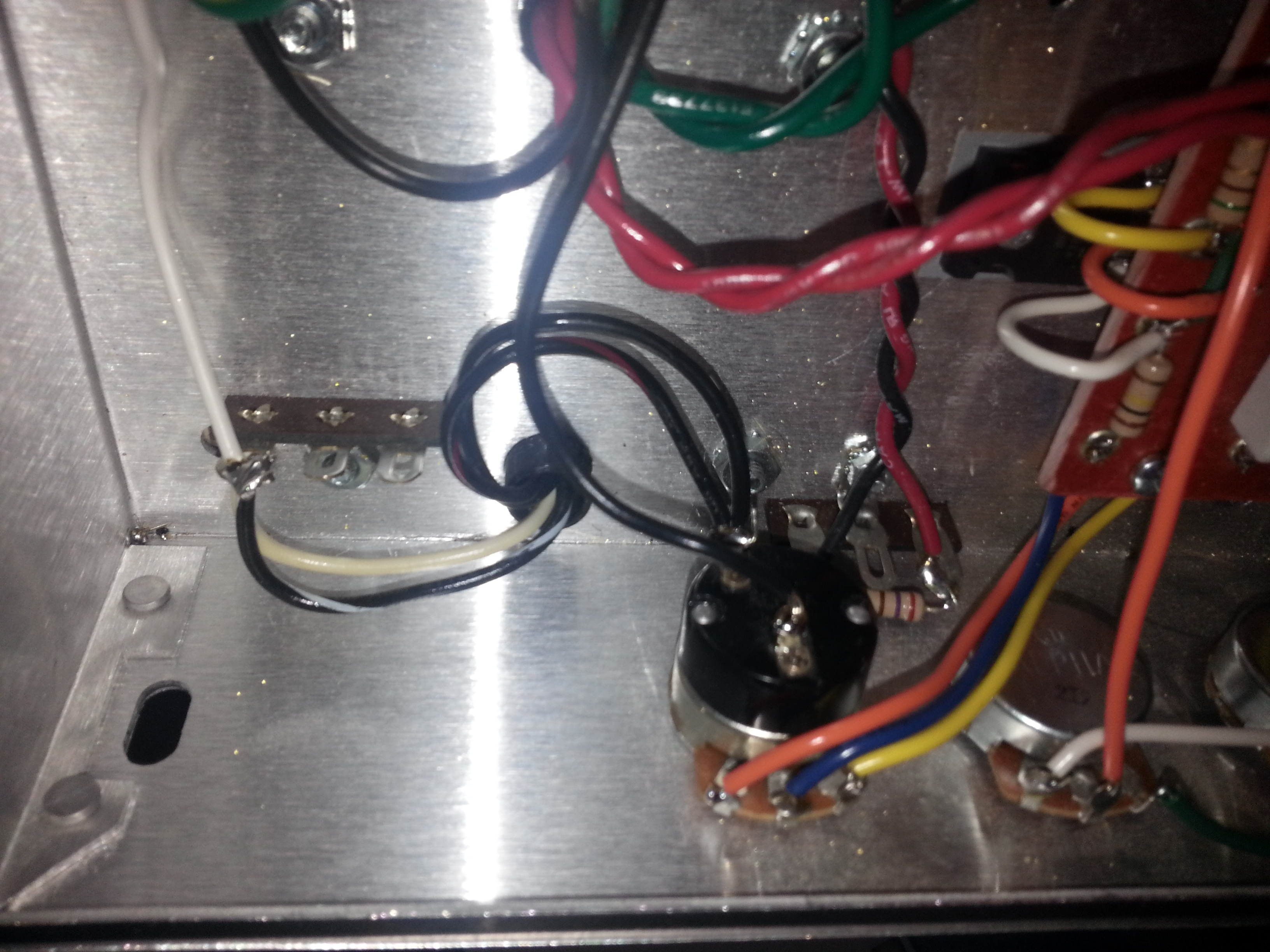

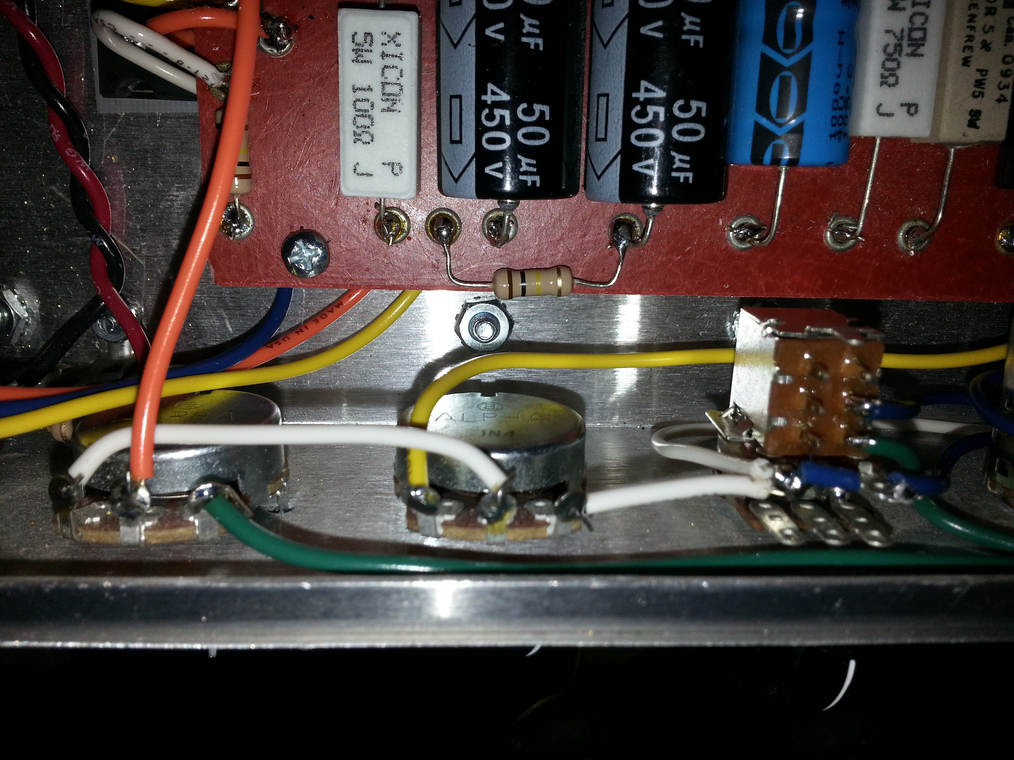

Can you post a good picture of your power side wiring?
PostPosted: Mon Aug 31, 2015 10:03 pm
Posts: 41
Thanks for taking a look Stephen.

PostPosted: Mon Aug 31, 2015 10:33 pm
in picture 3, showing the connections to the power switch, is there 124V between the switch terminal and the 3-lug terminal strip? there should be.
PostPosted: Tue Sep 01, 2015 6:00 pm
Posts: 41
Yes, it's 124V from the switch terminal to the 3-lug strip.
PostPosted: Tue Sep 01, 2015 8:24 pm
And what is coming out is half what was expected. If you are getting only half of the expected voltage out, It seems like the Wires to the transformer are labelled wrong. From the picture you posted, they look correctly connected according to the wiring diagram and layout.
PostPosted: Tue Sep 01, 2015 9:27 pm

G'day Michael,
Probably stating the obvious but those VRM voltages look very weird to me (also, for clarification are you calling C12 "1st"?. Just pointing this out because the "first" cap is actually the second cap in from the end of the board (C13) which is connected directly to rectifier diodes, hence "first").
It's hard to tell from the pics where the connections go as they seem to be under the board but it might be worth double checking the VRM control pot to board connections for correct point to point routing and also soldering/connection quality.
For example, on an amp with tubes in and speaker connected, I'd expect readings more like:
VRM B+ measured at positive side of C12 =
Position Idle = 40 VDC
Position MAX = 427 VDC
