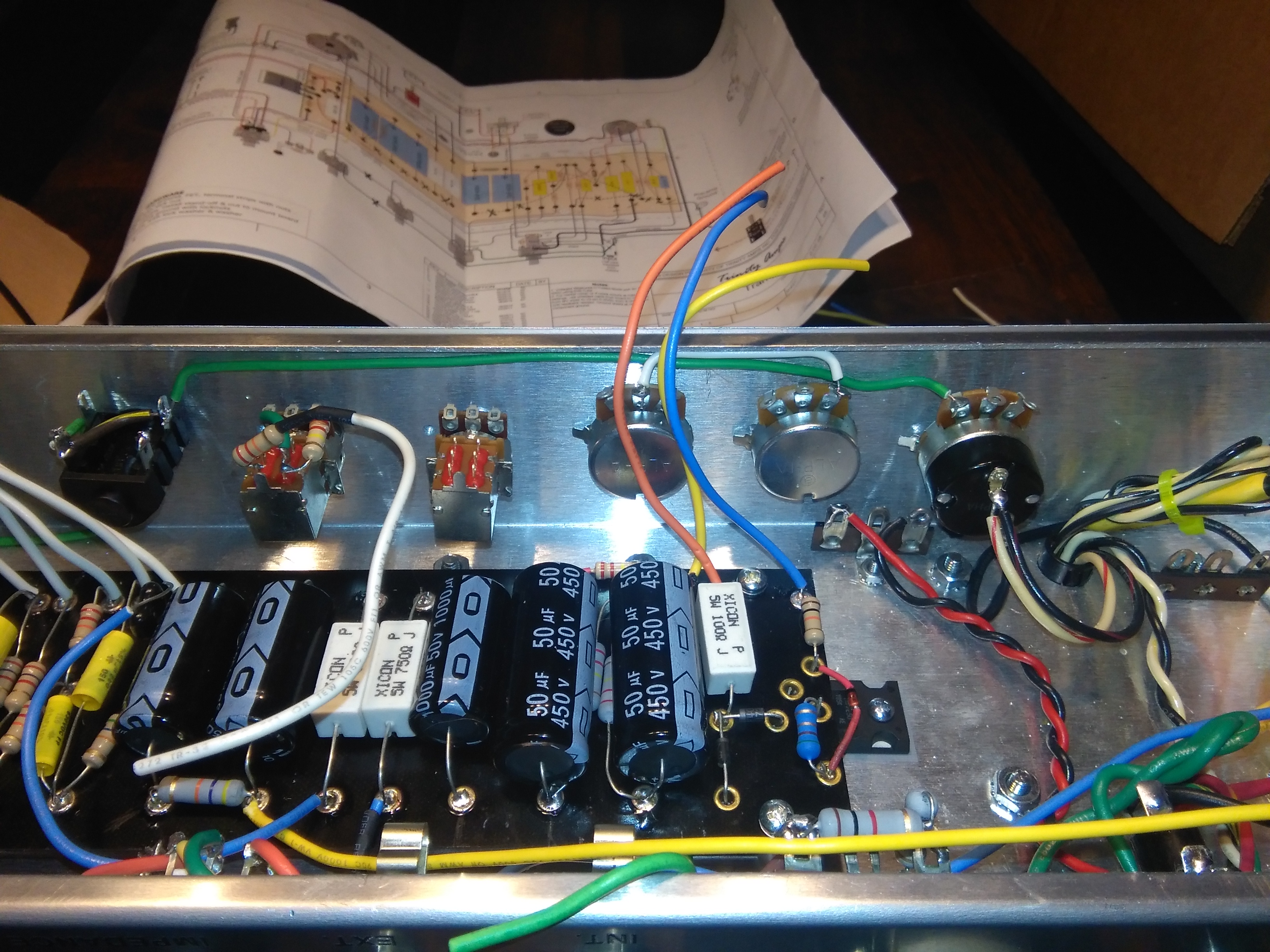

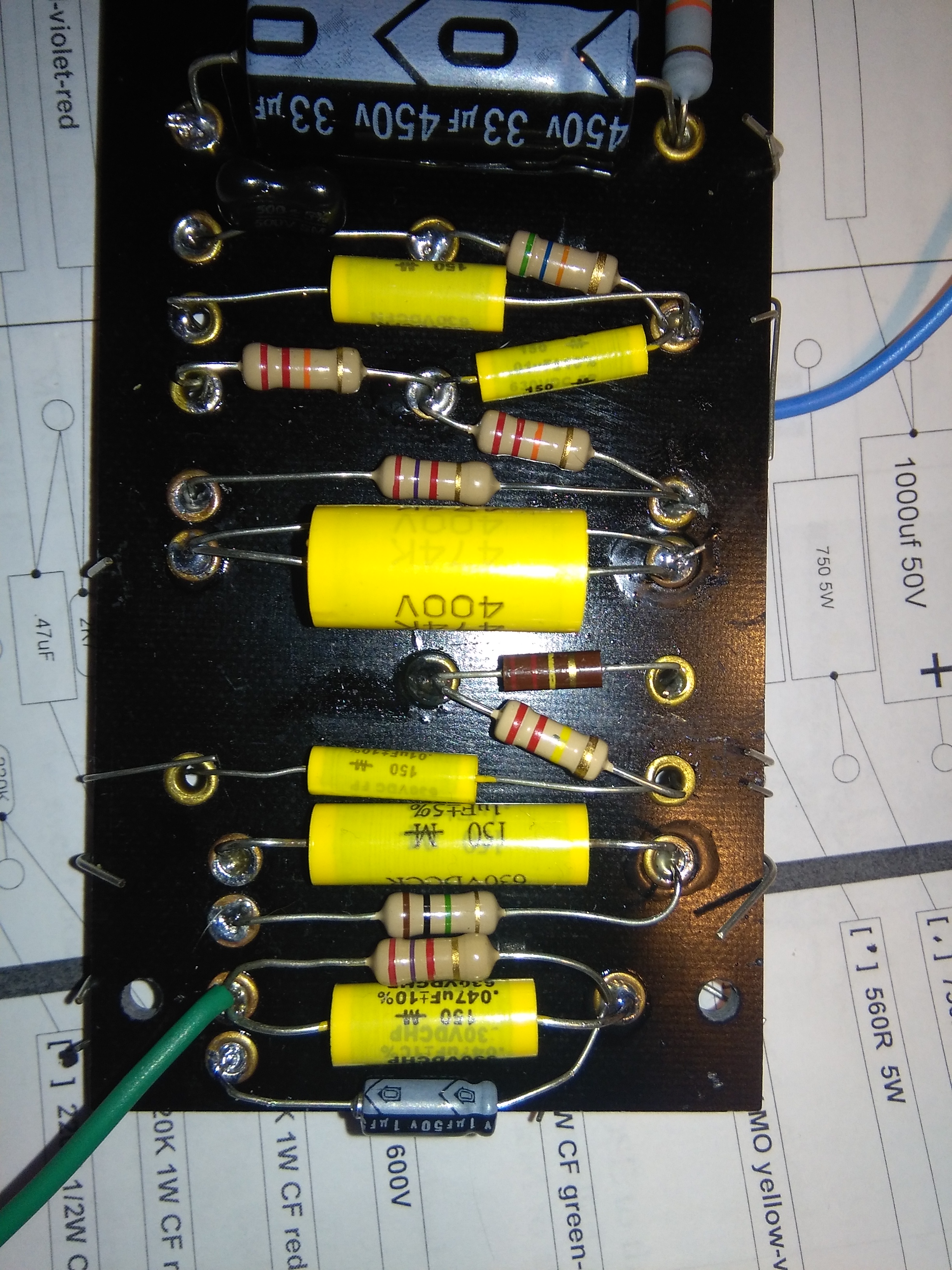

Ok, here's up to date pics. I know the 10k c.f. resistor goes from the ground lug to pin #2 on the 12ax7 socket, but can't find where the 270 ohm 1/2 watt goes. And, I found the 10k 2w MO I thought was missing. I had it on the board. If anyone sees anything amiss, please speak up, I'm still a newb at this!!

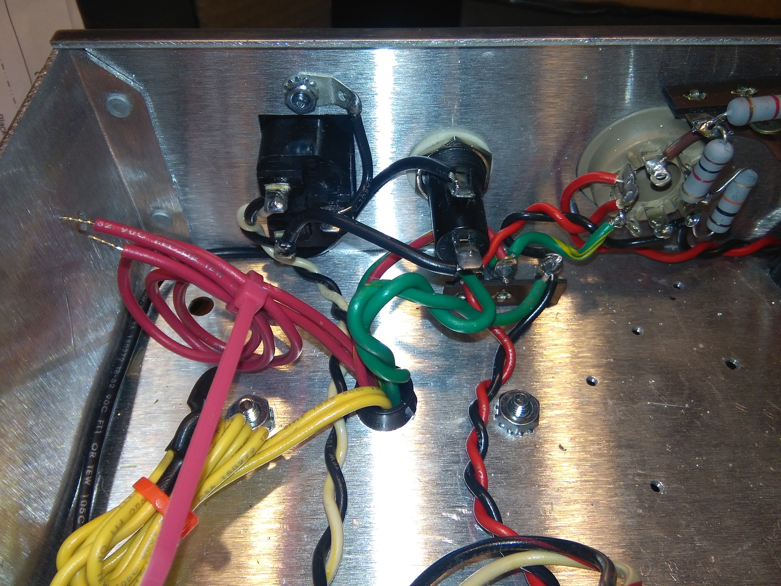

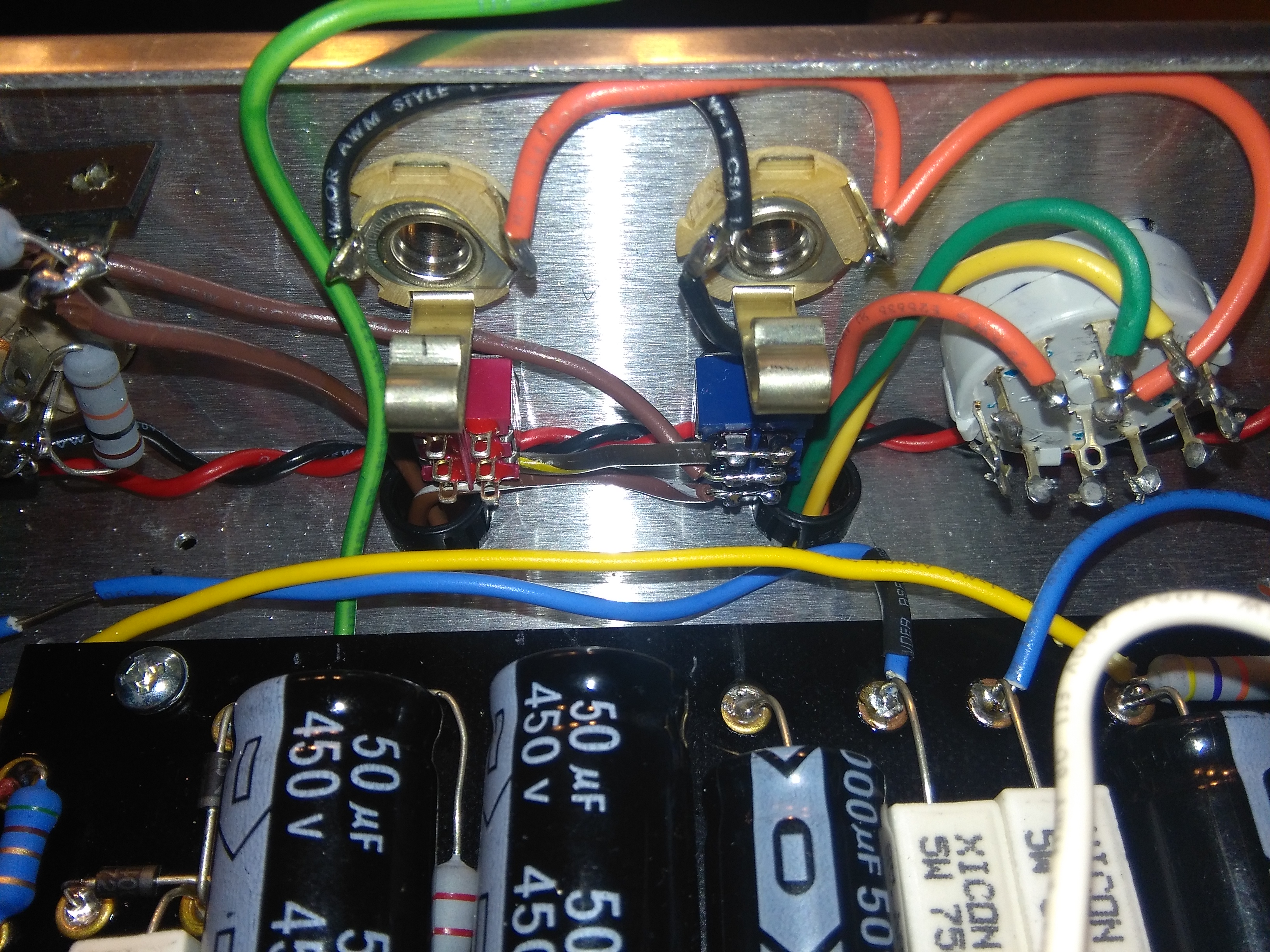

Here's the board, my phone died earlier before I could upload all of em. Trying to take close up, detailed pics for you guys to check my work, and if I'm right, for future builders to reference.

The pictures look good. I didn't check to make sure all the parts are in the right place, but I didn't see any glaring mistakes.
Red-purple-brown is 270 ohms. Like Hankules said, the only place I see a 270 ohm resistor on the schematic and the layout drawing is on the LED serving as the pilot light.

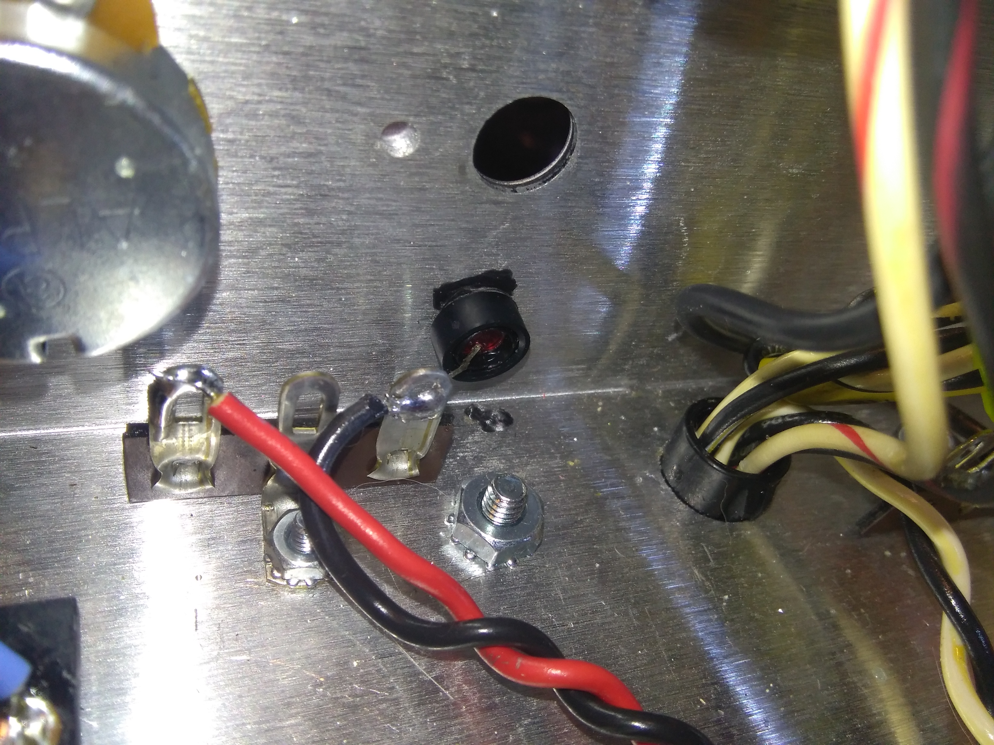

Epi, please post pics of interior, front panel and the resistor. There should be a terminal strip near the pilot light and should have one end soldered to a lead on the LED and the other to the terminal strip. with every thing connected , it should look like the picture on page 30 of the build guide. There is only one (1) 270 ohm resistor listed in the Bill of Materials (BOM). Also, you might consider going to the Tramp support page and downloading the COLOR, PDF build guide if you haven't already. Steven prints the one that come with the kit in black and white, the color guide made it easier for me to pick out some details

Ok, I figured out where my zener diode got lost at... I used it in place of the 270 ohm for the l.e.d. I had a snafu removing the zener diode, and broke a lead of the led, so now I gotta order a new one of those. Good thing is, I know what I did wrong!

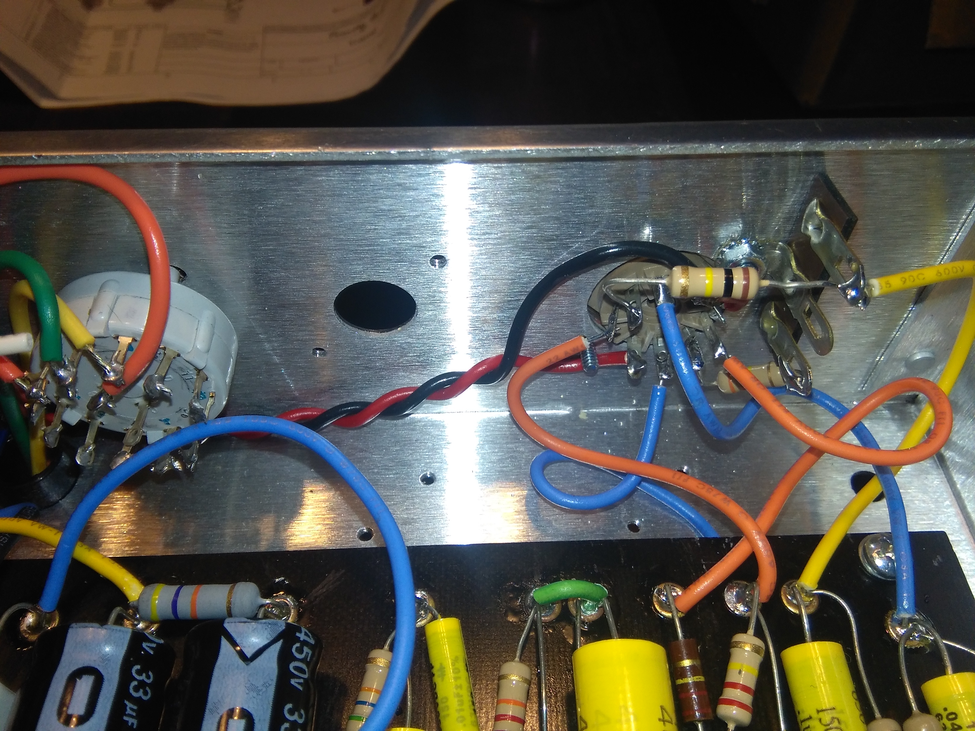

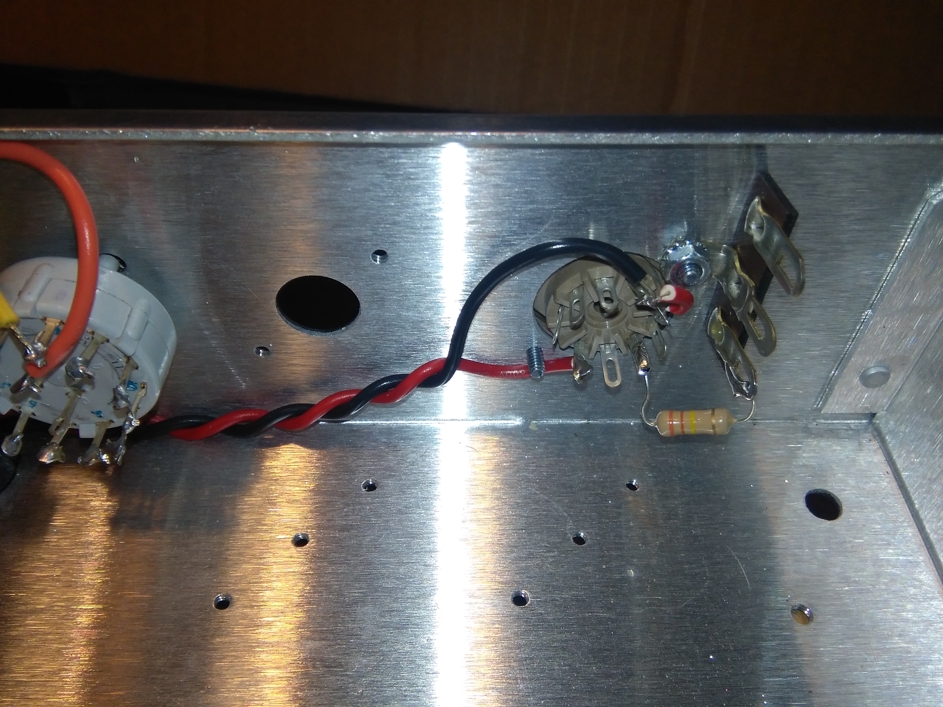

As of now, most fly leads aren't connected yet, but I'm working on em. Here's the current state.
