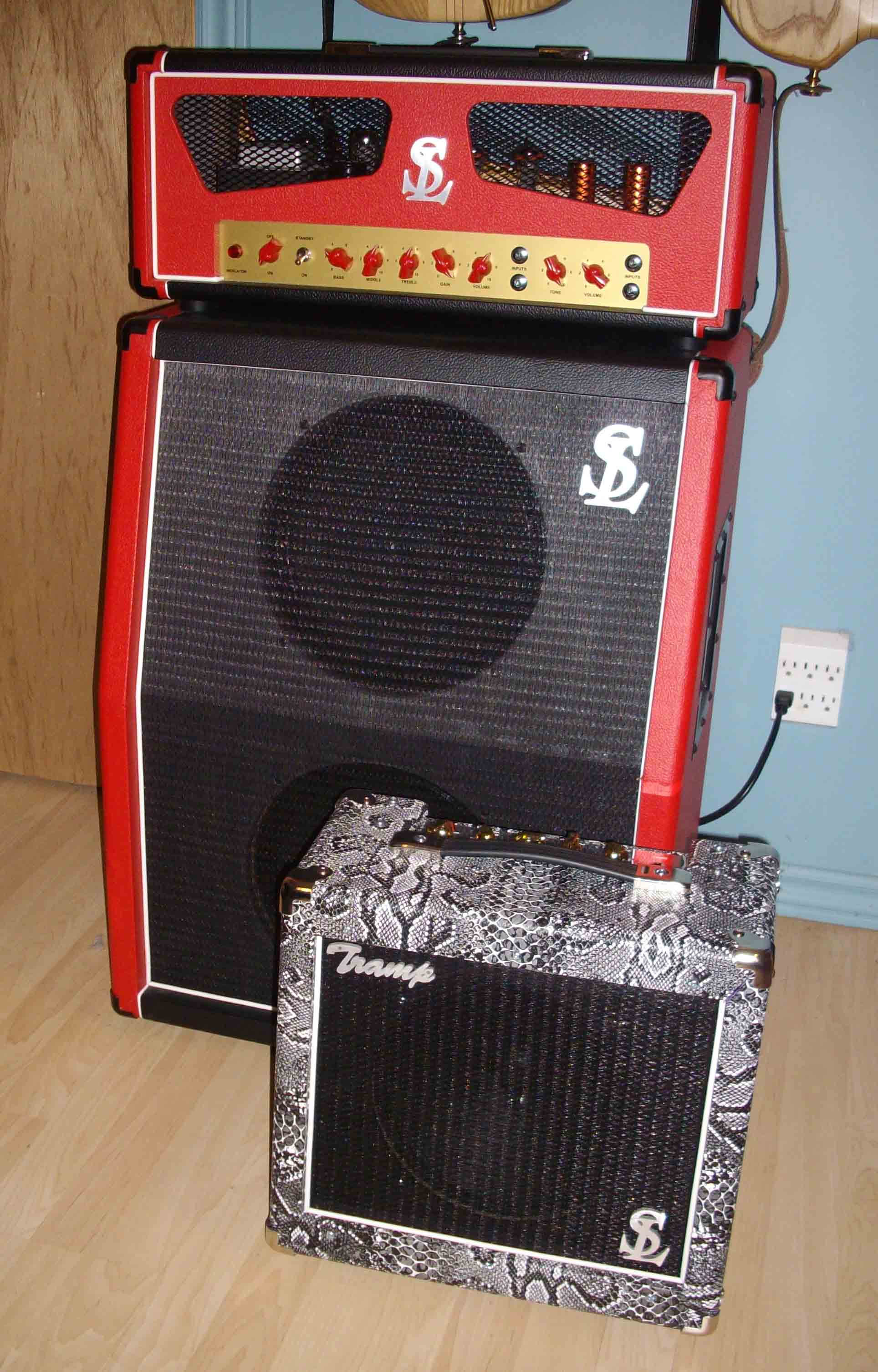

The cabinet is pretty small at 15.5" wide by 14 high. The depth at the top is 7.5" and 9.5" at the bottom. It is the smallest I can make it to accomodate the big Transformer and that particular Speaker. If I want to try another speaker I will have to connect a cabinet or else buy another Tramp kit. :D By the way, do you know if we can remove the Bell cover on the Jensen Blackbird Speaker?
As far as I can tell, the sound is fantastic. I really like it. I tried the Tramp with a Strat and a Les Paul and so far I've got plenty of different sound. For an amp with only one preamp tube it got very good distortion and the tweed tone is fantastic with the Strat. Thank's guys for working out a super sounding little amp. Great for practicing at home and more than loud enough.

Here is a pic for size comparison, the Tramp and my 18 Watts V6 with 2 speaker cab.
