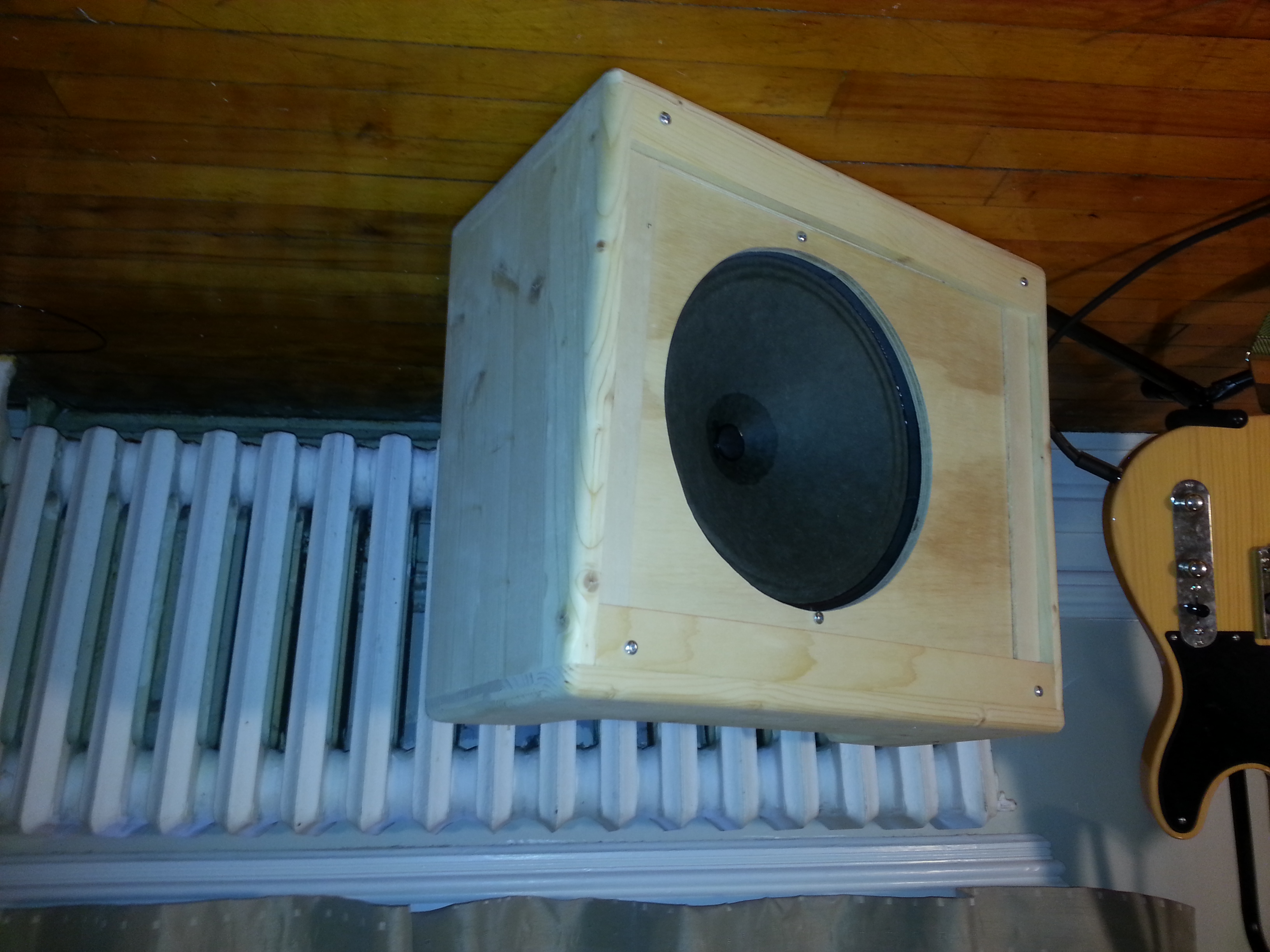

On a positive my cabinet is ready for the tweed

Your cabinet looks good. Did you build it yourself?
PostPosted: Sun Sep 06, 2015 7:05 am
Posts: 41
Yes. There are plenty of plans online and it didn't require any troubleshooting like the wiring! :oops:

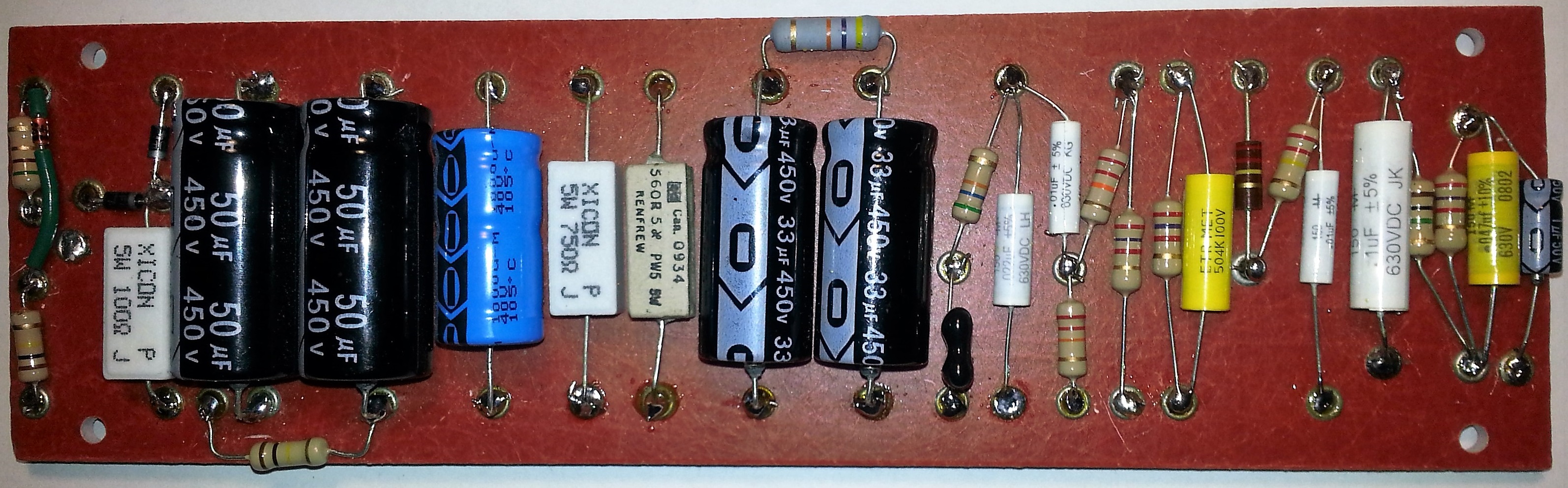

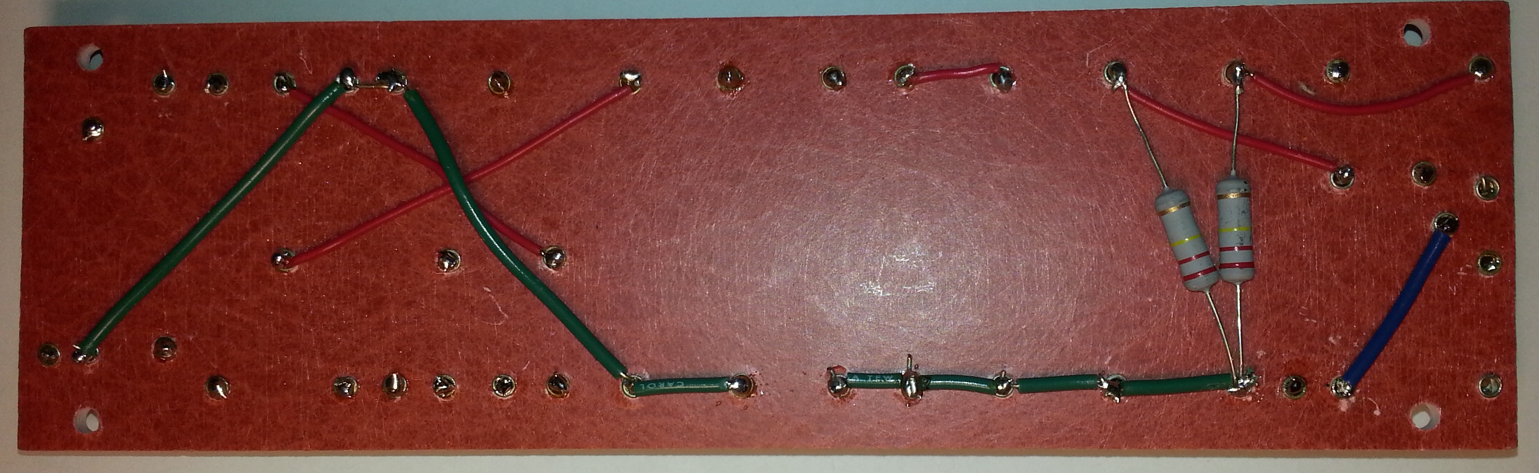

The bottom and top of the board after:
1. Confirmed top and bottom parts layout against specs. Nothing was out of place.
2. Reflow solder (my attempt anyway).
3. Measured all resistors and diodes, which are either right on or very close.
4. Wait for some comments to make sure I'm on track. (Please and thank you).
5. Put the board back in.

The board looks OK for the most part. There might still be some iffy solder connections. Use your meter to check for continuity between everything that should be connected. Probe on the components' leads and not the eyelets. That way you can find bad solder connections.
You have a 100K resistor on the board below C12 and C13. This is R22 in the VRM circuit. It's shown as a 220K on the schematic and layout posted here on the forum. It sets the lower limit for the VRM. 100K just gives you more range. Everything else looks to be the right part in the right place.
I would say any N channel MOSFET that is close to the voltage and current specs will work in the VRM.
