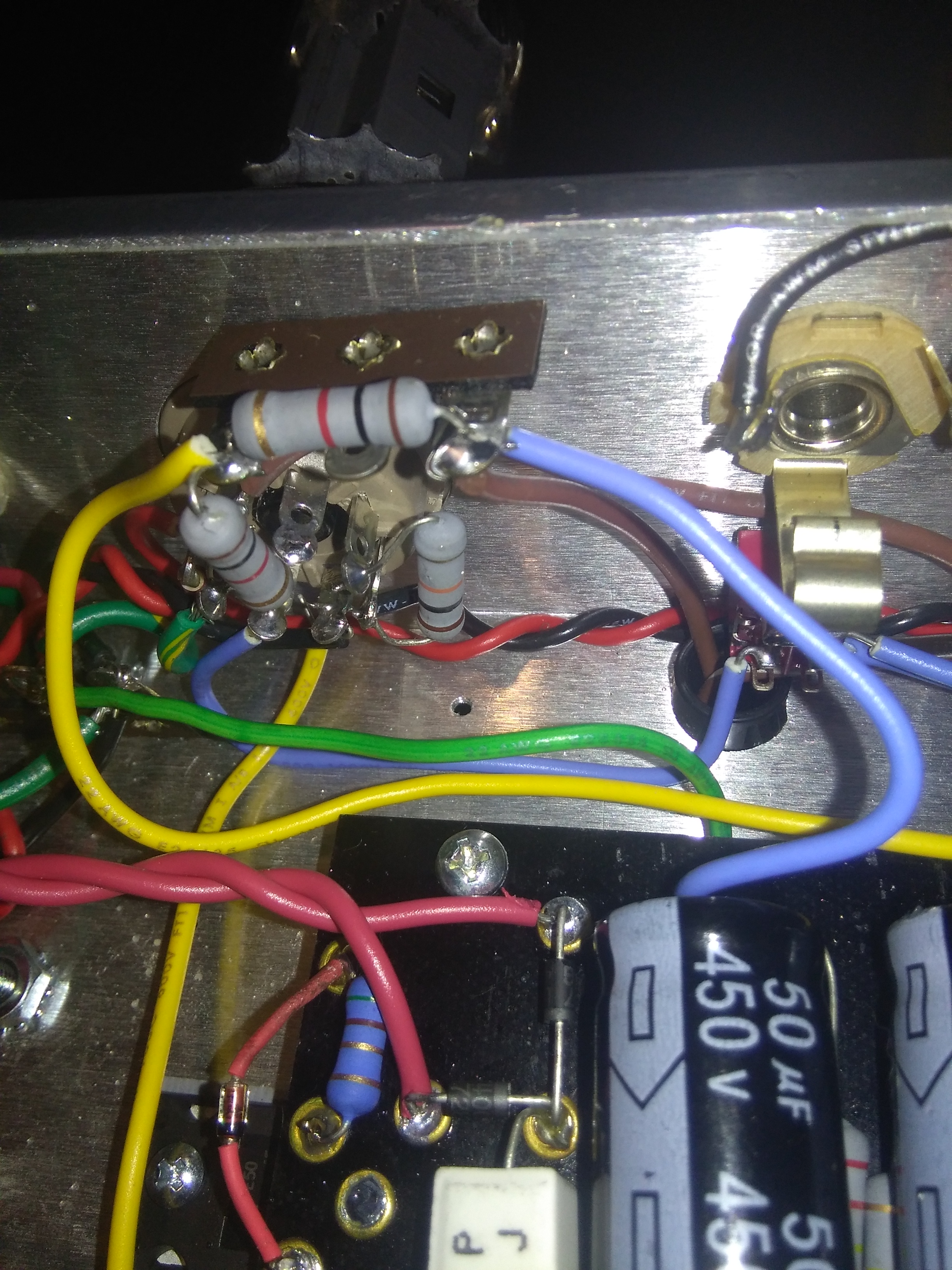

That's where my voltage readings stop. I get nothing on any pre amp tube pins to ground, or power tube pins, though both tubes are glowing orange. I get nothing from the 1000uf capacitor either, and so on. When I turn the amp off, and plug in a cable to the input, I have continuity from the cable tip to ground. I've waited what seems like forever to build this beautiful amp, now I gotta get it playing loud. Are there Any pics I can post that may be helpful diagnosing any problem? Or any other information I could supply?
PostPosted: Wed Aug 21, 2019 1:47 pm
Yes, some pictures might help.
If you have no voltage readings at any of the power tube pins but they read OK at C12 and C13, check your connections to the 1k resistor on the terminal strip by the power tube. Also check the wire running from C12 on the board to the 1k resistor.
With a cord plugged into the input, you shouldn't see a short from tip to ground. If you see a tip to ground short with a cord plugged in, then check your wiring to the input jack. You should see a very low resistance reading from the tip of the cord to the input end of C1, though.
And with no cord plugged in there should be a short from the input end of C1 to ground.
PostPosted: Thu Aug 22, 2019 7:39 am
Posts: 27
I was missing a wire from c12 to 1k @power tube terminal. Now, I'm getting readings to all the big caps at least, and I get a little buzz when I'm turning up the vrm, but nothing from the speaker. I get a buzz when I'm doing voltage readings as well.

PostPosted: Fri Aug 23, 2019 4:57 am
Posts: 27
Ok, went to look inside tonight, and found that the master volume pot wasn't connected to pin 7 on the power tube. I have sound now in both modes, but couldn't turn it up all the way, as everyone else in my house is sleeping. I'll post final startup voltages asap.
