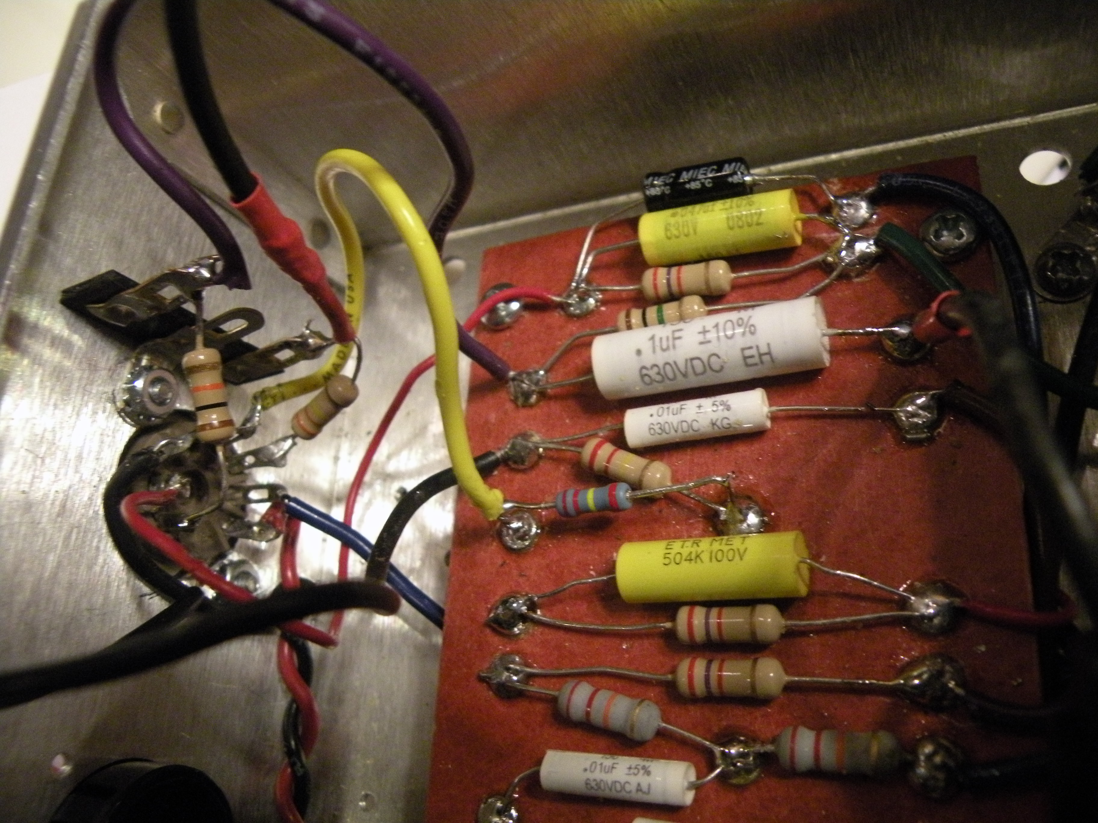

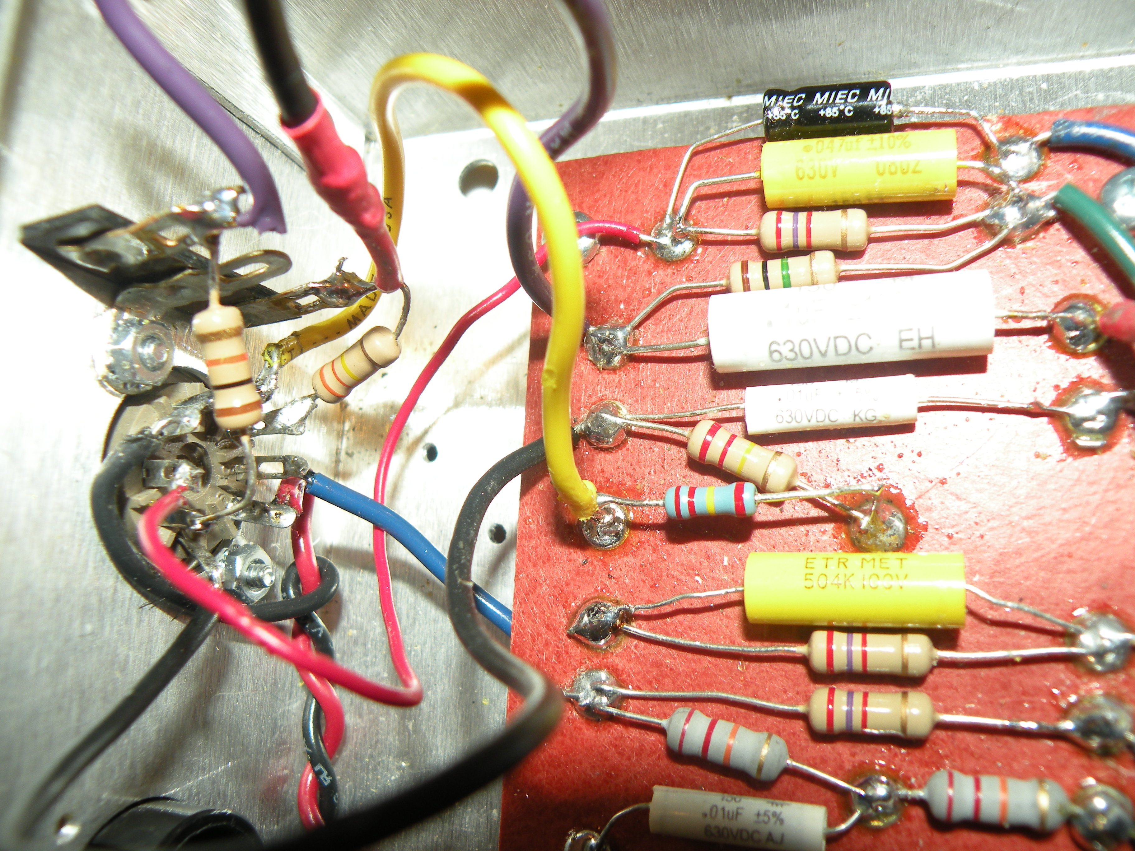

Thanks for the quick reply. NOPE, no sound. I plugged in a guitar and I know the cable is good (I used it last night with a different amp), but no sound. I get buzz before that .1uf cap, but not after it. I will try resoldering that cap and if necessary replace it also.

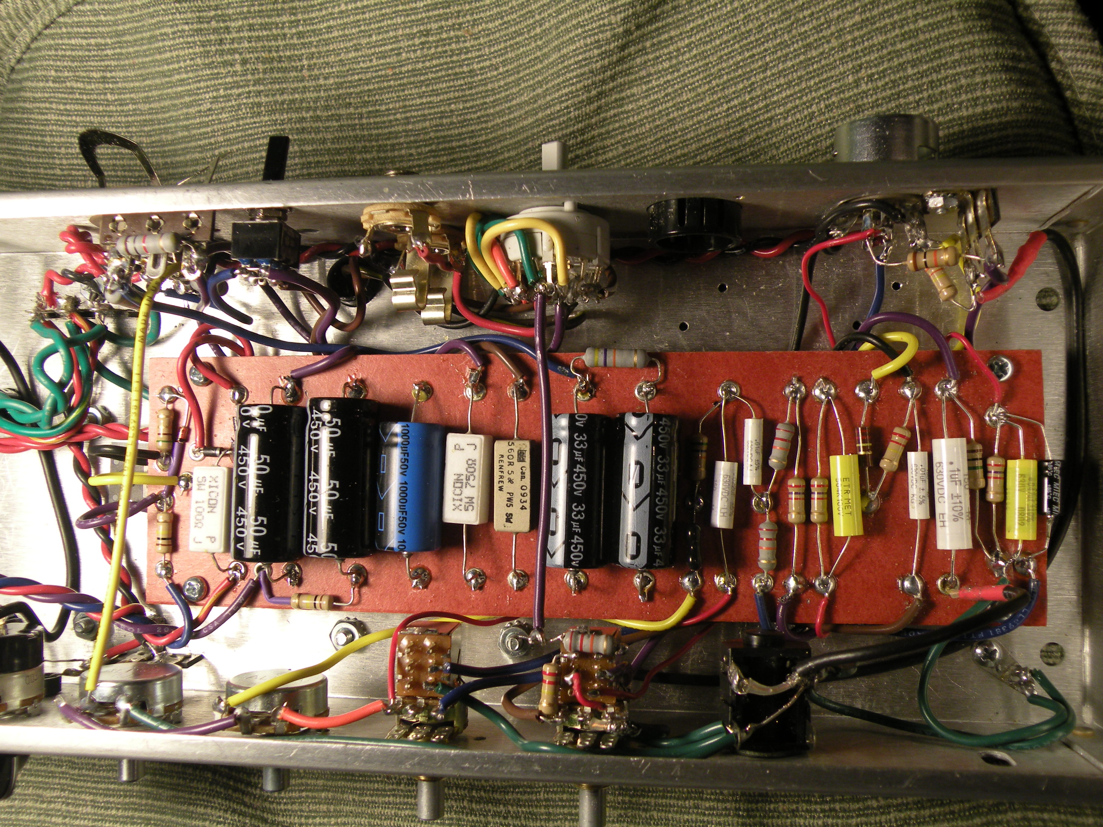

Also, here are two pictures of the preamp side of the board with the new 220k cc 1/2w resistor.
PostPosted: Tue Jan 15, 2013 10:18 pm
I wonder now if the 2 shielded cables are OK? :?:
Preparing them without shorting the conductor to the shield seems to catch a few builders. :idea:
Might be worth checking.
Snowy

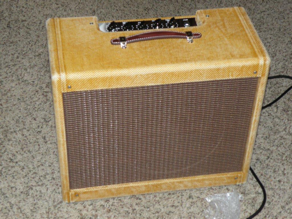

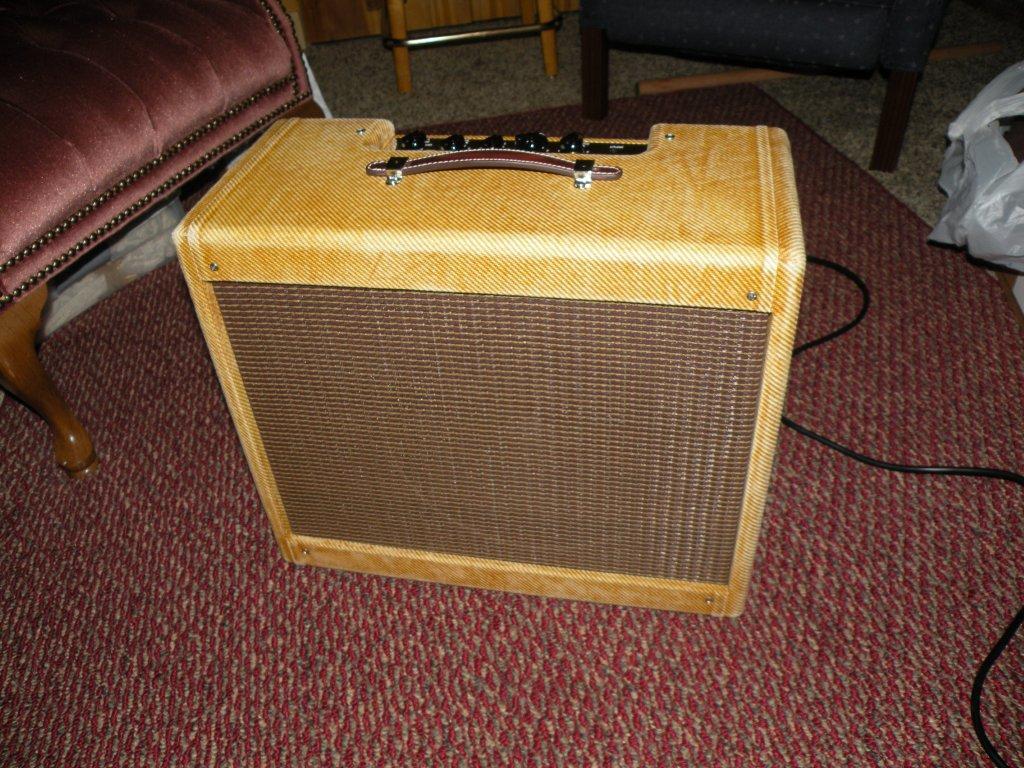

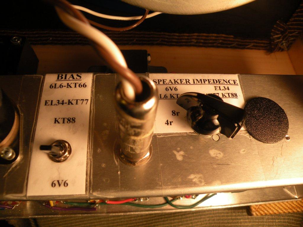

"Vintage" Tramp pictures. The cabinet is a modified 5e3 with the chassis cut out for the Tramp's dimension. I shellaced it with a clear spray first, then four coats of a mixture 1/4 clear, 1/4 amber and 1/2 denatured alcohol. Then I sanded it down to give it a vintage but not tortured look. I think it looks like it is from the "60's" or "70's" and has some wear, but no tears. One of the pictures also shows it with a KT88
The last picture shows a couple of labels for the bias switch and the rotary impedance switch.

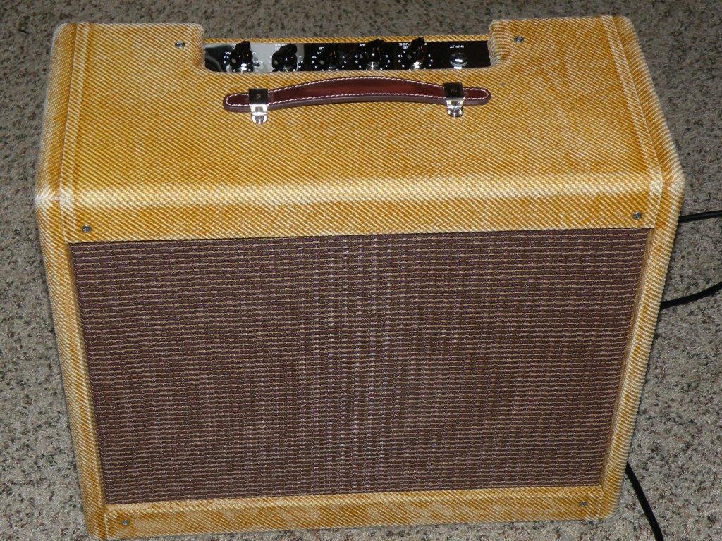

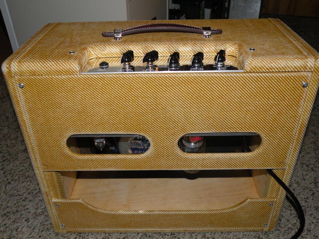

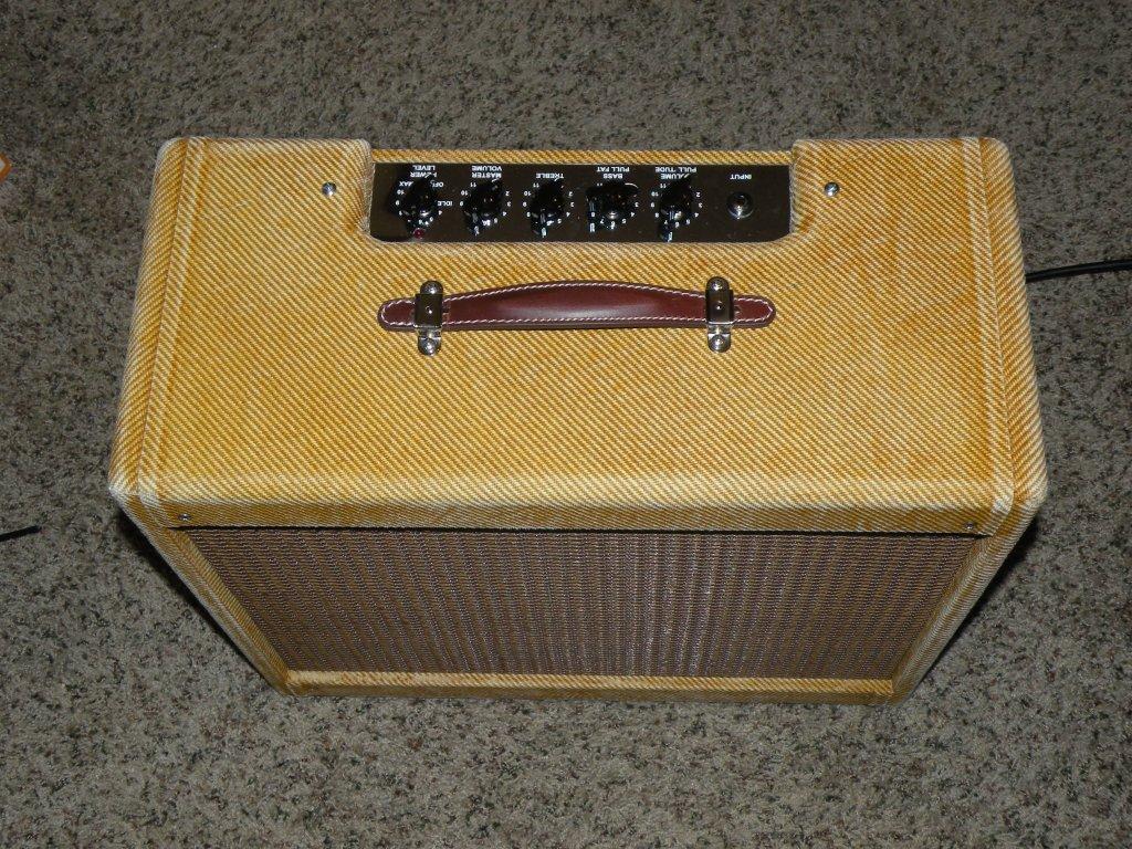

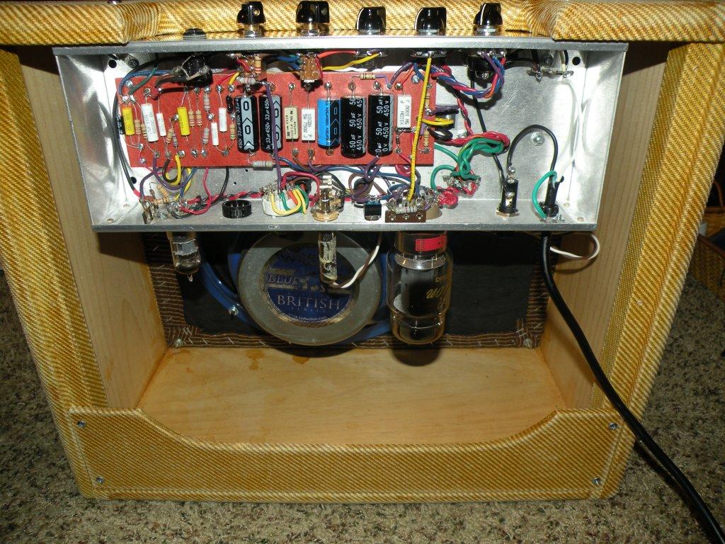

Here are three more pictures of my "vintage Tweed" Tramp Combo.
The first is looking down at the control panel.
The second is looking at the back with the KT88. You can see that there is plenty of room for a Celestion Blue, or a Alinco Blue Dog, or a Eminence Red Fang. By moving the speaker opening to the preamp side this allowed for more space in the cabinent.
Finally, one picture of her front.
