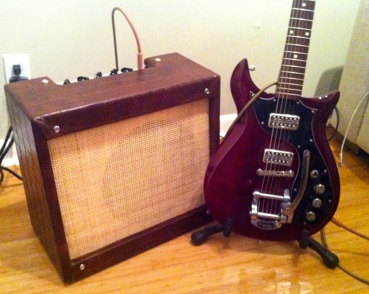

I completed my Tramp earlier this year, but have been so lost in playing it that I never got around to showing you fine fellows any photos of the completed beast. Here's a few, with thanks to everyone who helped with the few questions I had.
Here's the girl all dressed up in leather and cane.

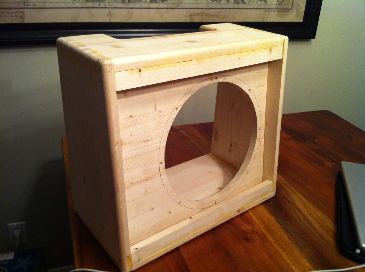

Fully undressed, so you can see my first-ever box joints. Note the room for a 12".

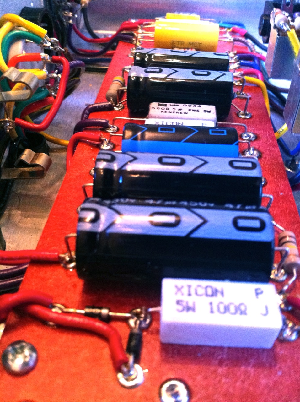

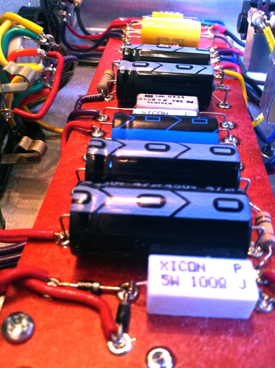

I'm rather (shamefully) proud of my wiring and routing.

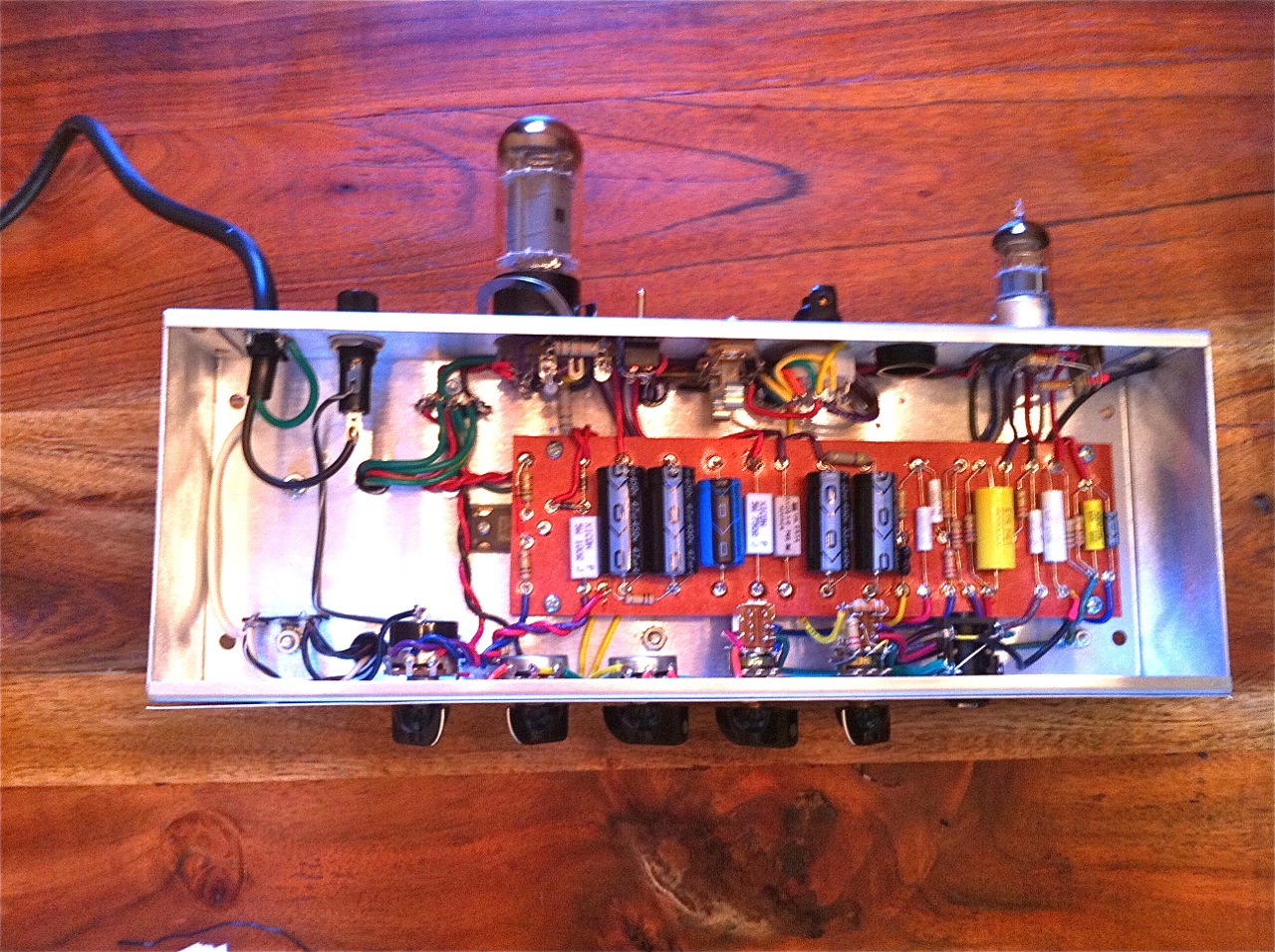

Looking down into the chassis.

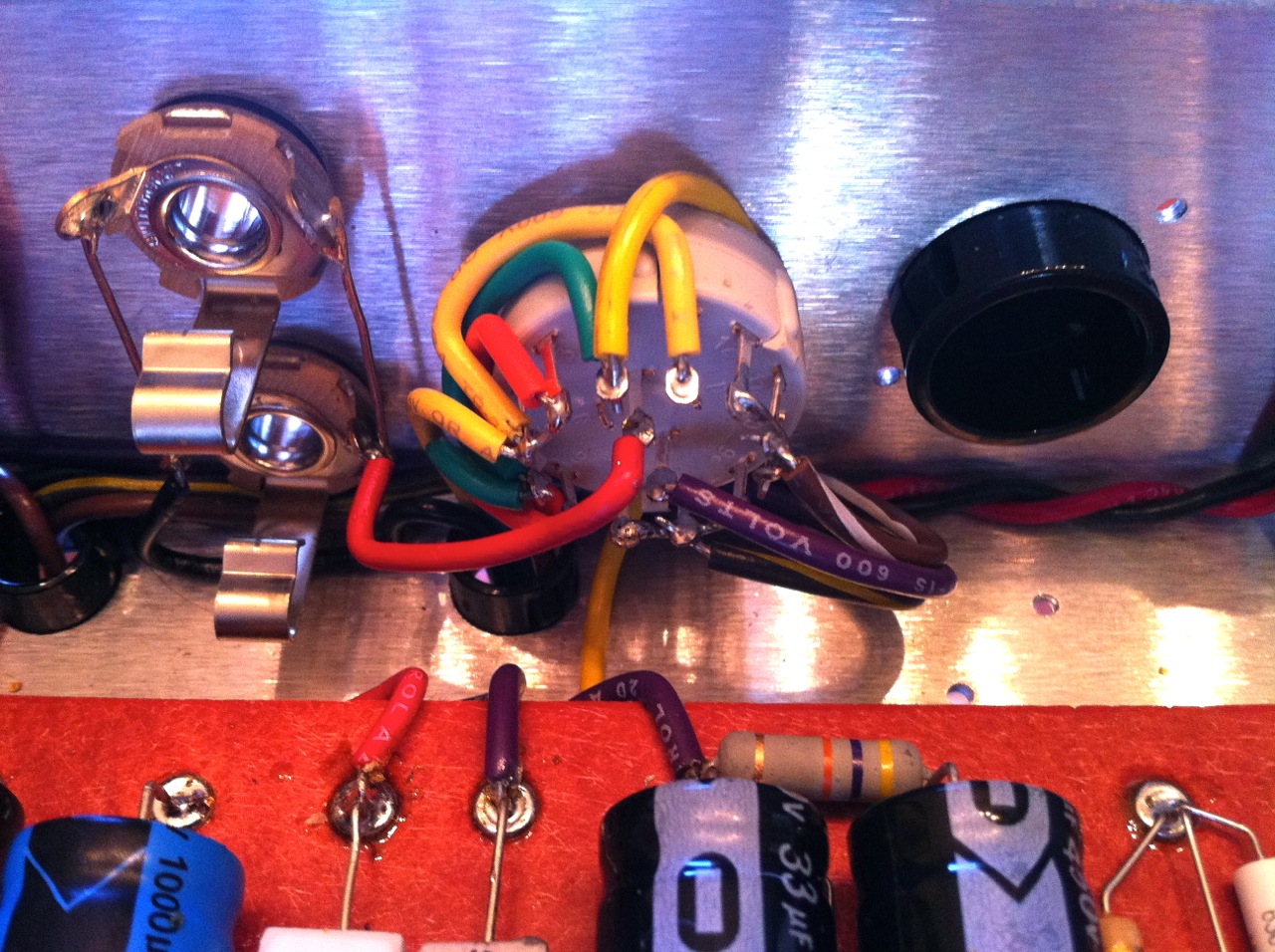

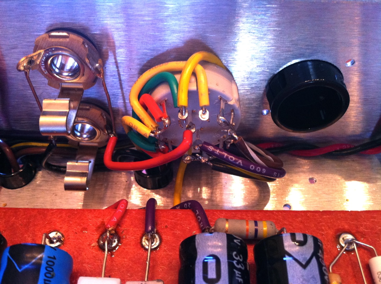

Closeup of the rotary, wired for multi-tube use.

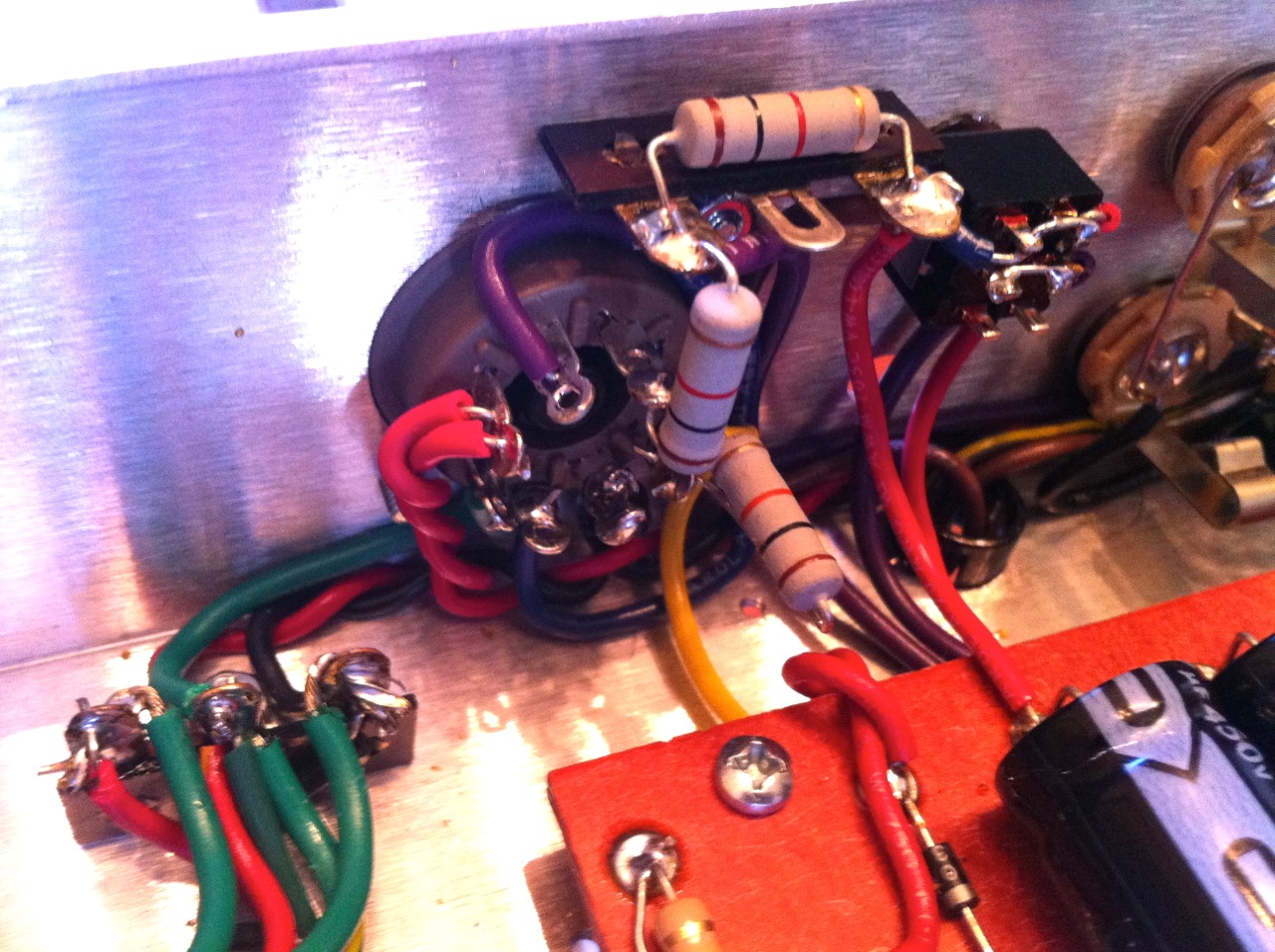

Aaaand the preamp socket, just 'cause I like 90ยบ lead bends.

 Post subject: Re: Leather-clad Tramp
PostPosted: Tue Oct 23, 2012 1:28 am
Joined: Wed Sep 26, 2012 8:57 pm
Posts: 19
Sexy wiring job!

I am thinking about buying a Tramp kit for a combo cab and would want to run a 12" speaker.
Did you build your own cab because the Trinity Tramp cab does not accommodate a 12"?
I don't have the ability to build my own cab... do you know if Trinity can custom make a Tramp cab that would handle a 12" speaker?
