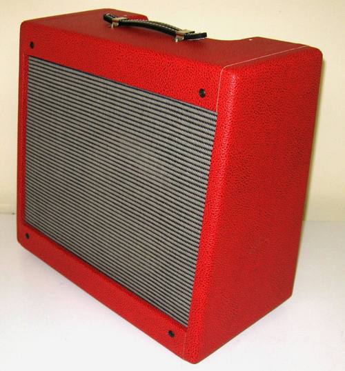

A real jem going to ajcoholic.
Garnet Levant Tolex with Bluesbreaker grill cloth.

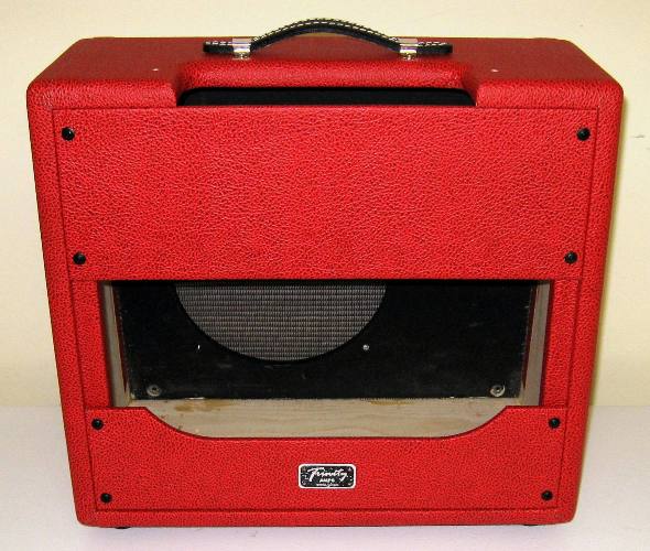

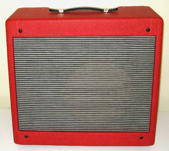

Nice behind too!!
