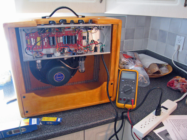

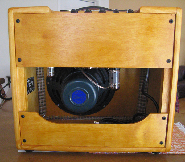

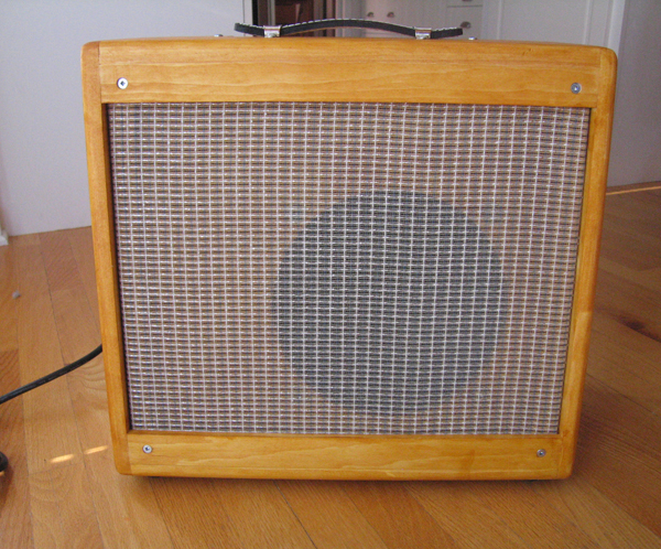

Finished a Tramp build today.
It was a first build so I decided to go slowly and check everything as I got along.
The instructions and schematics that come with the amp are indispensable, as is the forum.
Here are a few pictures of the completed Tramp.
No sound came out at first try but played fine after I realized I had forgotten the ground wire originating from the big capacitors on the Eyelet Board.
It is the best amp tonewise I have ever tried and easily beats my Blues Jr and Traynor oldie.
Edited to correct a few typos and add that the speaker is a BBQ 10A100T, 25 watts, 8 ohms.
Has anyone tried the Tramp with an RCA 6L6GC Black Plate tube?
I found one on Ebay on May 14 and should be receiving it in 10 to 15 days.

PostPosted: Tue May 17, 2011 12:18 pm
Posts: 67
Looks great!
A LOT of people miss that one. I did.
When I realized it, I looked at the layout and it's there. Always was.
..and when you realize what's all connected there and notice that it doesn't go anywhere without that ground wire, *WHACK* right on the forehead. :lol:
