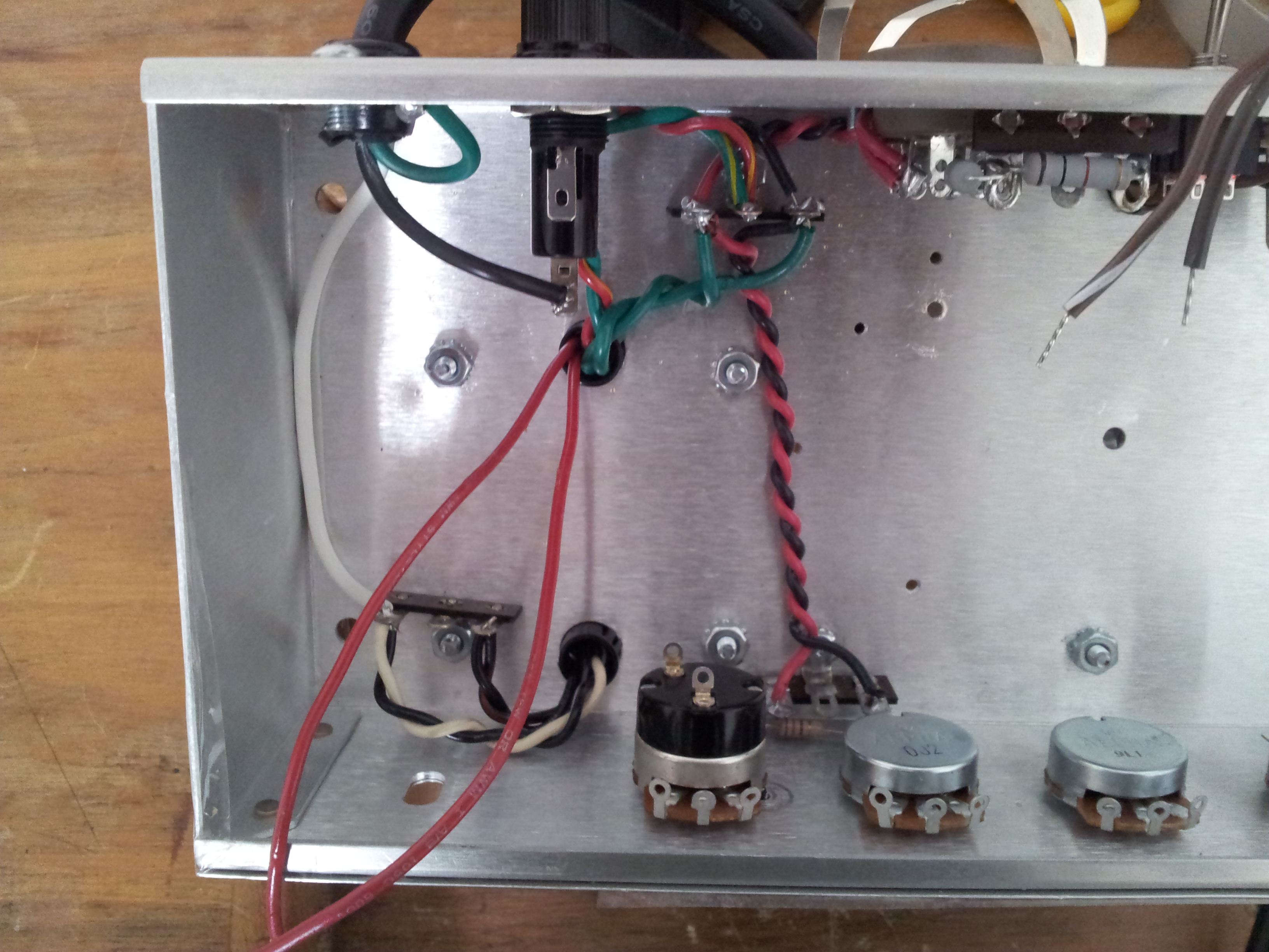

This is what i´ve got. The question is either to connect from the Fuse (the empty middle connection) to the TOP RIGHT CONNECTION of the VRM or the BOTTOM LEFT of the VRM.

Oh.. now I understand your question when you say "VRM" you're talking about the pot with the switch. If that's the case ..either or.. It's a simple open/closed switch. So as long as you only use the 2 connections on the switch part of the pot..and not the other 3 lugs of the actual potentiometer..you can't go wrong!
Stew
