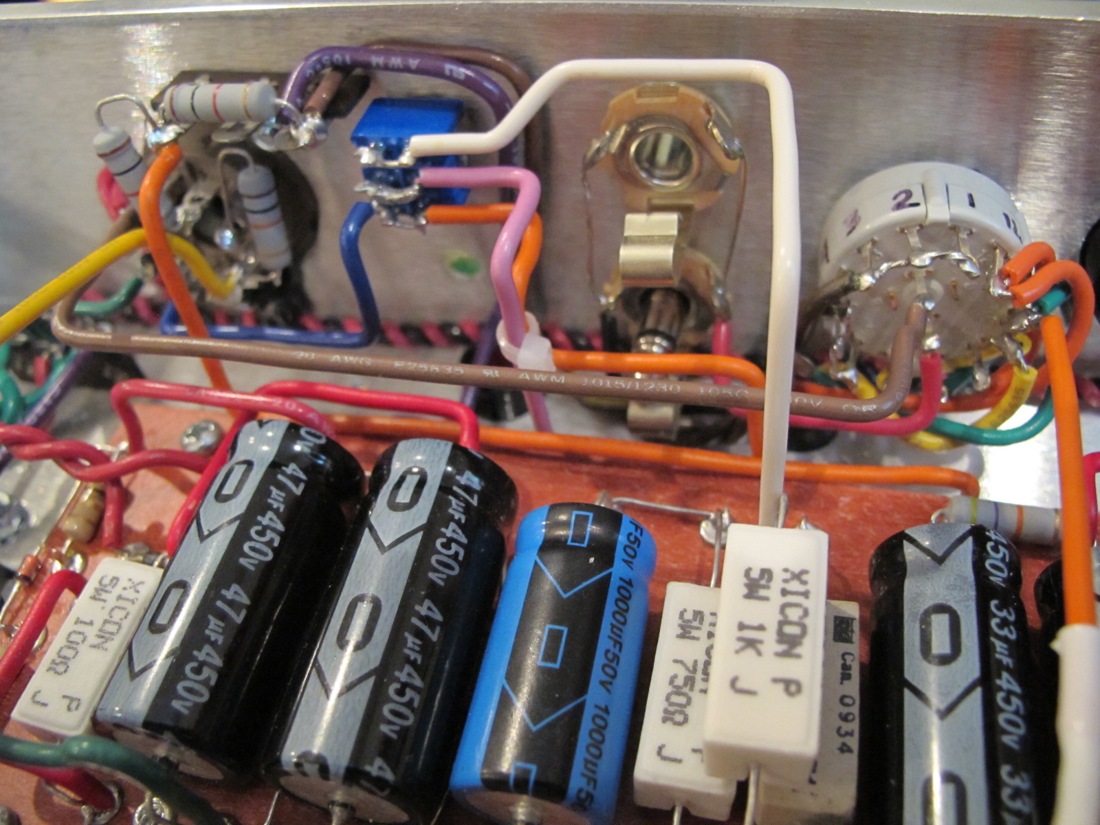

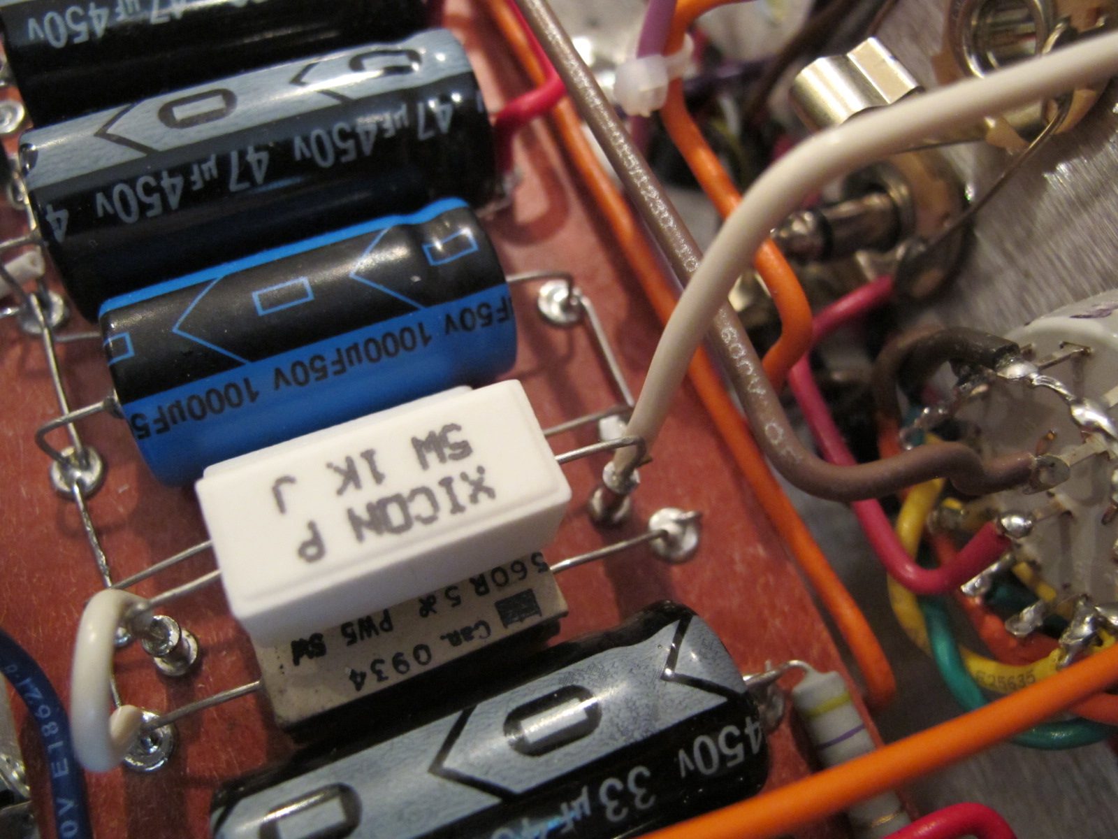

I have continued to experiment with the TRAMP.
I installed a selectable 5W, 1000 ohm ceramic wire-wound resistor, in parallel with the stock 750 ohm cathode bias resistor. The combination measures out at 423 ohms, well within the 5% nominal tolerance of the components.

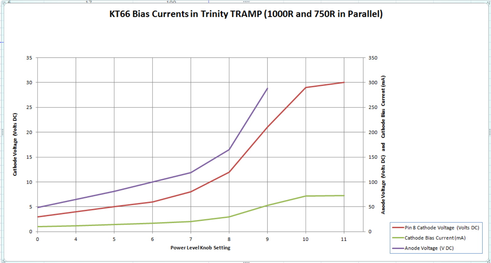

With a JJ KT66 tube, I measure the following voltage/current relationships:
My question is, Do these curves look "correct"? I was unable to take voltages with the Power Level > 9. I though I heard the beginning of "crackling" sounds from the speaker as I slowly advanced the Power Level knob, so I immediately discontinued the experiment. Does the onset of crackling suggest that the bias level is too high?
MANY THANKS for any input,
S_Two
