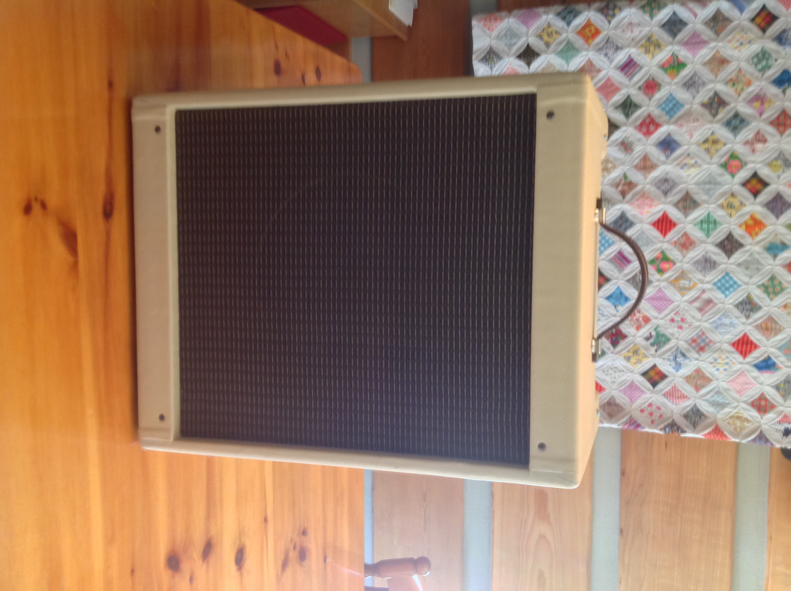

I just decided to take it on down. He was happy with it. Here's the completed combo.
