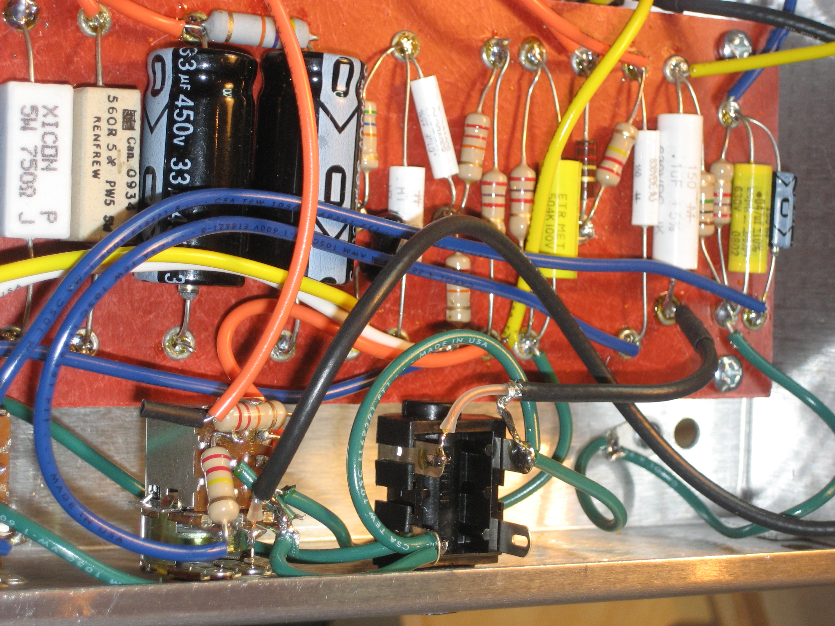

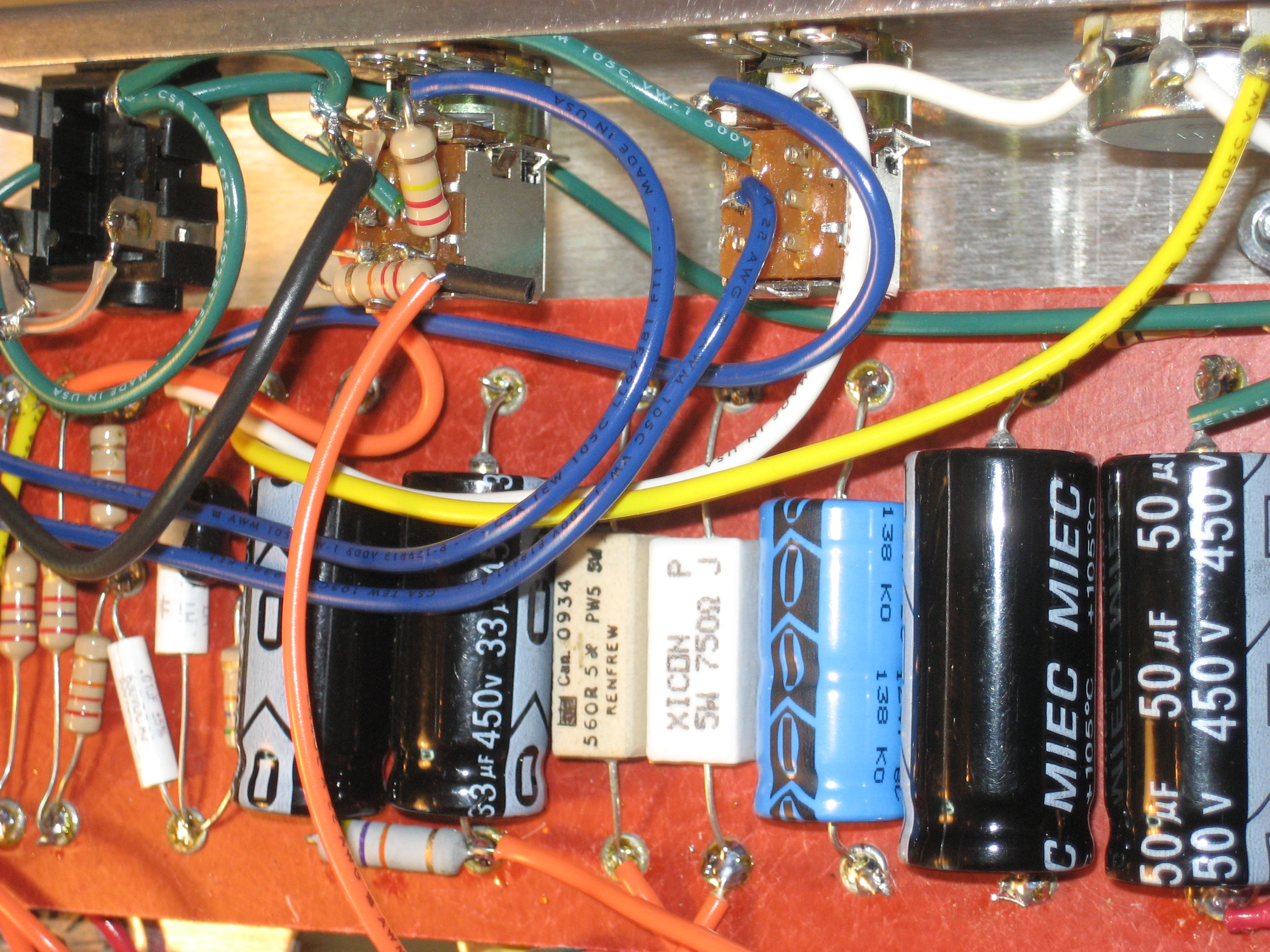

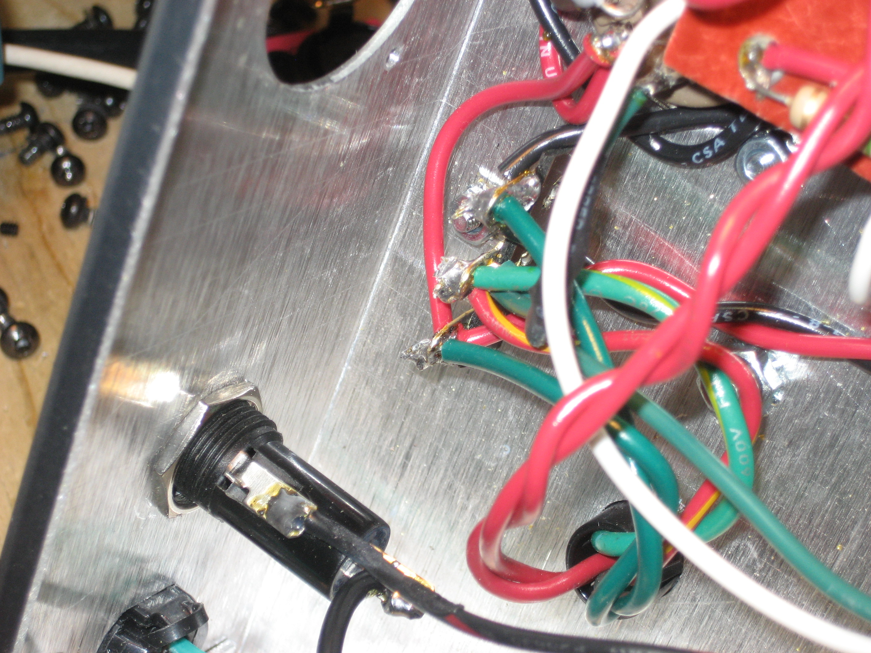

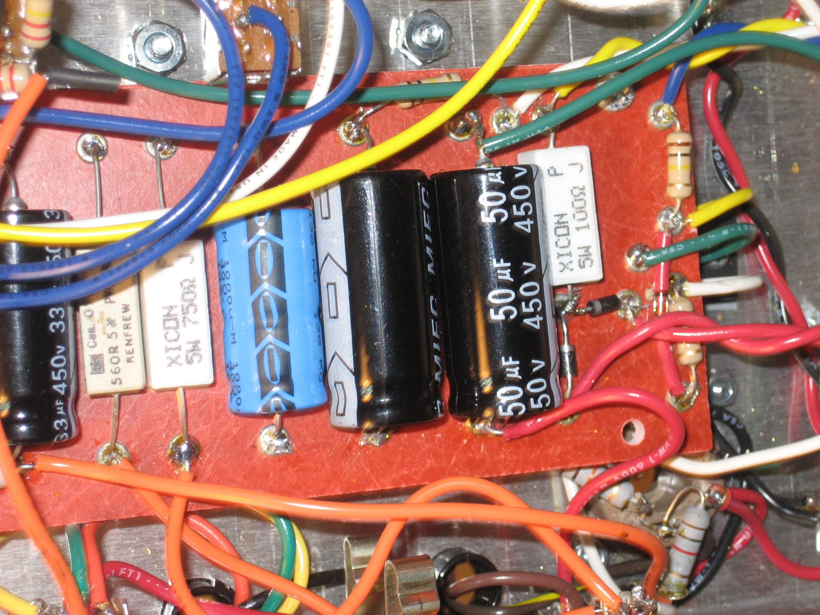

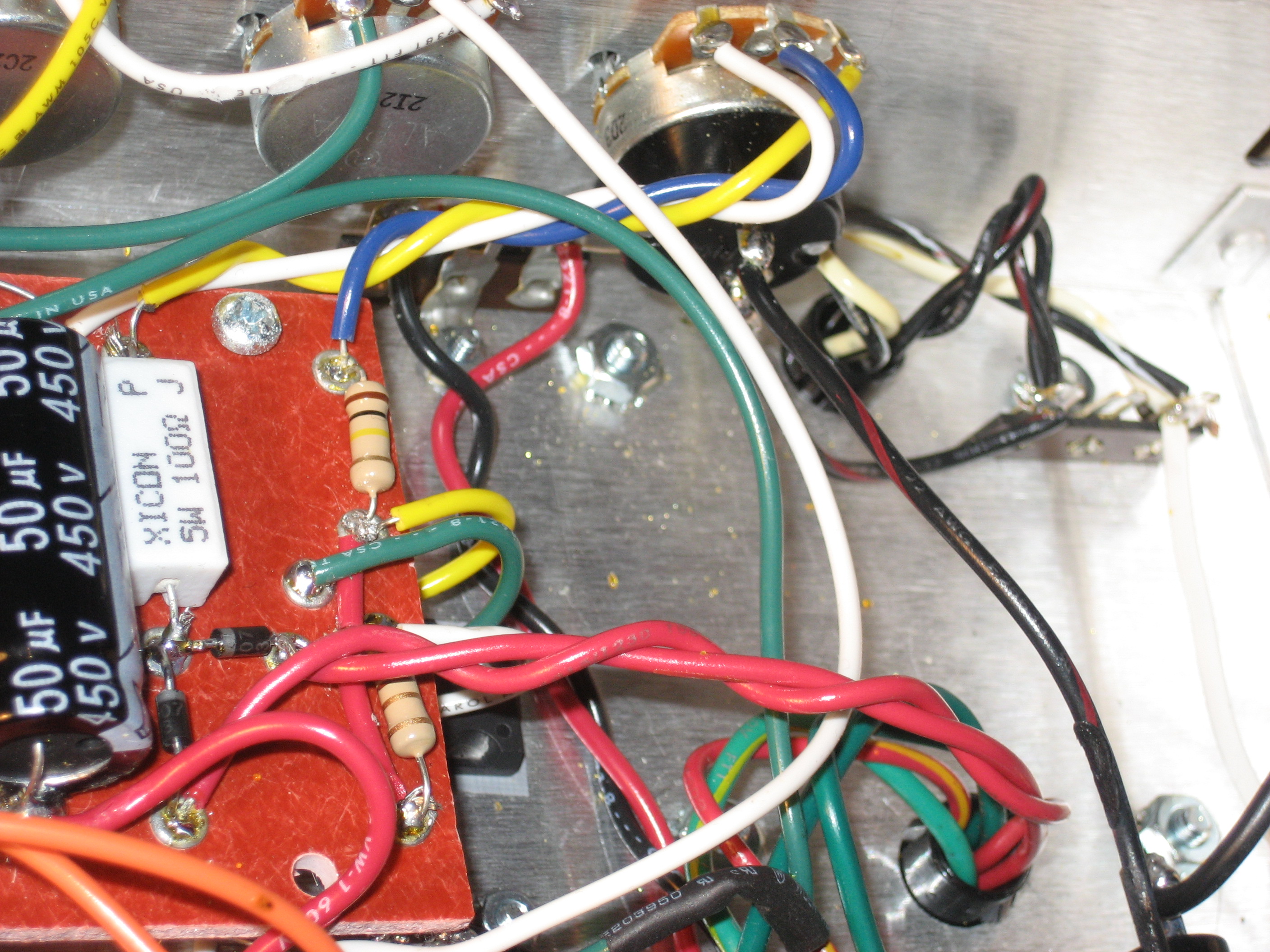

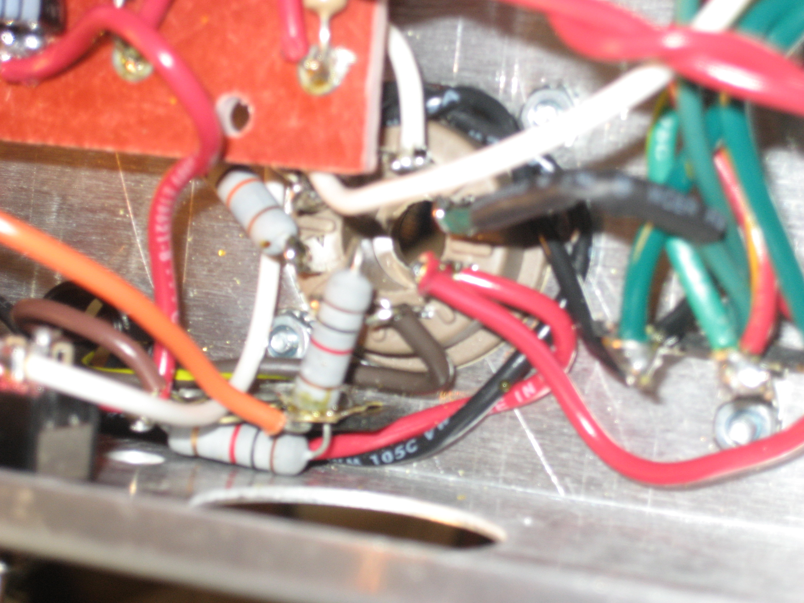

some photos
hopefully its an easy fix thats been staring me in the face
thnx all

But check that you havent wired up the LED so with one side going to ground. Double check that the heaters dont touch ground.
When you tested the Power supply before hooking it up to the heaters or board was it OK?
Does is blow fuses when the board is hooked up or when the heaters are hooked up? I would disconnect board first and see, then the heaters. Divide & conquer.
