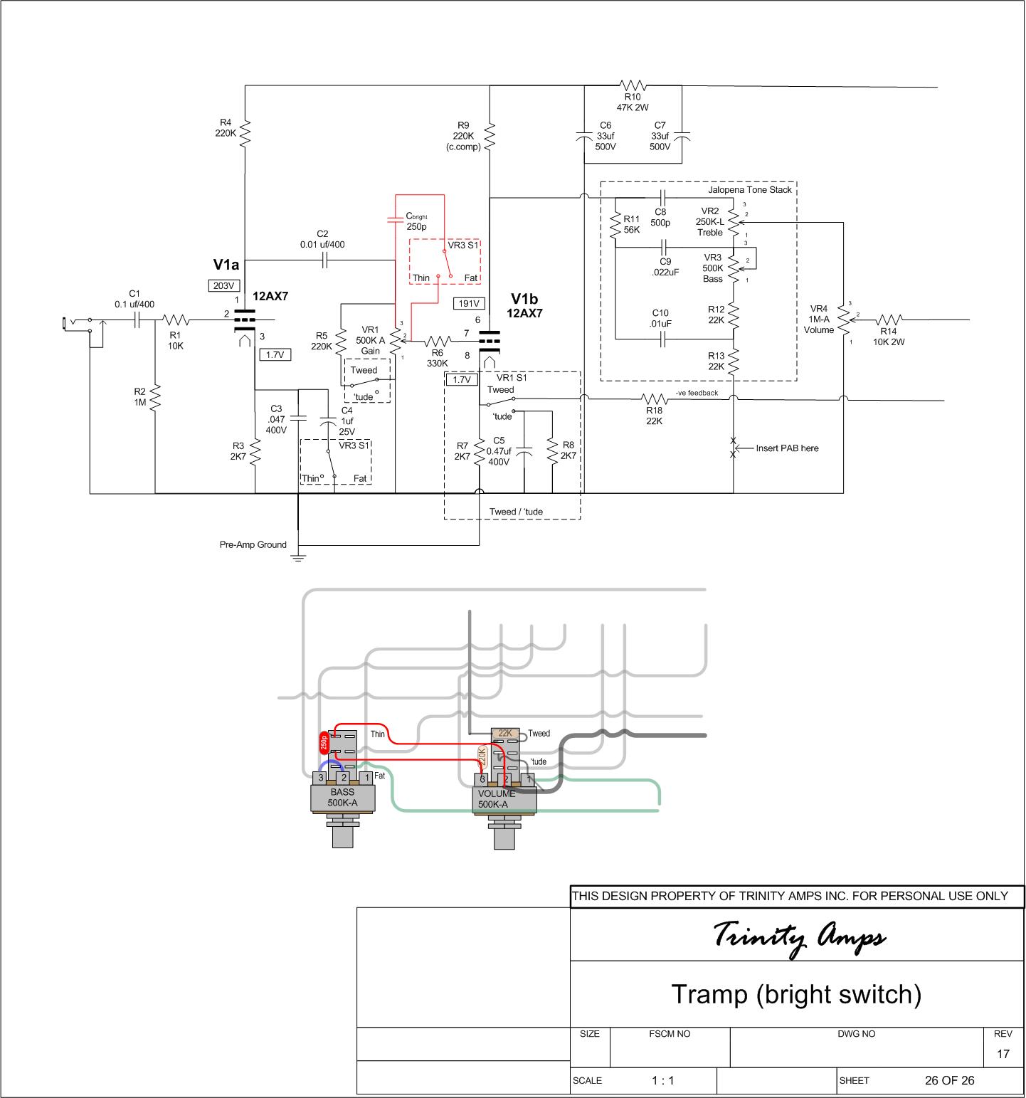

The treble setting on my Tramp could benefit from a bit more spark in tweed mode. Mostly at low volume but also at high volume, in a lesser way.
There are so many bright switch spdt combinations that are using different values like a 47pF and 250pF and now 2,2nF I can get easily lost.
Can someone guide me tru this simple mod ? Installing a push-pull treble pot switch instead of a SPDT would give a cleaner look.
 Post subject: Re: Gain mod?
PostPosted: Thu Apr 12, 2018 1:42 pm
Try this by using the Fat - Thin switch to select a 250pf bright cap.
Let me know how it works . 500 pf would be extreme bright.
Only works in Thin mode.

Thank you Stephen. I have 47pf, 100pf, 250pf and 500pf all 500V SM in stock. I'll go for 250pf first.

I've tried 100p, 250p and 500p caps and 500p is way too bright in 'tude mode.
100p keeps everything clear while 250p permits a treble roll off.
For now 250pF as suggested it shall be.

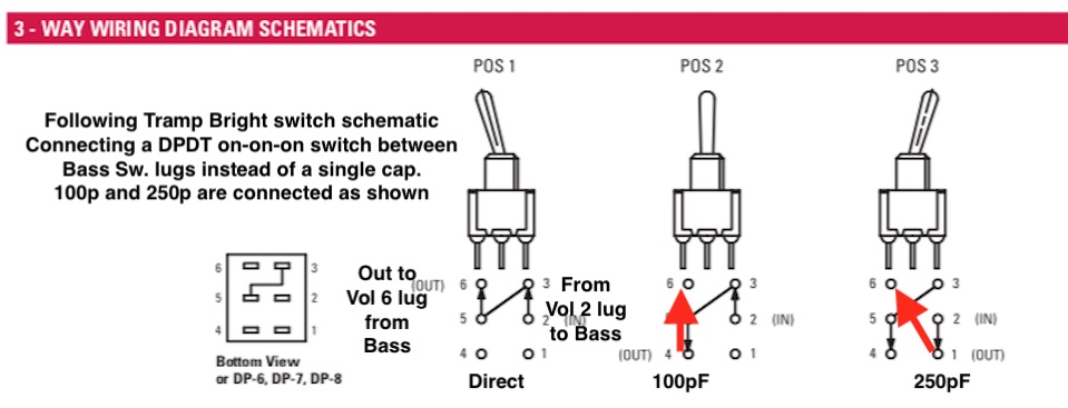

Later, I'd like to go for a combo switch DPDT 100p / 250p on-off-on so I could get back to the original setting on a flick.

You can use the existing switch for 2 settings only, but that's a decent option considering you had none!

I'm about to try and install a DPDT on-on-on switch ( just got it today) with 250p, 100p and none for the third option in order to get back to original setting.
Well it took me some time before doing it. Something went wrong when soldering heavy 18 awg on those tiny switches lugs. My fault... too much heat.
