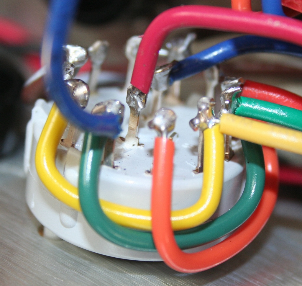

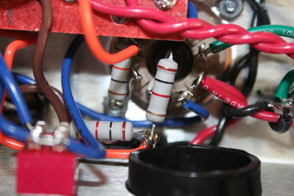

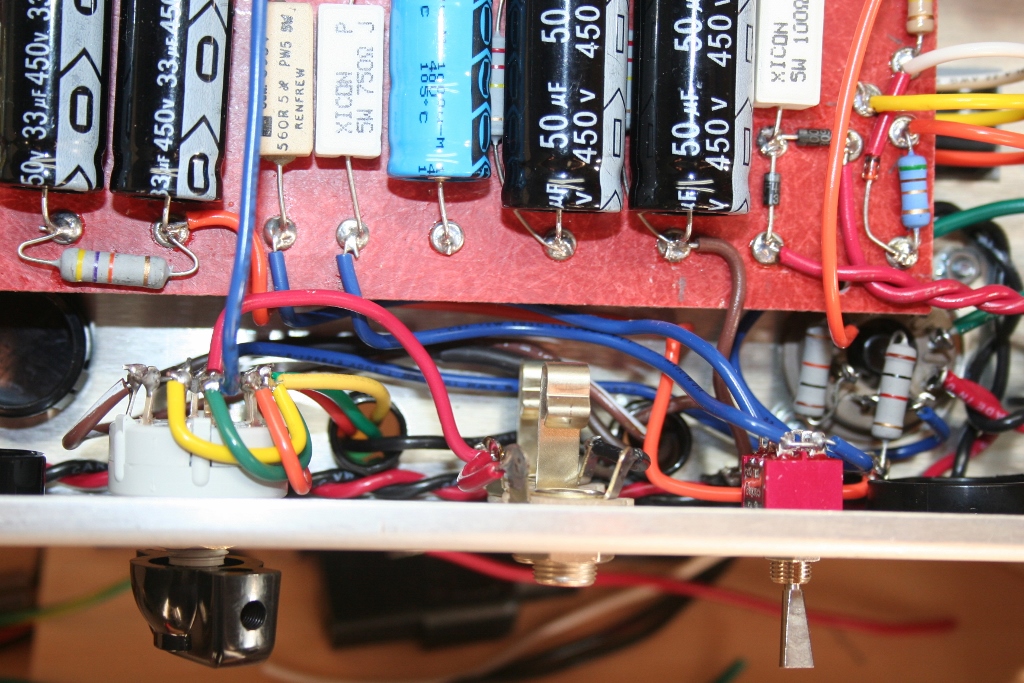

Thanks for the help Snowy! Maybe you or someone else can help. I have barely had time to play the amp due to other life issues but I decided to mod the impedance switch for El34 use following your thread. Before the mod it sounded good and loud! Now after the mod I have very little volume and it's very fizzy! :( So I swapped out the new EL34 for the original 6V6 hoping it was a bad tube. Same result. Oh, the amp is quiet and only fizzy when the guitar is strummed. Other than undoing the mod and running the 2.5k tap to the plate I don't see what I did wrong. Any ideas? I will attach pics and wait for rescue!

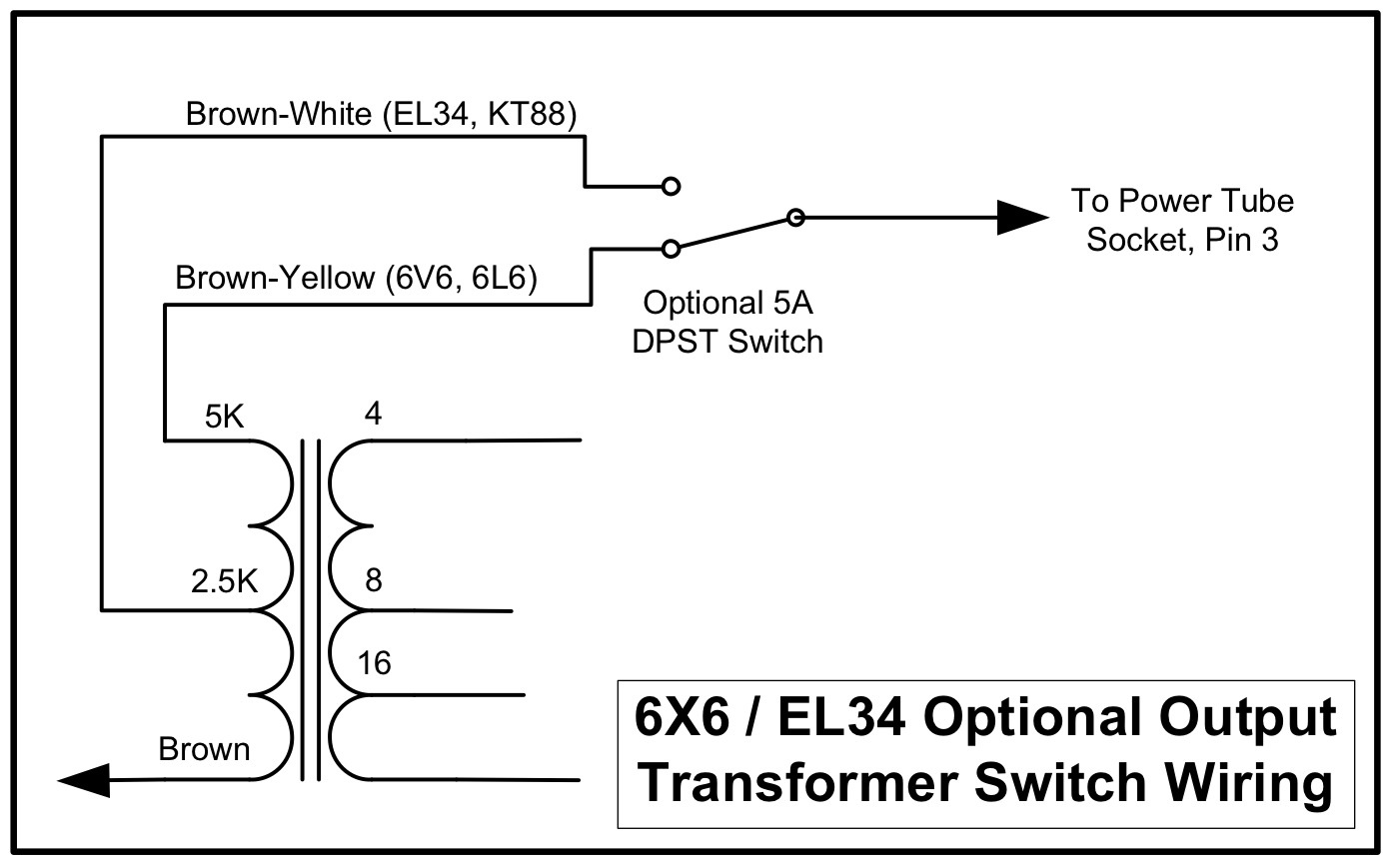

I know the mod works iF wired correctly bout it Is a biT of a tough mod. I can't tell from the pics if it is wired Ok. I assume you have a schematic for it.
While it is an elegant solution, We don't actually do it that way anymore. We do it with a Toggle switch.
