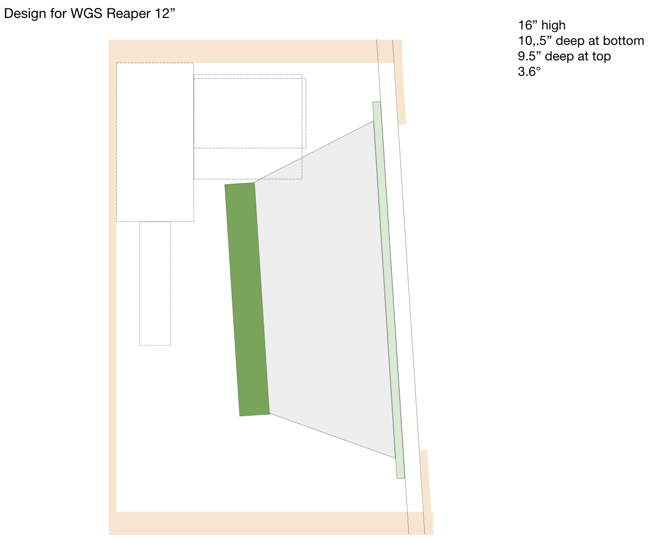

I agree with you 100% on the speaker size vis-a-vis cabinet size. I'm building a custom cabinet, so I'm choosing its specs based on the actual speaker sizes of potential 12" models I might select. I've done a couple of sketches of the proposed cabinet, with speaker installed to see how the speaker does (or does not) clear the chassis and transformers.
The basic dimensions I am going with are 18.5"w x 16"h x 9.5-10.5"d (tapering from bottom to top for slight tilt). Using 0.75" fir for body, 0.5" plywood for the baffle (or possibly 3/8").

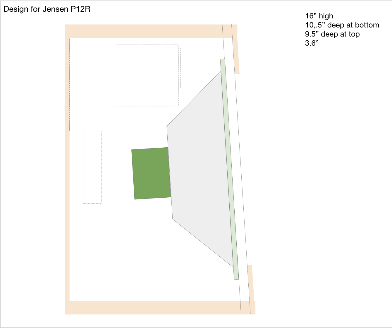

I attached the diagrams below for others going through same exercise. In this side view, you can see that 2 typical 12" models will fit (small Alnico, larger Ceramic). The power transformer is far enough to the side of the chassis that it is nowhere near the speaker magnet. And even the largest tube (EL34) will be farther back in the cabinet than the back of the speaker.
That said, some models of speaker will *not* work. For instance, Trinity recommends the 10" Blackbird 100 for this amp, which sounds like a fantastic speaker. If you try to go with the 12" version of the Blackbird 100, it has a gigantic bell on the back, and it won't fit in this cabinet. Could accommodate it by either making the cabinet 1 inch deeper (see last diagram).
Jensen P12R:

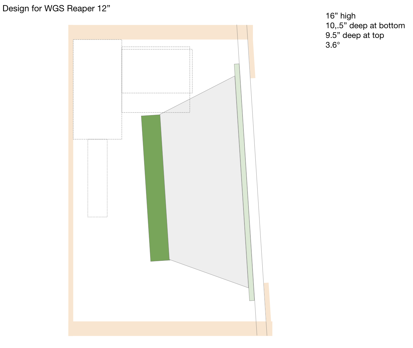

Front View of Cabinet w/Reaper:

I've never played through a Blackbird, but why in the world would a 100W speaker be recommended for an amp that can push only around 15W max???
Not sure if the wattage rating on the Blackbird influences the size of the magnet/bell cover, but if it does, I'd recommend using a 25 or 50W version of speaker if it allows you to squeeze it into the cab.
