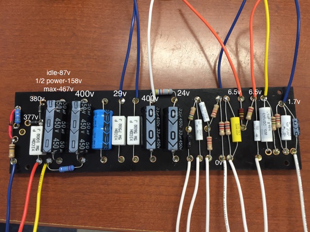

Hey guys, first time builder having an issue.
(I completed the build, but had these issues. I’ve since taken it apart to check all the component values & redo it. Just thought I’d throw this out to see if I missed something.)
I’m not getting 340v @ r10 & c6. First off, I get 400v on the left side of the resistor coming from the OT & power tube. On the right side of the resistor, my voltage starts around 270v then drops continuously to 24v. I only get 6.5v @ pins 1 & 6 on the preamp tube. I get 1.7v @ pin 3, but 0 @ pin 8.
I've attached a pic of the turret board with voltages to clarify what I’m taking about.

 Post subject: Re: Tramp build trouble
PostPosted: Tue Jul 19, 2016 12:25 am
Looks like way to much of a voltage drop across the 47k resistor between the two 33uf filter caps. The colour codes on the resistor looks right. Check to see where the jumpers under the board are correct from that point.

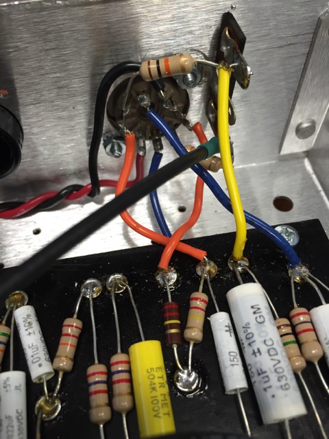

PostPosted: Mon Aug 01, 2016 8:39 pm
I don't see the little jumper that is supposed to run between the grounded ends of R7 and R8 on the board (the two 2K7 resistors right beside each other). Maybe you put it on the bottom side of the board, but if it's missing C6 and C7 won't have grounds and none of the preamp power supply will work right.
Also, do a continuity check with your ohm meter to make sure that everything that is supposed to be grounded actually is.
PostPosted: Wed Aug 10, 2016 9:40 am
Joined: Sat Apr 30, 2016 5:58 pm
Thanks for the reply mitch. The jumpers there, it's just under the board

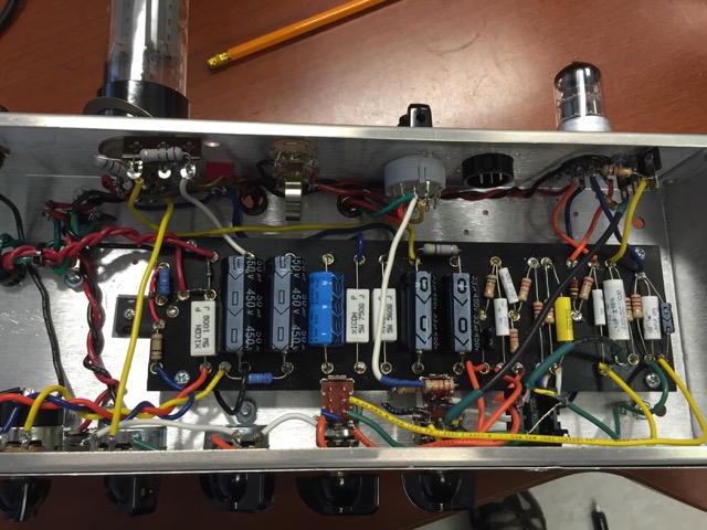

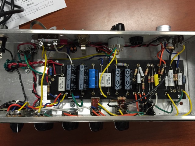

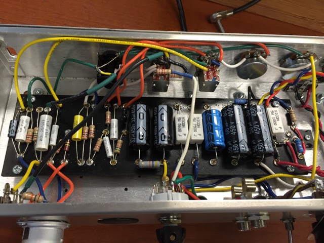

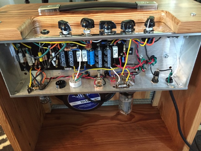

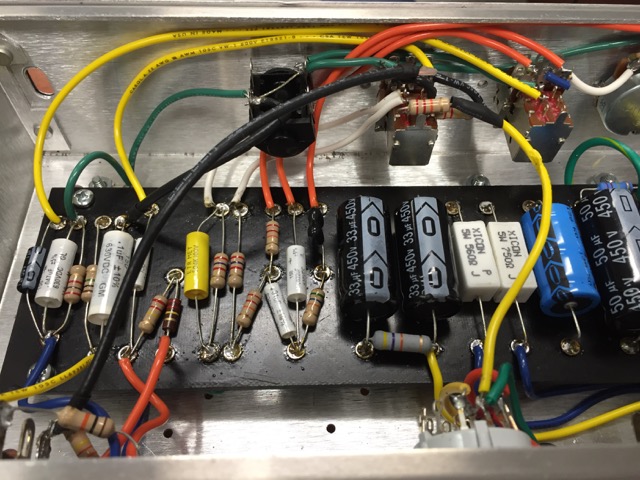

Everything sounds great, voltages are good, but I've got that squeal problem with the vrm & master volume maxed, & the volume above 8. I've read this is a lead dress issue & I've included pics, to maybe get some feedback on what to move or change.
The voltage problem from the first post ended up being a volt meter problem. It reads weird on the preamp side, but 2 other meters read fine. :roll: It was probably wired correctly then,but my soldering skills have improved greatly from that first attempt to the last, and I'm more confident in these joints not giving me issues later.
PostPosted: Wed Oct 05, 2016 9:59 pm
Glad the amp is almost fixed. Try moving wires around with a chopstick or a similar wooden stick while the amp is squealing to see if you can reduce the squeal. Do you get the squeal in both settings of the Tweed/'Tude switch?
It's just in the 'tude mode. Sounds fine with everything maxed in the tweed mode.
I'll try some chop sticks & see what happens.
