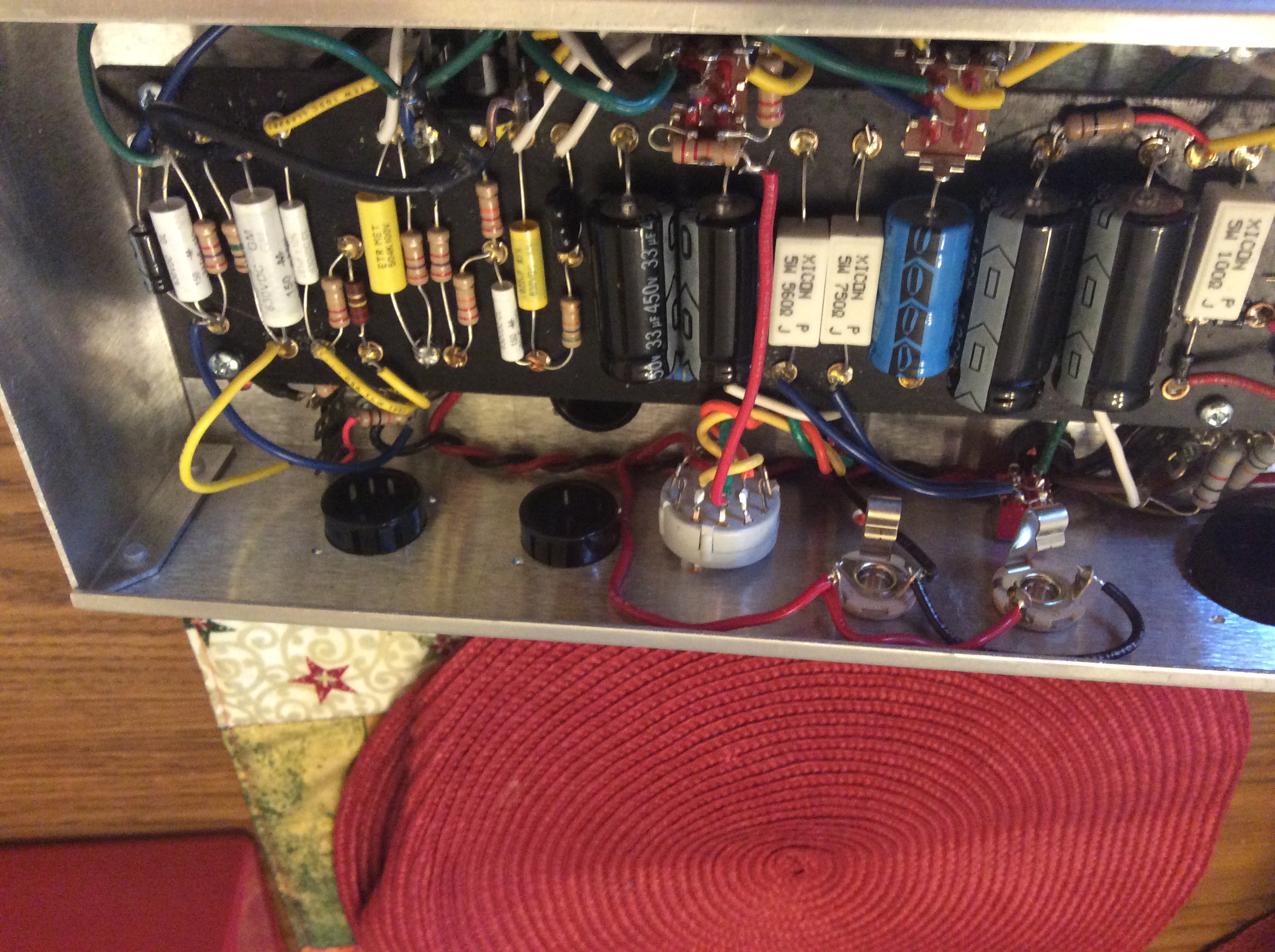

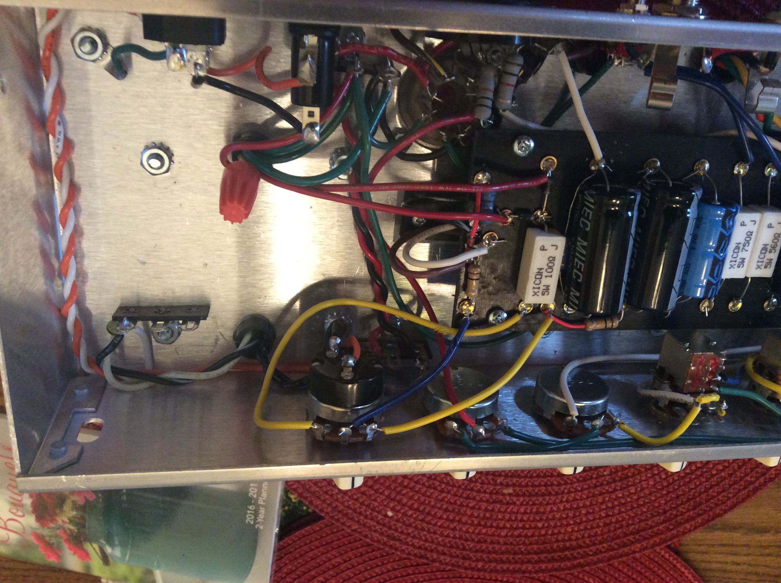

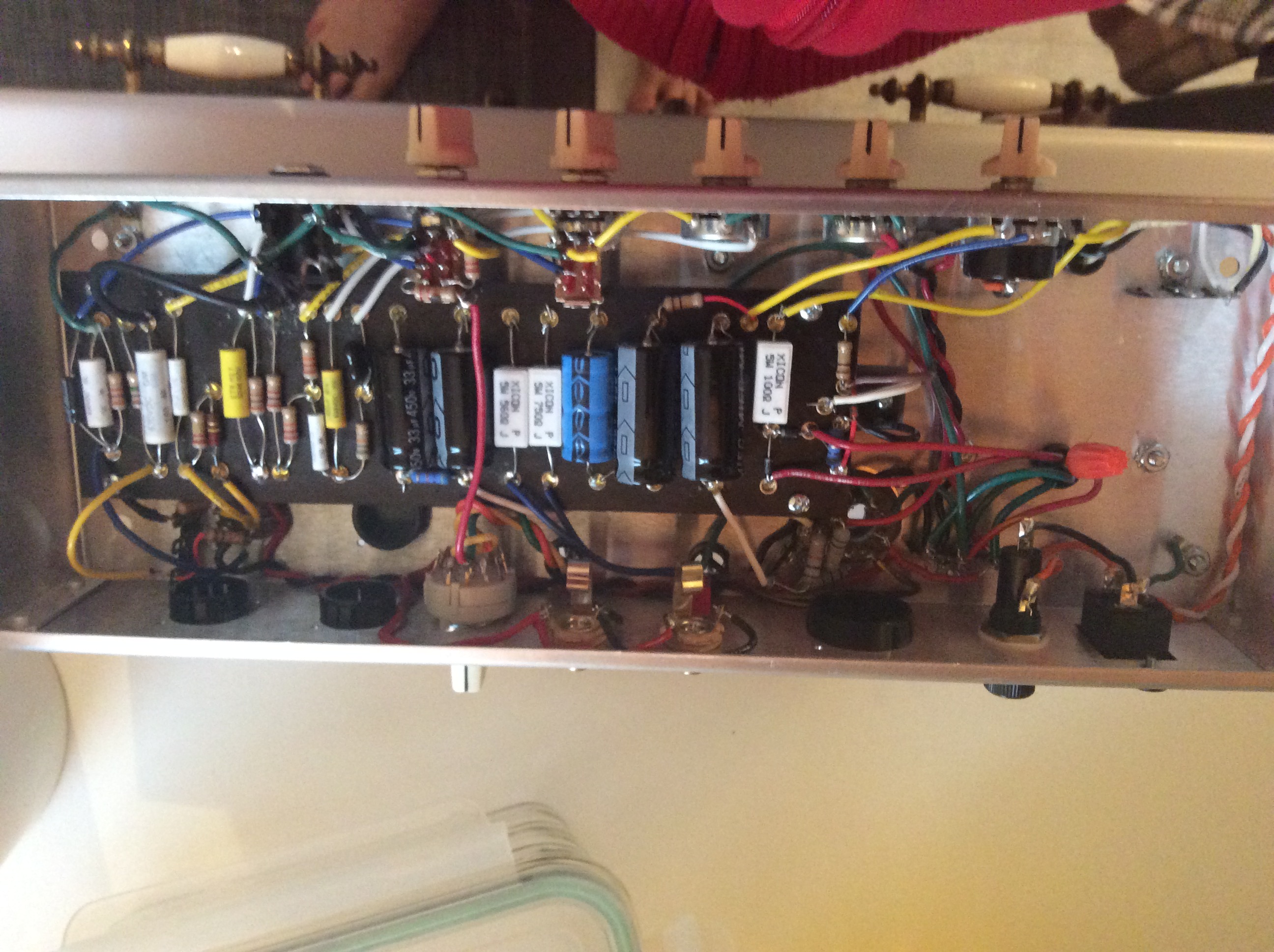

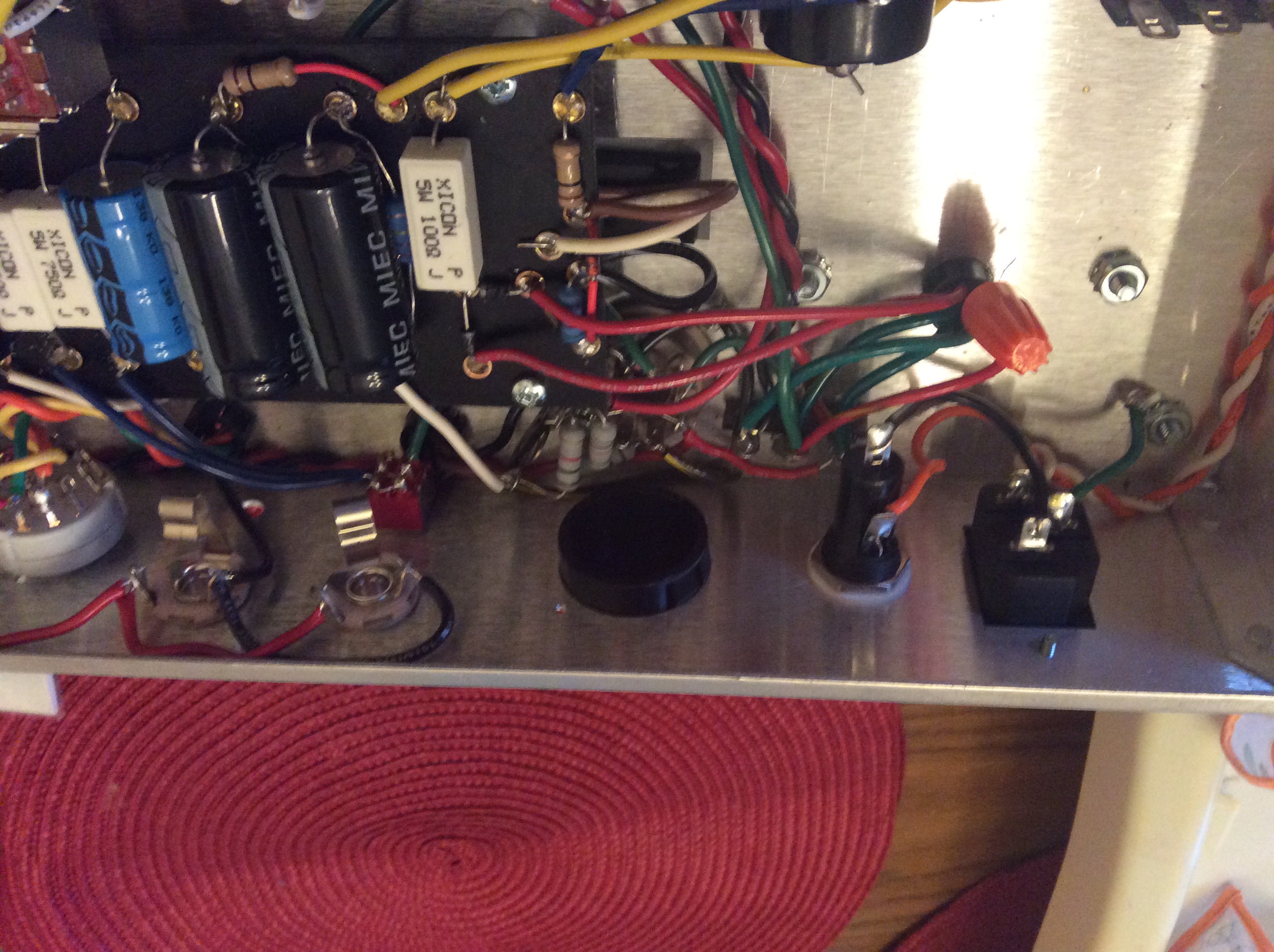

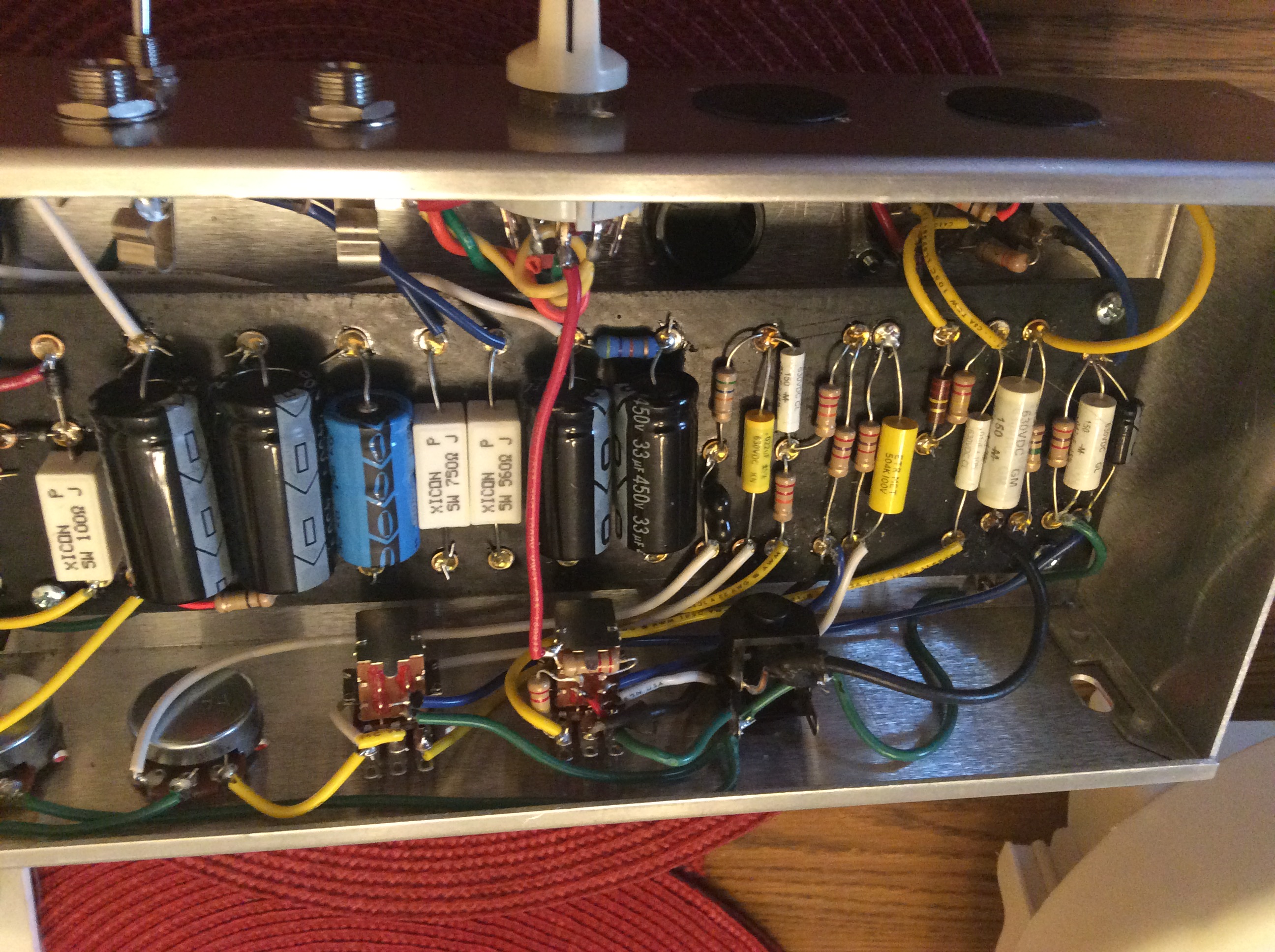

Hey guys I am new to the forum and amp building as well with only a trifly under my belt so far. Build seemed to go well and the readings looked good but I have no sound. Went through it a couple of times and redid my volume and input and all the shielded cable, gave pins 5 and 6 of the output and 1 and 6 of the preamps a light tap when everything is on and there is a pop coming out of the speaker then but no sound from the guitar, any suggestions?
Here are my readings and a few pics:
Rectifier Pins: 649 VAC
Cap 2: 439 to 442 VDC
Cap1: 44 to 437 VDC (moving VRM from low to high)
Power tube heaters: 6.95 VAC
Pre Amp heaters: 6.96 VAC
