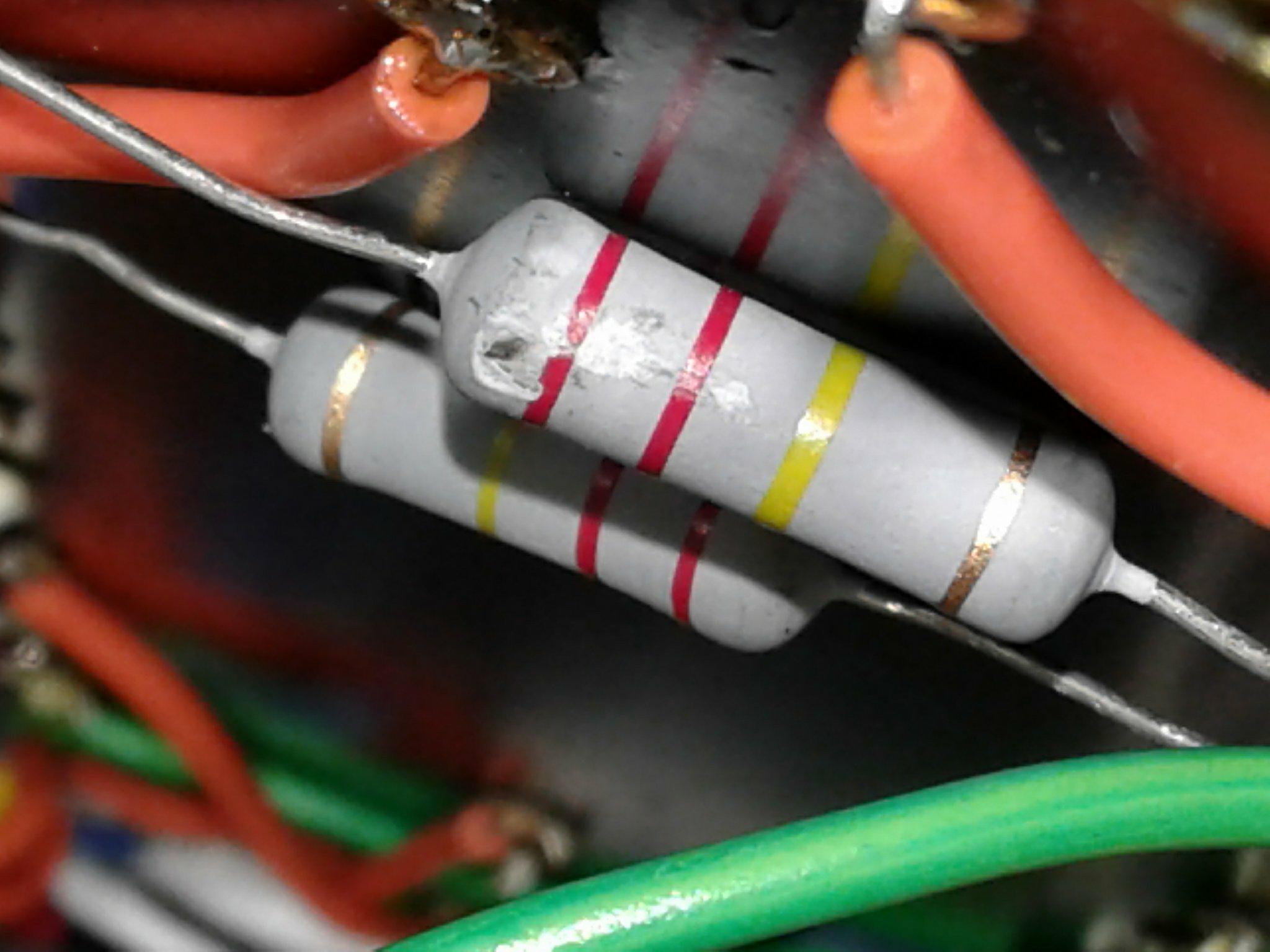

So I was able to get it turned on with the tubes installed without blowing a fuse. I had installed the two 220k resistors under the board and the one that bridged C12 had lined up perfectly with one of the transformer mounting screws. It looks like the screw rubbed off some of the insulation on the resistor and made a connection with the metal film causing the positive side of C12 to be connected to ground. After shimmying the resistor out of the way the amp turned on without blowing fuses.

I'm not big on putting parts on the underside of boards for that very reason. A few jumpers or the fly-off leads are OK on the bottom, though. You could piggy-back those 220k resistors on top of C12 and C13.
The amp sort of worked originally because the bad connection you had to the MOSFET didn't let enough voltage through to cause problems. Also the short to the mounting screw could have been intermittent or it only happened when you put the board back in after removing it.

I've had the exact same issue, here's what the resistor looks like after coming in contact with the transformer mounting screw.
This creates a short from 400V to the chassis. These resistors have got to go somewhere else.

We dont recommend putting resistors or parts underneath the board. There is space on the top side for these in the area around the capacitors.
