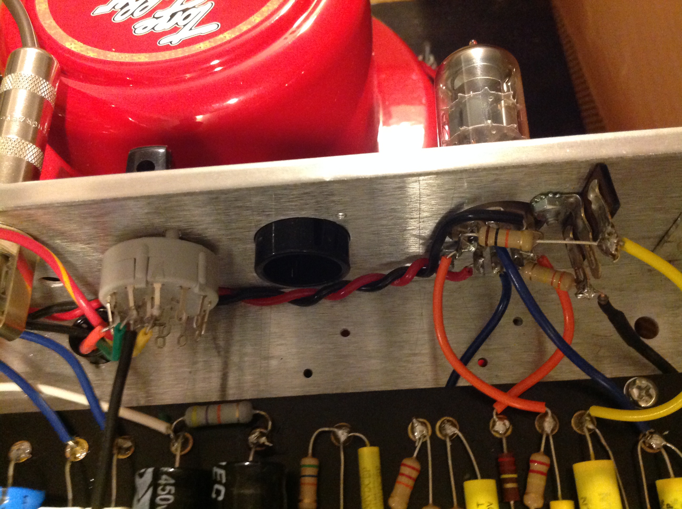

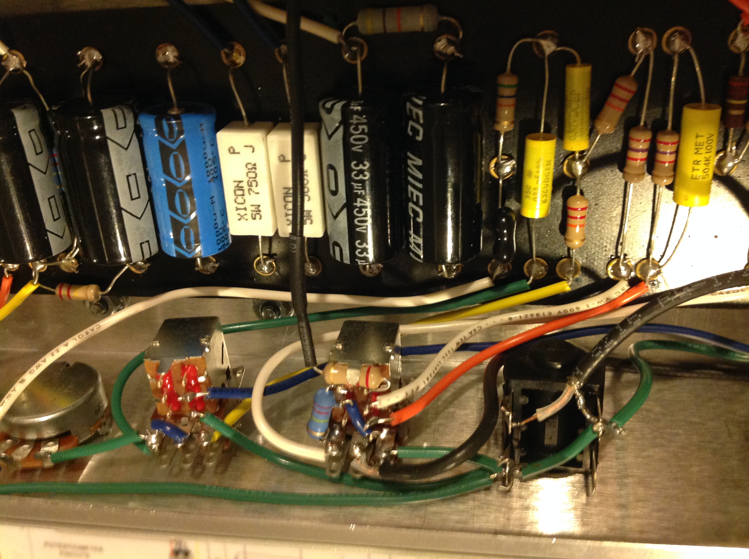

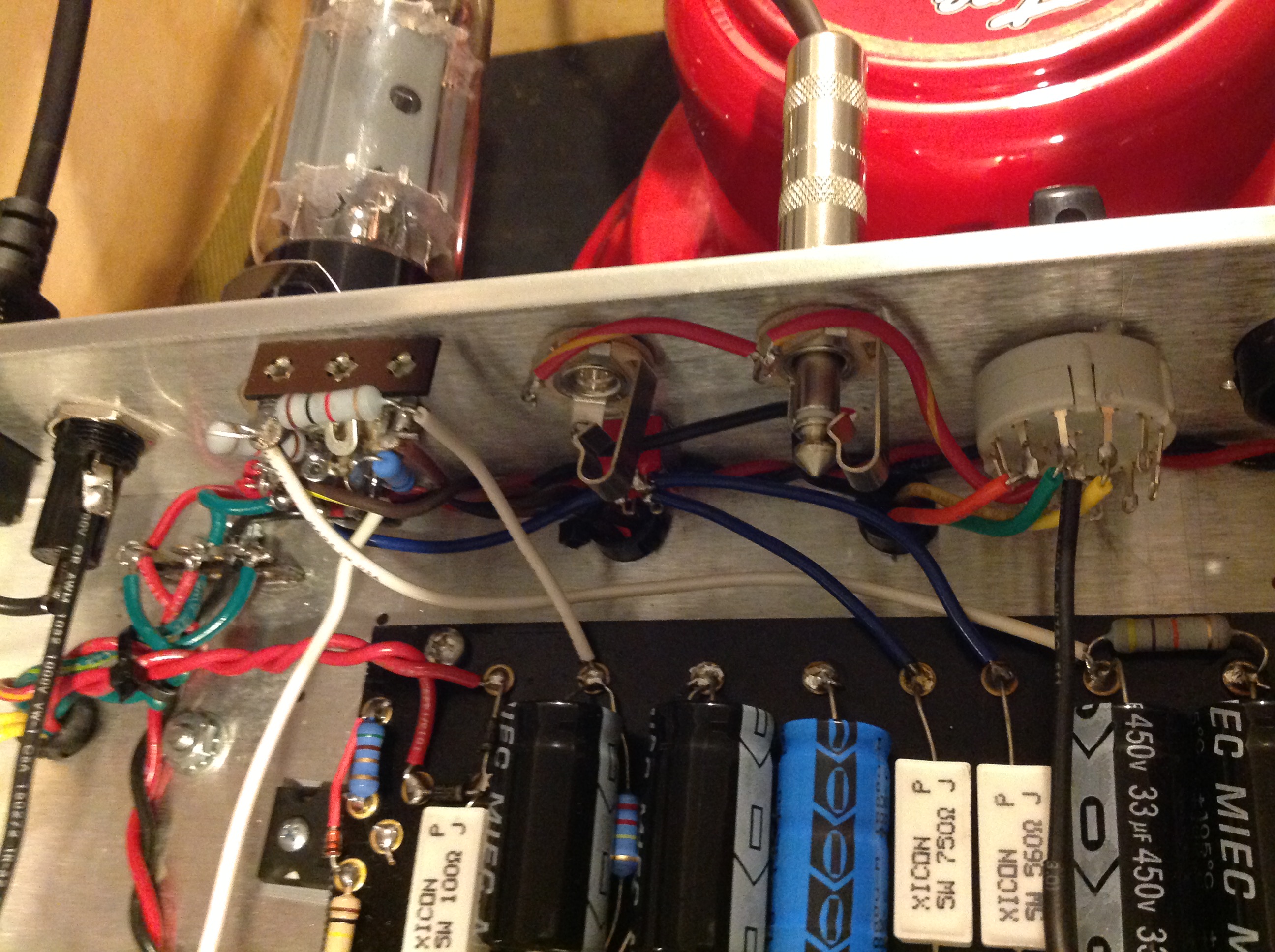

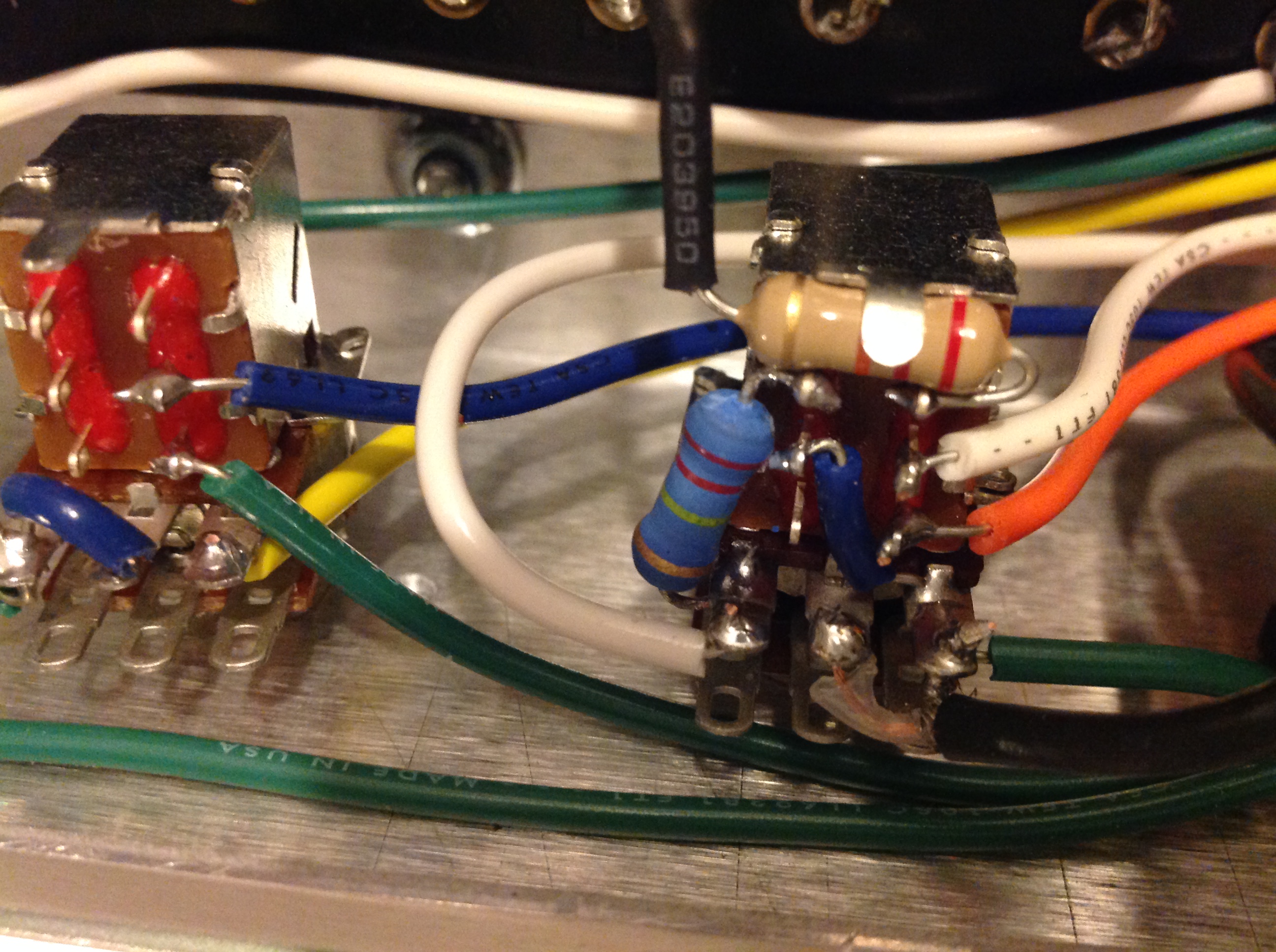

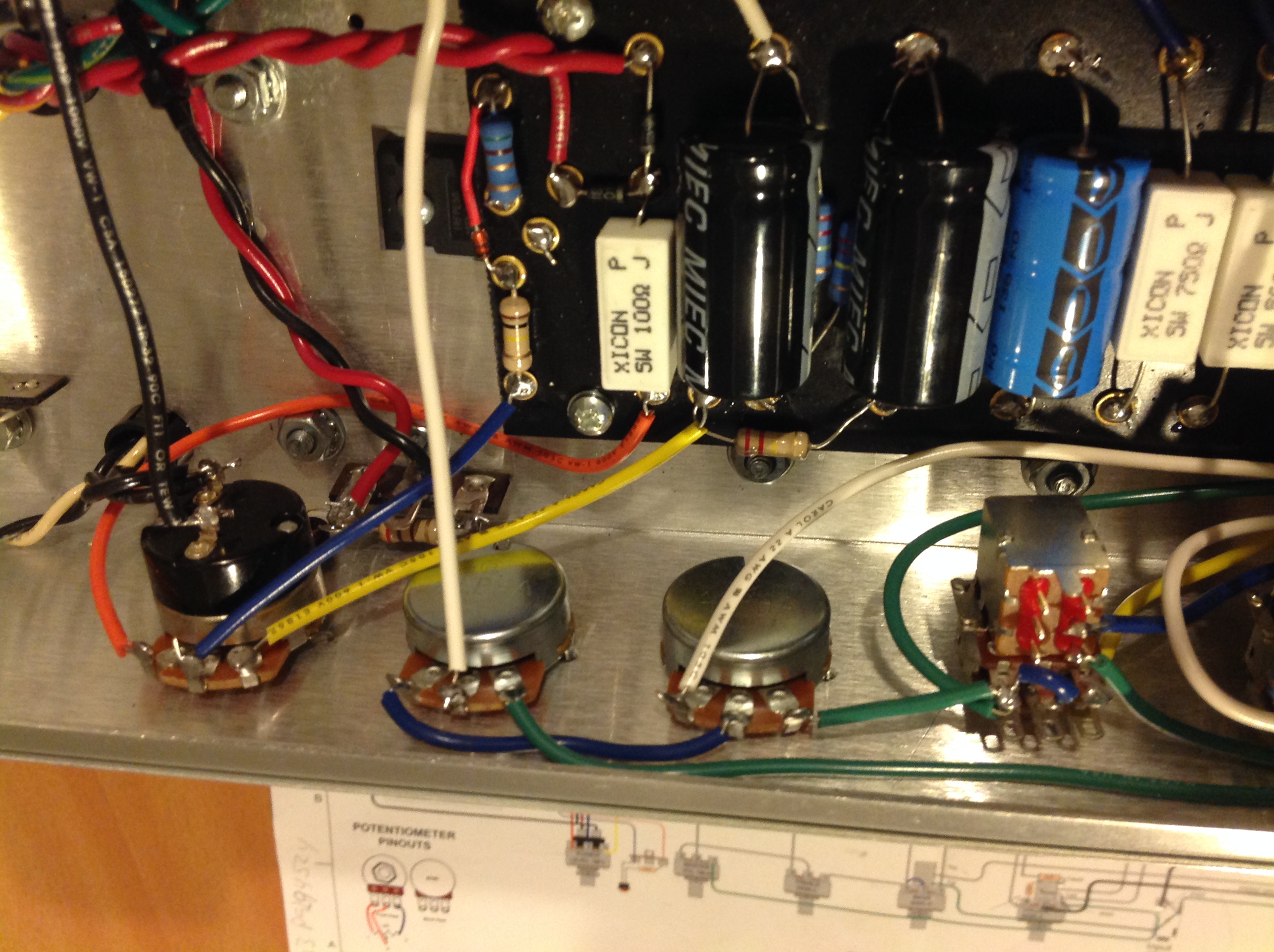

Hi all,
Just finished my amp and there is no sound at all, no pop when plugging guitar cable in etc. All of the voltages seem in scope so I'm confused. There is no change to the the power hum when increasing volume or VRM.
Power in = 640
50uf cap = 448
Preamp
Pin6= 181
Pin 1 = 188
4&9 = 3.5
I tested with a known working speaker and cable with same issue = no sound. How do I isolate this - could it be the volume (tude) switch wiring? I can't get any pops etc to start with.
Chris

Measure and Post all the voltages per manual.
Check for continuity from tip of plugged in guitar cable to grid resistor .
Make sure coax cables are not internally shorted to ground.

As follows - voltages seem off
All measured in DCV with 6L6 tube
V1
P1= 188
P2= 181
P4=3.5
P9=3.5
V2
P7 & P2 = 3.5
P8 = 431
P3 = 434
With ground to chassis and tubes in
-1st 50uf cap = 429 to 435 as vrm is turned up
- 2nd 50uf cap = 436 but does not increase when vrm turned up
Cathold voltage
- it's at 426 DC and should be 29 ???
There are two other areas to measure 1.7 in the schematic and these are at 1.85.
And for the stupid question- where is the grid resistor for checking continuity.
Thanks,
Chris

1. check you have a ground connection to your cathode resistors (750R/560R) and all the caps (50, 50, 1000uf).
2. check the polarity of all the filter capacitors points to ground.
