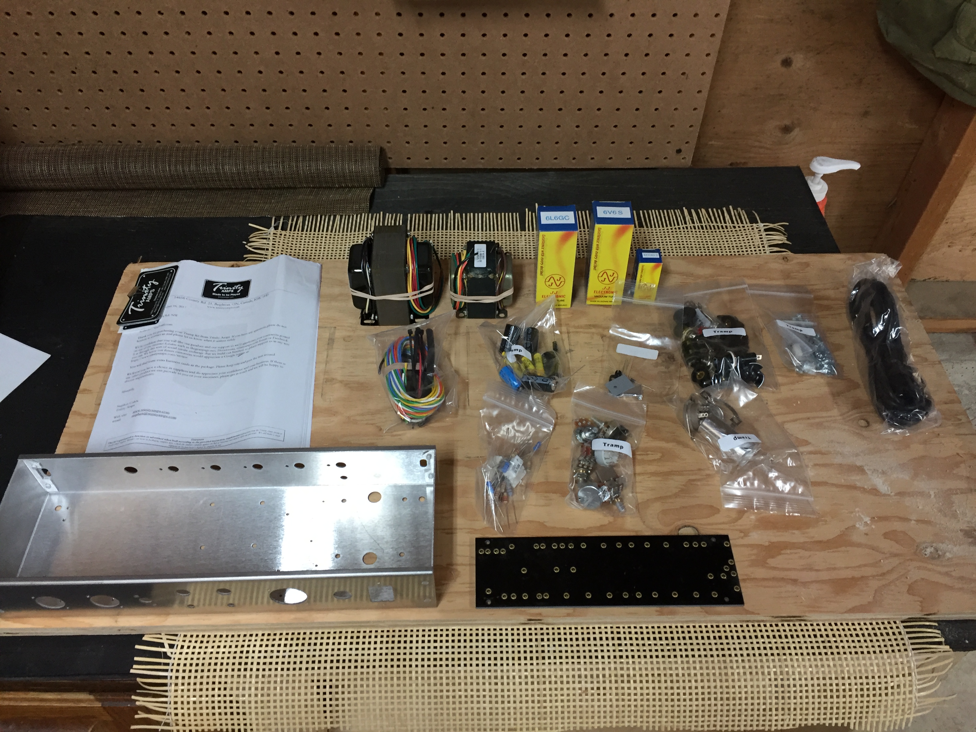

Hi, I just ordered a Tramp kit from Stephen. I currently have a Sovtek Mig 100U and Fender Super Reverb RI that are just too loud to play in the house. I always thought I would be playing in a band where I needed a big amp, but life seemed to get in the way! I was looking at building either a 5F1 Champ or a 5E3 Deluxe kit, but decided to go with the Tramp as it seems to be right in between. I think the 5E3 would have still been a bit loud and I wanted something a bit more versatile than a 5F1. This will be my first amp build, so I'm looking for any tips or tricks anyone might have. I definitely need to practice up on my soldering skills! My buddy has quite the wood working shop so I've decided to build my own 5E3 cabinet for the Tramp in as it sounds like it's the same size. Picked up all the wood on the weekend and got everything cut on the table saw. We just need to set up the dado blade so we can cut all the box joints. I think I am going to go for the natural pine look with a darker walnut stain along with a wheat colored grill cloth. Looking forward to the build! I'll try to post some pics of my progress.
Thanks,
Barry

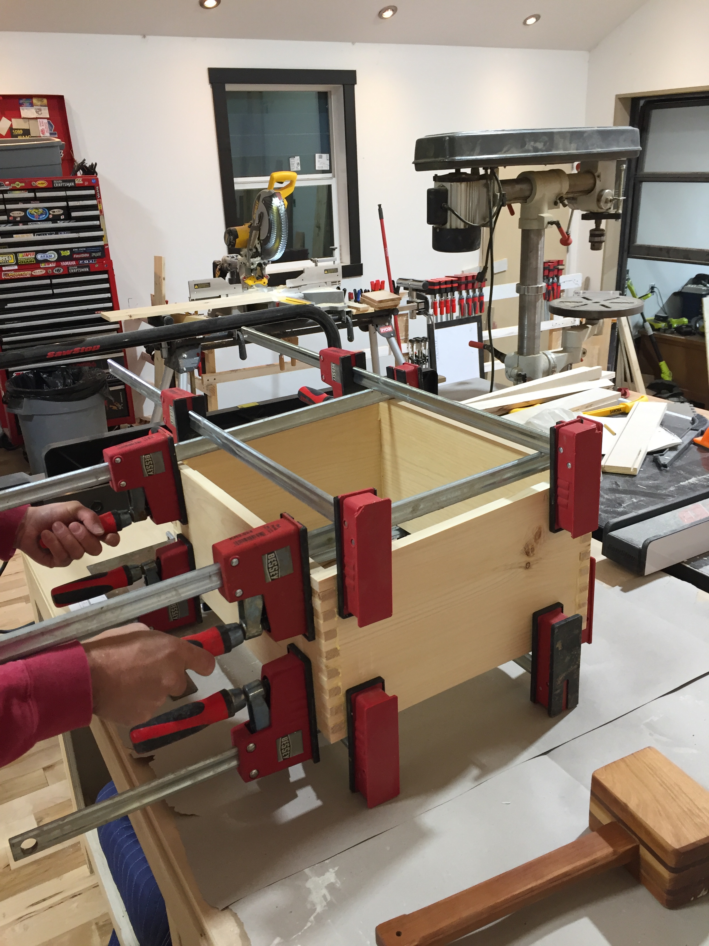

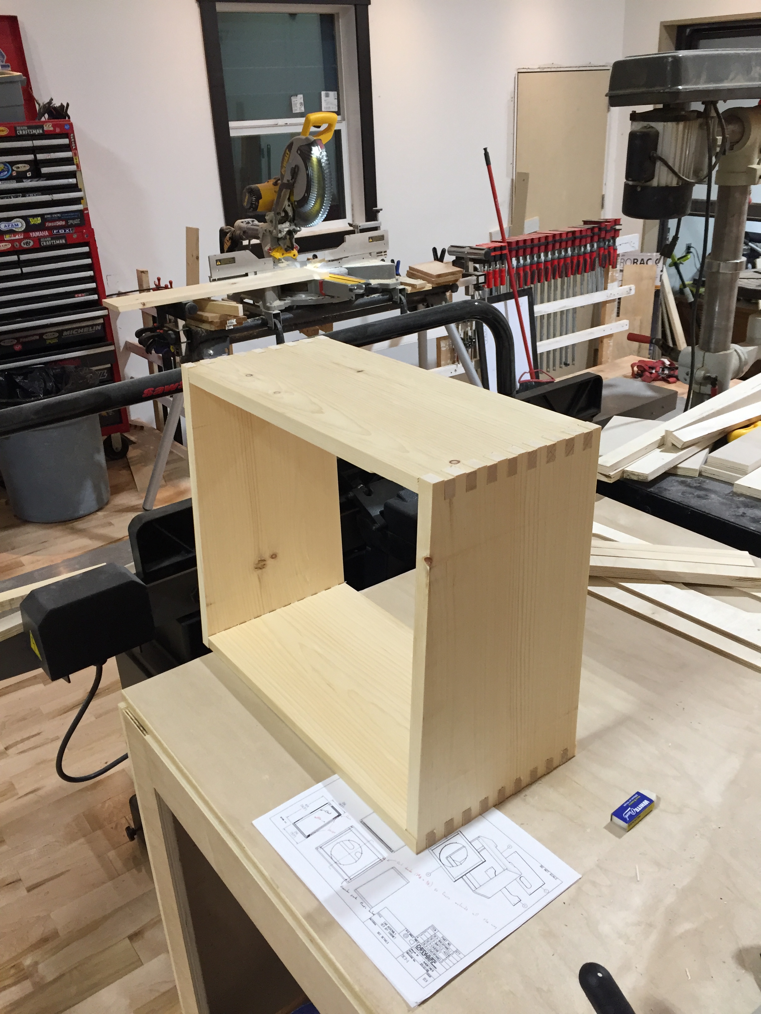

I got the cabinet cut and glued last night. Sure helps having the right tools and two sets of hands!

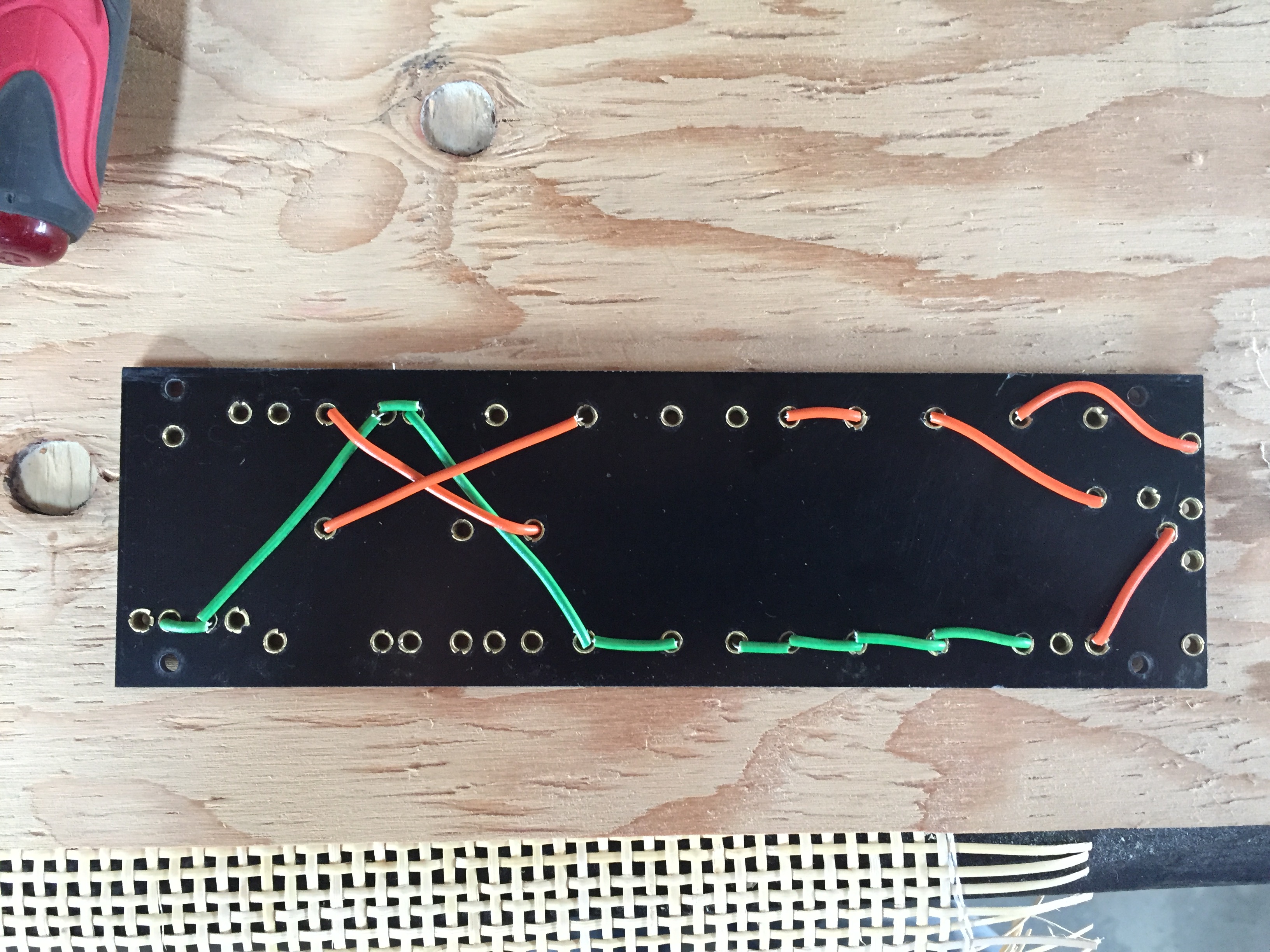

Got a start on the jumpers this weekend. Just a newb question here, I'm assuming you don't start soldering until all the jumpers, components and fly leads are in place? Do you solder from the top or the bottom of the board?

The cabinet and board look good. You are off to a great start! Yes, having a well-equipped wood shop is a real advantage when you are making cabinets for amplifiers. They aren't overly big, but having power tools to make the cuts and joints accurately and easily goes a long way to achieving pro-quality results. It speeds things up, too!
Yes, you don't solder an eyelet until all the wires and components that go to that eyelet are in place. You can attach the flying leads now. The manual should say how long they should be. With eyelets it doesn't really matter whether you solder from the top or bottom. Just pick whichever side you find the easiest. If there are wires with insulation at the eyelet, soldering from the side opposite the insulation is probably easier.

Yeah that was what I was thinking as well. The insulation does seem to get in the way a bit of the eyelet. I think I'll wire the fly leads underneath as well so all the insulation is on one side and then I'll solder from the top once all the components are in. Thanks for your help!

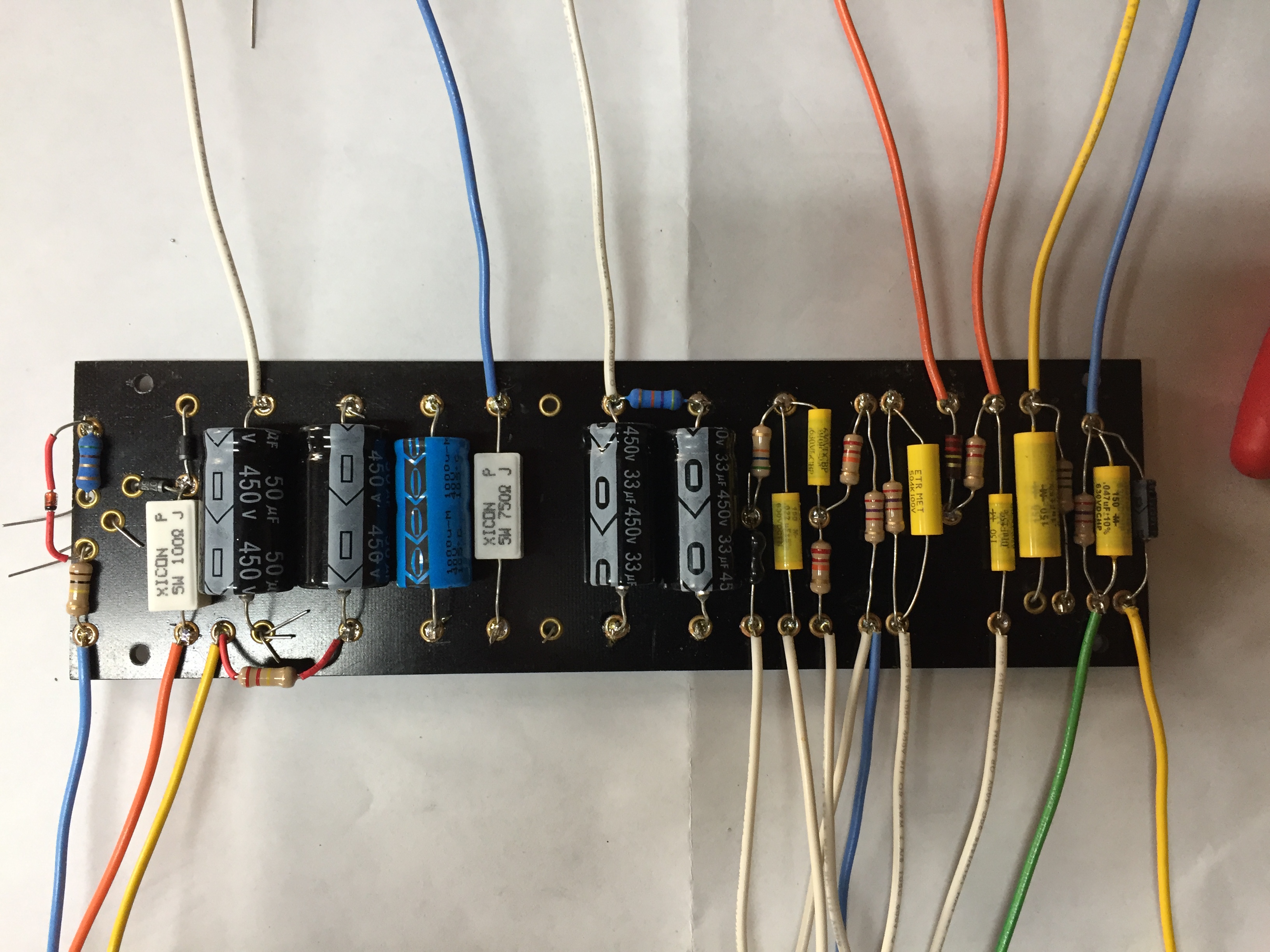

Got most of the board soldered up today. Not quite as pretty as some of them on here, but not bad for my first try I hope!

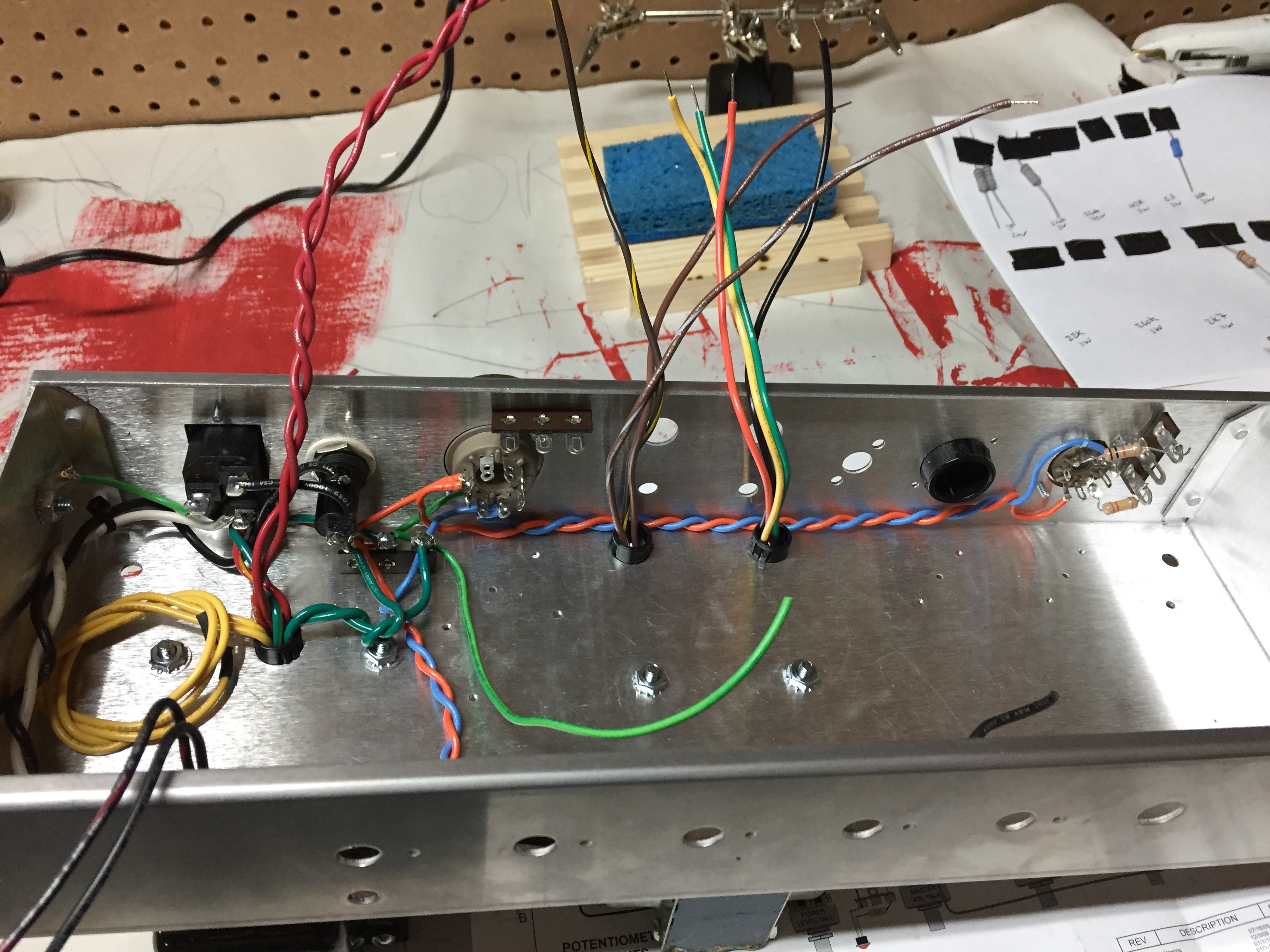

Got the heaters and main power wired

Looking' good, love the cab work so far too. Just looking at your board, did you install the 2W 220k bleed down resistors? (can't see in the pics but maybe they're installed under the board).

Yes the bleed resistors are wired underneath. I ended up just wiring the fly leads on top as it didn’t seem too bad once I started soldering. Just waiting for a few missing parts to show up and I can finish. A new baby boy arrived last night (our second) so I’m not sure when I’ll have time to work on this “baby” again! I’m still torn on the speaker whether to go lower wattage/efficiency alnico or a little higher ceramic. Thanks guys!
