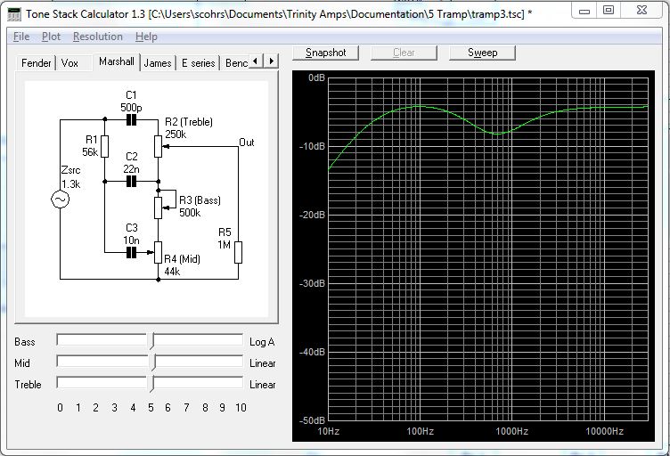

Hello,
I assume you need to use the marshall tab within the TSC...
Are these the correct values for tweed / thin:
Zsrc 38k
R1 56k
C1 500pF
C2 22nF
C3 10nF
R2 250k (linear)
R3 500k (log A)
R4 22k (fixed - what setting would I use in the TSC 10?)
R5 1M
If not, what they be? Also, what about tude and phat settings? or am I completely lost?
Thanks for your help!

Here is a snapshot of the TSC for the tramp. It is a modified Marshall stack. Mod the mids if you want to change the two 22K resistors.
