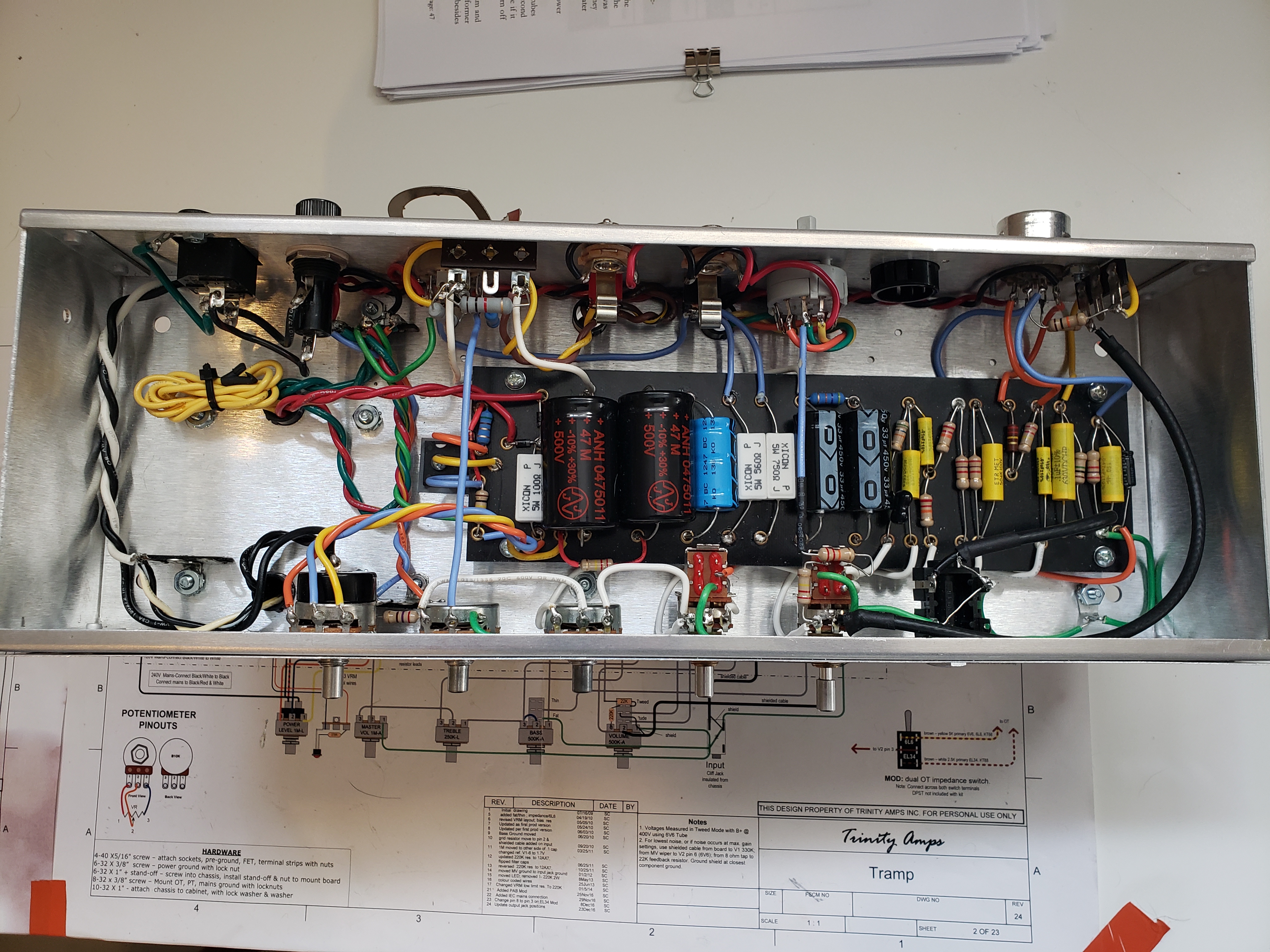

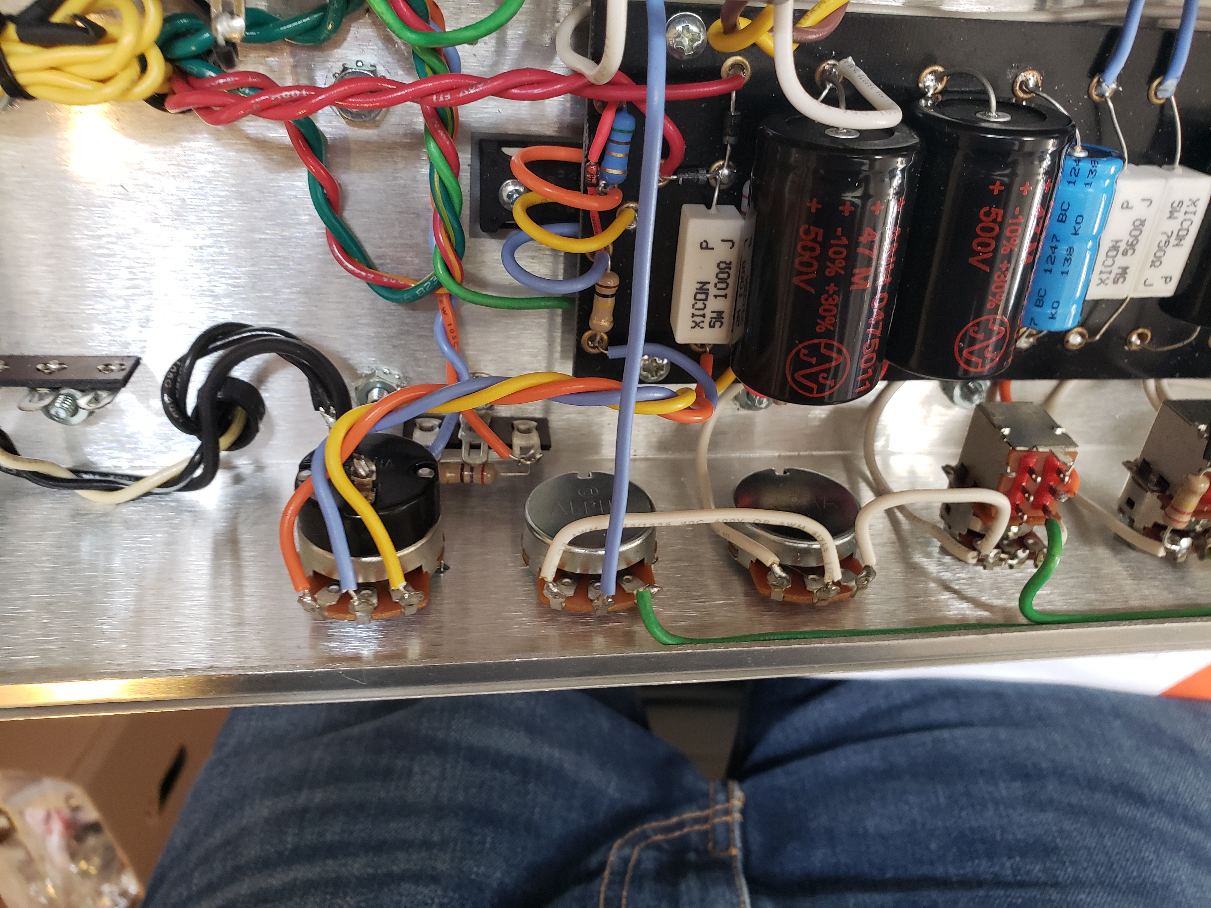

Hello,
So here are some pictures of my build. Isn't the cleanest of some other I have seen. Mind you it's been a while since I've been behind the iron.
Going to get those voltages messured again soon. And will post those as well. Did read over another form post with vrm issues and re-read that in the trouble shooting section as well. One step at a time.

PostPosted: Fri May 01, 2020 9:30 pm
Kim, a problem I had when I built a Tramp was the leads from the MOSFET to the board would come unsoldered when heated with the iron, you might loosen the board mounting screws and take the nut off the MOSFET and lift them up gently and slightly to see if this is the case. I wired the power switch wrong on another and the amp worked, but no effect on voltage. Your wiring is correct on Pwr switch, so I'm guessing a bad connection.
Also, looking at your pics some solder joints at eyelets are not filled and some are beaded up (should be smooth). Could be bad solder joints. I respectfully suggest that you read "Of Soldering and Solderability" on page three of Forum Resources page, since I don't know your skill level. JoeyVelour apparently used to or still does production electronics.
A working VRM really brings a change in the number of the tones you can get, so good luck and hope you can get her running at her full potential. :thumbsup:

Make sure all your solder joints are good! Check the joints on the 47K resistor between the two filter capacitors. It supplies power to the preamp.
Also make sure everything is wired properly in the VRM area and there aren't any accidental shorts or anything like that. It looks OK, but sometimes it's hard to tell just looking at pictures. Also check to make sure the Zener diode is a 6.2 volt one. The numbers on the diode in your photo look like 47. Not sure if it should say 62, or maybe the 47 is just part of the part number. Maybe someone who built a Tramp from the kit can verify what it says on the Zener.

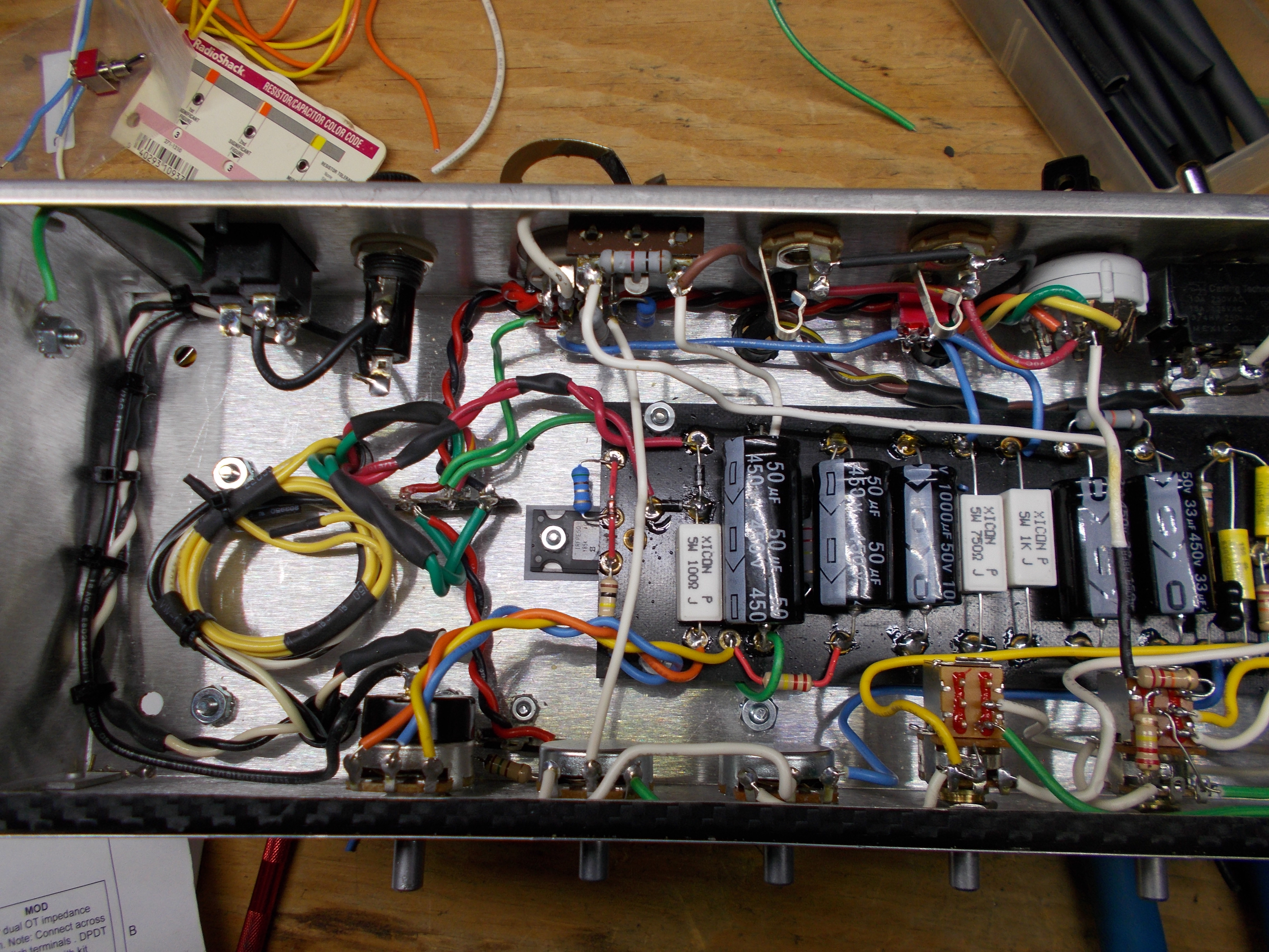

FYI The 6.2 zener diode looks to be correct compared to the ones on both Tramps I've built. I still think you need to consider reflowing the solder on your board eyelets to ensure you have good connections, especially at power section.
