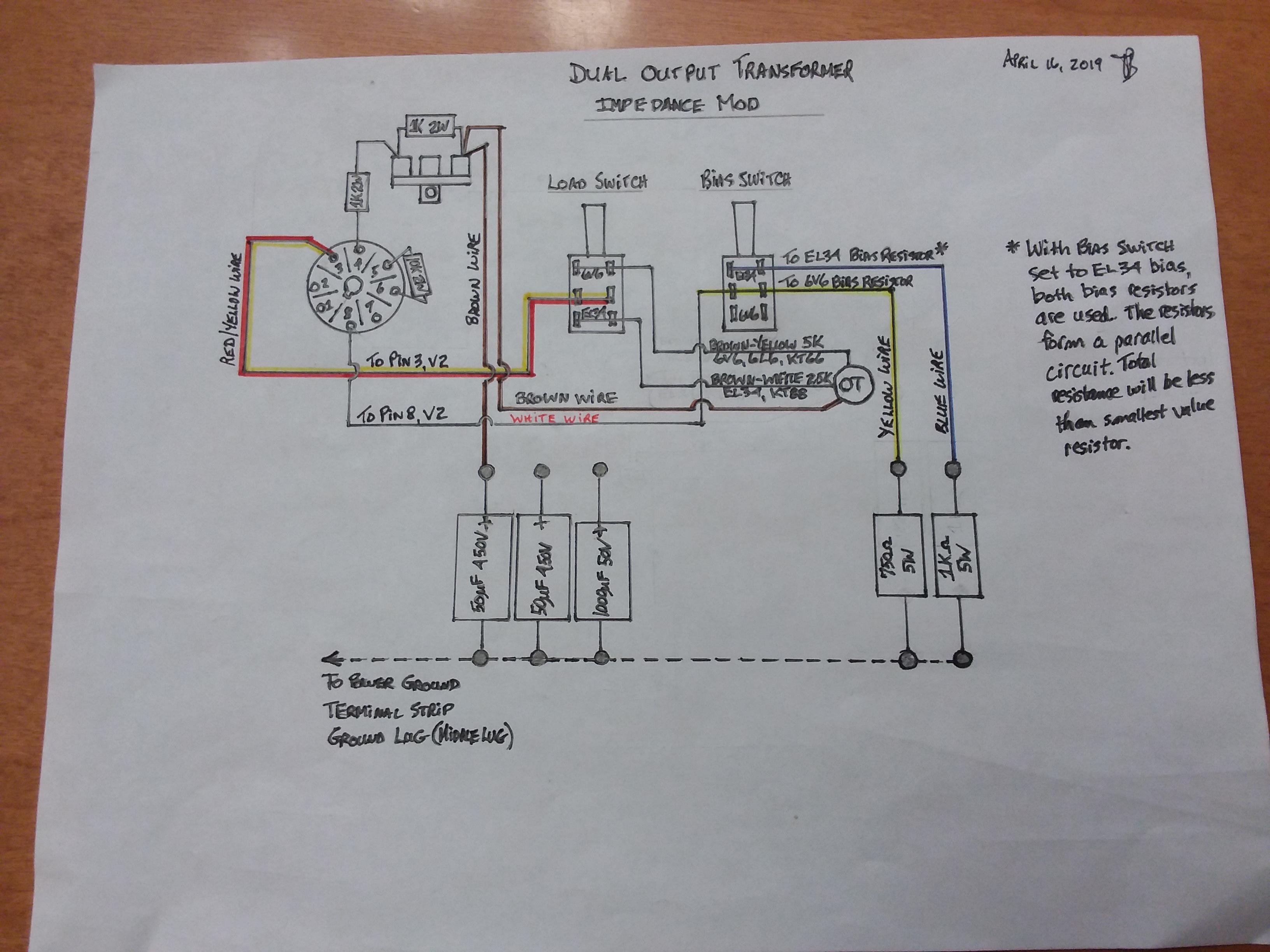

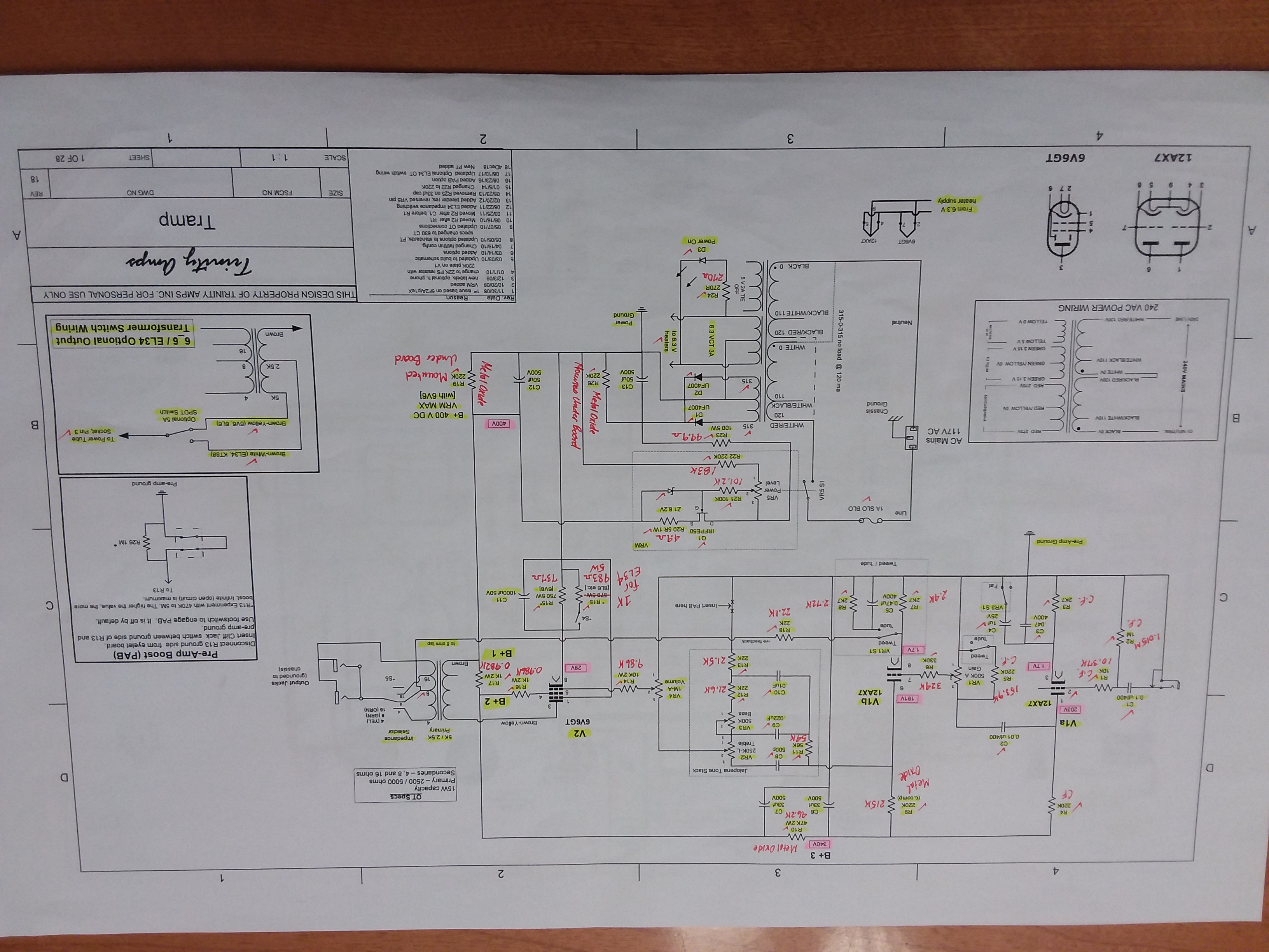

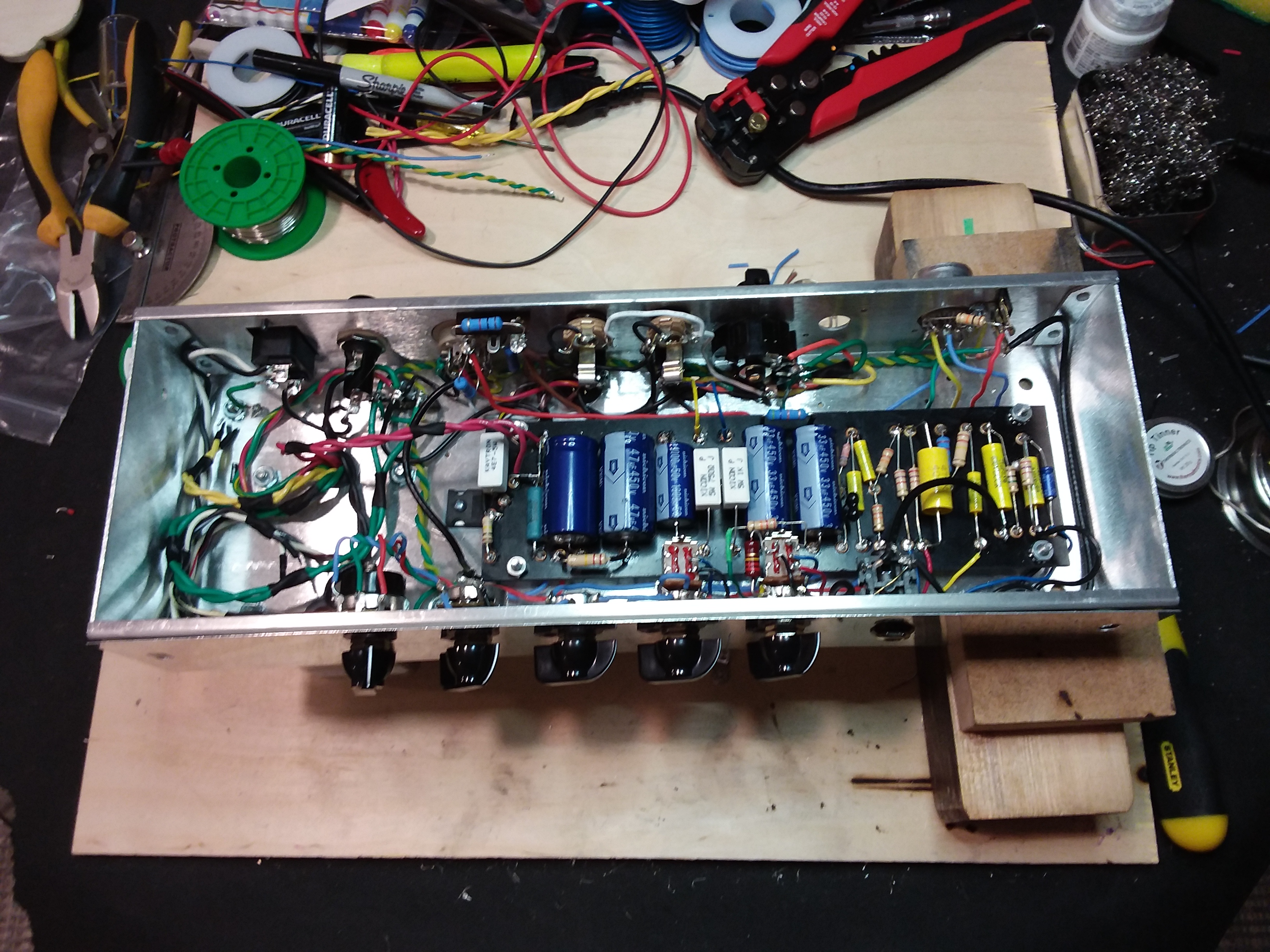

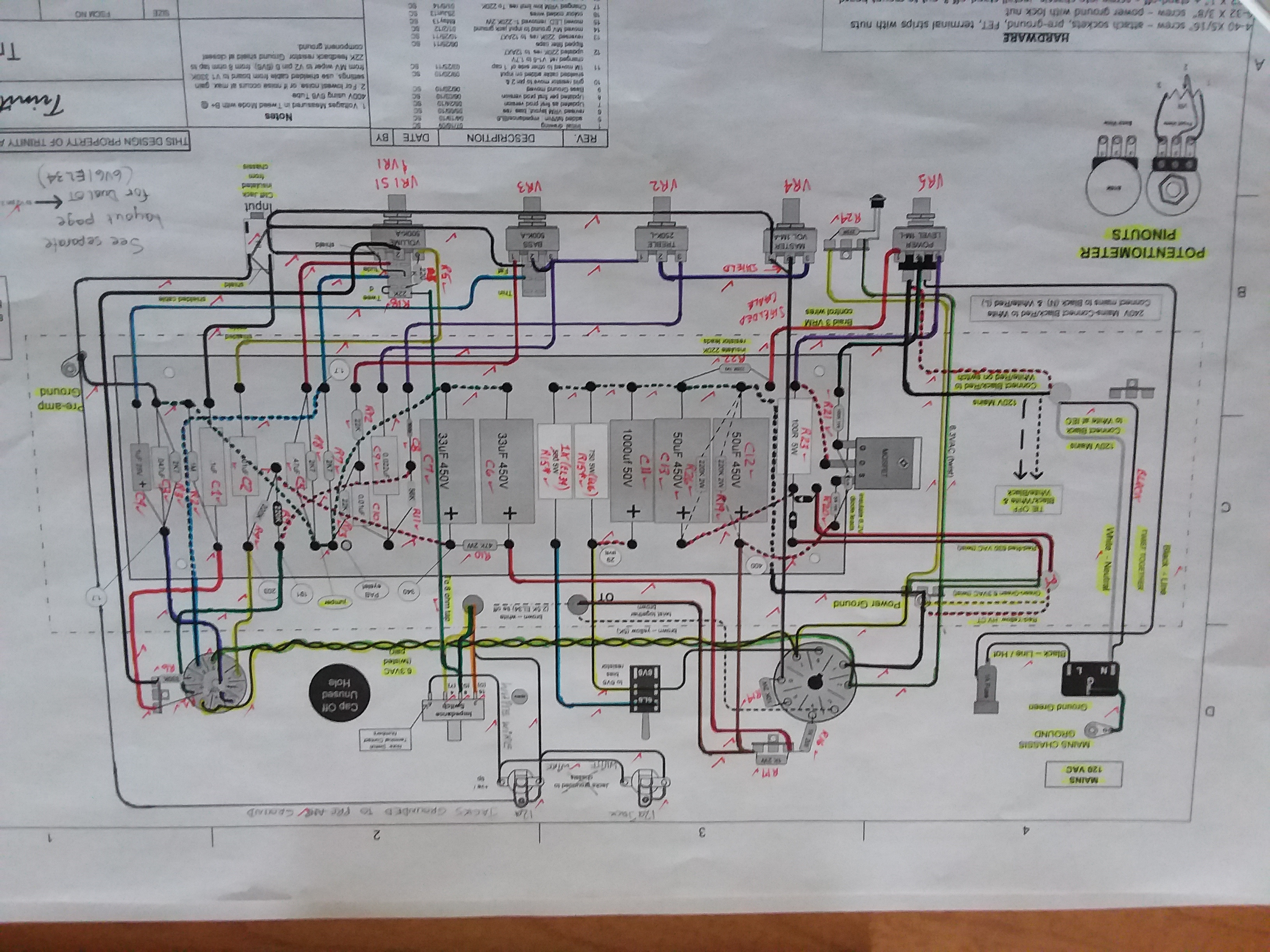

Here's some additional information for my build. I've attached an image of the layout where I coloured all of the wired connections the same colour as the wire I used in my chassis. I've also labelled each of the components to match the schematic. As well, the speaker connection jacks that I used are not the same as those on the original layout. I used 12a shorting jacks for the internal and external speaker connections which is why I have an external ground for them. These jacks use an insulating washer so they are not grounded through the chassis. The red check marks at all of the wire connections indicate that I've measured the resistance between the two points the wire is connected through to ensure there isn't an open circuit. I've also attached an image of the layout for the dual OT mod which I did. Hopefully it will be of some help for those of you that are planning to include this mod in your build.

Just looked at the pic of your build, and am curious as to why you put the 220K carbon comp resistor on the volume control and the 220K carbon film on the board eyelet and wire that runs to pin 6 on V1? :hmmm:

Actually, I put a 220K carbon film resistor going to pin 1 and a 220k metal oxide resistor going to pin 6. I didn't have a carbon composition resistor and couldn't get one at my local electronics supply, all they had were carbon film. I think they would both have been fine with carbon film. Did you get the same type of voltage readings that I'm getting at C12 with the power level control at min and max? I can't see how it's possible to get 400vdc when the control is at idle. The way the circuit works it doesn't make sense.
I also installed some tubes and am not getting any kind of sound at all. The amp is dead quiet. I went over the circuit 3 times checking for open circuits or wires that were in the wrong place. Found only 1 wire that was going to wrong pin of V1. Damn! :damntech:

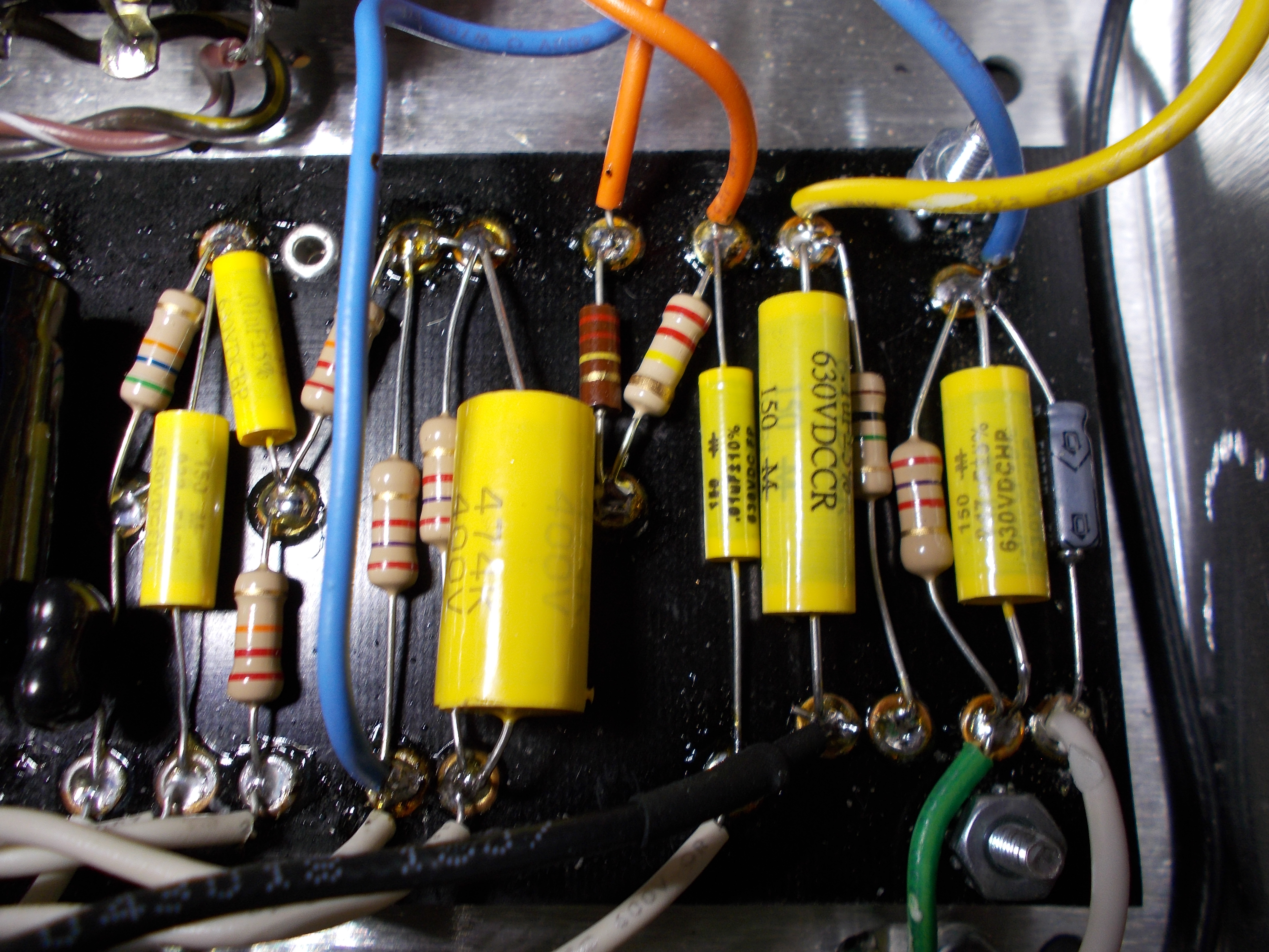

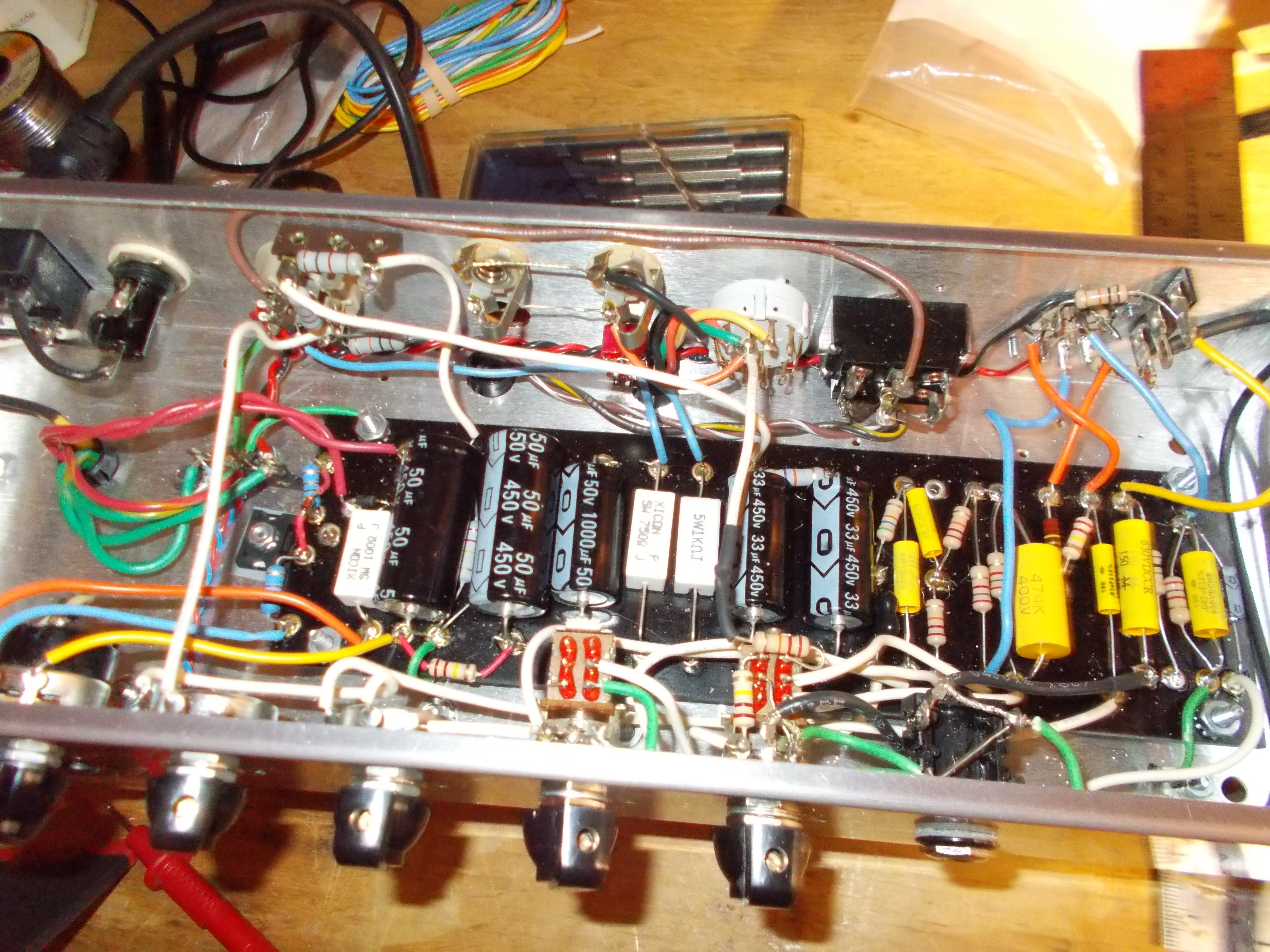

Here are pics of my board. Can't see the two 220k blue power resistors under first two 50uF caps.
