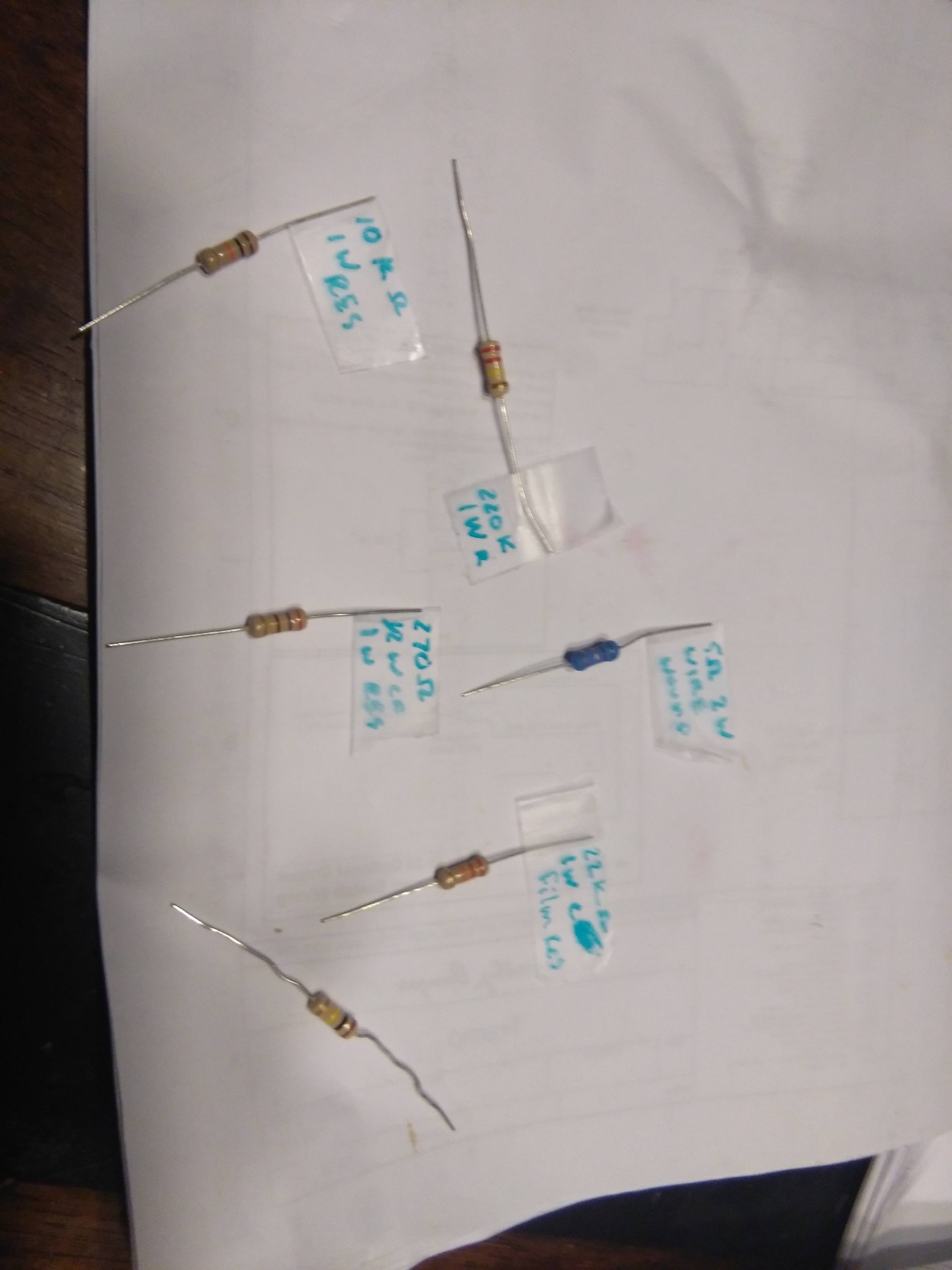

File comment: The resistors I haven't used yet. Hoping one of these is my resistor for v2, pins 5&6.

Looks like you are missing a grey metal oxide (10K,Brn-Blk-O) in your remaining resistors. Are you located someplace where you have an electronics store? If not, you may have buy online. Resistors are fairly cheap, but shipping is murder. Amazon can work , but locating the proper values is a pain! I live in OK and I use Antique Electronics Supply/Amplified Parts(same people, different name) in Tempe,AZ. Takes 4 to 5 days, but their shipping straight down I-40 to me!!

Is the missing resistor the one I'm missing at v2, pins 5&6? Does everything else look ok? And the cf resistor that's unlabeled, it's a 10k, correct? Would that work instead of MO?
PostPosted: Mon May 20, 2019 5:52 pm
The unlabeled resistor is a carbon film,1/2 or 1W 100K(brown, black,yellow). You probably need a 2W power resistor on V2,pin 5 & 6 since it's a power tube. You have a 10k 1W labeled near the top of your pic. Build guide and schematic call for a 2W on pins 5 &6 on V2. I don't know if the 1W would last :shock: Have you wired V1? V1 has a 10K 1W shown on pin2 to terminal strip.
PostPosted: Mon May 20, 2019 6:06 pm
Page 34 of builders guide shows what it should look like. Here's a good resistor code finder for future reference http://www.searchingtabs.com/rcolor/rescolor.htm Power resistors are usually gray or blue w/ a rough exterior. NOTE: the one blue (5R) you have in pic goes near VRM in power section. Check your work on layout. You may not have gotten or maybe mislaid the resistor you need.

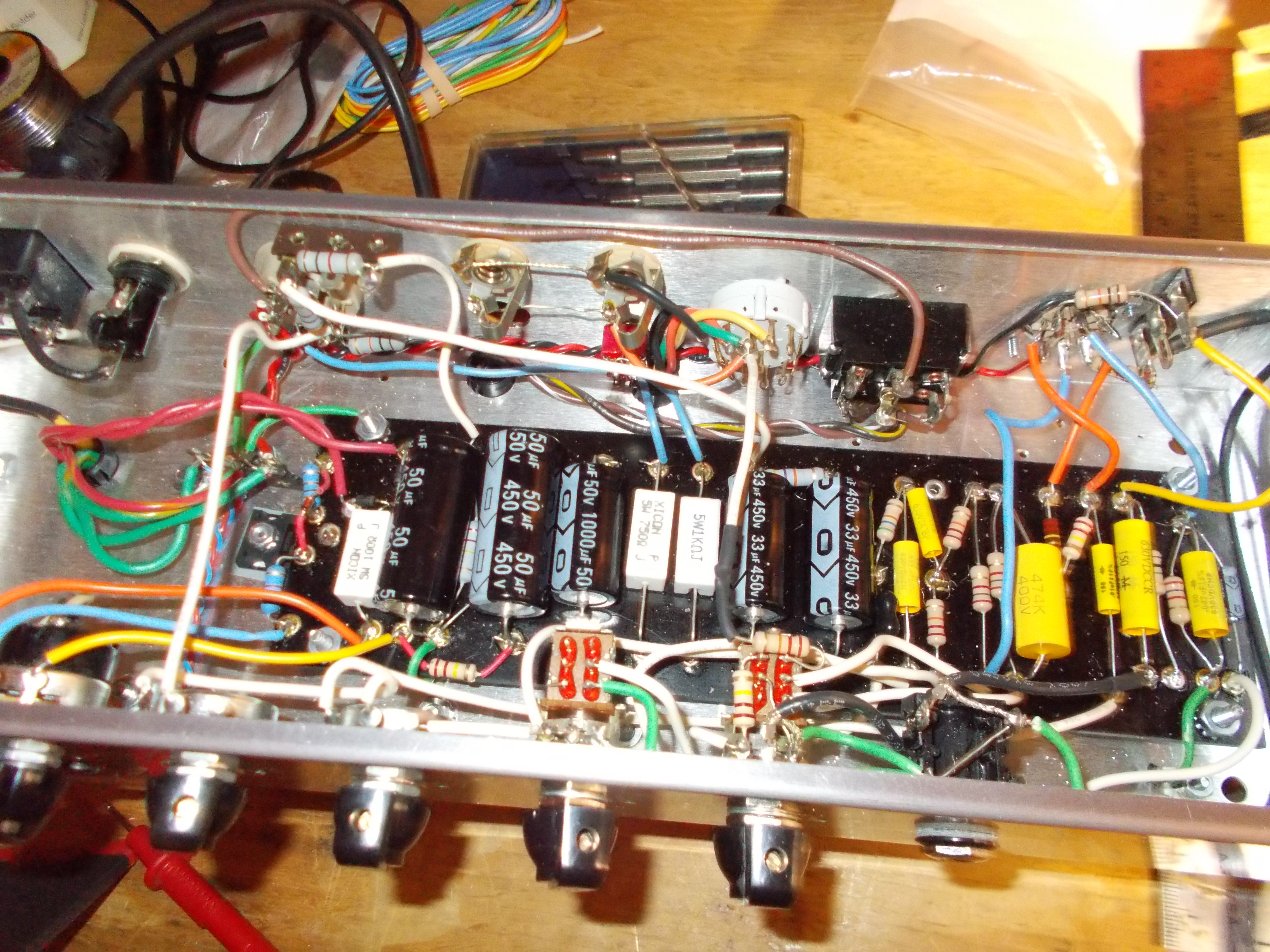

NO! The blue 5R goes on the board near the VRM!! Have you installed resistors on V1 (preamp) socket? Post a picture of V1, if you have. V1 uses a smaller wattage 10K resistor (in your remaining resistor photo) than the V2 (power tube socket). Metal oxide power resistors are usually blue (1W),or gray(2W). Look at my post on "State of the Tramp Message), it has a fairly good pic of amp guts. once it's up, you can click your computer cursor and magnify any section. Also, you can contact Coco (Stephen) using the "Send A PM" section from your User Account Control (upper right of forum page) to get a definite answer. Here is gut shot of my Tramp

Snowy, that was some pretty work and very clear photos. Hopefully it 'll help Epifool. I'm beginning to think he either mislaid, didn't get or installed the 10K power resistor on the V1 socket which uses a 10K CF. There's no place else on the current layout that uses a 10K resistor and his photo didn't show V1.

I must not have gotten it. I'll order one or some from somewhere. I've checked every resistor. V1 isn't wired yet, that's why no pics. And I was tired trying to reply the other day, that's how I confused the blue and grey. I knew the remainng blue went next to the vrm. Was just hoping I had made an easy mistake. Thanks all, will update as I progress toward the end!
