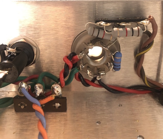

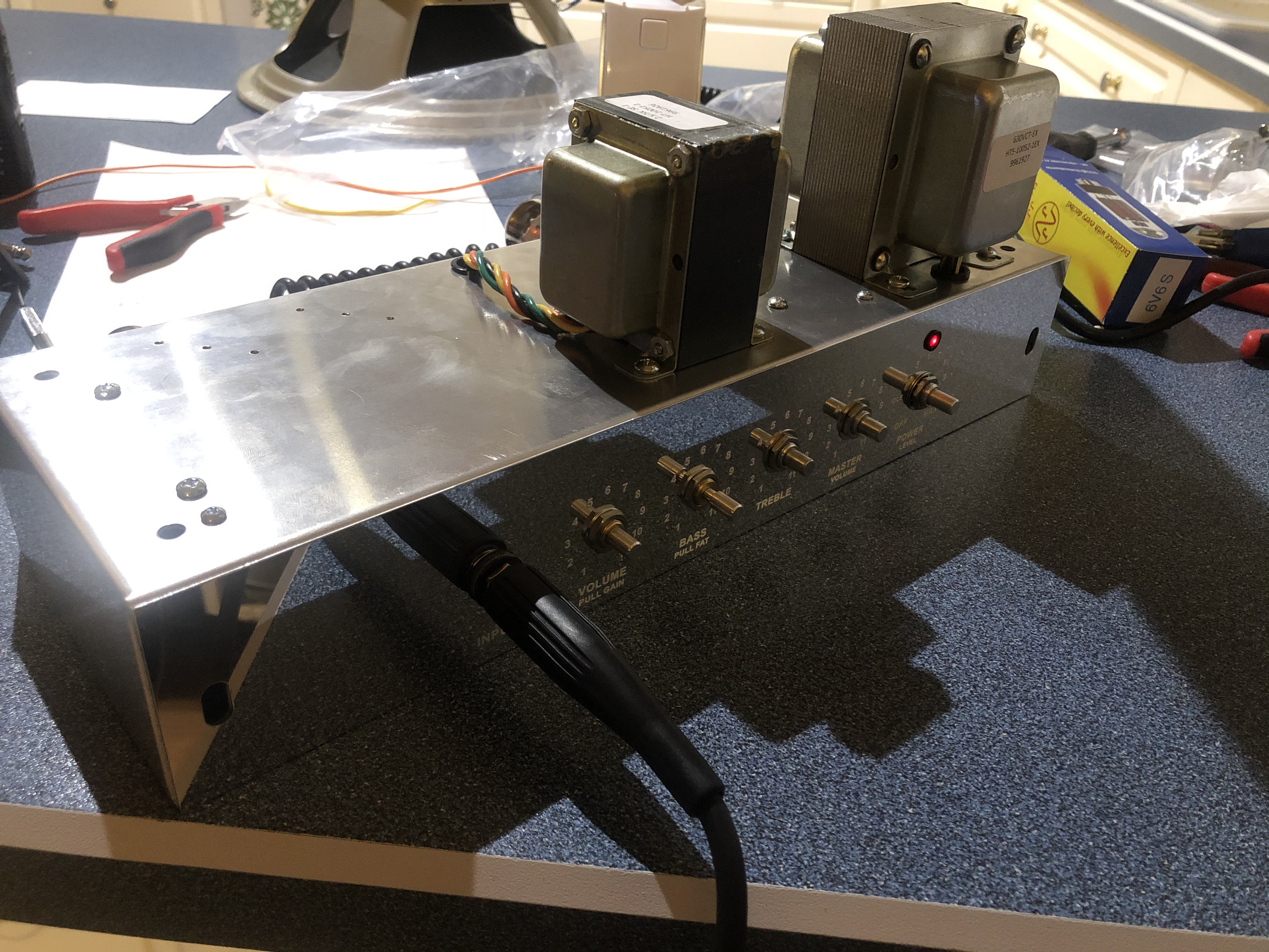

PostPosted: Tue Dec 03, 2019 12:19 am
Posts: 38
Coming along. Worked on it this weekend.

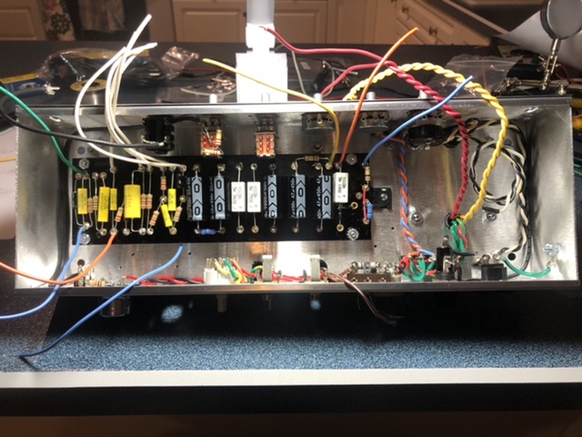

Wiring this evening.

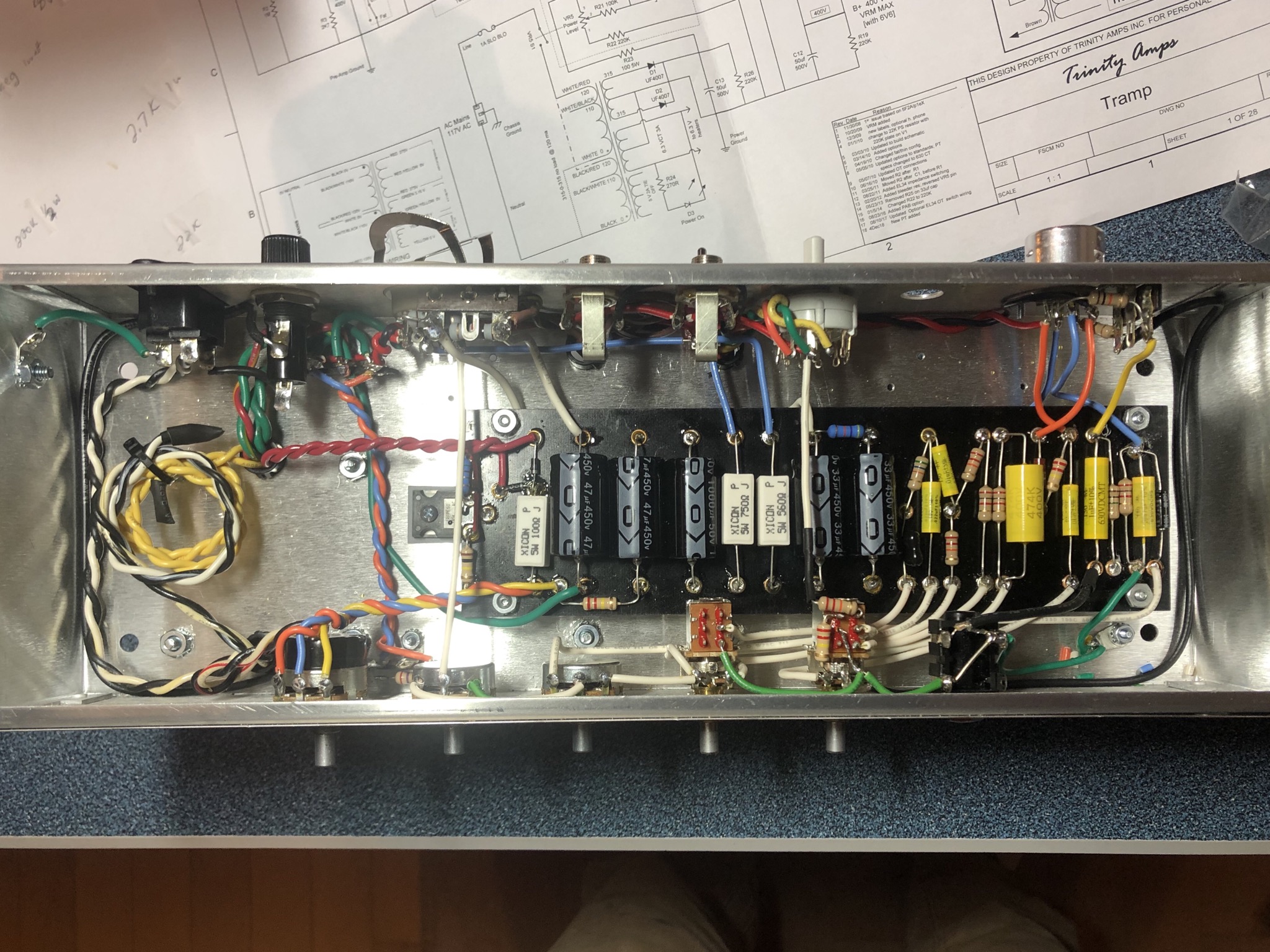

PostPosted: Tue Dec 03, 2019 1:59 am
Posts: 38
All wired. Now double check everything.

PostPosted: Tue Dec 03, 2019 1:16 pm
Looks good, I can't see it in your final photo, is the blue jumper there between eyelets 3 and 2 on the Bass control? and thanks for the gut shot , always good to see other people's wiring style. Always looking to improve mine :!:
PostPosted: Wed Dec 04, 2019 12:14 am
Posts: 38
Good eyes.
I just took the pliers & bent pin2 over to touch pin3, so when I soldered the wire on, all in joined together.

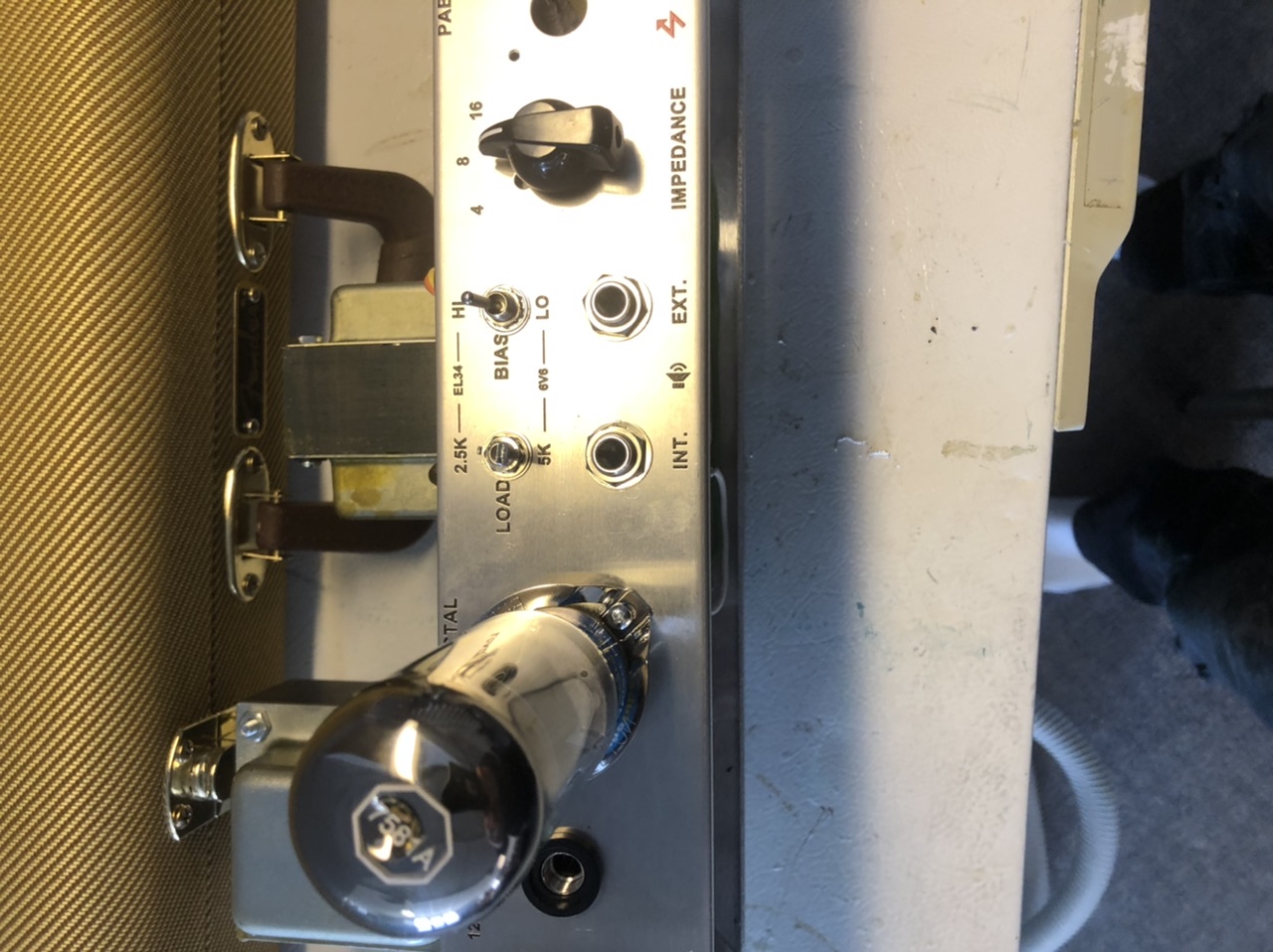

KT 88 works well in the Tramp, but you'll have to remove the supplied tube retainer clip (tube base too large), if you haven't already discovered that :(

Posts: 38
Put the 7581 in this evening. Changed the bias switches to 5k & Hi. Sounded great.
Cranked it to the max, it was screaming real nice, then started cutting out, saw a slight bit of the dreaded smoke from the Power tube area, then dead.
Checked the fuse, blown. Replaced & put the tube back in. Glows with a little bit of lightning inside.
No sound.
Bad tube?
Scott
PostPosted: Mon Dec 16, 2019 10:08 pm
Scott, all I can suggest is to check the bias and load switches, particularly the load switch. There have been some problems reported with them arcing on the Tramps and at least one OSD (may have happened on another, but I can't recall which it was). Seems as if it usually happened during cranked up conditions. If it arced, may have taken out the power tube. Just spitballing, may be something else entirely. :hmmm:
