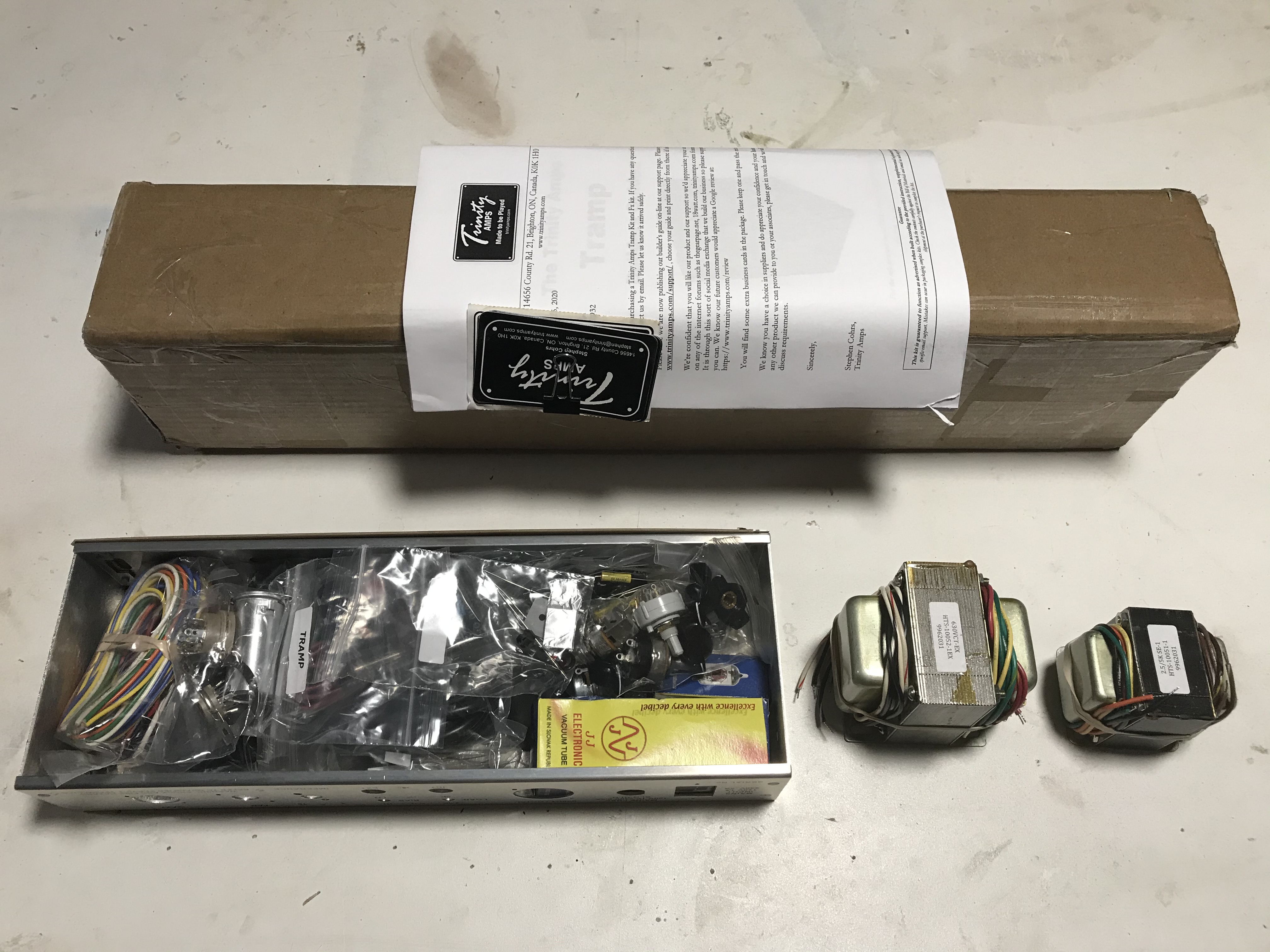

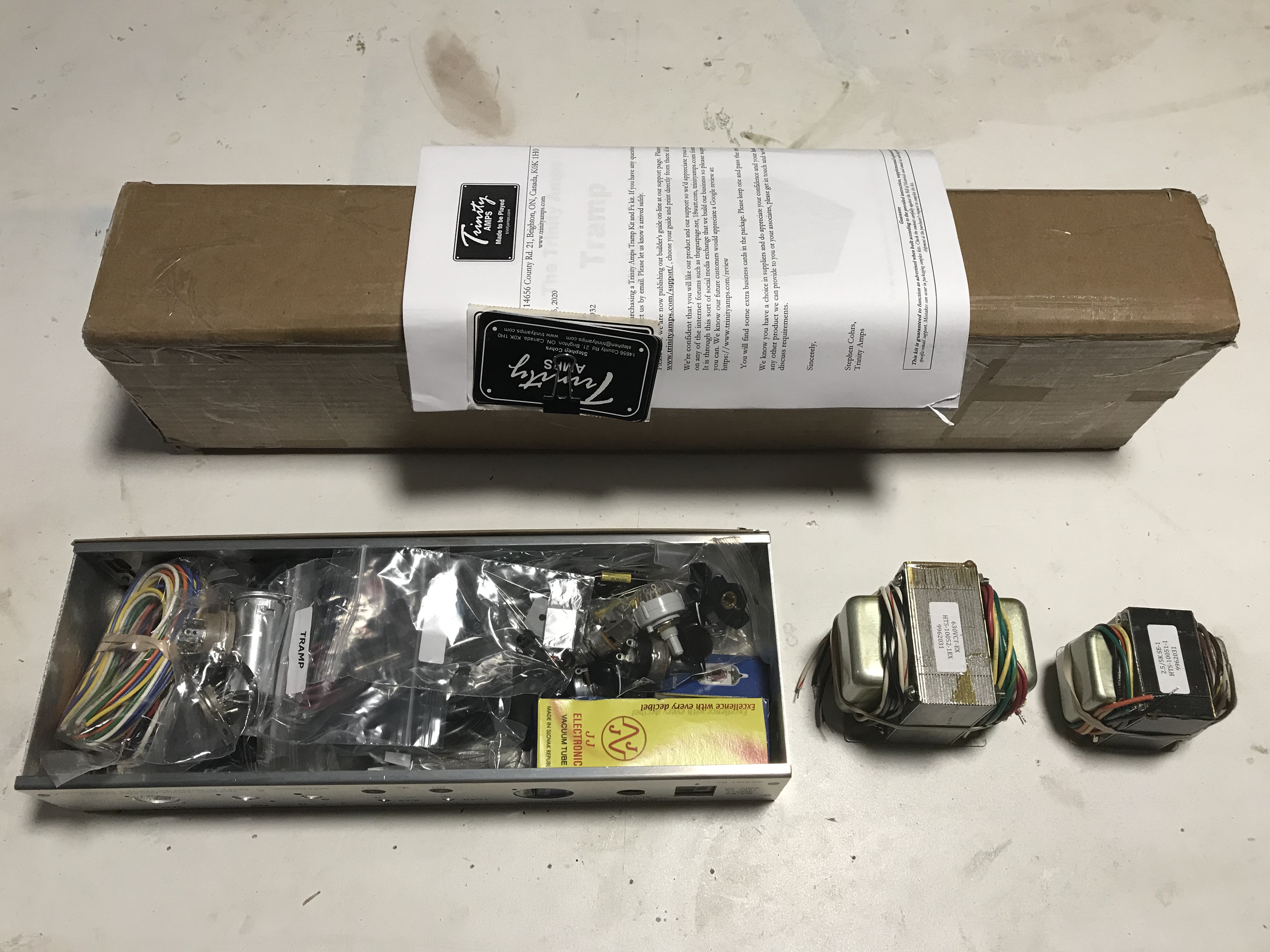

I've been dabbling in electronics for many years. Did a bunch of Monte Allums pedal mods, upgraded a VHT Special 6 Ultra, and modified 4 Fender Blues Jr's (billm), converted one of them from EL84's to 6v6/5881/6L6. Super fun!
So I figured it was time to do a complete build. I've also began doing more woodworking lately so looking forward to building the head cab and speaker cab; box joints, routing, etc.
I'll try to document this the best I can for posterity and to help other builders... just like a few of the other threads will no doubt help me.

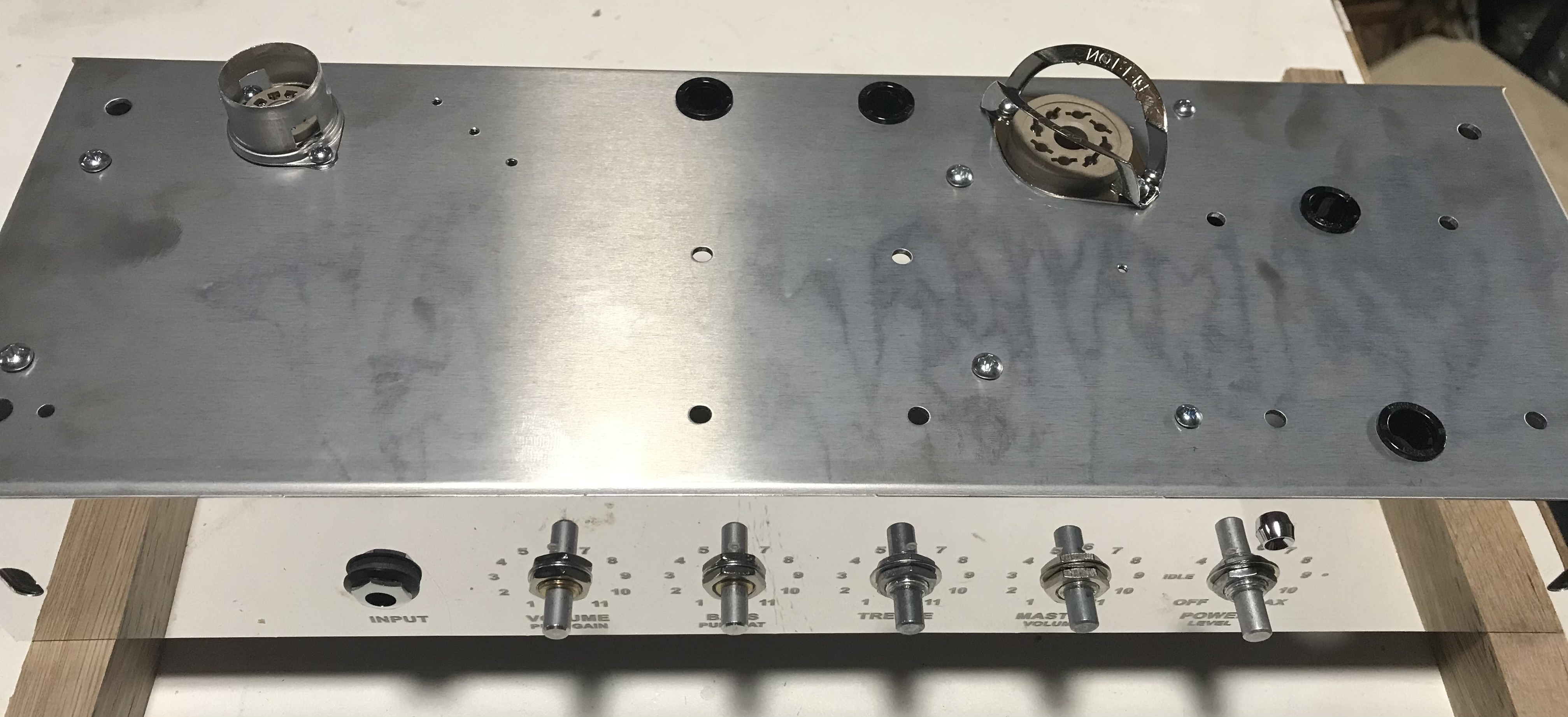

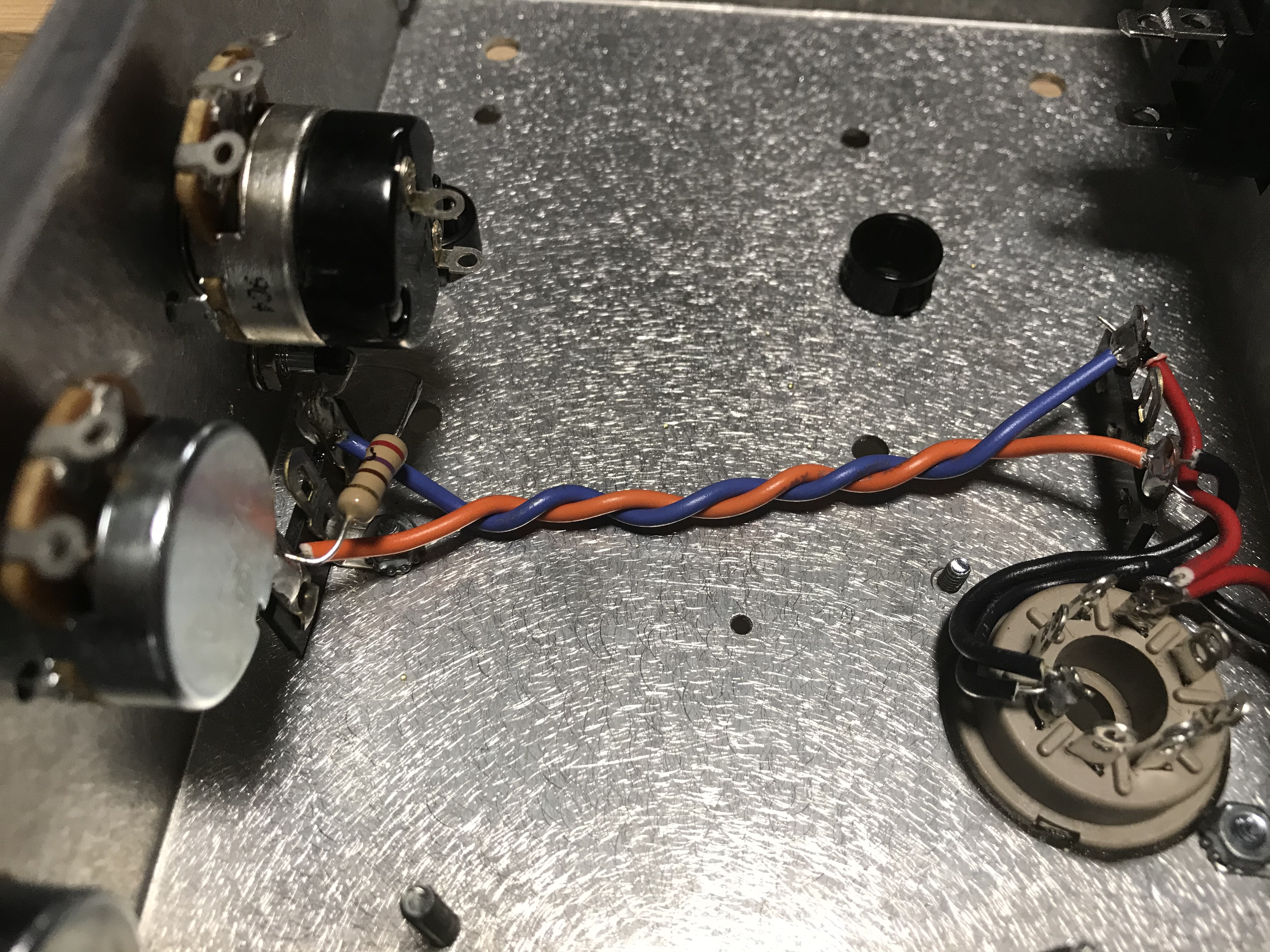

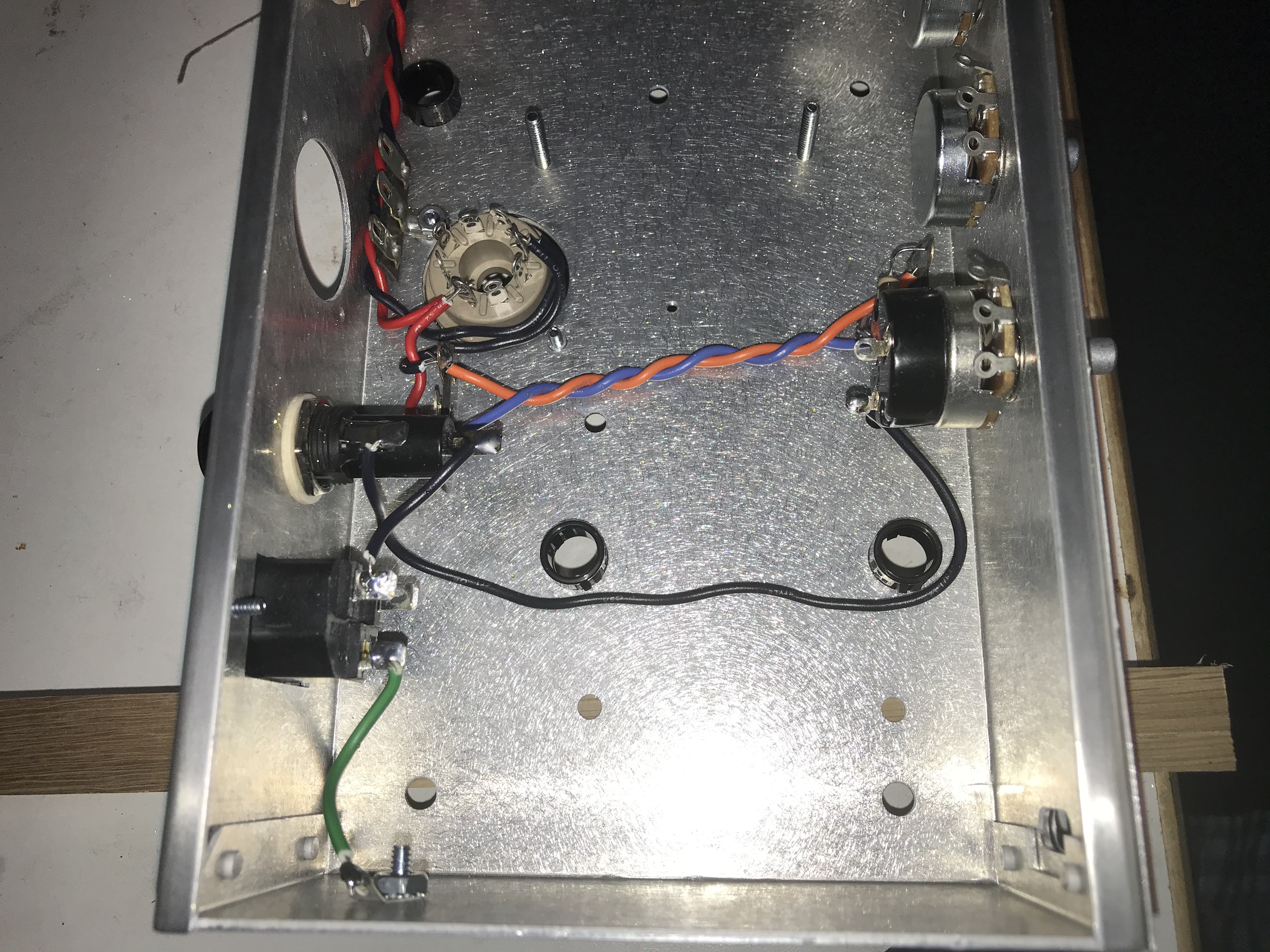

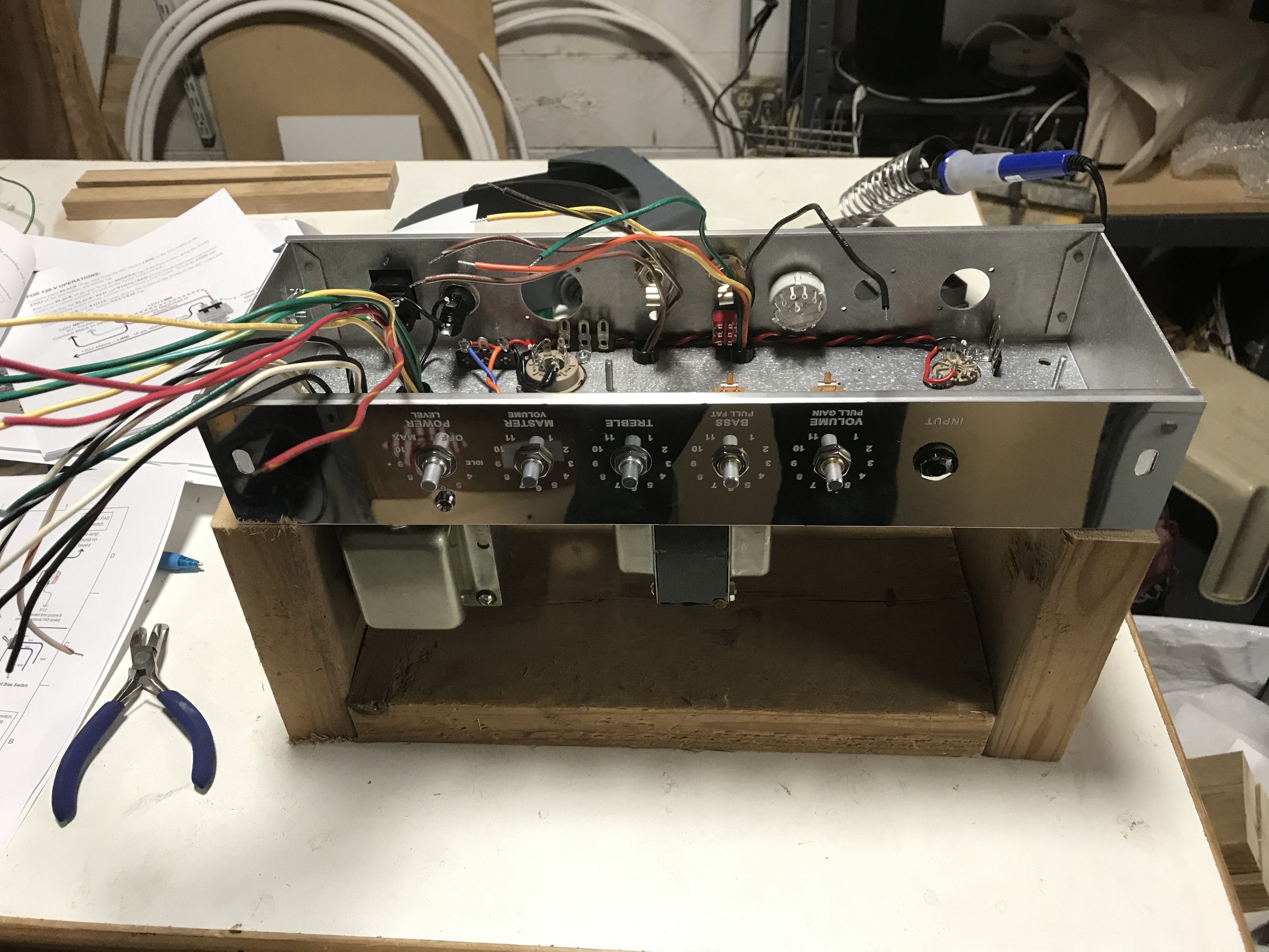

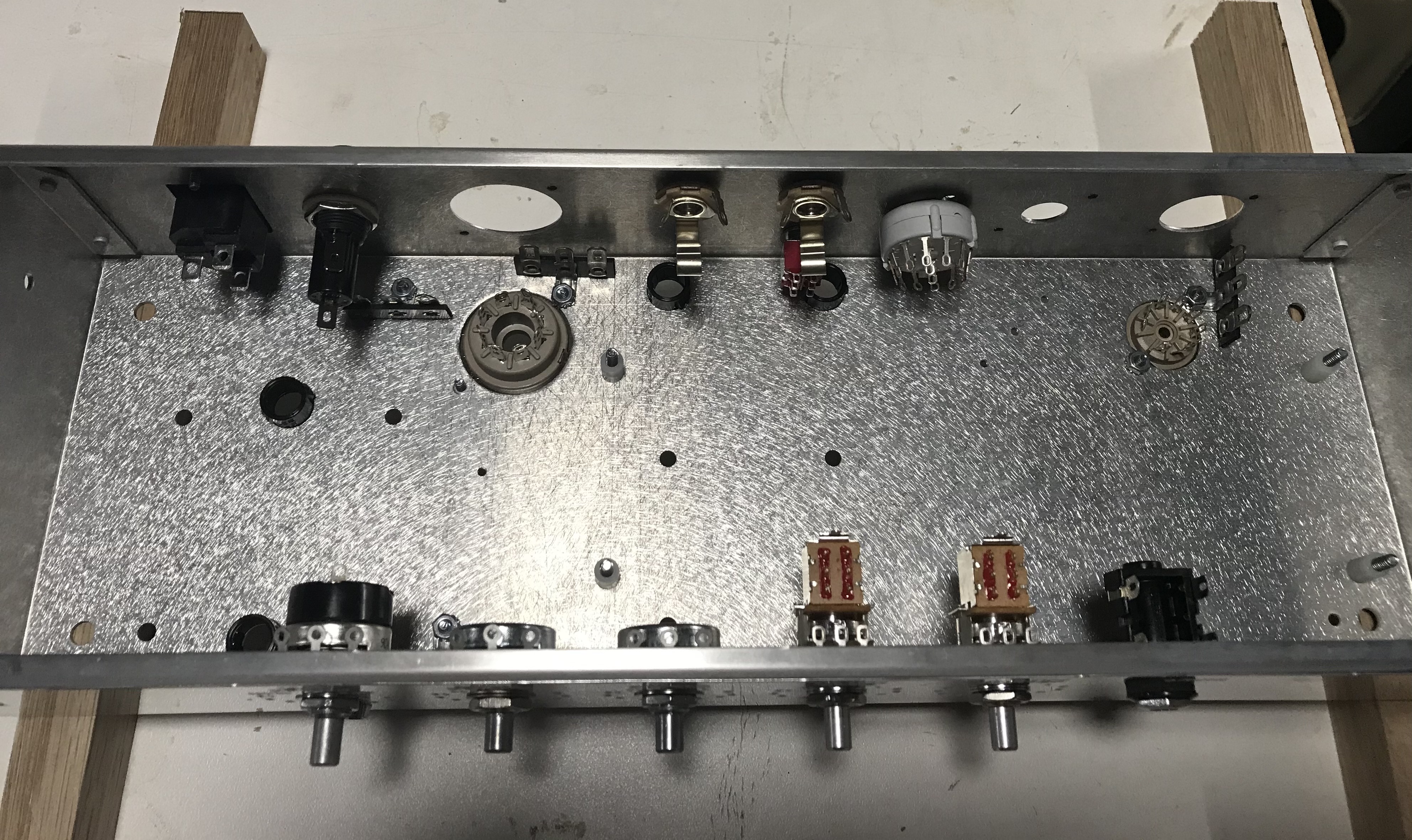

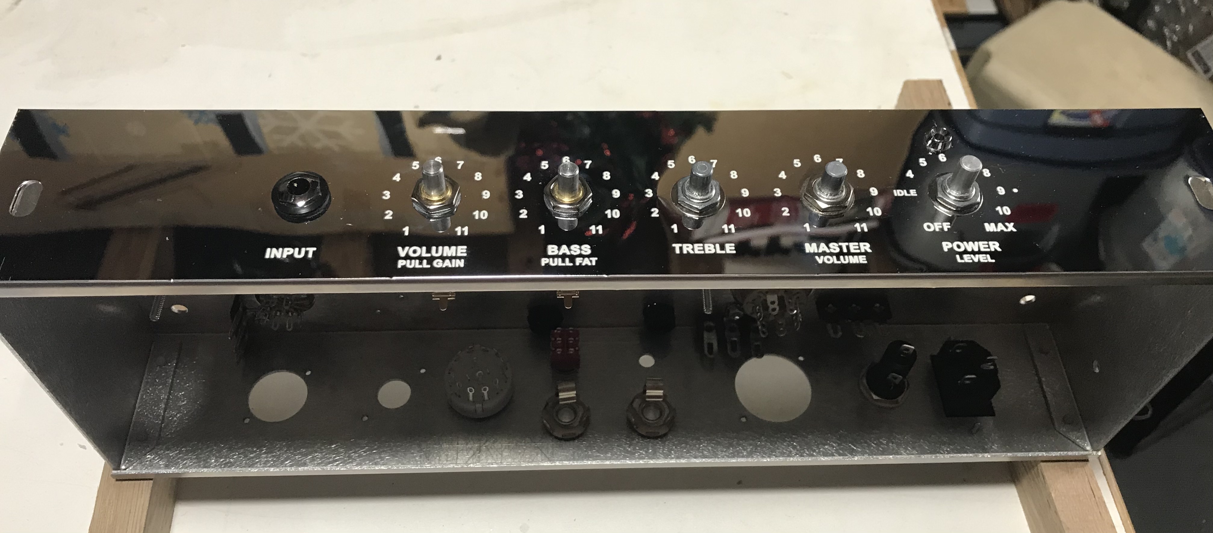

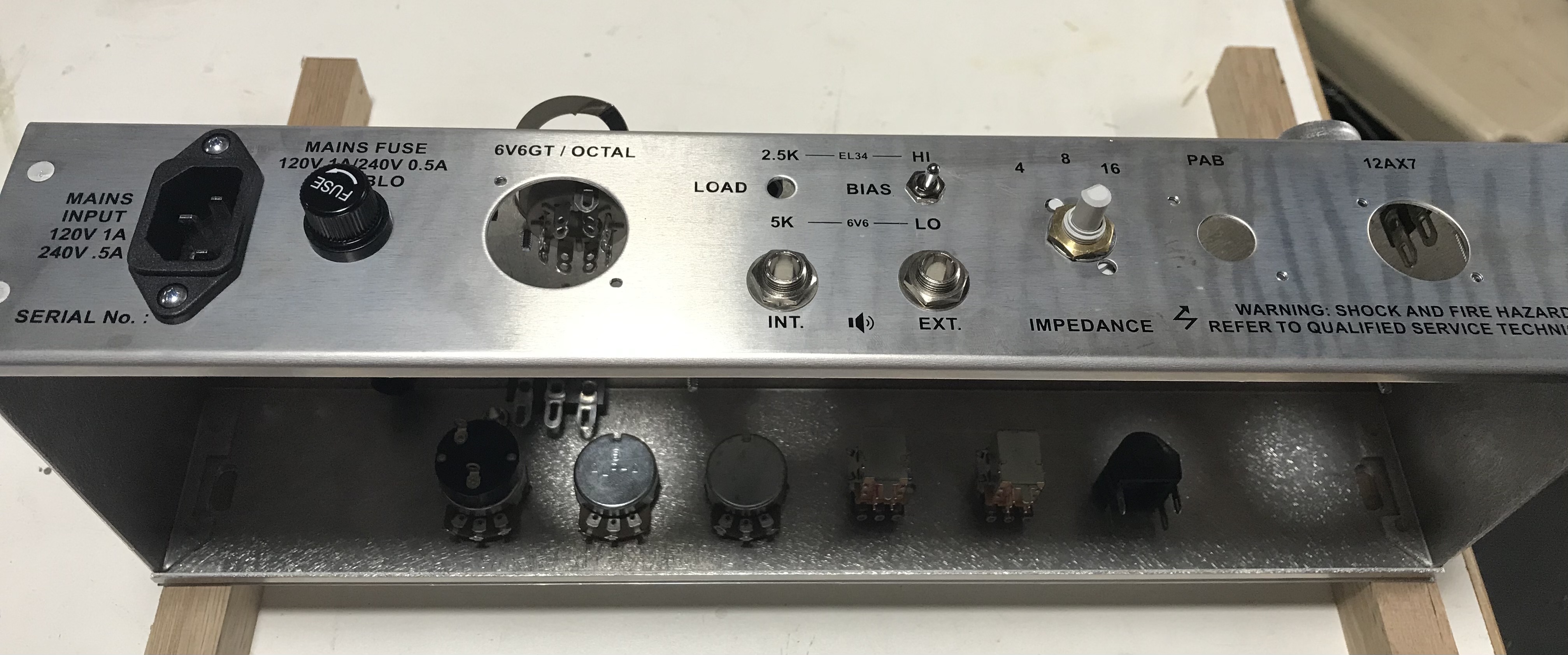

Tonight, I installed all the hardware!

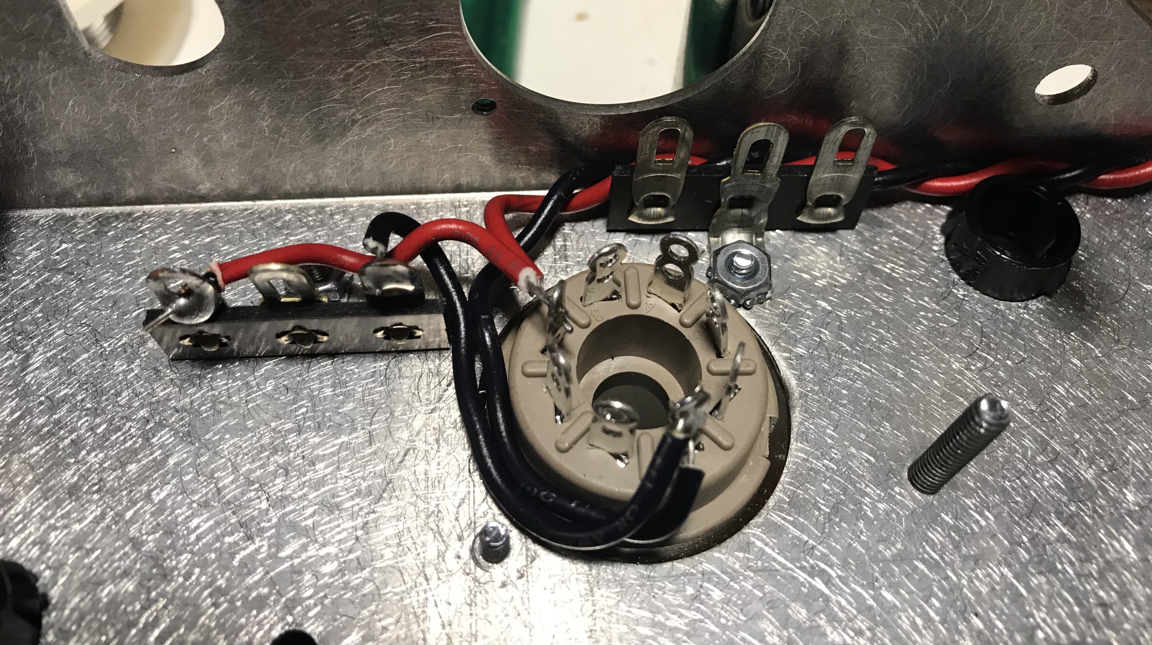

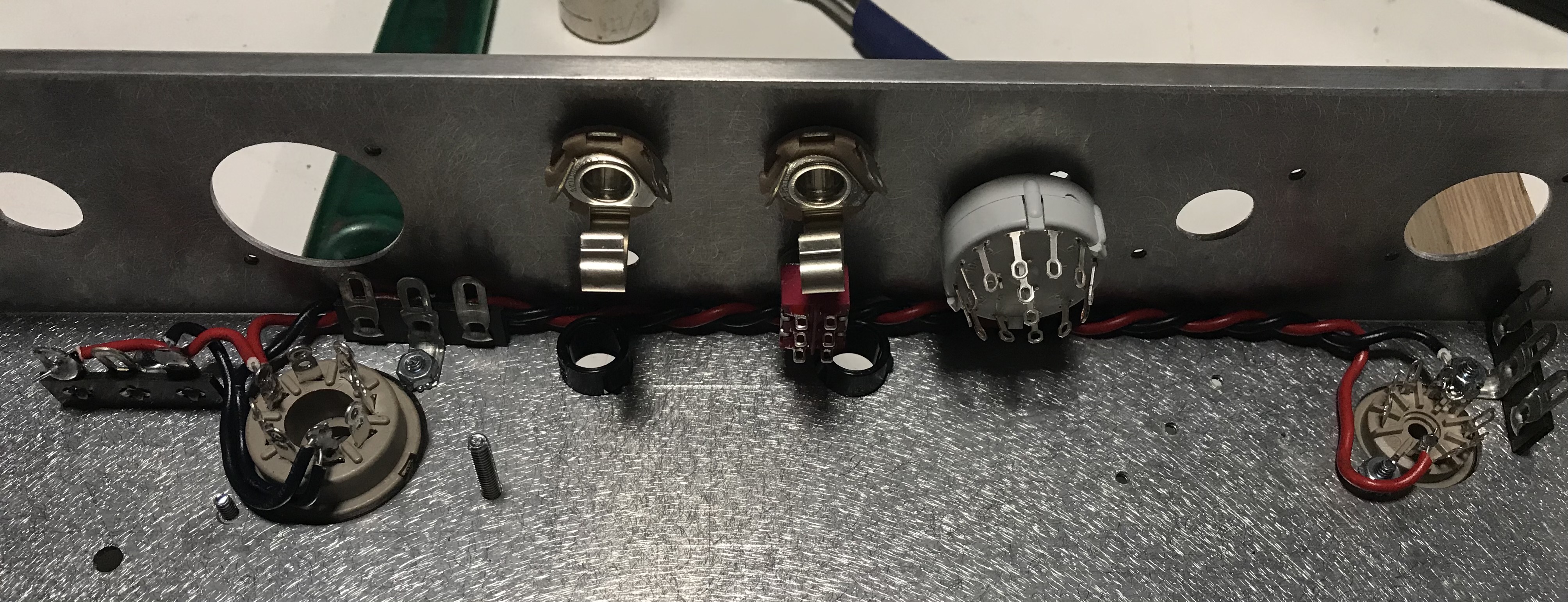

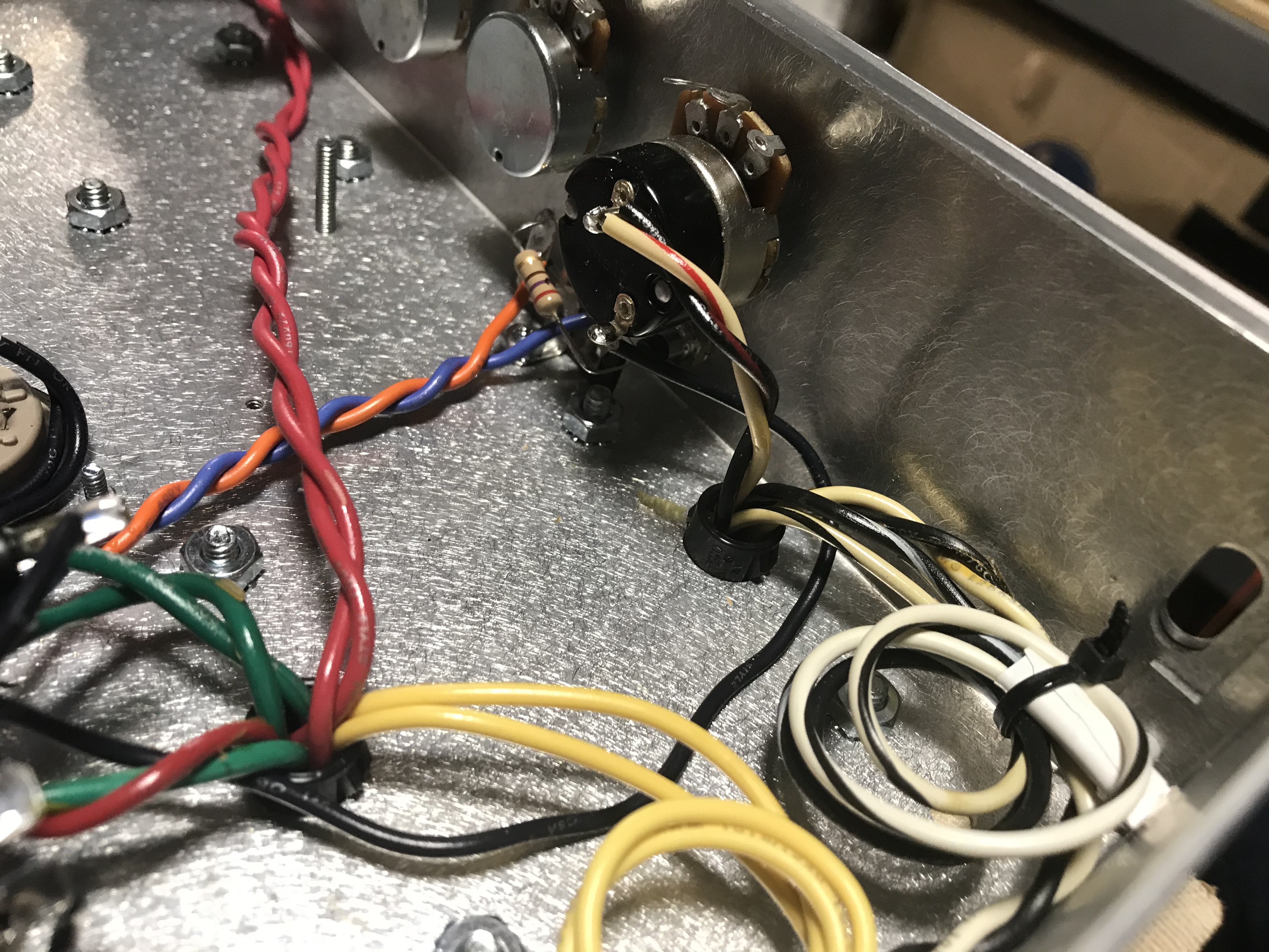

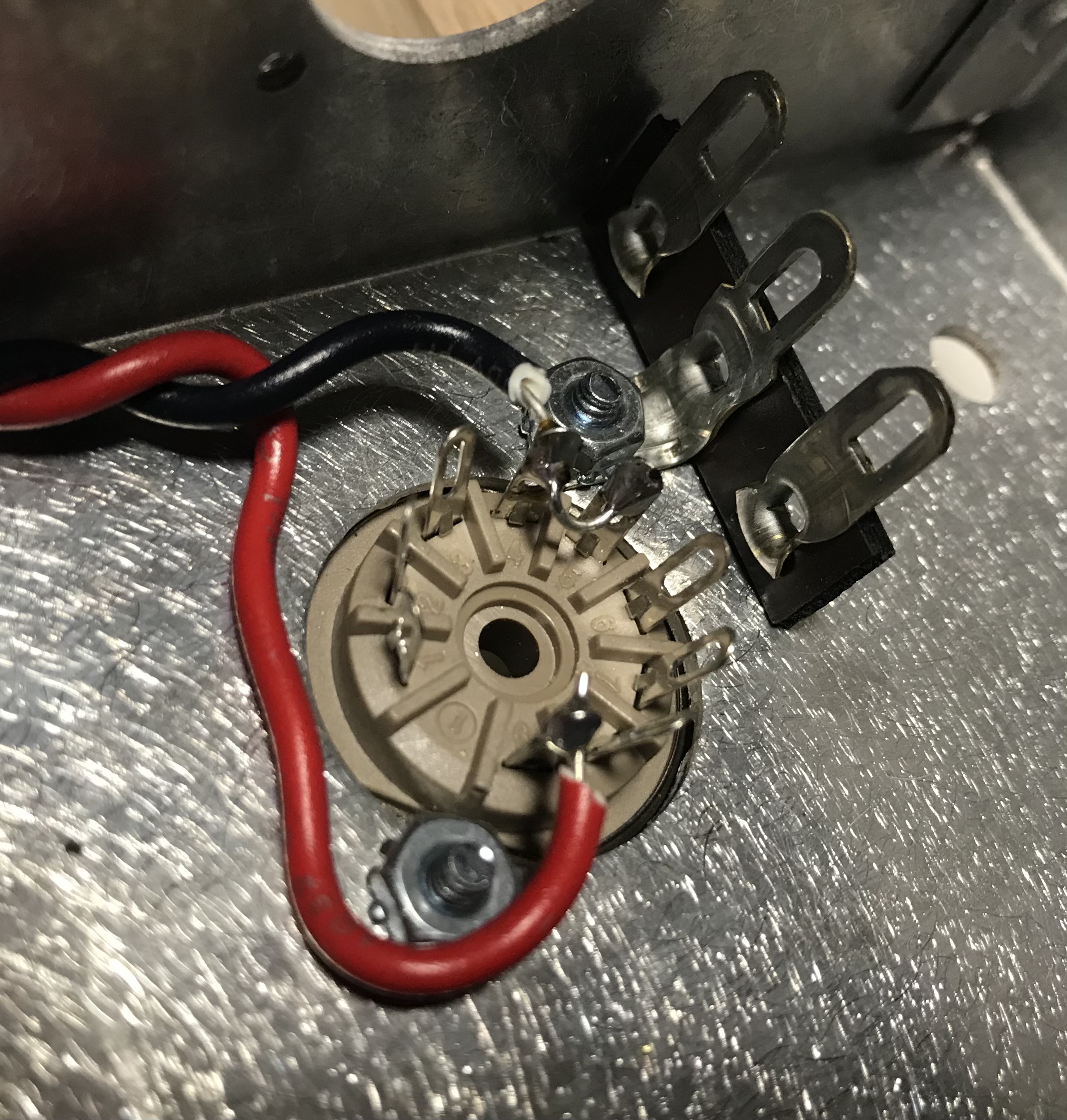

Also soldered the heater wires in... had to remove the fuse socket first.
File comment: Preamp Tube Wiring

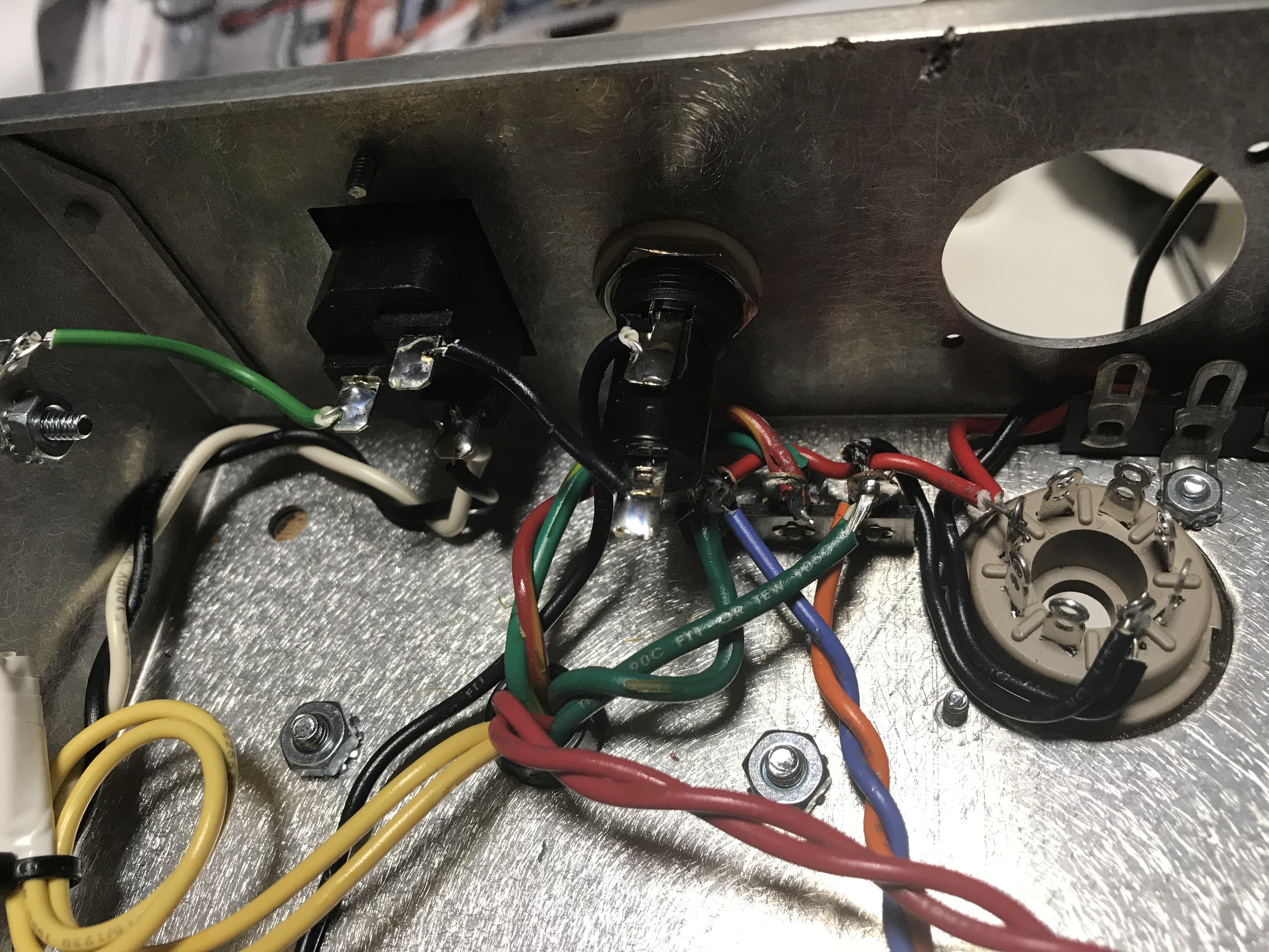

Got the transformers installed and the PT wired.

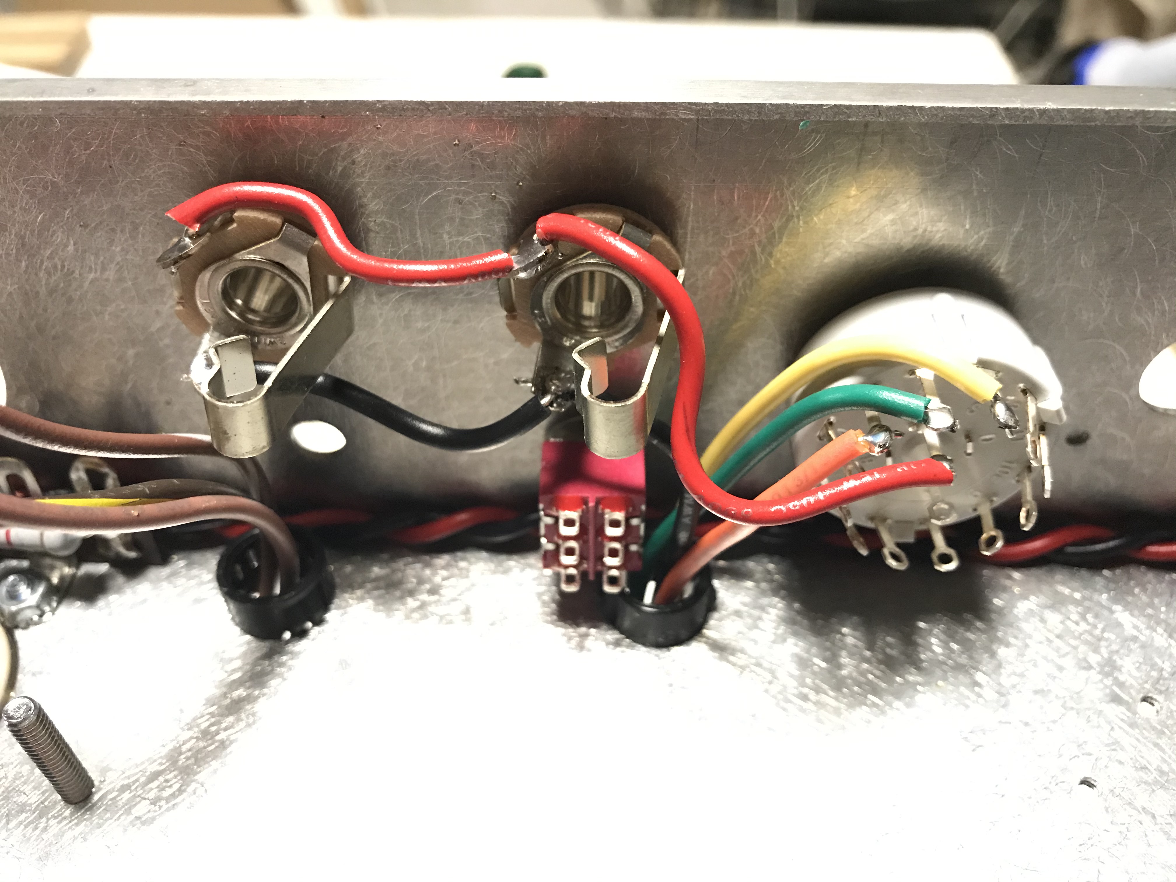

Wired up the OT.

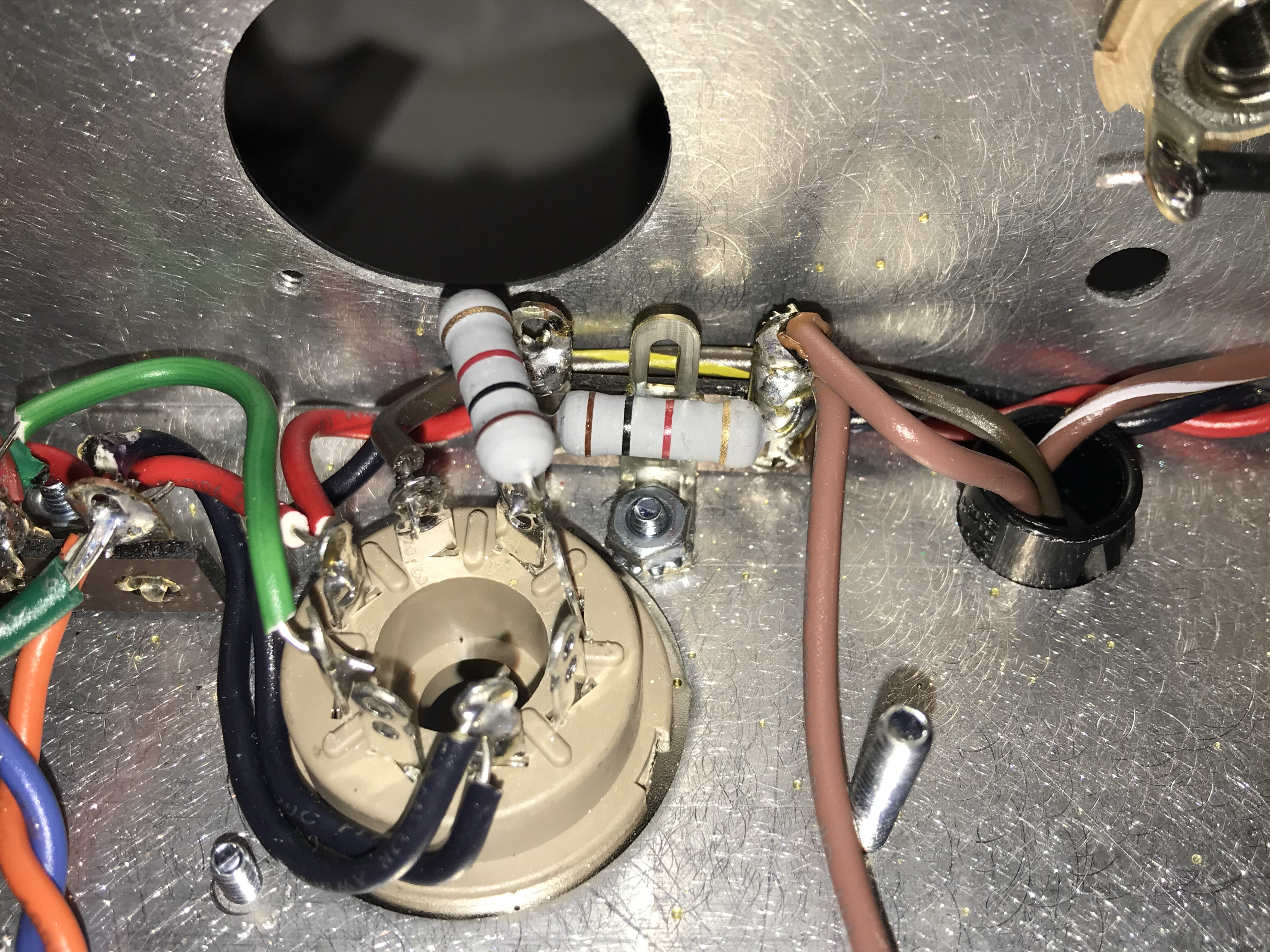

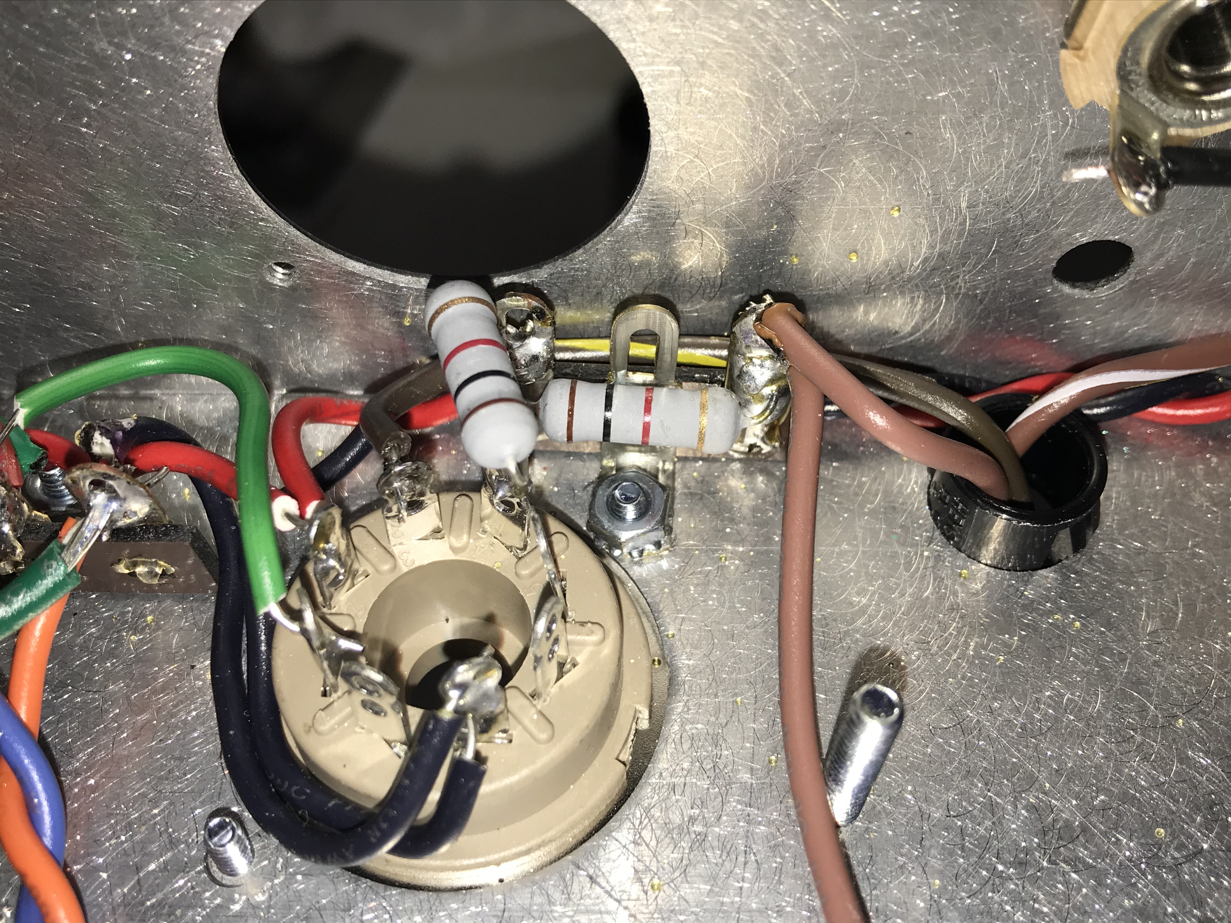

Question. The 10k resistor across pins 5 and 6 of the octal. I didn't receive a 2W resistor like the layout and instructions say, but I did receive a blue 10k 1/2W resistor. Is that sufficient? If not, I can get them from Amazon for a few bucks.
PostPosted: Thu Nov 26, 2020 3:22 pm
Would recommend the you get the power resistor (10K 2W) or PM Coco (Stephen) to send one. What does the one you have look like (maybe a pic) ?
PostPosted: Fri Nov 27, 2020 6:39 pm
Posts: 23
I ordered a pack from Amazon. The 10k that came with it is small and blue. The ones in the Builders Guide picture are larger and grey like the 1k resistors near/on the octal terminal.

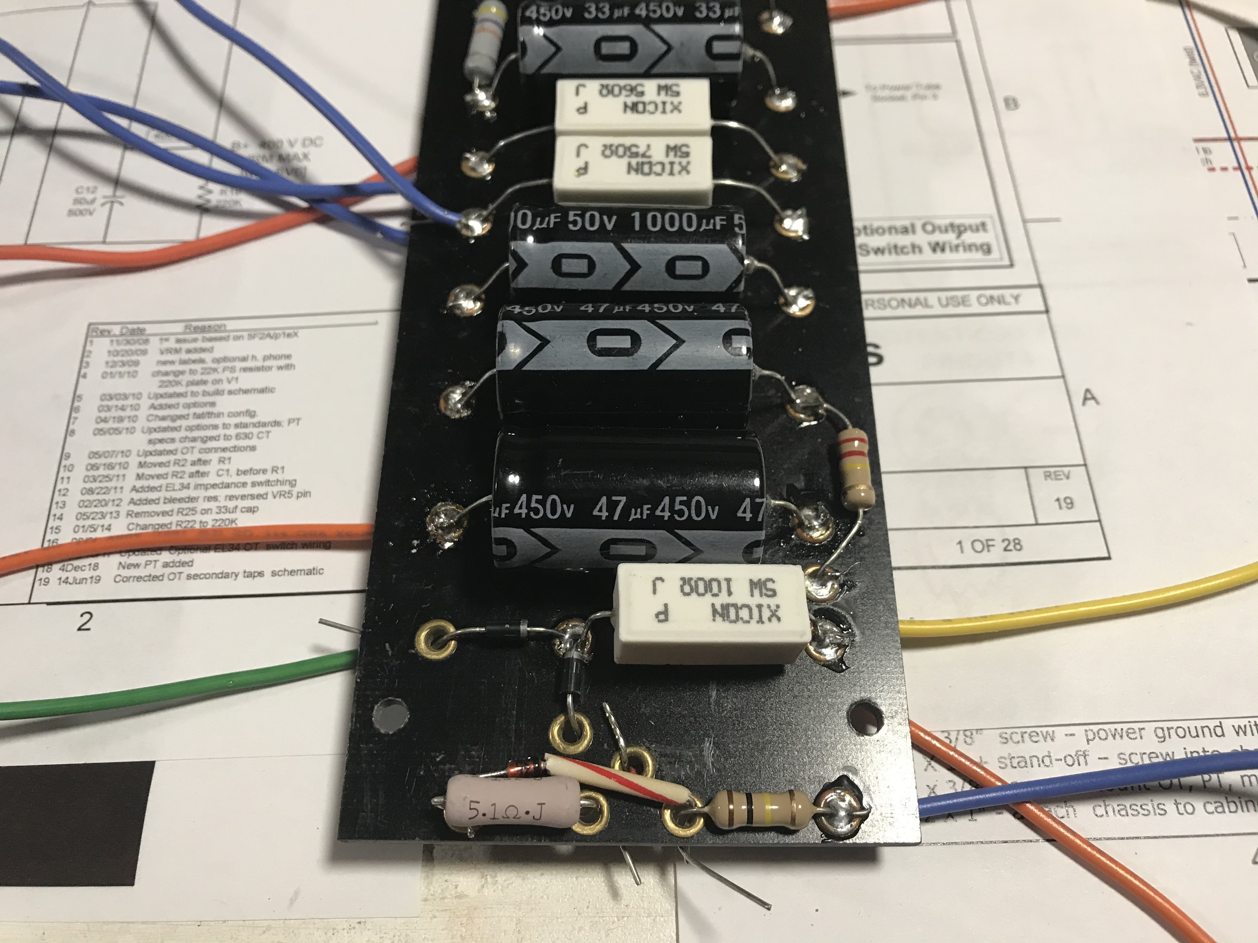

On page 45 of the builders guide, it says: Note: Make sure the cathode bias resistors for the power tubes are separated from the bypass
cap and slightly raised off the board as this resistor can emit some heat.
Which ones are the cathode bias resistors?
PostPosted: Fri Nov 27, 2020 11:27 pm
That would be the 570 and 750 Ohm 5W resistors next to the 1000uF 50V electrolytic. Find something to rest them on that you can slide out after you solder them into the eyelet board (to separate them from the board). I used a small piece of metal flashing EDIT: or a thin coin. They can get pretty warm :!: H. Schepers

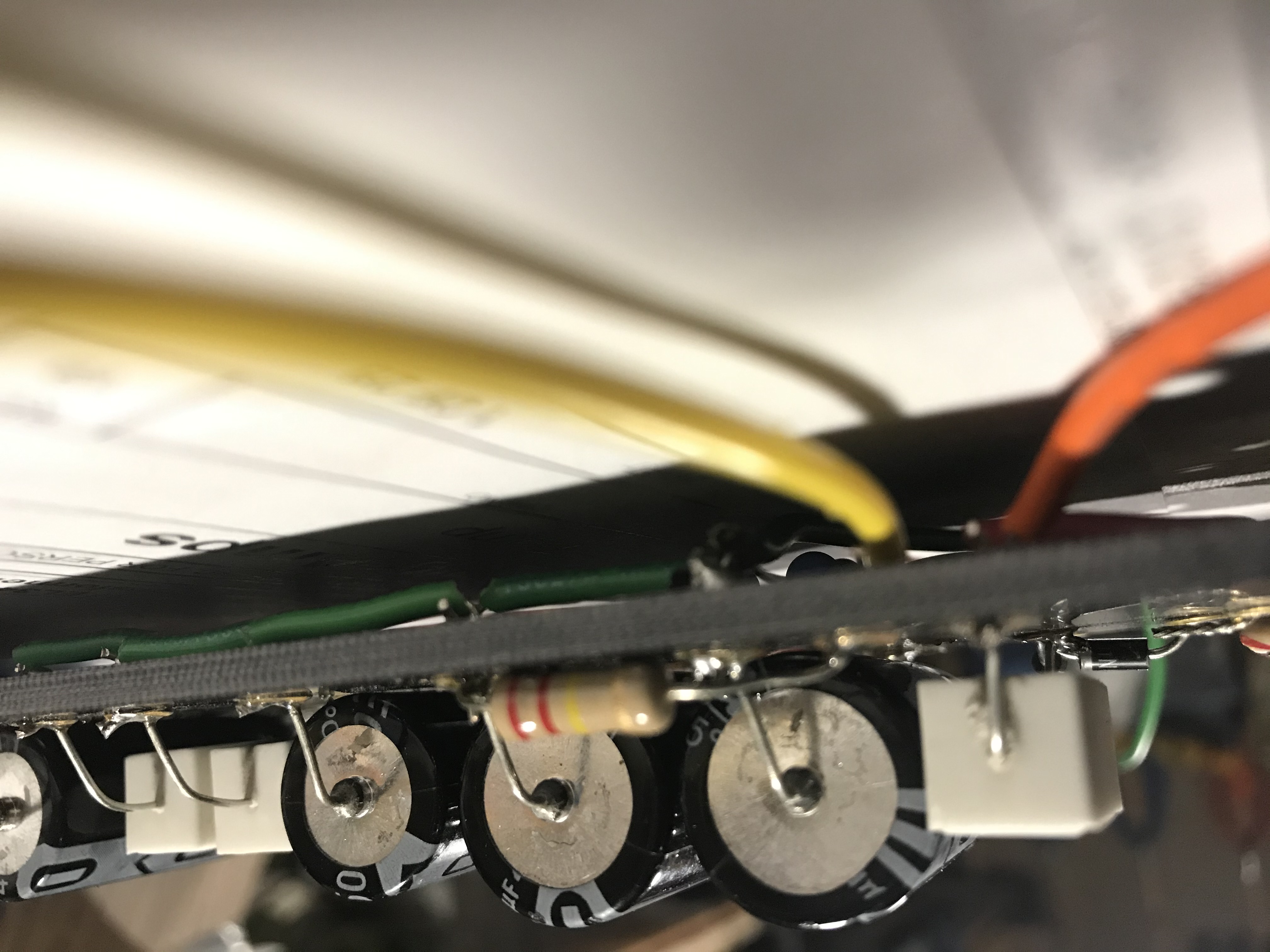

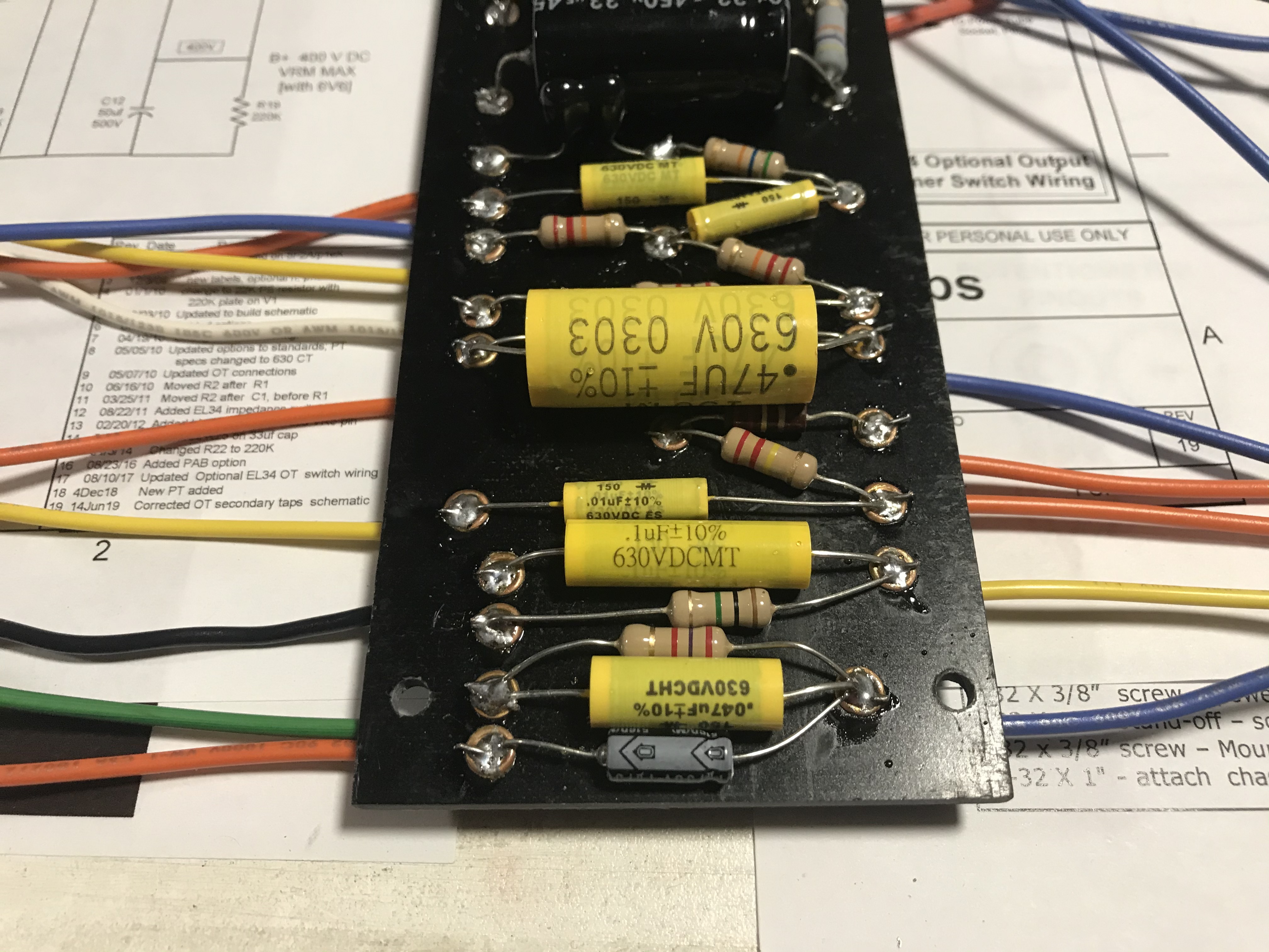

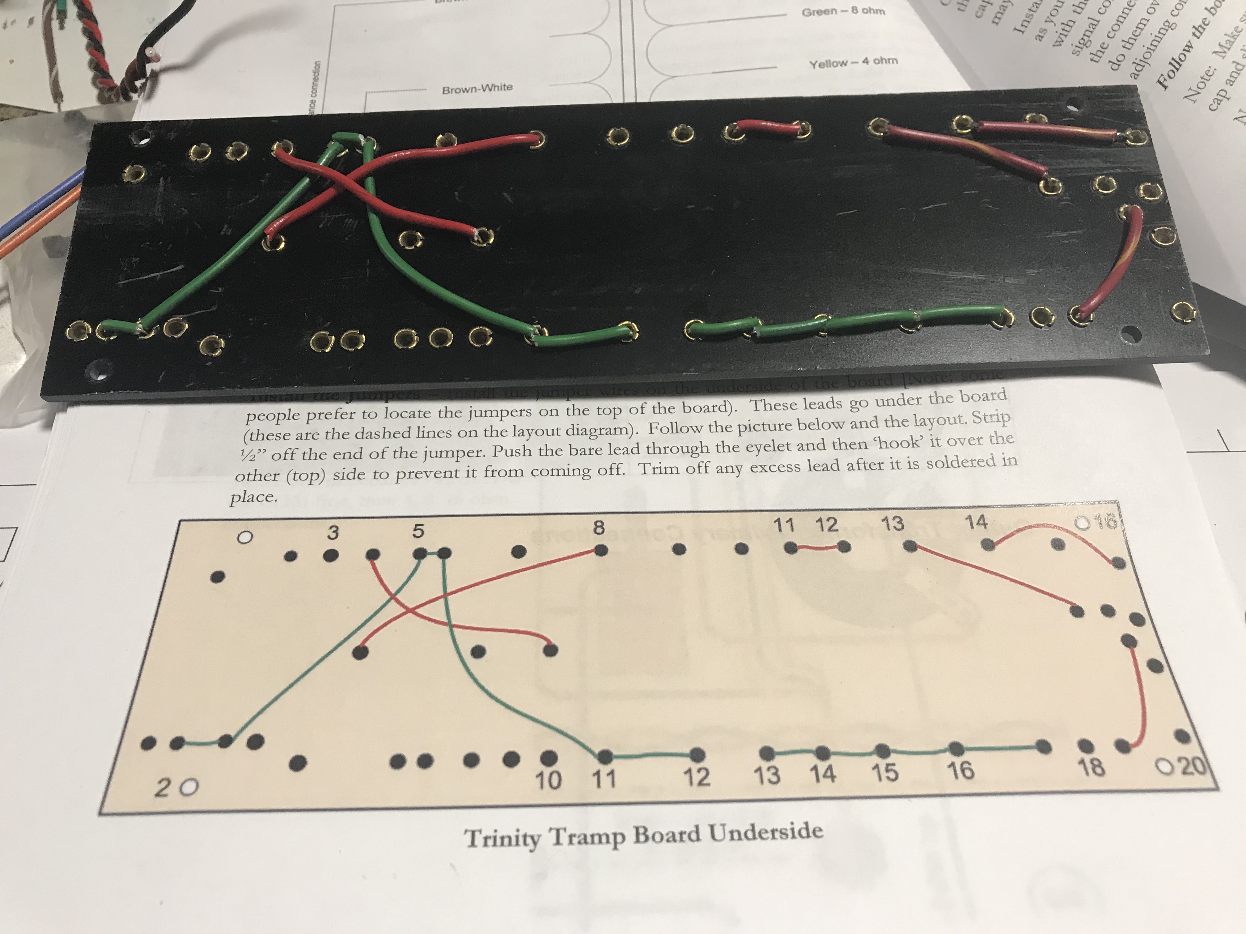

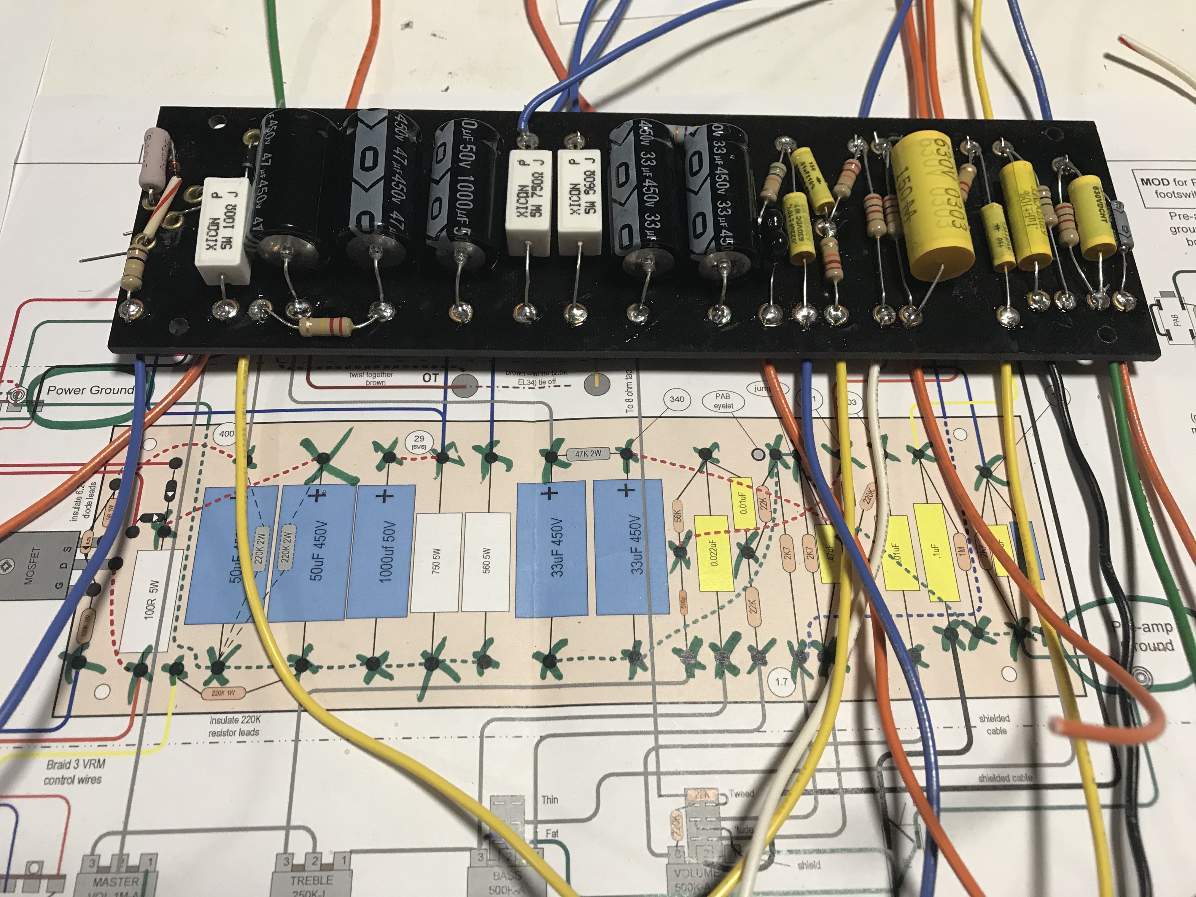

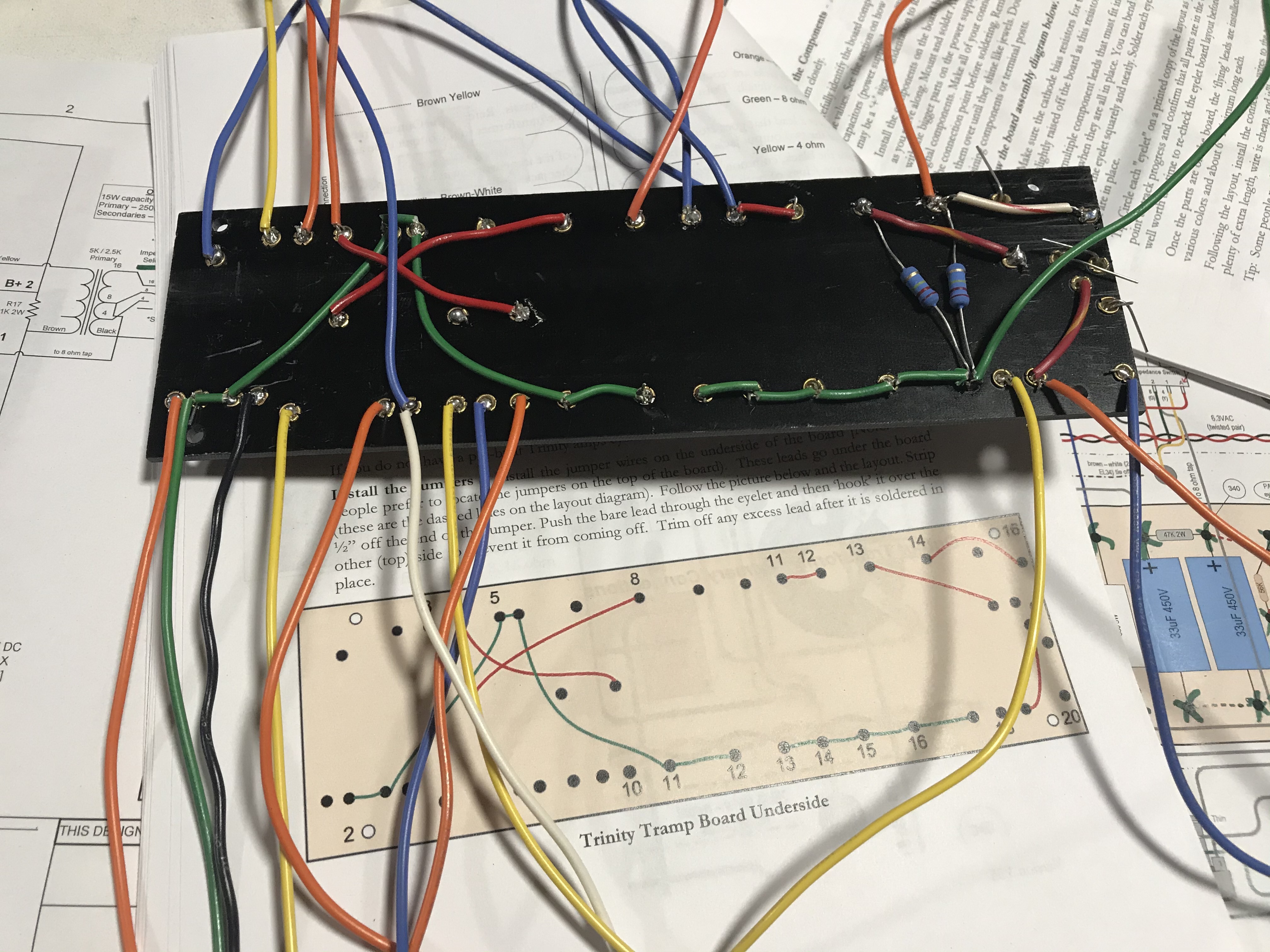

Finished the eyelet board this weekend.
File comment: Eyelet jumpers on the back
File comment: Top of Eyelet board with leads
File comment: Eyelet back, decided to put a couple resistors back there because they didn't fit so well on the top.
File comment: Mosfet side of the eyelet board
File comment: Right side of the eyelet board
File comment: Used 1/8" hardboard as a standoff for the ceramic resistors
